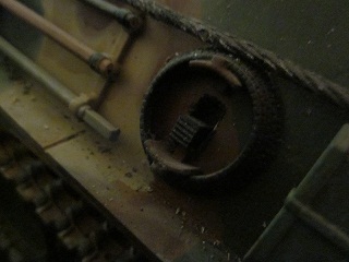

A good place to put the on of switch after cleaning it up so a battery recharge cable can be attached to it and run up to the large rear loading hatch is in the center if the cable coil holder in the right side of the upper hull. This can be also done with the panther G. Just paint the part of the switch that is exposed like the rest of the tank and its vurtually invisibleif you domt know that its there'

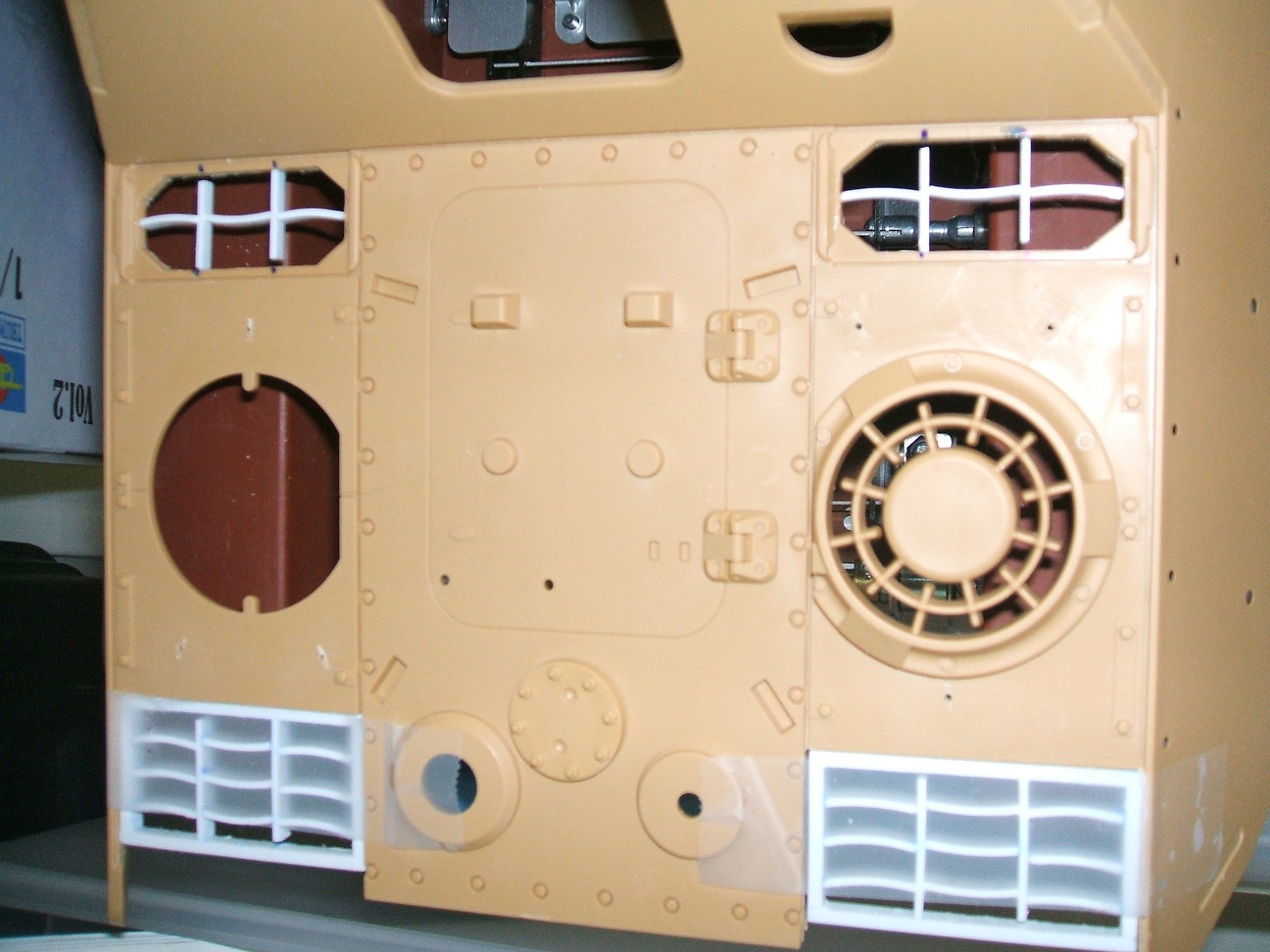

I've received the grates from Welshdragon, and the Tamiya sprue with the early exhausts on it. I did think about the other engine covers as you showed in your earlier post, and thought about how I'd do them. I took a stab at creating them out of balsa, had ok results. Might actually try to change the engine grates going that route. We'll see.
I guess I do have a question. The Tamiya exhausts I received do not appear to be hollow to allow smoke through. The bottom where they attach to the rear of the tank are hollow, like the late exhausts, and then there are small holes up to each exhaust stack. However the top of the exhaust stacks are solid.... Because there are small holes in the bottom, leads me to believe they might just be hollow all the way up, and if I drill out the top I'll open it up for smoke, however I'm reluctant to do that if the entire thing is solid. Anyone have any thoughts?

Drill A small access hole in he rear of the tube that faces the back plate, if hollow it's an easy fix if not it is easy to hide.

I partially drilled my exhausts and they are solid from the top down to at least to the bend in the pipe, that's where I stopped.
