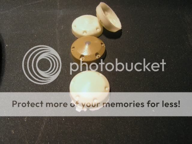

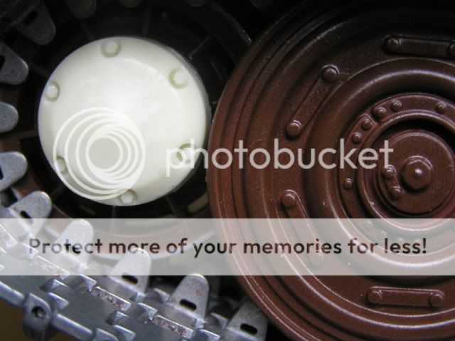

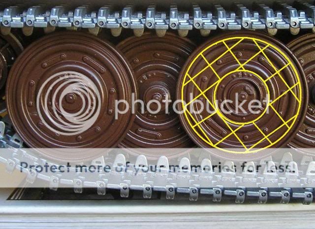

    BTW - If anyone is interested , and has the Asiatam 'small' metal Tiger 1 idler wheels , i've made some resin caps for them ( you just stick them on with epoxy or superglue )
    • Image

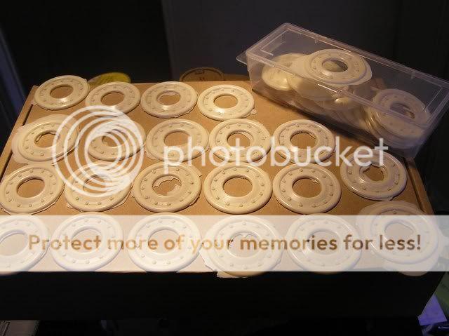

    • . . . . I've done a mould , and it's doing nothing , ( + a litre of resin !) so as long as it lasts - if ya want some just holler :thumbup:

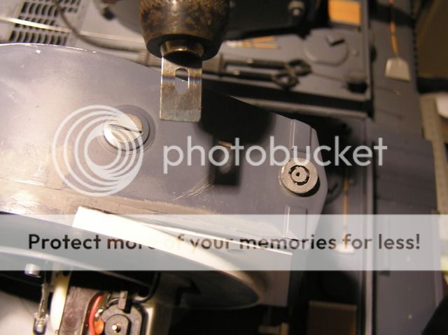

          • In the picture above you can see how i made the vision slits , first i reversed a large scalpel blade and used the tang , heated over a lighter pressed it into the plastic - the slit should be slightly below the centre line - when cool it was wriggled free and the whole mess filed back to a lower profile .

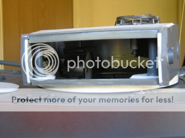

          • . . . I was not impressed with the trunnions either , and have cut them down to a more believable size and added some styrene under the 'chin' to represent the later type armour. things got a bit confusing here , research time . I spent yonks scouring the interwebs trying to find some decent shots of this , the late side armour profile is shown in 'Tiger info' but i couldn't find anything other than a photo of the thicker plate underneath . :|
            - I did find some fairly good still's , but a recent 'update' wiped out all of my scrapbook files ! Thanks a bunch , F*refox . Grrrr . Anyway , what they showed was that the front of the plate should be much closer to the turret ring and with a step at the sides and another showing below the mantlet framework . More number crunching confirmed that around 5mm has to come off the front , and 1m has to come off the height of the turret too , to do this i carefully removed the .5mm steps that make the joint between the top and bottom halves of the turret and made a new one from strips of styrene glued to the inner faces , it is much more positive as well :angel:

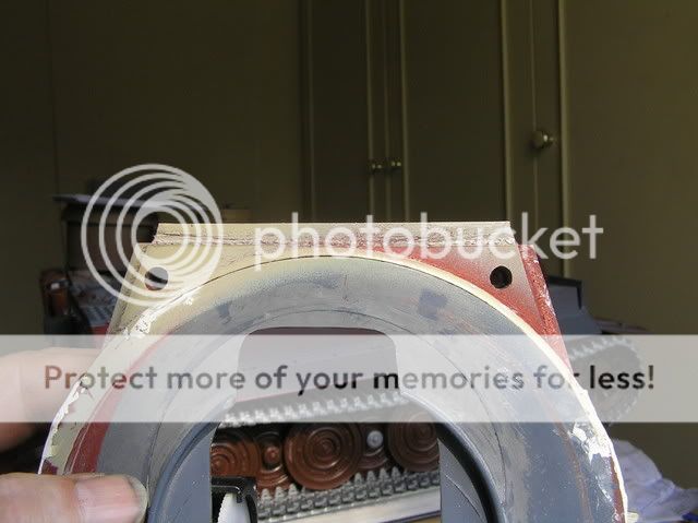

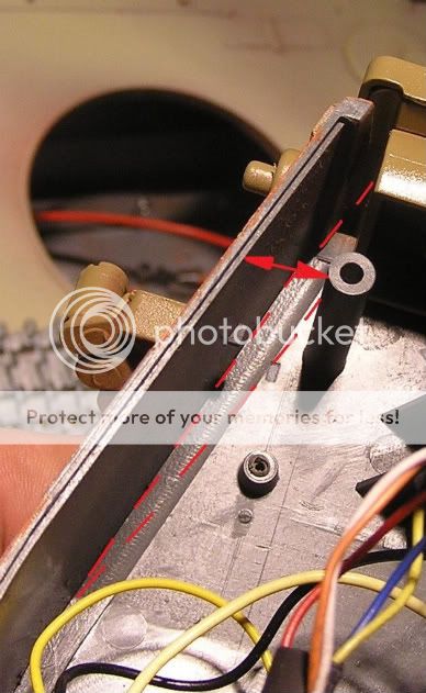

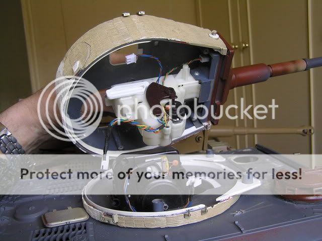

          Surgery time :| Deep breath , the real Tiger turret is offset , so i cut a 'V' shaped slit out of the r/h side of the roof along the weld at the front tapering back to the roof centre weld , taking care not to damage the inner fixing pillarthis was then clamped and glued , making sure the mantlet didn't overhang the ends when fitted .reinforcing the pillar/wall join with scraps .
          • Image
          • Image
          . . . The turret has to go from this . . .
          • Image
          . . . To this ...
          • Image

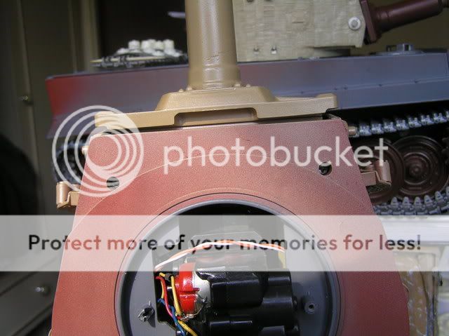

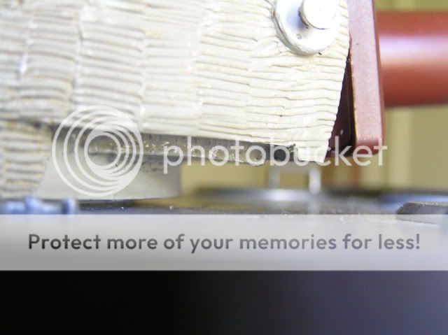

          • . . . The chin piece was trimmed to suit , and some styrene was added to the 'chin' upper edges to represent the turrets 80mm thick armour (5mm in 1/16th) , and a strip of plastic ( cut from the old Tigers battery compartment ;D )were glued to the front of the turret , to become the lower mantlet frame .
          • Image
          The top of the turret roof was trimmed back (to the weld line) the sides reprofiled and another plastic strip (4mm)added for the upper mantlet shield piece , I shall scribe the three segments and add the bolt detail here as it is visible .
          • The roof was skinned in .040" (1mm) plasticard to represent the additional 15mm extra amour that was added to the later tigers , i'll finnish the roof details after i've reworked the metal cupola to a more accurate shape .
          New trunnions were made from a dead Biro body and milliput , drilled 3mm for the new trunnion pivots (spare Asiatam suspension axles) and the distinct lower 'step' of the front armour crosspiece added , again from spare H/L plastic . It dosn't have to be too neat either , the Zimmeritt will hide it all ;D

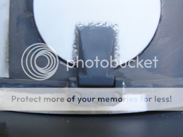

          The new scratched escape hatch door , the hinge from the old one had the lowest bolt drilled through and the lower portion cut away - * I found out later that Partworks Tiger has the right unbevelled type , worth looking for if you're thinking of doing a late version , trust me , it'll save you a lot of aggro .

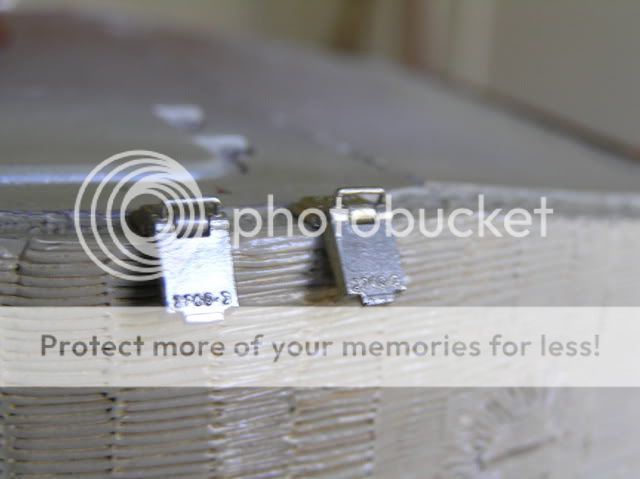

          • A fit of madness made me get the Schumo (working!)track hangers , pricey , but they are truely superb , you need a magifying glass to read the part no's ! ( the holes needed redrilling but that's not suprising , they are made using the lost wax system )

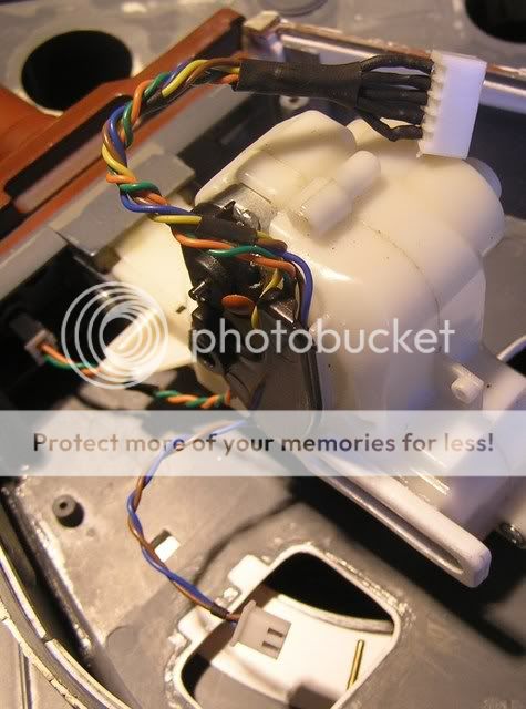

                      Back to the subject .pt 7 . The joys of wiring . . .
                        • Image
                        The new wiring scheme for the turret .
                        . . . Much better than the old confusing H/l system i think , i'm now able to trace any wire to it's source instantly . The 2 + 5 pin sockets from the original ABC TX board and the unused RX 18 IR lead supplied the coloured leads (the black lines show areas of shrink wrapping , keeping it all neat and snag free . )

                        • . . . and put on these home made resin bits instead ! Muhaha !

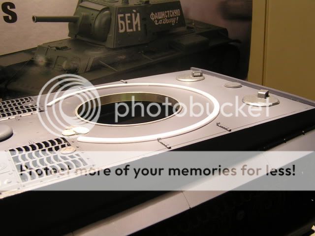

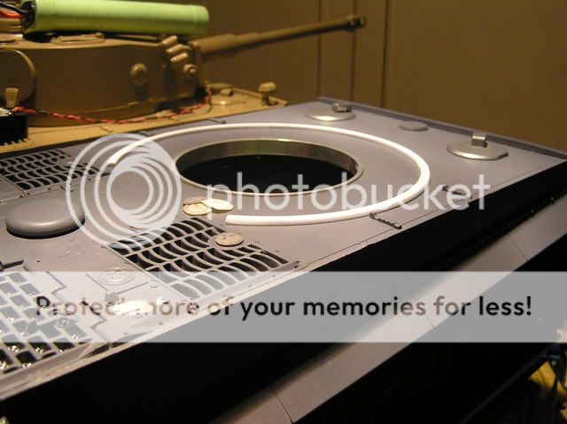

                        • 'Er indoors has decided lately that being outdoors "Is good for you" - (Translation -grafting in the garden etc. ) cruelty to troglodytes i call it . . . .
                        All i managed this weekend was the shot ring :thumbdown:
                        • Image
                        . . . and a couple of resin track shoes for the hooks , the metal ones i have won't stay put , these i can glue/pin into place permanantly and still have some working spares . Yay . B .

                        I like your turret protection ring - often forgotten in the later builds.
                        I hope to start scribbing one out for Tiger Ebbey soon.. Interesting about the turret track links, another area of fun to come no doubt !!

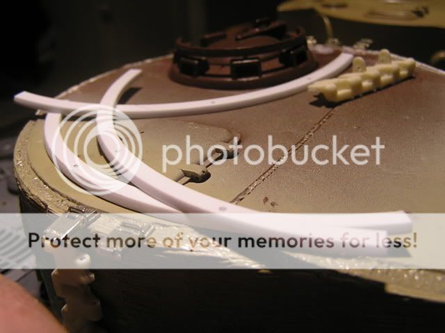

                        Hello peeps ! I have got a bit tied down with work 'n stuff lately and bench time has been lacking , however , i have 'cleared the decks' and given it a coat of primer , getting it ready for all the clamps , tools and dodah's to go on .
                        • ImageImage
                        . . 'ello 'ello , there's a strange big box in the background - now that wasn't there when i went to work this morning . . . :shh: He hee .
                        • Image

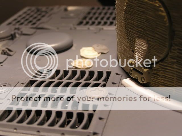

                        . . . tonights little job is turning the engine deck into the late type , moving the catch for the engine hatch , filled rear oil filler cap ( still need to make the tiangular plate , new air intake and handles ) all the old fixture holes were filled along with the six little waterproofing latch holes . The new 'cast' airfilter cover is just the old one ,sawn off , the top corners were rounded off and the base trimmed flat , the original hole was filled with a disc of plasticard with a 4mm packing piece to restore the height , neat eh . Also shown are some new radiator / fuel filler caps . Bluetac pressed onto the originals made the moulds , a drop of resin later - i can now have them at more realistic random angles :D simples . Must dash - early start again , nighty night . :wave:
