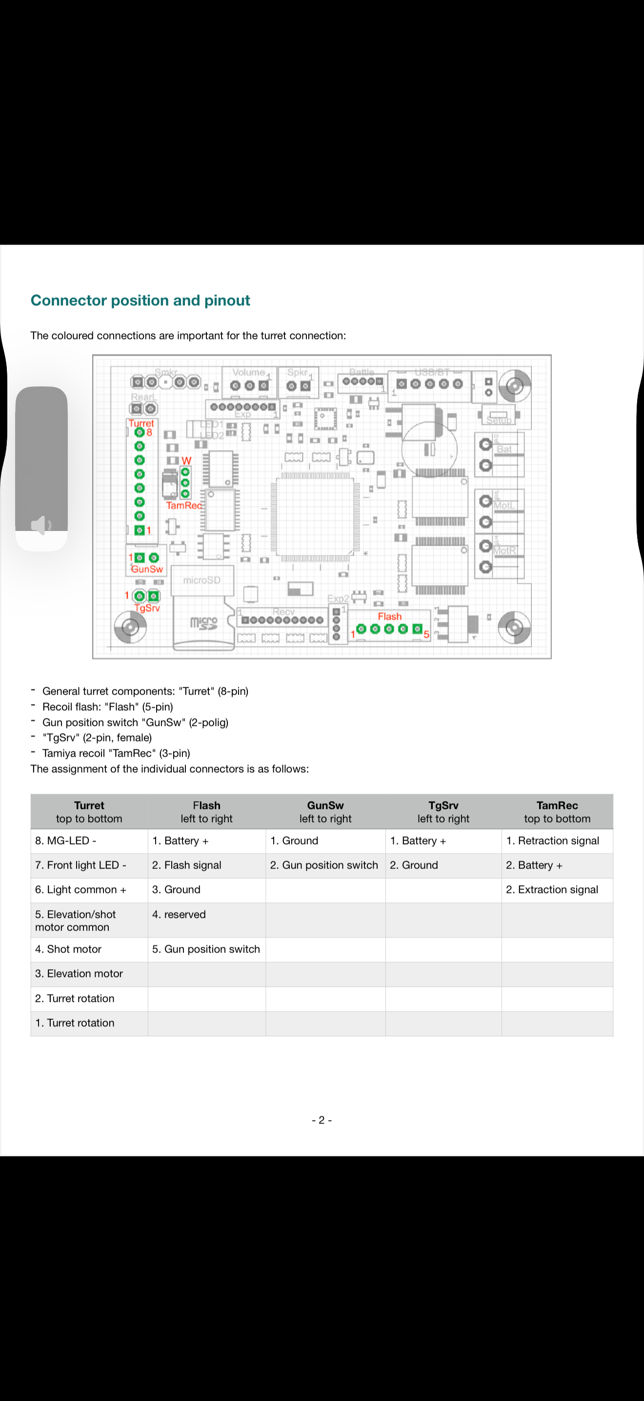

So I think I know what’s going on with the wires, but not the switch.
So Taigen/Torro will often combine the positive wire for multiple things and then have separate negatives, whereas HL is usually good about having a separate wire pair for each component, so the diagram of the HL 360 may not align with what you have there.
If you look at the picture of the Elmod turret connection wiring table below, you can see this how Taigen/Torro have a common positive for things in the hull (lights, MG) and things in the turret (AS motor, elevation motor).
So looking at the number of wires coming out of the slip ring I believe what that unconnected wire probably is is the Airsoft limit switch. When the plunger of the Airsoft unit is pulled back, the limit switch is closed and that tells the V3 to stop sending power to the Airsoft motor. The plunger releases and the limit switch is open again, the motor is off, and it’s ready to fire again.
You said that you fired the Airsoft already and saw no issues, so if this is the case I’m wondering why you didn’t hear the plunger clicking over and over again, which is what will happen, instead of clicking once. Because that wire is zip tied up there, I’m guessing it came that way, which is all the more intriguing.
If there is a gun smoke unit up there, I’m wondering how it is powered. While you could use the common positive to the turret to power it, it would still need its separate negative to power at least the heater….
Unless the whole thing is tied to the Airsoft motor. It might be that the heater, blower, and Airsoft motor are all tied together. So I guess what would happen is when you pull the trigger to shoot, the shooting circuit is now complete and the Airsoft motor, the smoke heater, and the air pump all turn on at the same time. Then when the limit switch is closed, the V3 shuts off power to the shooting circuit and the Airsoft motor, smoke heater, and air pump all turn off at the same time. So if this is the case there might not be a gun smoke controller card.
I usually make it so that the heater is always on and the air pump and Airsoft plunger (or usually in my models the recoil servo) activate at the same time. However, it doesn’t usually take long for the heater to start generating smoke, so maybe just turning it on at the same time as the Airsoft motor gives it just enough time to generate some smoke. It may not be very visible though, as the smoke won’t really have time to build up since the air pump is also going at the same time.
To see if the air pump is going, I would unplug the speaker and then shoot the gun and listen for a little whirring sound of the air pump.
If you are brave, you can see if the barrel has that smoke oil smell after you fire it, indicating that smoke may have traveled up the barrel, but maybe wasn’t thick enough to actually see.

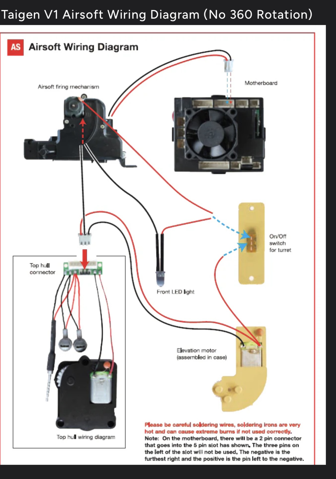

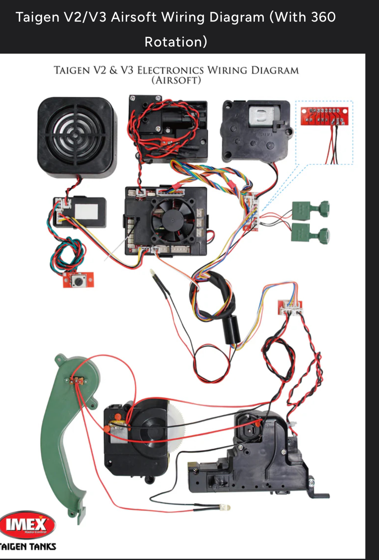

Below are some connection diagrams for the Airsoft in the V3. I bet that blue green wire pair is the limit switch. I wonder why the Airsoft was functioning correctly without it though? I guess even with the limit switch unplugged it would still fire the Airsoft ball, just the plunger would click over and over, it might fire multiple balls too, if you have more than one in the hopper. I think that sometimes the MFUs have a timer cutoff for the Airsoft motor power just in case the limit switch gets unplugged.

- Here you can see in the 8 pin Taigen connector some of the positive wires power more than one component, but each component will have a separate ground wire
- IMG_0384.png (589.38 KiB) Viewed 513 times
- Even though this is for the V1, this picture kind of gives you an idea of how the wiring for the Airsoft models is done, even though there is no slip ring in this diagram, it’s still the same. You can see that the wire pair for the limit switch goes straight to the MFU and does not plug into the upper hull daughter board, kind of like what you have going on in your model.
- IMG_0388.jpeg (323.38 KiB) Viewed 513 times
- Airsoft wiring for Taigen. Here that first small red daughter board you would find in the turret. Notice that the limit switch connects to this, but it does not connect to the hull daughter board, it goes straight into the MFU. In this image the orange and white 2 pin JST plug is the limit switch plug, whereas in your model I think it is blue and green.
- IMG_0389.jpeg (1.01 MiB) Viewed 513 times

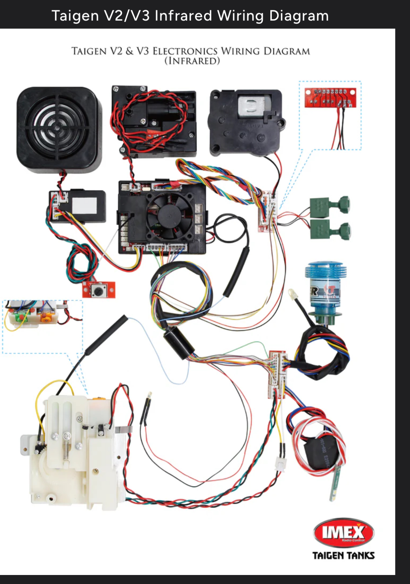

- IR wiring for Taigen, for contrast
- IMG_0390.jpeg (1.04 MiB) Viewed 513 times
