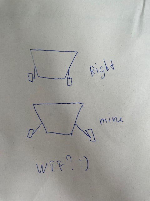

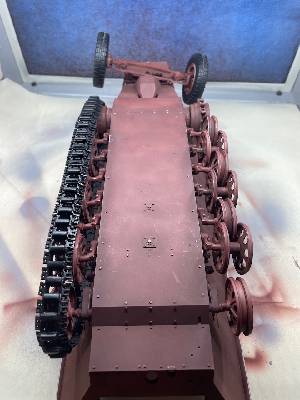

Here is problem with swingarms and torsions:

I am just a bit confused, velthal and Met5: do you mean that one should NOT replace the stock gears?

Herr Dr. Professor wrote: Thu Jun 20, 2024 8:00 pm I am just a bit confused, velthal and Met5: do you mean that one should NOT replace the stock gears?
I dont want to cut hull, but i didnt find replace. May be I will order copy in factory from good matherial.
Im interesting about upgraded bones. Should i cut it or cups? I found 3 variants here on forum.

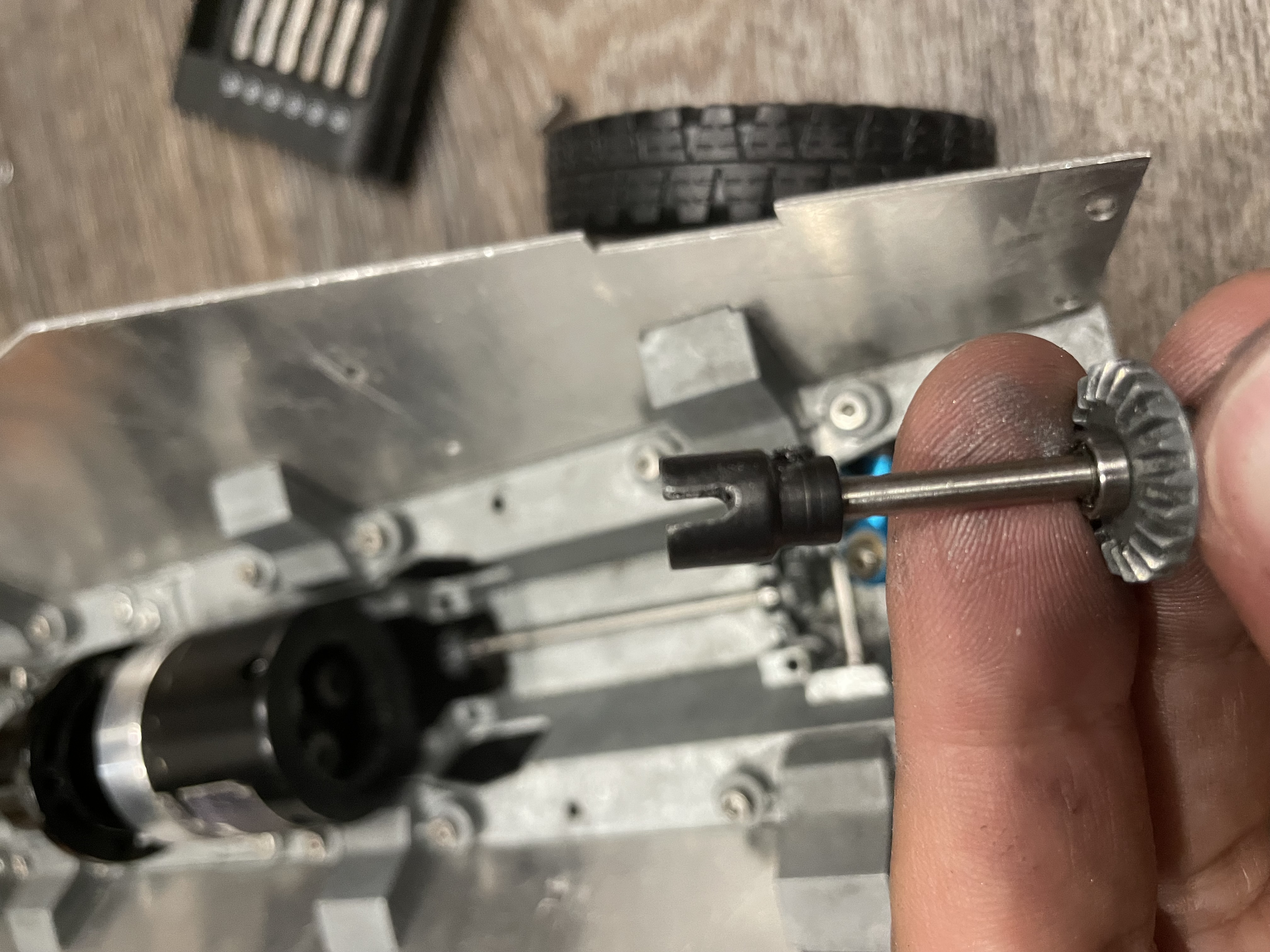

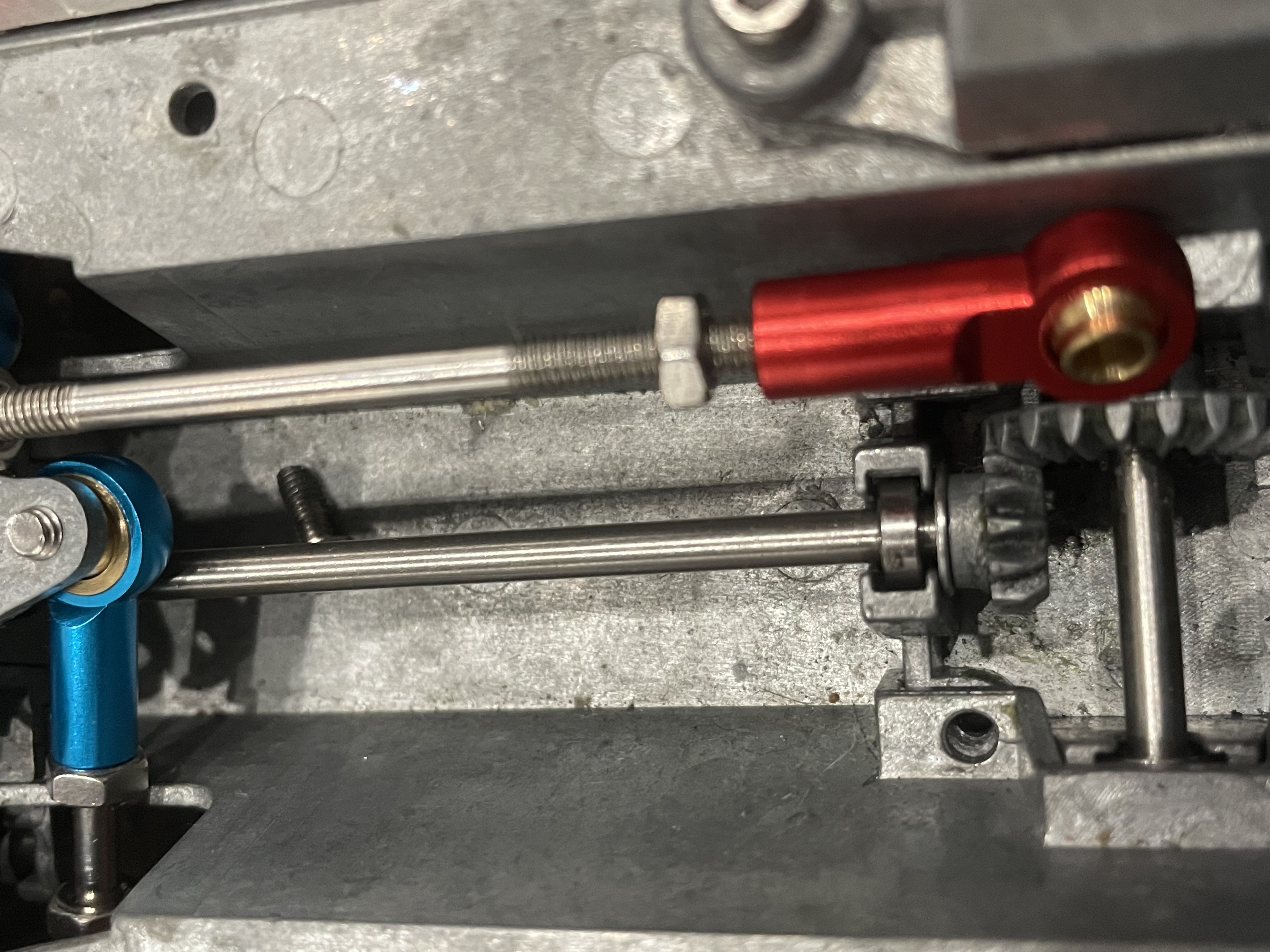

#234
On Puma from metal origins, my first impressions:
1. it is advisable to replace the original gears. but if not replace them, be sure to put washers.
2. cvd should be selected or refined. as for refinement, there are at least 3 solutions on the forum. I am interested in Met5 option (but he does not answer me).
3. The servo drive platform should be modified to 4 mounts instead of 2.
4. I don't know how in the latest revisions, but in the first revisions, the upgrades interfered with the operation of the main parts. For example, the motor rests on the stiffener, the gearbox from the turret rests on the motor and the lid does not close, cvd bones have the wrong stroke and the wheels bounce.

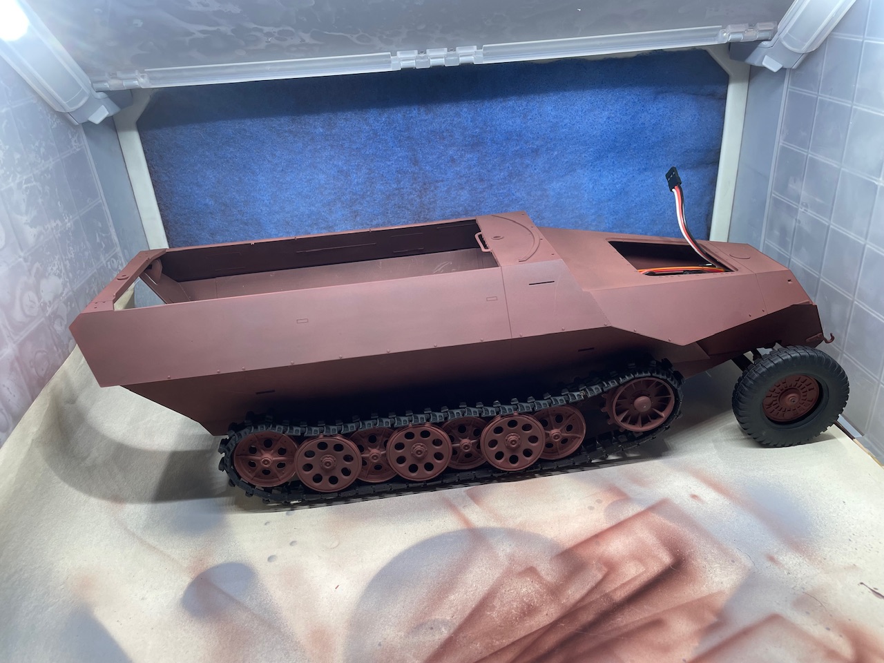

#251
Thanks, Derek. CA is a good glue for torsions. I finished 2nd track. maybe tomorrow it will be first run for my 251.

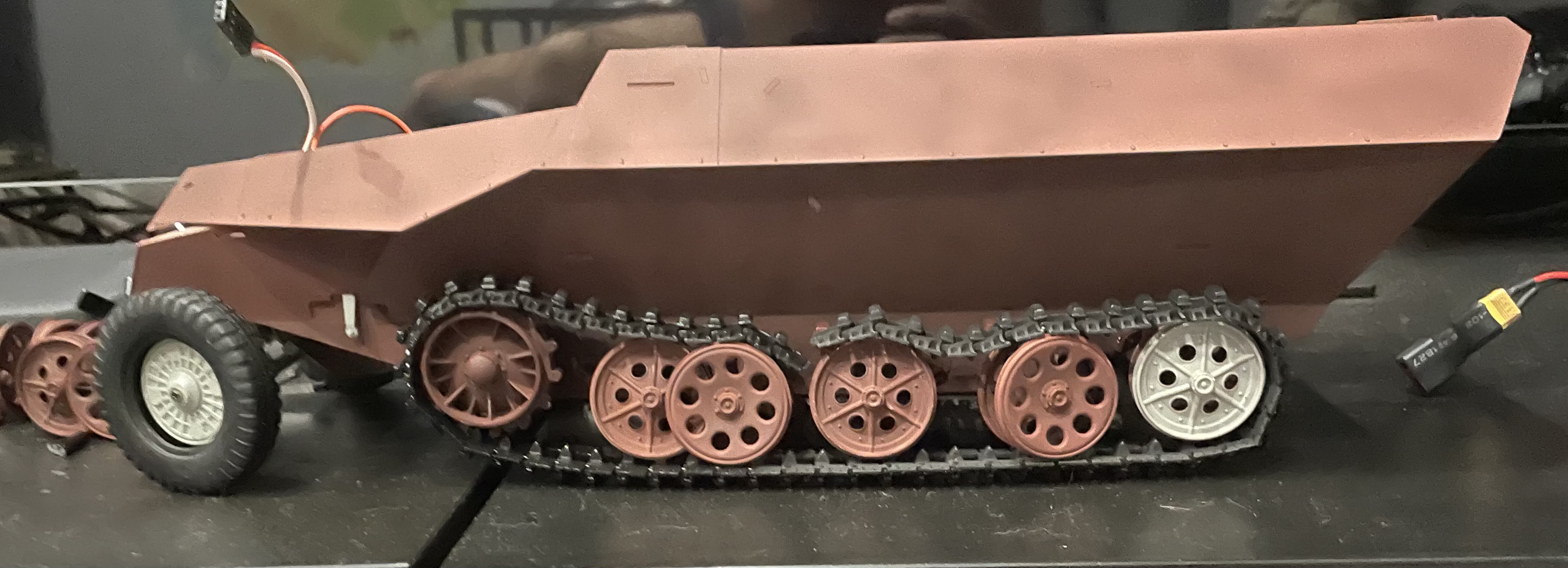

Okay, first run. Im not very glad because idle wheels are not really watching straight.

251: started, but suspension adjustment is required. tracks are constantly running away. haven't figured out how to fix it yet.
https://youtube.com/shorts/9Tjpx2t8C4Q? ... DUXXDIoIF_

I will put bushings or washers on the shafts, cut the cups, probably using lmcq11 method. I would like to hear Met5's opinion :).
I burned my elmod puma.

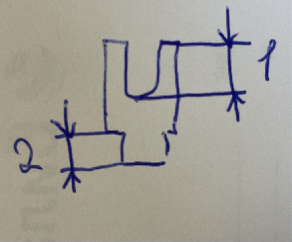

updated: ok, i did like lmcq11. Work perfect. Done 4\8.

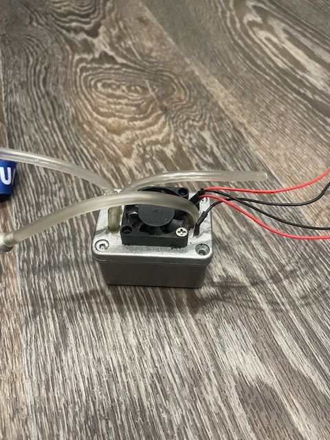

aero-mate tiger 1: finally figured out how to connect and control the external brushless motors. however, one of the sticks on the remote control started drifting and it's a bit of a hindrance to full operation. Time to choose a smoker. i have one of these, pictured below. Should I keep it or are there better options now?
Smoker
Smoker
whats better to cut? 1 or 2?

Puma progress. I installed upgraded bones kit, cut shaft cups and installed wafer.
https://youtube.com/shorts/lc0a78rqIN8? ... WJTeBRwxF-
