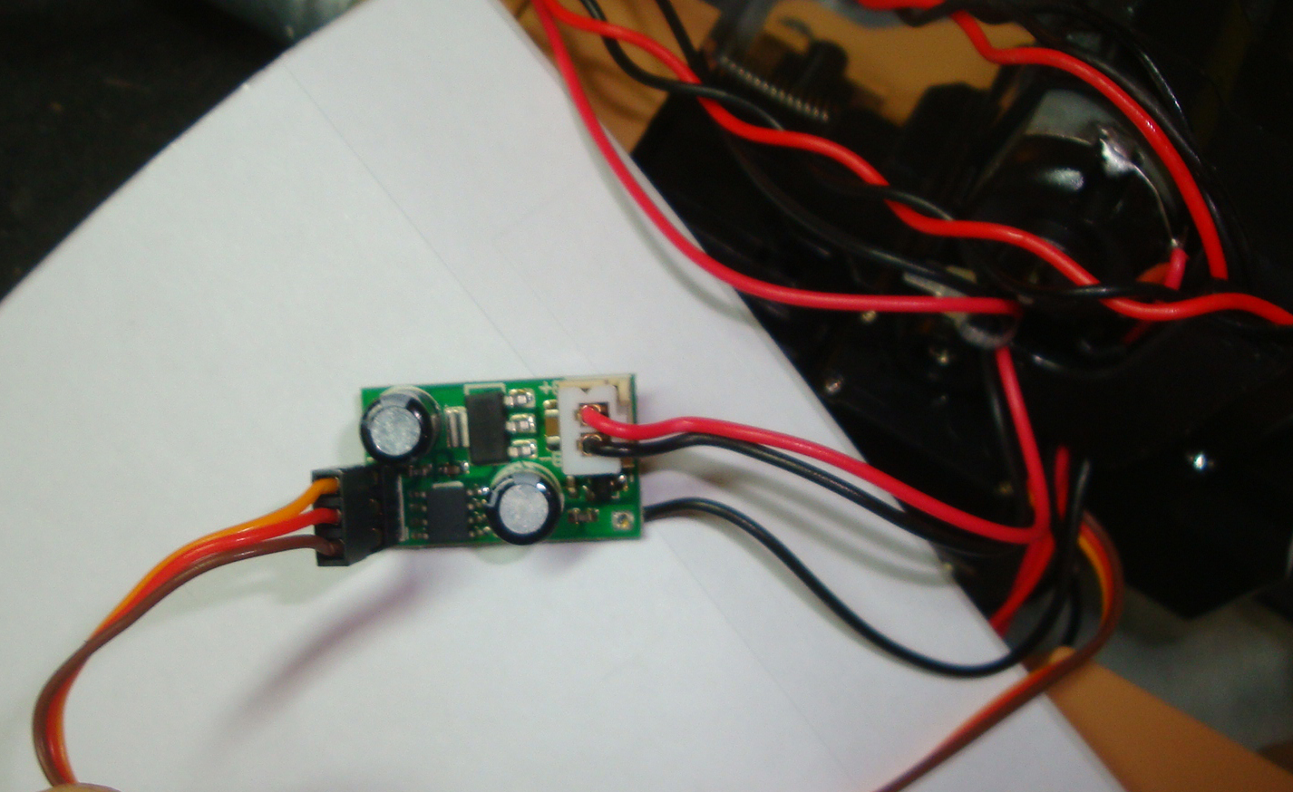

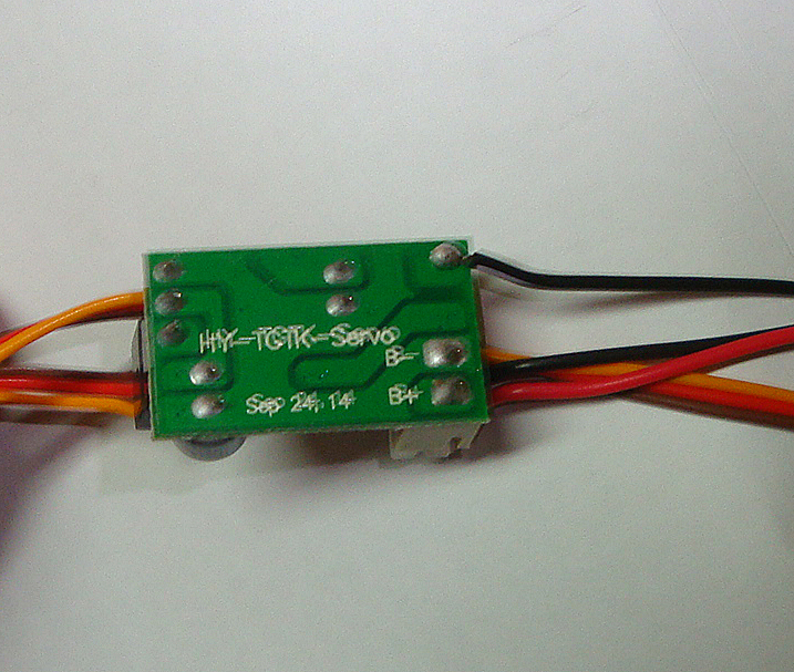

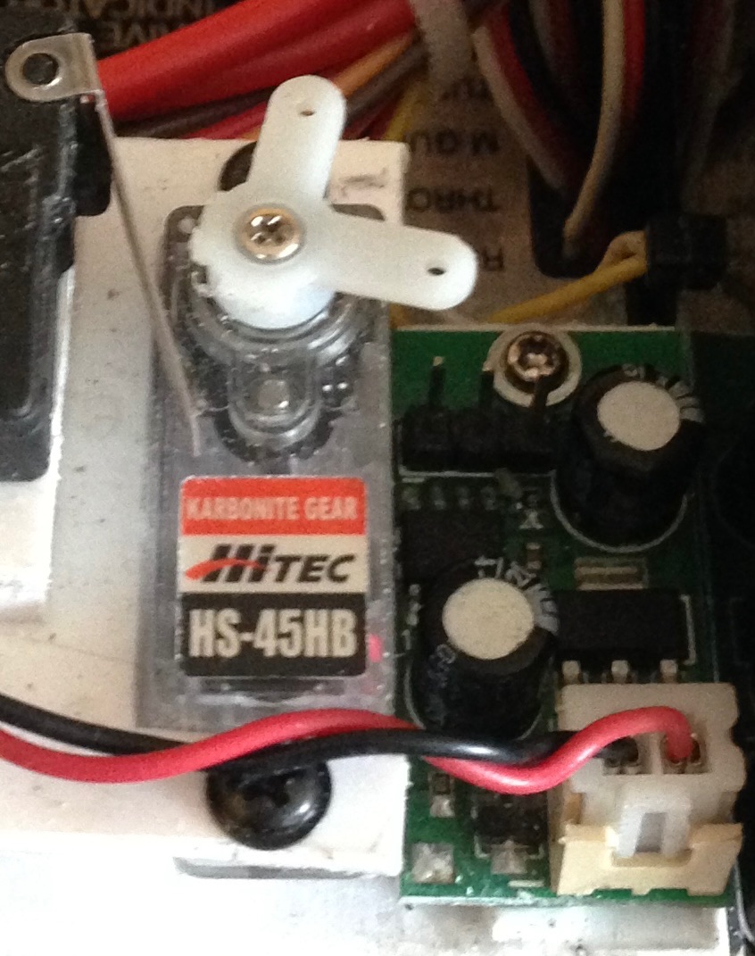

by Jofaur86
:) there was a specific module, to operate a servo, a powered plate +/- 5 volts, and plus 5 volts, taken from the "airsoft" switch attached is a photo of this system installed for gun recoil, on a Sherman Tamiya, while retaining the original electronics
platinum
installation on Sherman
