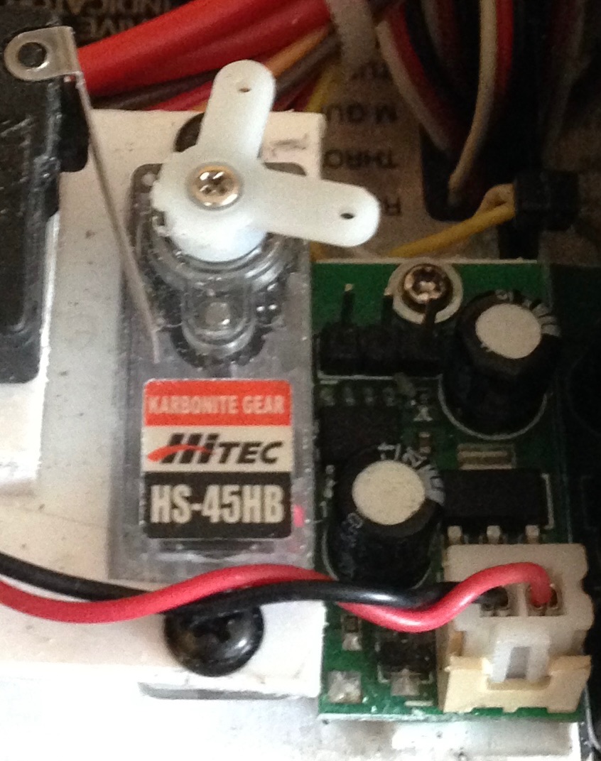

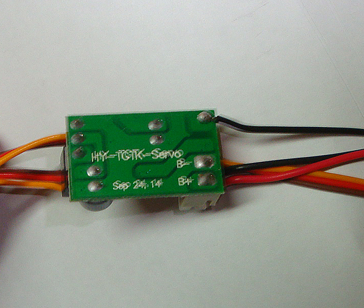

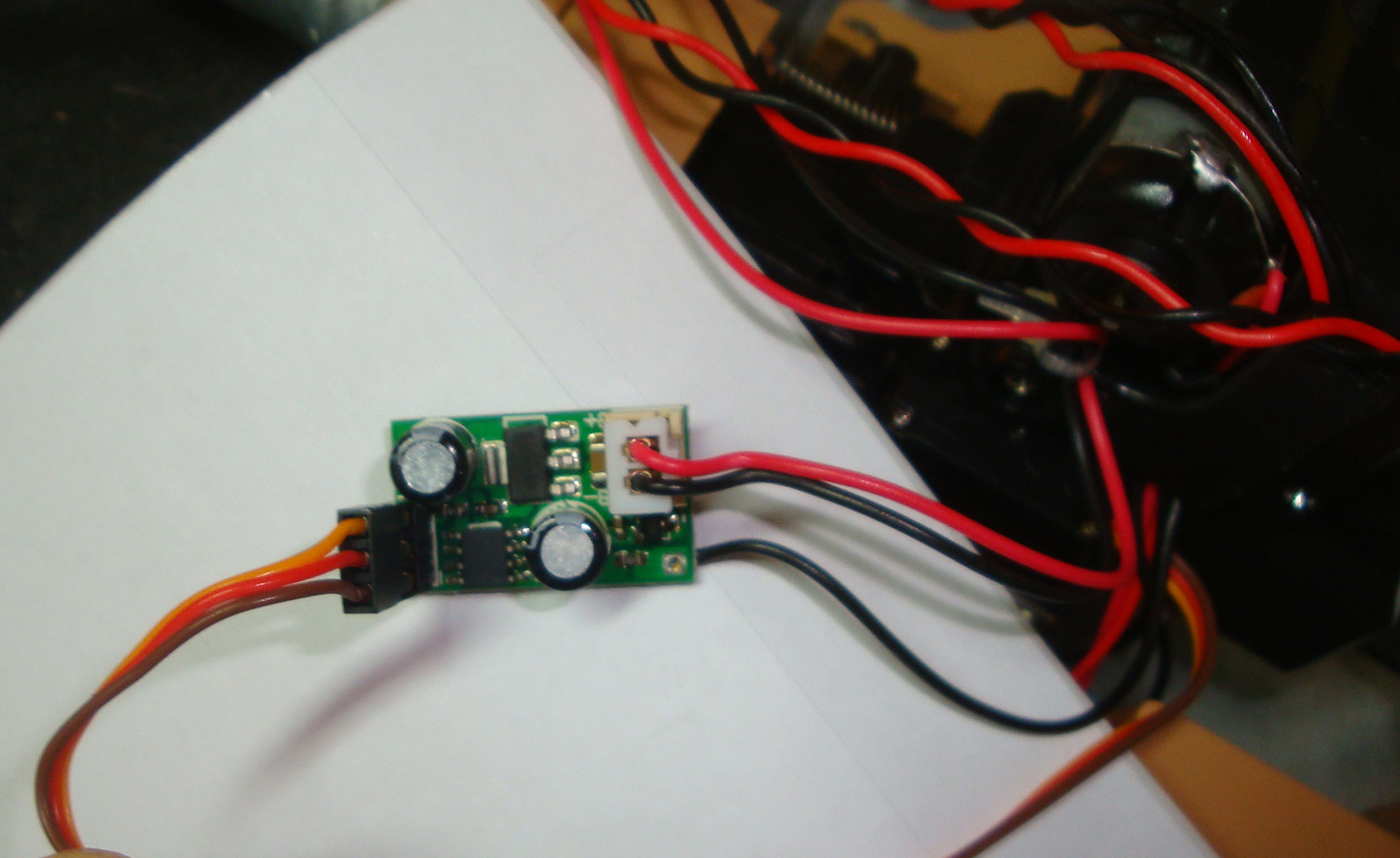

There are a bunch of different ways to add recoil to the barrel. Some retain the BB function, but since you are adding smoke I would assume you aren't keeping that function. Adding a barrel recoil usually requires a good bit of cutting and fitting as the barrel is glued to the mantlet in most cases. Most of us use a servo recoil, but without a motor driver to servo converter or a control board with a servo output like a 7.1 or 6.1 (or aftermarket board) it is not really possible.
