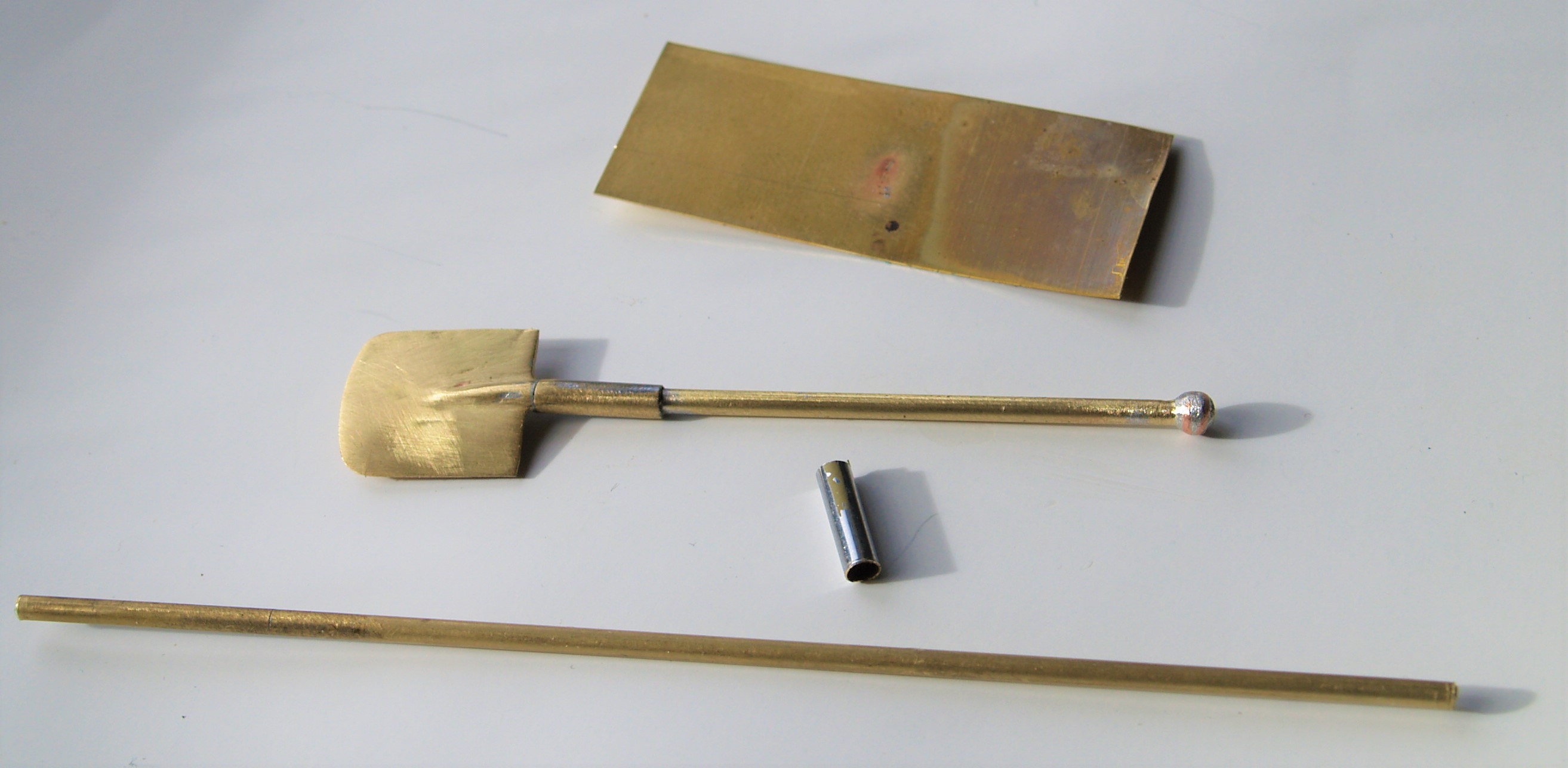

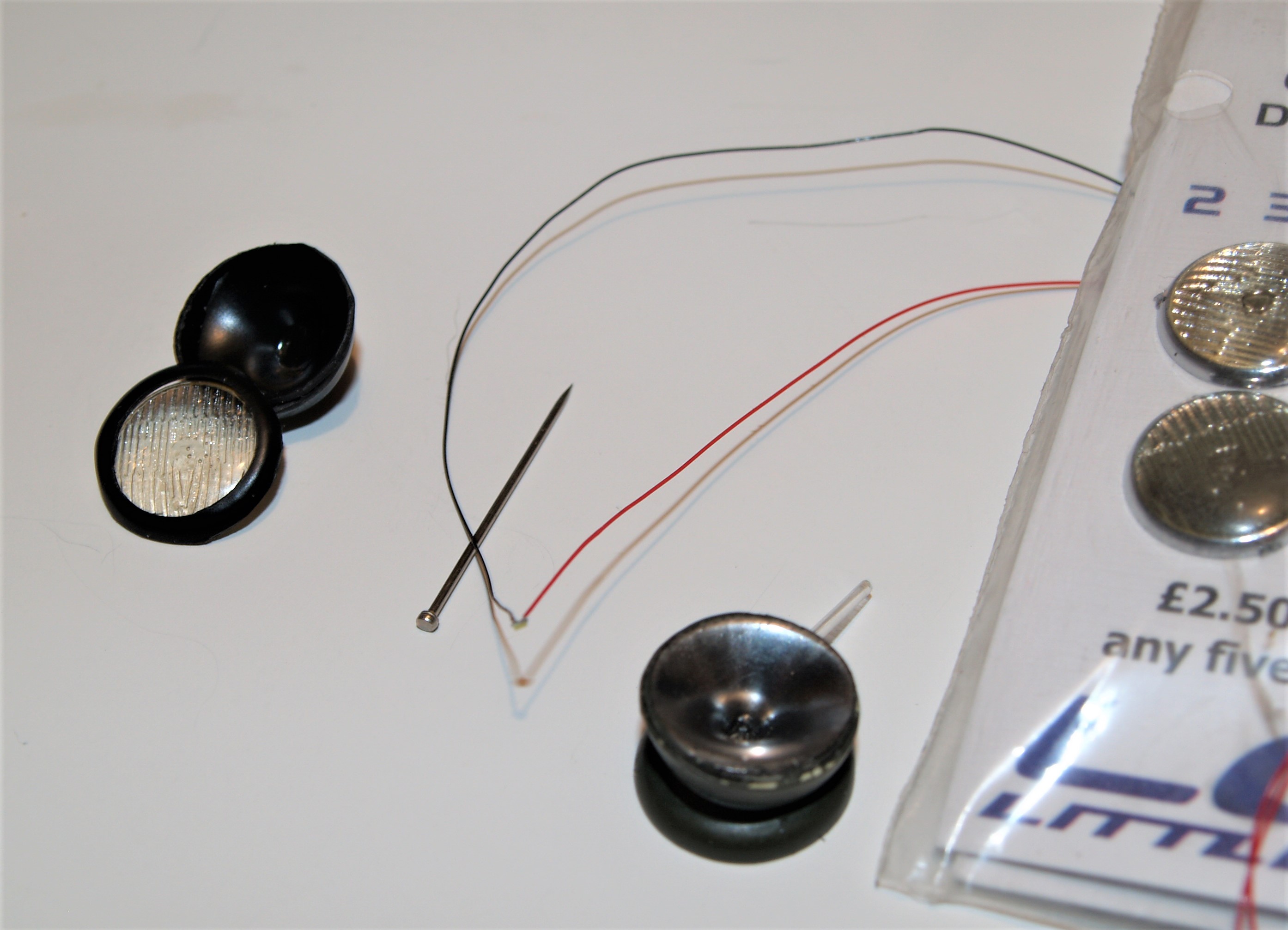

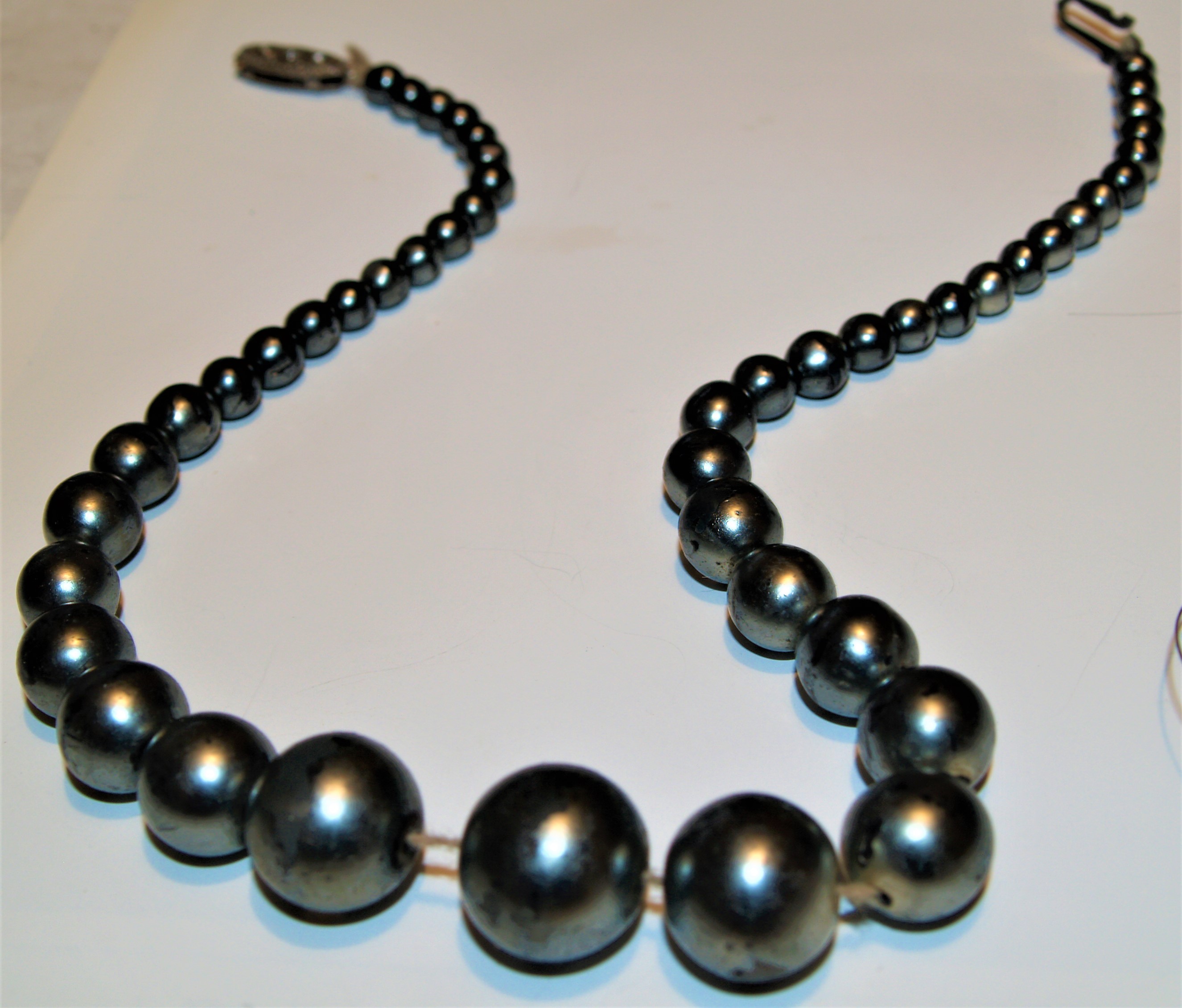

Sorry folks , I've been a bit slow lately
- Been sorting the IBU2 , servos and other wiring stuff .
- However here's some bits . . . .
. . . Some beads , various sizes , from a charity shop make excellent masters for ...
- Head light bowls etc. the threads are wires for the Micro SMD bulbs - Pin for reference !
And a couple of shovels to round things off .

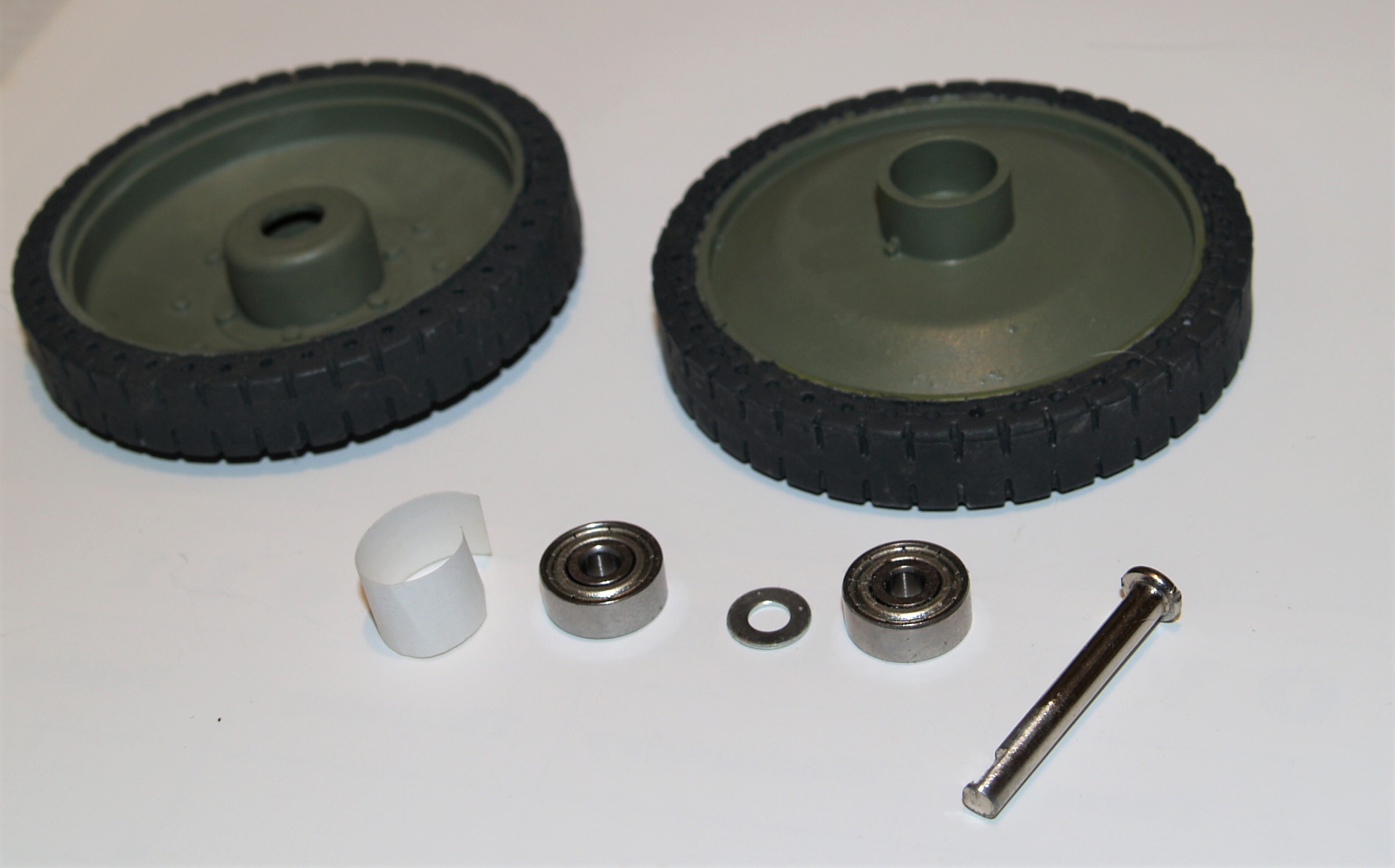

I can understand everything very well,but I wonder how you put these wheels from Trumpeter on the HL hull,can you please show us.
with kind regards,Guido

Hello Guido
- Not HL Guido , the hull is Taigen , with steel gears . . .
2x 9x3x3mm Bearings , a washer , axle (from my spares box) wrapped with a paper strip - this takes out the slack around the bearings .
- a tube spacer is also needed to align the wheels and stop them rubbing against the swingarms. ( Not shown)
* If 7x3x3 Bearings are used , the outer packing can be 1mm thick plasticard.
All the best . B.

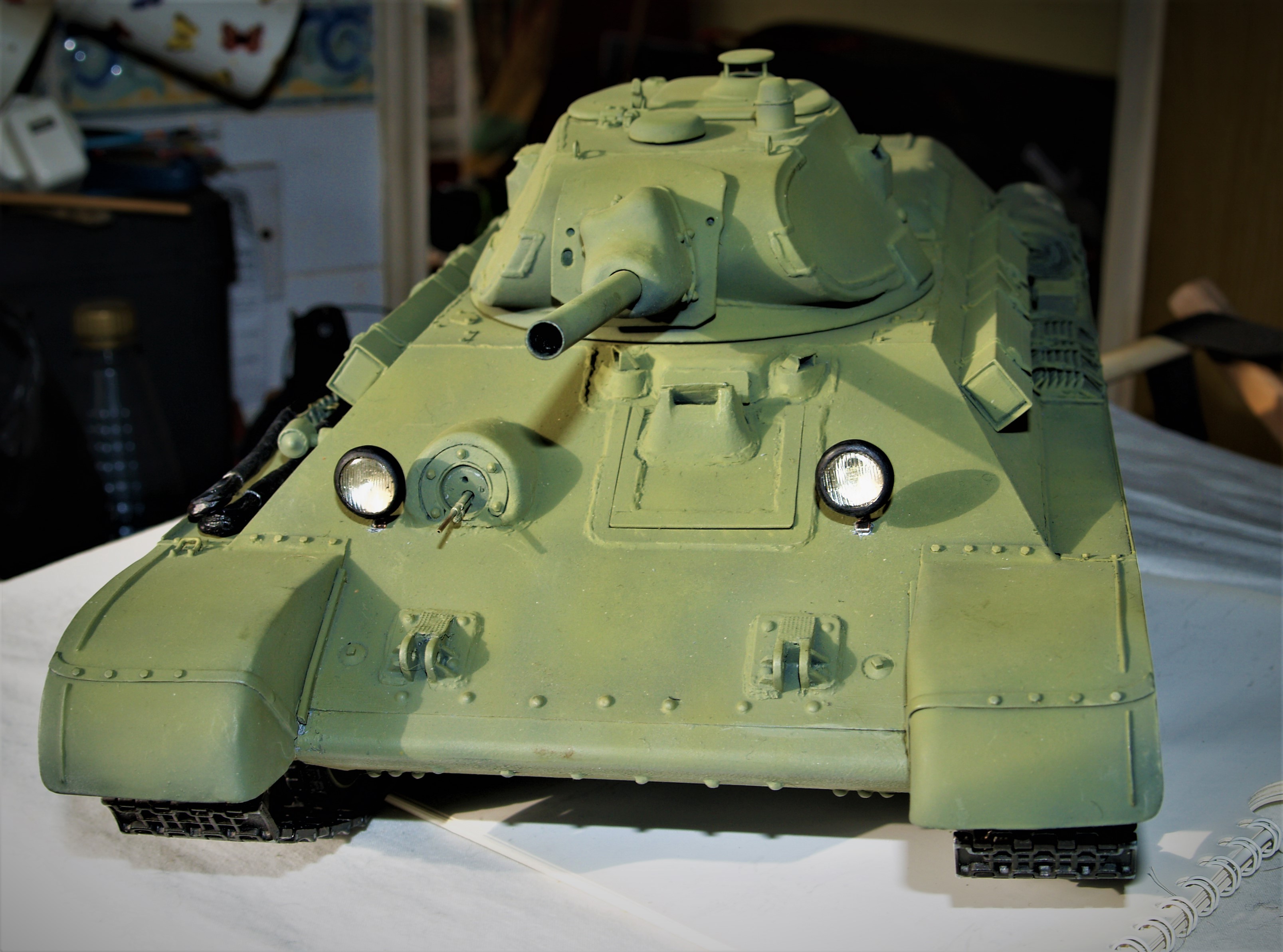

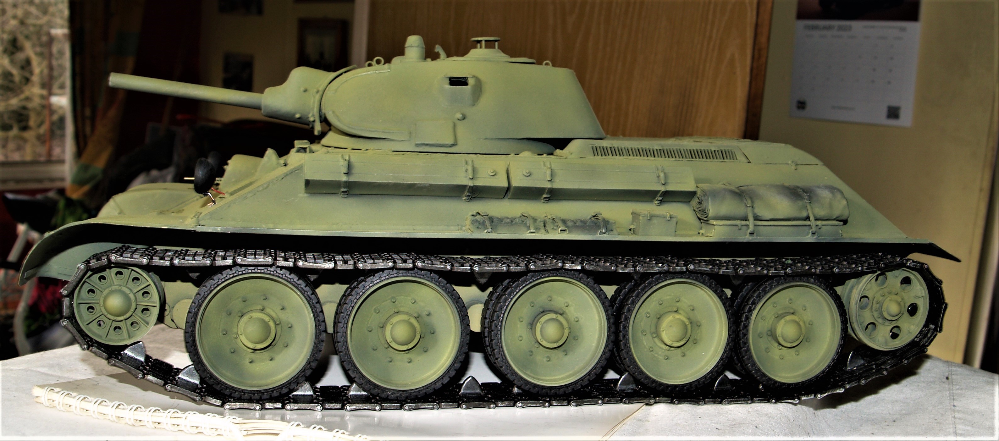

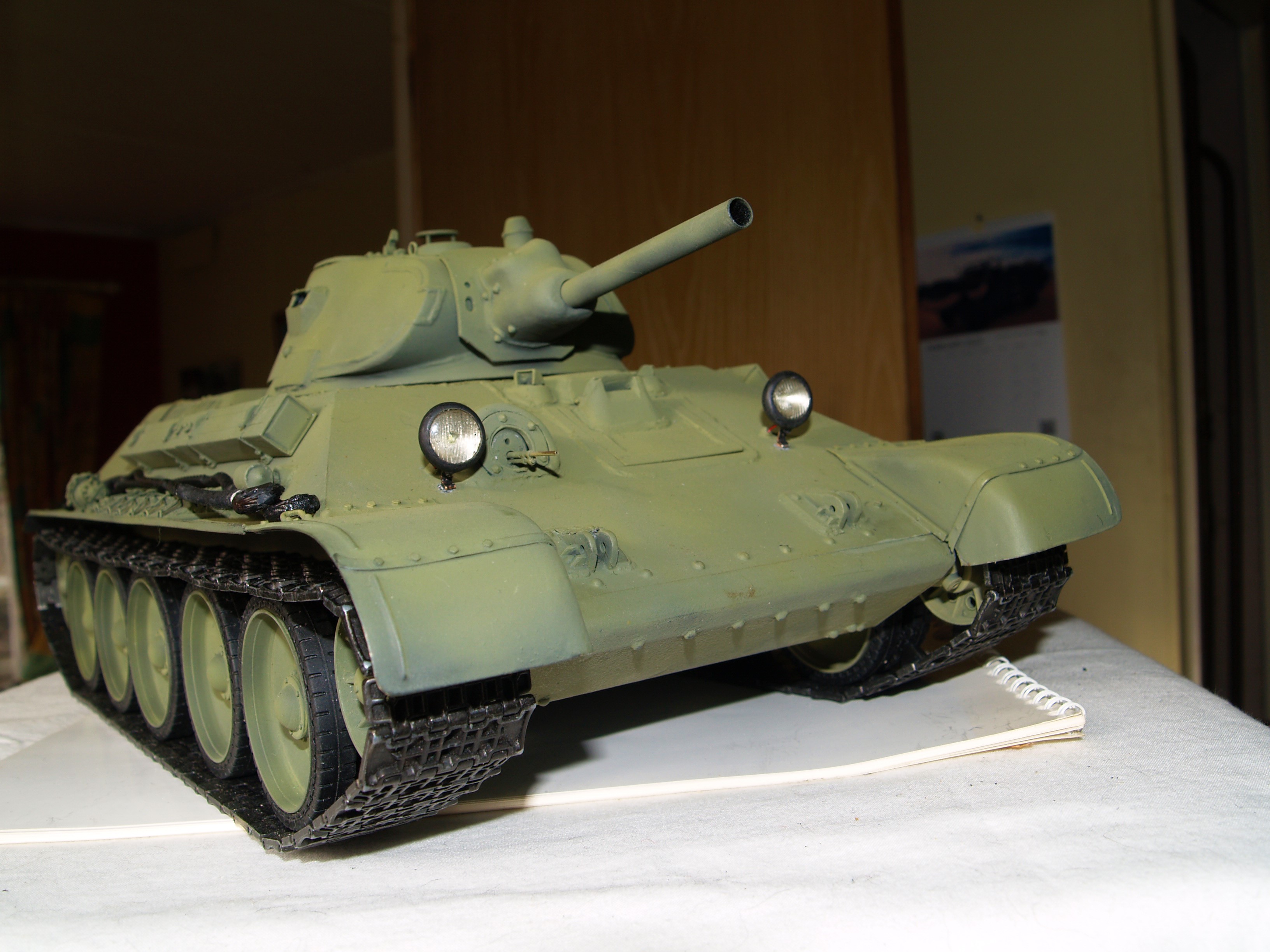

At last , The weather has improved so I can get a base colour on -
(The headlights are going to be left black , as they appear to have been simply taken from existing motor pool stock.)
- Yay , progress !
- Yay , progress !

Maaaagnificent
if ever you decide you will part with that for export, look me up Sir !!
Re: T 34 L-11 1940 w.i.p.
Definitely jealous of that one.
