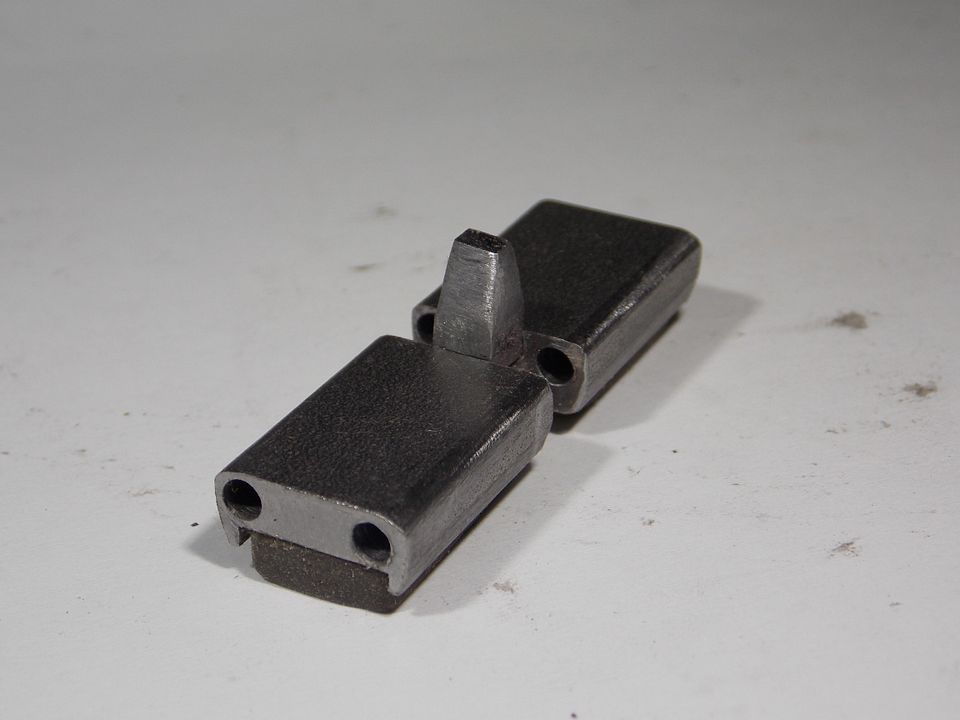

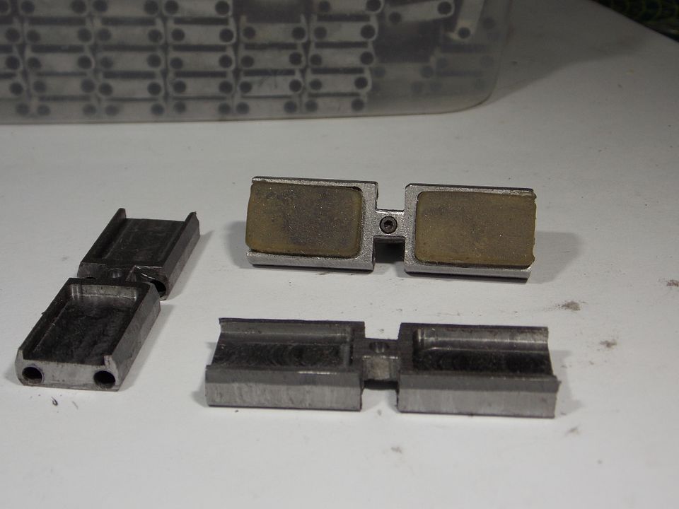

The tracks are made from mild steel, there are quite a few steps to make each one. I decided to fit the guide pin with a small screw. Obviously on the full size this would be a part of the casting.
Once the tracks rust up a bit this will blend in. The track pads are polyurethane rubber , the same material as the tyres. I ran out of pigment so my test pads are the natural rubber colour. I superglued them in place, they are firmly attached.
I now have to make another 140 or so guide pins, the first one was hand filed, I did make around 150 connecting links the wrong size :headbang: that was very frustrating to say the least.

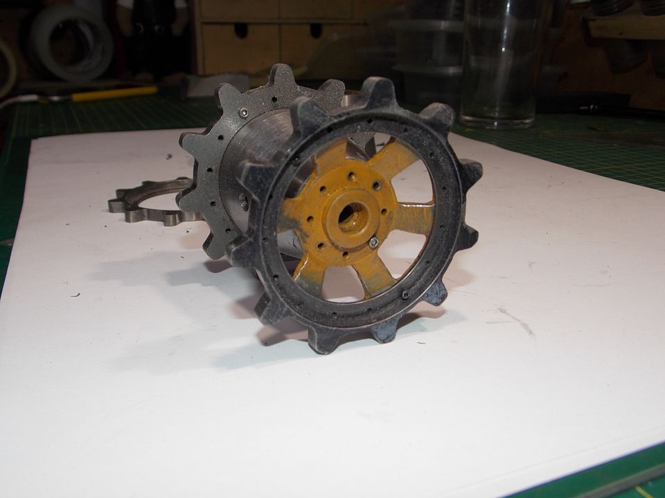

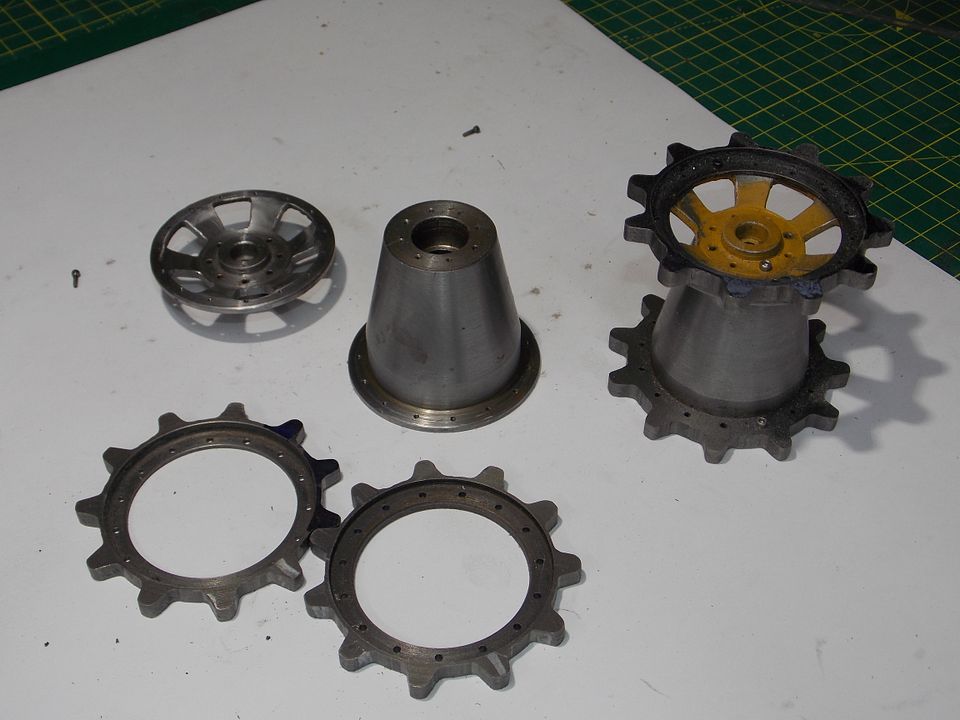

I made the drive sprockets . The webbed part that holds the front sprocket is not quite right . This is down to both my marking out and the rotary table I used to hold it. It was very cheap many years ago . They will do for now . The sprockets are made from cast iron, the tooth profile is not quite right , I did re cut two of them when I was starting to make the track links , next week’s job.
The hub is made from mild steel in two parts as per the full size.

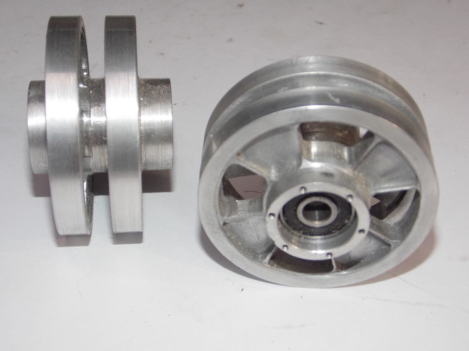

The idler is made from one piece of aluminium, the cut outs have the same issues as the web cuts outs I mentioned above. I will invest in a better rotary table when I build my next one.

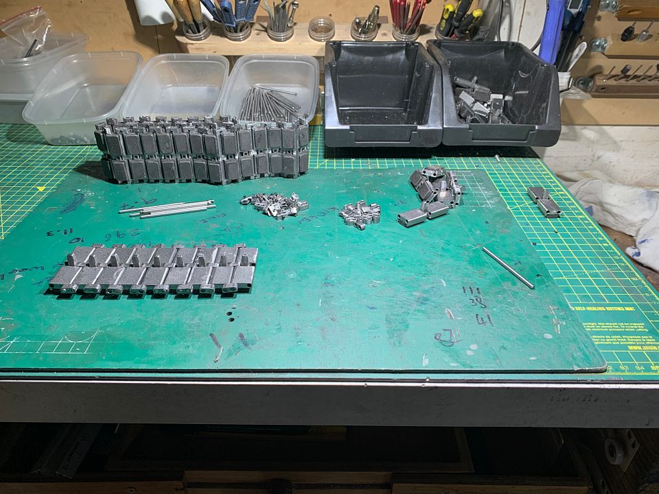

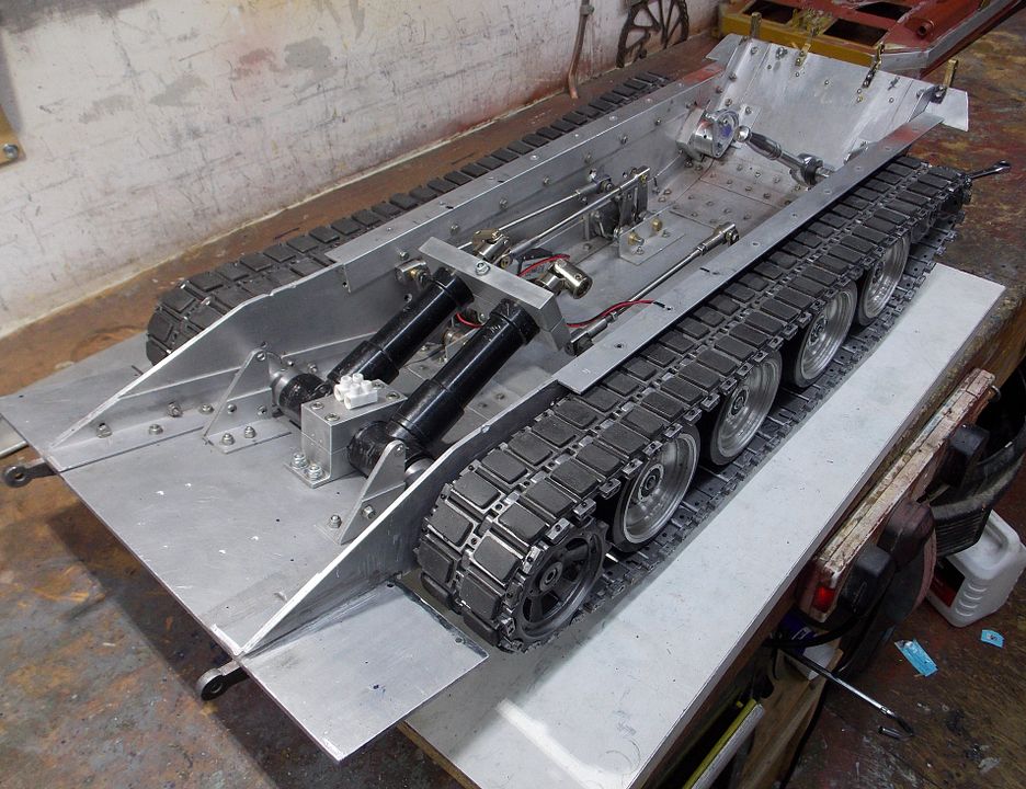

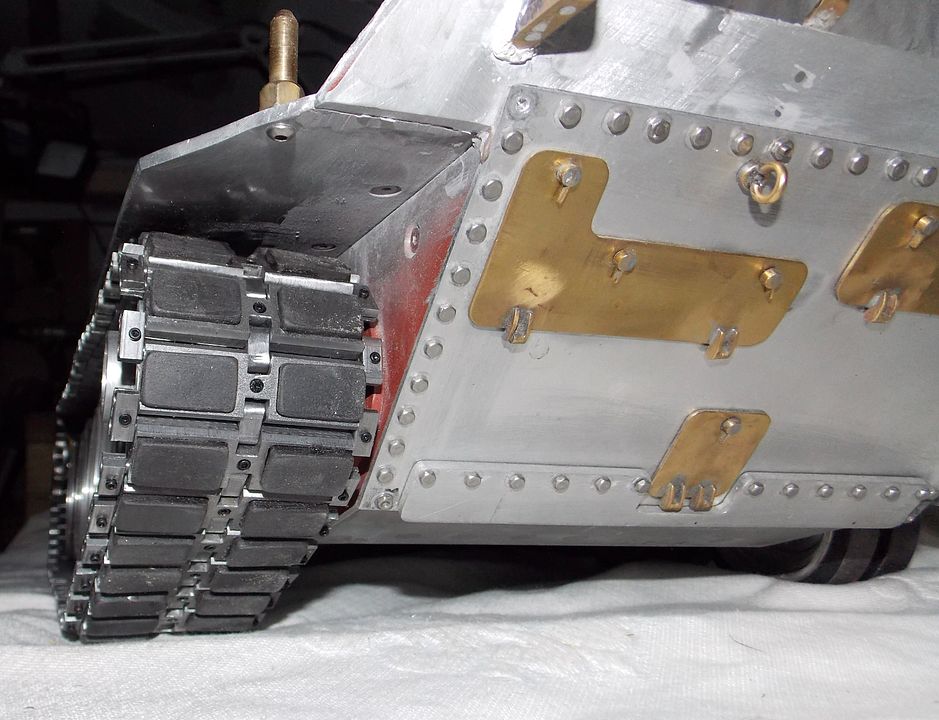

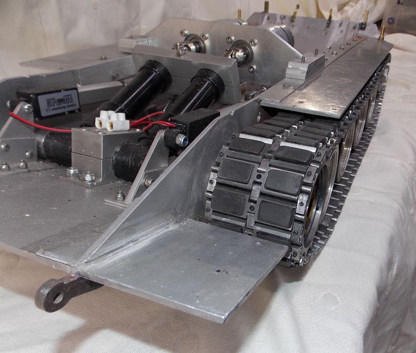

Thank you for your kind words , I have completed the tracks there were a few issues but overall I am happy with them. Each track weighs almost 2.5kg. I made them up over a few evenings quite relaxing and nice to finally get them made up after all this time and using up the hundreds of individual components I have been making for the past few months.
I have fitted the tracks. There are a few things and I need to rework. It would be a pity to rush the test run after all this time . I need better track tensioners and the drive sprockets need a bit of refinement. They work but can be a bit clunky. They are cast iron so Dremel should sort that out. That need I need to work on the dremel too. It’s starred to rev up and down and not keep a steady speed.
