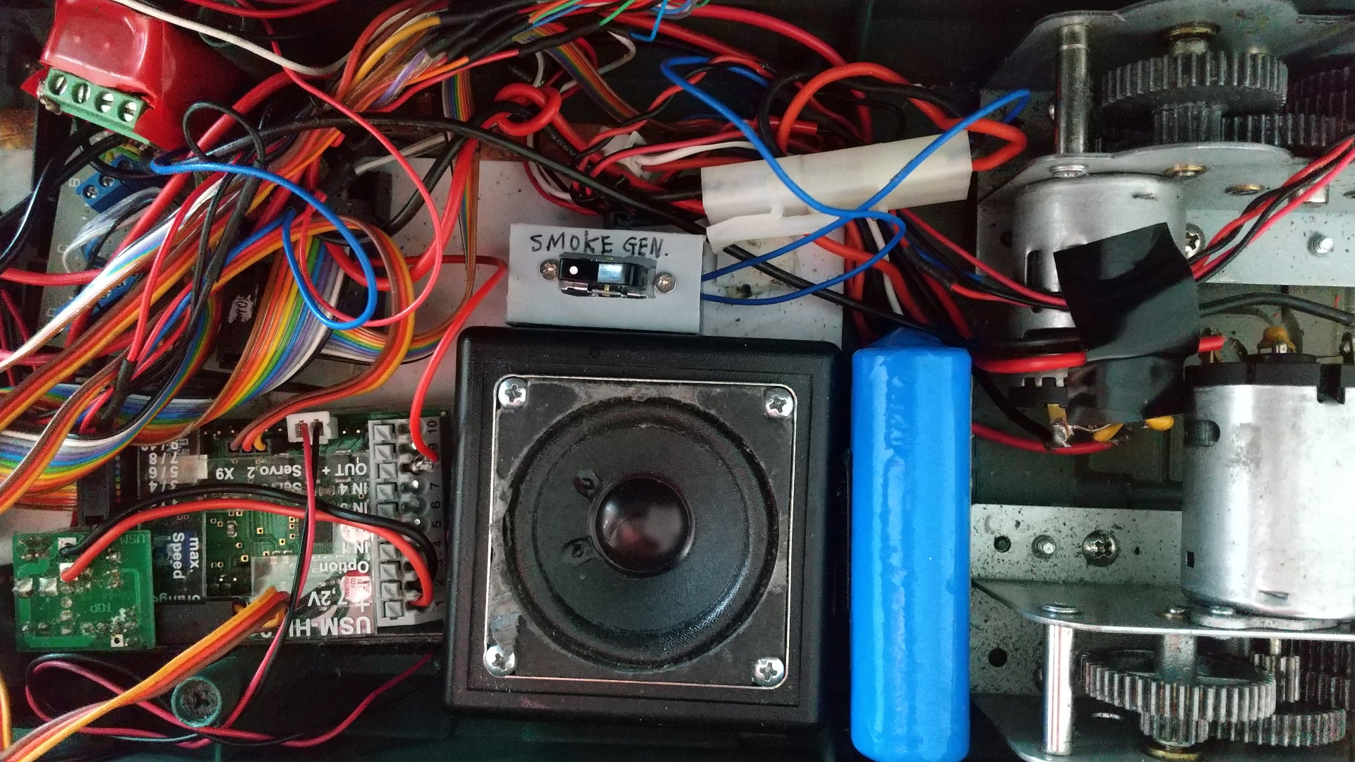

The heater part of HengLong stock smoke generator is relatively easy to break due to the fragile 0.1 mm diameter nichrome wire.
The heater of this T-90 tank was also broken, so when I repaired it, I replaced it with a 0.2mm diameter nichrome wire. I don't like to have a lot of smoke, so I think this amount of smoke is good.? Speaking of greed, I would like to change this reciprocating type pump to a fan type to eliminate the rattling noise, but this T-90 tank is difficult in terms of space.? Inside the under hull, a switch to turn off the smoke generator function was provided.

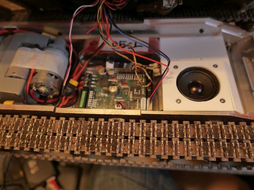

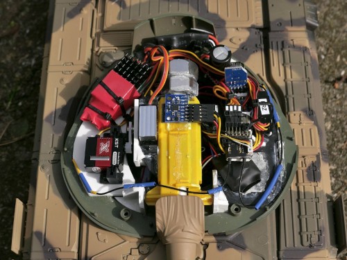

in the T-90 is enough room!
Here my T-90 with Beier SFR-1-D and PDSGB-Gearbox:
at the Turret is the Electronic for Barrel und Turret stabilisation:
The lights are alle functional same as your t-90...

Re: HengLong T-90 detail up
Nice. Impressive board and gearbox!

I am impressed by the array of lights and action you have packed into one tank! Indeed, the amount of electronics you pack into the turret is a show in itself. I'd like to know why the cannon lifts after it is shot. This seems often to be so with modern AFVs.
