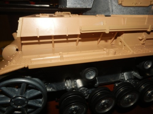

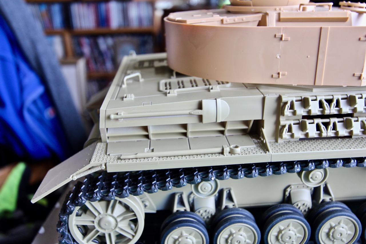

Tamiya have the ventilation louvres exactly right. You can also see the four hinged cover plates resting on the side fender (embedded actually). All very accurate.

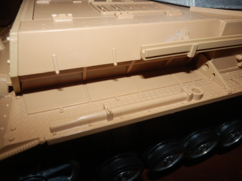

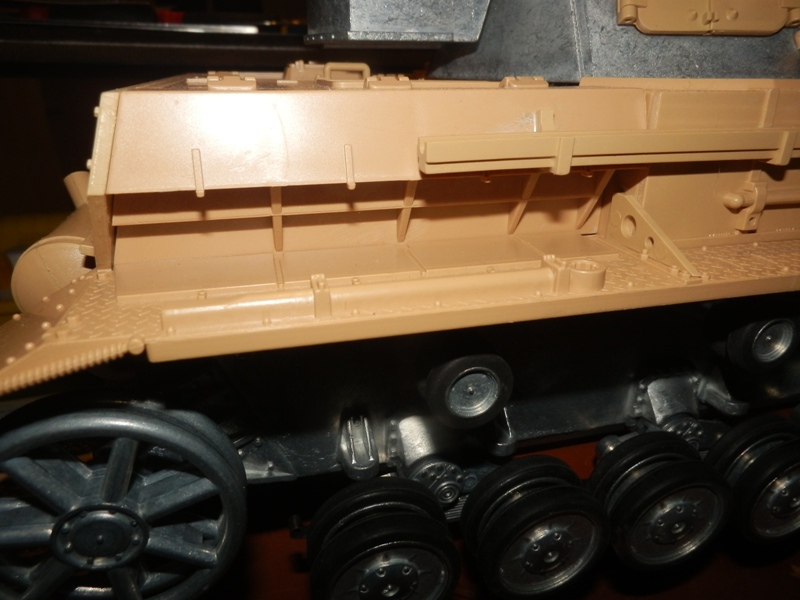

This then (below), is the point on the upper hull where the engine slope begins. On the Tamiya model, it starts about 26mm above the fender, and ends at around 23.5mm (extent of the slope), by the rear armour plate.
Tamiya Pz IV start point for the slope on the engine deck
I used these rough dimensions to mark out the angles of the slopes to be cut on the Asiatam hull.

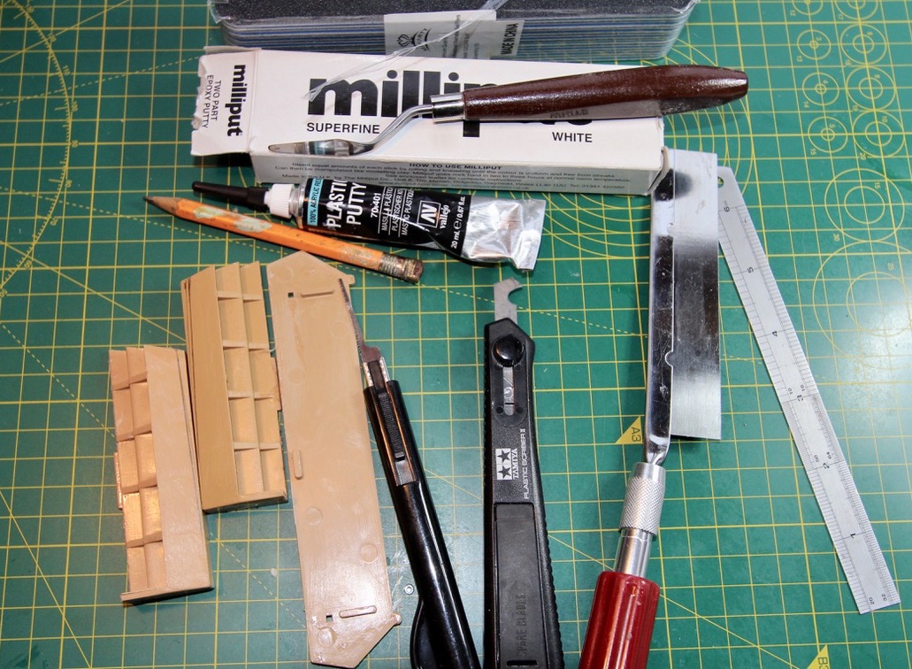

Here's the cosmetic surgical equipment I used on the Asiatam's erroneous angles.
Tools for Tank cosmetic surgery..

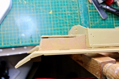

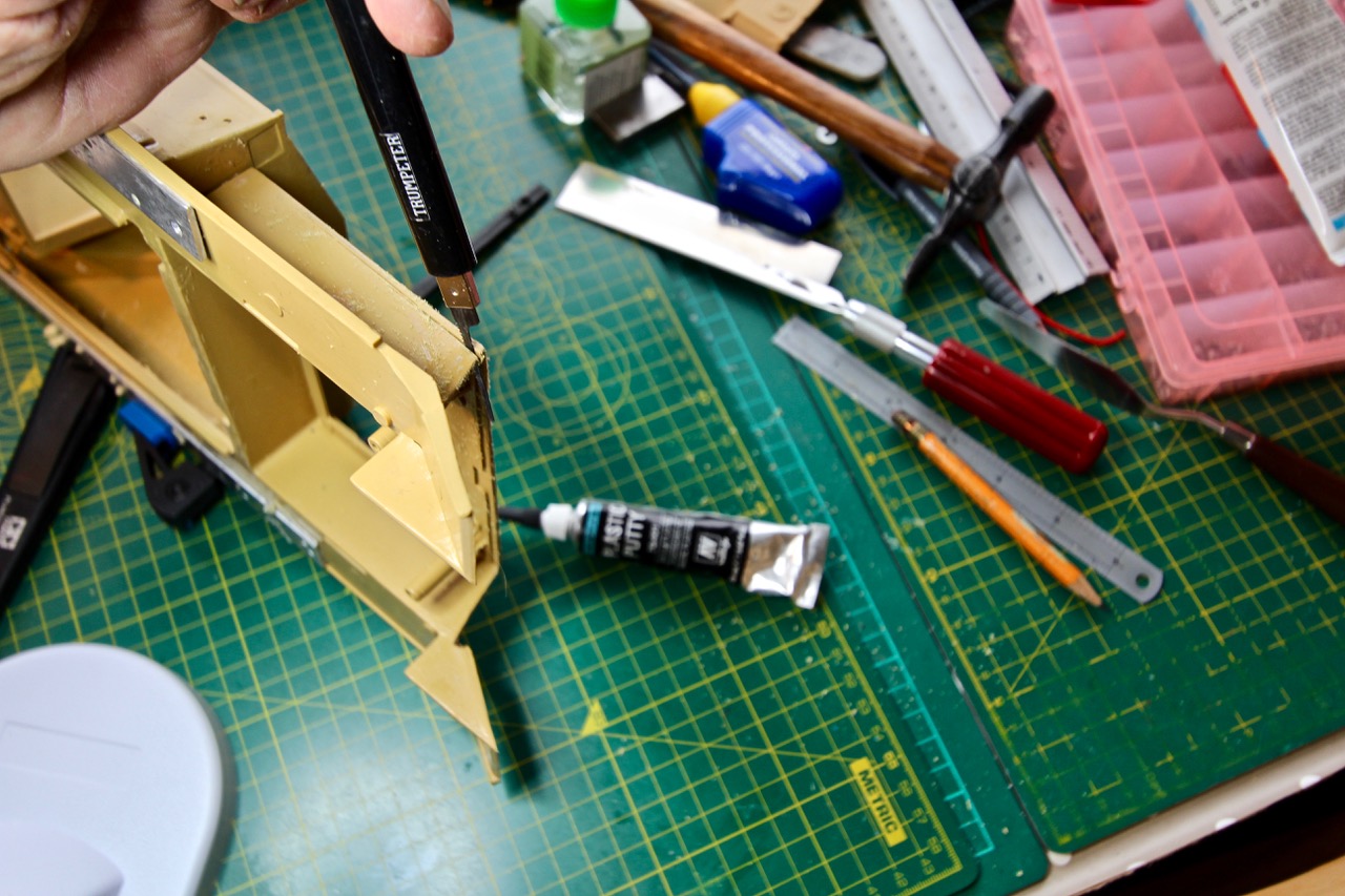

After removing the louvres and rear armour plate- very carefully,
I began to make the first cut in the hull.
Asiatam upper hull starting point for excision..
The Trumpeter razor saw is ideal for this.
Ditto with the other side:
Asiatam upper hull first cut
Then I used the Exacto Saw to straighten the cut out, and to mark a straight line (hypotenuse) for the triangular fillet I need to remove.
Creating a straighter cut with the Exacto saw

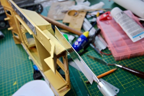

Re: Asiatam StuG IV conversion kit...
I'm aiming for a slice that roughly corresponds with that on the Tamiya Pz IV. This means that later, I shall have to slice roughly 2.5mm off the rear armour plate in oder for it to line up properly with the new slope on the deck and ventilators.
Here's the plastic fillet I'm about to remove from the right side.
Asiatam StuG.. slice to be removed from rear engine deck
After a bit of sanding to even it up, I bonded it with ABS glue, as it seems to need that. Ordinary cement and no impact. :eh:
I did the same to the other side,

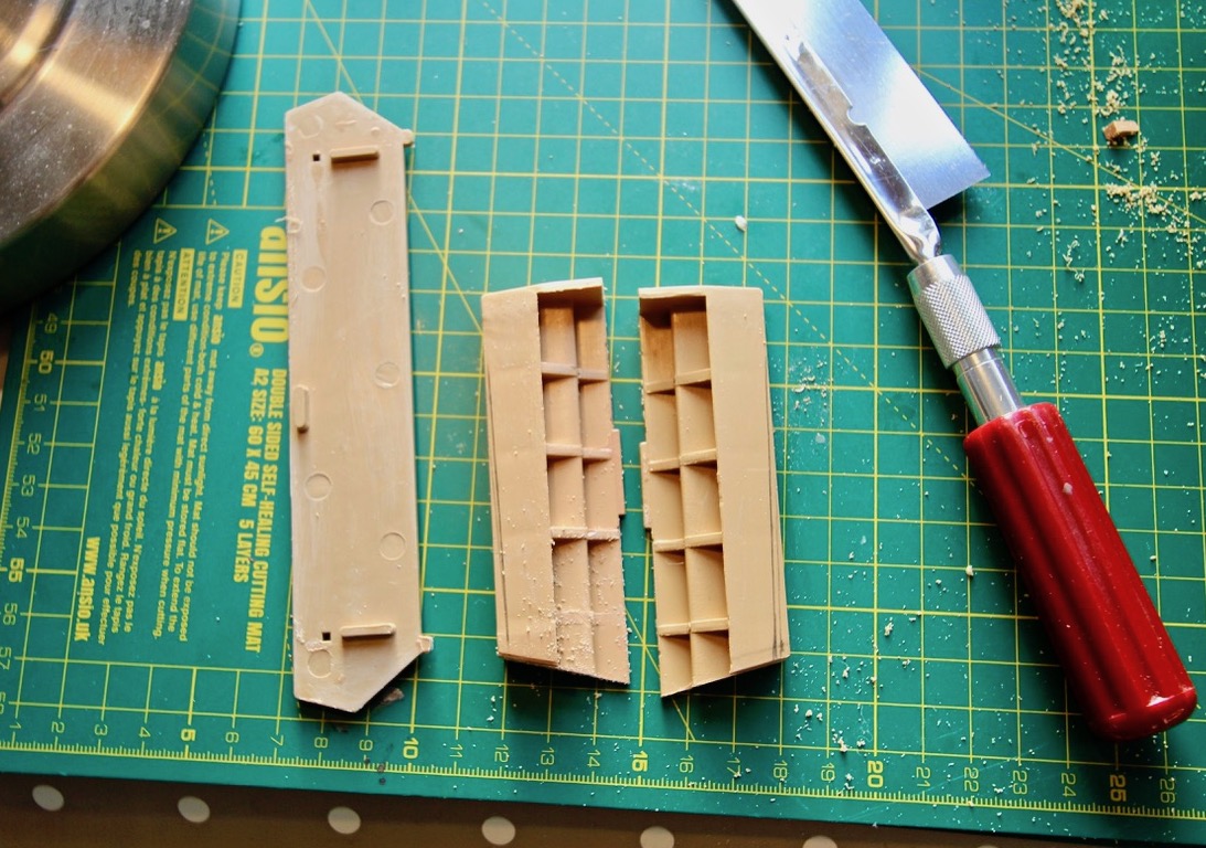

Asiatam StuG IV -removing rearmost louvre baffle
and then began to remove the rearmost baffle from the louvres, as that's the only concession to accuracy this badly conceived kit will permit. :(

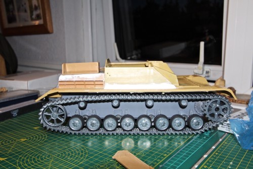

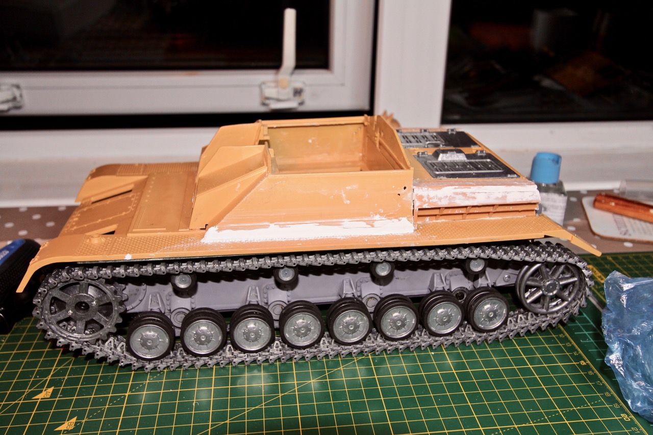

Next, I bonded the engine compartment ventilator units back in place. For this I used Plastic Fusion two part epoxy. If they'd been harder to remove in the first place, I think I would have opted for cement again :think: Plastic Fusion is the best epoxy I've encountered for use on models, though some guy giving a modelling master class on Youtube, also extols it's value. Maybe he gets a small gratuity from them.. :think: :D
Having given the bits time to settle in, I then began to fill the gaps I'd created with a mix of Milliput superfine, and Vallejo plastic putty. Milliput allows a little more pliable working time than Vj PP., but they're both good products. :thumbup:
Here's what the revised look amounts to:
Asiatam StuG IV- revised rear engine deck assembly
Here, I've placed the spare wheel box on the deck to demonstrate more clearly the slope I've created. I have to say, I'm quite pleased with the result. After all this effort, it's just as well. It definitely looks more like the real thing now..
Asiatam StuG IV engine deck slope and ventilator louvre fixes..

Frankly, if you have a Panzer IV- no amount of paint and weathering cannot compensate for this ever more obvious defect. Once one has noticed it, it's practically impossible to miss it, and on other models too... :|
The remaining upturn at the front disappears with clamp assistance and slight tension, proving that when I have a viable attachment system in place (like the front adaptor plate and catch sold with the quick release mechanism on the Tiger),
The silhouette will pass muster.. :thumbup:

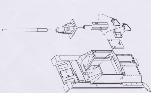

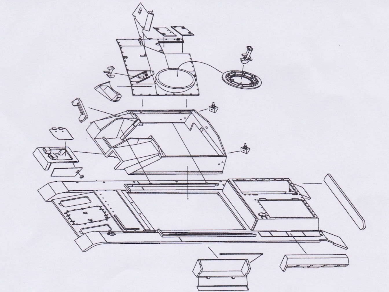

For anyone interested in buying this labour-of-hate kit (and to be fair, there are not many alternatives if you want a StuG IV.. :problem: ).. this is how the bits go together:
Asiatam StuG IV casemate and hull assembly
and the gun assembly:
Asiatam StuG IV gun assembly

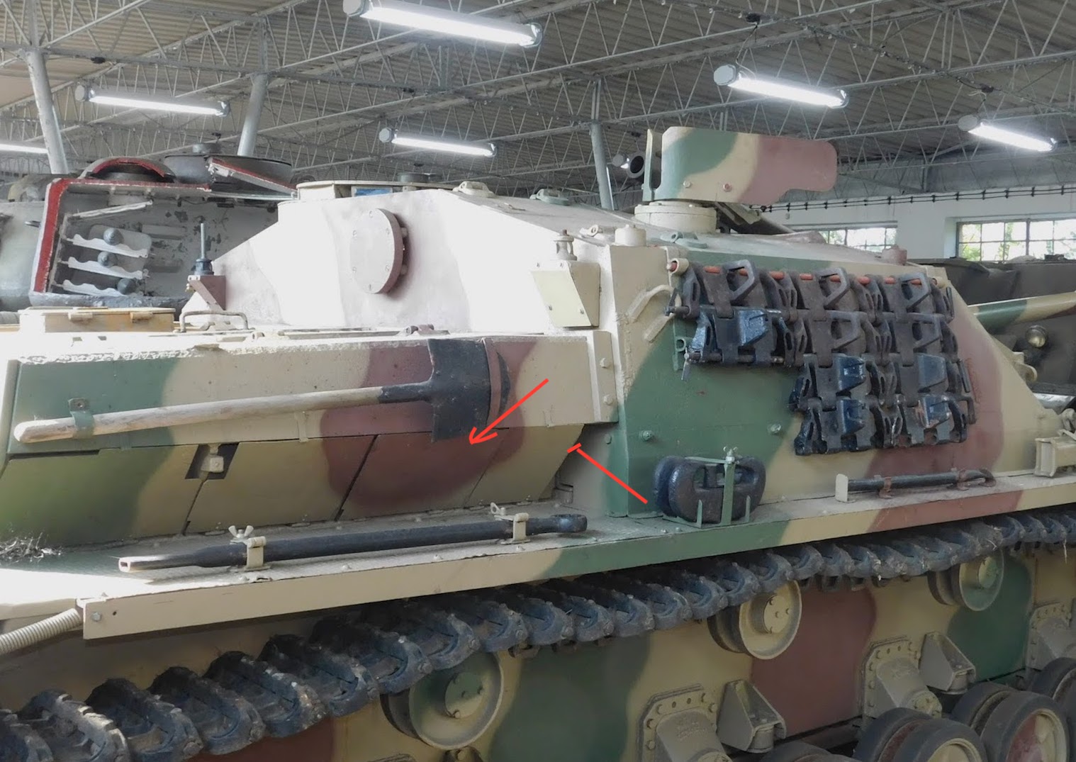

When building models it's sometimes hard to find good reference material- especially pics to support the build. The Golden Rule seems to be to get as many viable references as possible.
Here I found a fantastic set of walk around pics- 72 in all- showing practically every nut and bolt of the StuG IV. So, here's a big THANKS to Jacek Szafranski for taking the time and trouble to do it...wherever he may be :thumbup:
http://bigmodel1200.blogspot.co.uk/2012 ... round.html
Here's a sample of the walk around. Until I saw this picture, I'd never seen PZ IV with the plates/covers for the 4 intake louvres covered up. They are in this shot: :)
Stug IV with vent/ intake louvres shut
