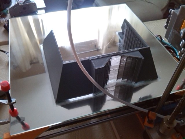

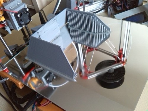

Jeez, Cura told me it was a 6 hour print job, I had already had one failed print, so had to spend time dismantling the hotend and de-clogging it. Time was running out...
I started the print again, and ramped up the print speed by 25% thinking that would knock an hour off at least. Six and and half hours later, and well past midnight, it finished. Thank Christ this one turned out as nature intended.
And added to the pile of parts.
I can now get on with the onerous task of designing the gun, and the rear interior, which is a lot of detail work, I need new glasses!!

Great progress Rob :clap: :clap: , the print time for flat parts is why I prefer to use styrene sheet, my nerves and intestinal fortitude could not withstand a six hour print :crazy: especially given my recent printer experiences.
Will continue watching the progress with great interest.
Alwyn :thumbup: :wave:

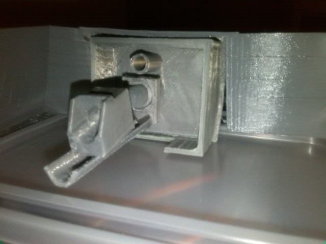

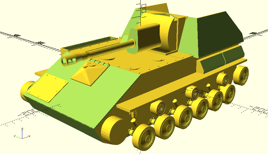

Designed the muzzle brake, barrel and mantlet. Took a bit of figuring out, but I got there in the end. Have now run out of filament on the printer I am using for large parts, so can't print the lower hull for a few days.

Impressive bit of drafting there, Rob. I've had a crack at OpenSCAD, but the parametric-driven nature goes right over my head since all of my experience is with CSG-based modelling. I'll have to try something else if I want to give these 3D-printing shenanigans a try.

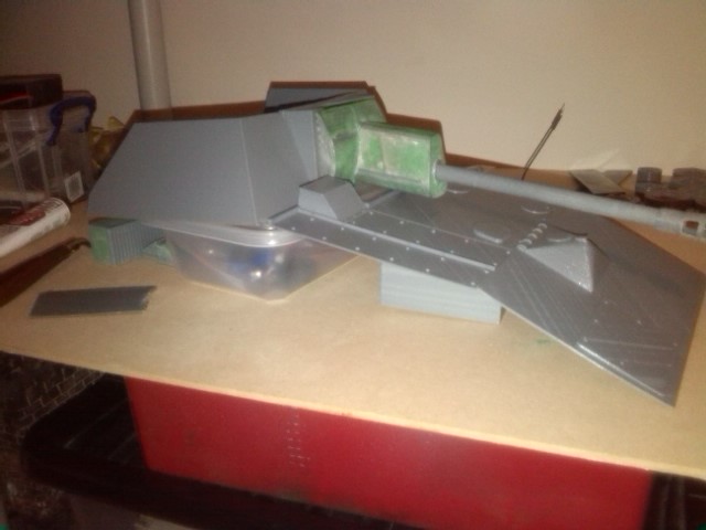

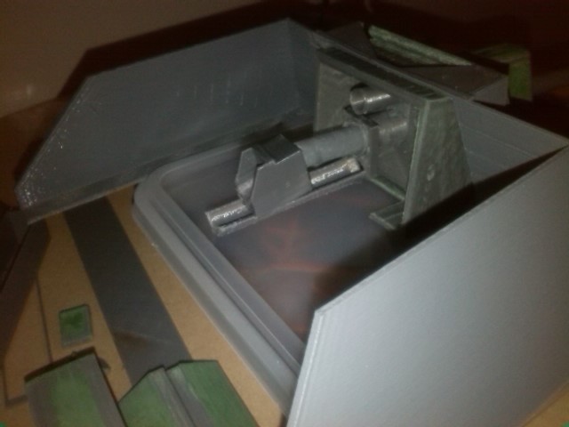

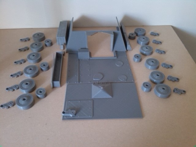

Apart from an averted catastrophe half way through the mantlet print, it is coming together. The barrel, mantlet, mantlet inner, muzzle, breech and shell loading tray are now all done. It's killing my eyes doing all these small parts, and staring at the screen. I need new glasses but I am too tight to buy them and can't be a**ed to drive to the opticians.
Waiting for a couple of bit and pieces to arrive and then I can start the lower hull, I may yet just print the sides, and make the base out of 3mm styrene. It's a 32 hour print otherwise for a complete lower... :crazy:
I have started to design the tracks, just as an experiment, I'll see how that goes... :O

Fantastic work Rob, I don't want to even try and guess how many hours CAD design time that represents, it's just scary! :crazy: 8O :clap: :clap:

Amazingly little coding, I am learning how to apply my old programming skills to Openscad, using loops, and hull commands etc I am also getting into looking at a photo, and converting the shapes into Openscad in my head, and at the same time visualising how to orientate parts to get a clean print and so on.
I never stop learning, it keeps my brain active.
