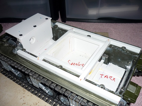

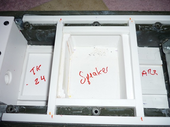

Good morning tom, as yet the battery has only been placed in position, but it seems to fit well in between the
gearboxes, its the li ion battery from my heng long Sherman, until the other day I didn't realise you could remove
it from its casing, thinking about powering the tarr on a 9v rechargeable radio battery and plug the fan in to the
tk24.

Engine bay ready for holes to be drilled for wiring and then a lick of paint

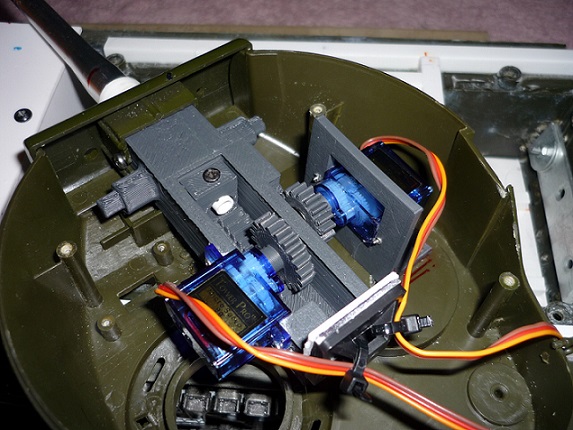

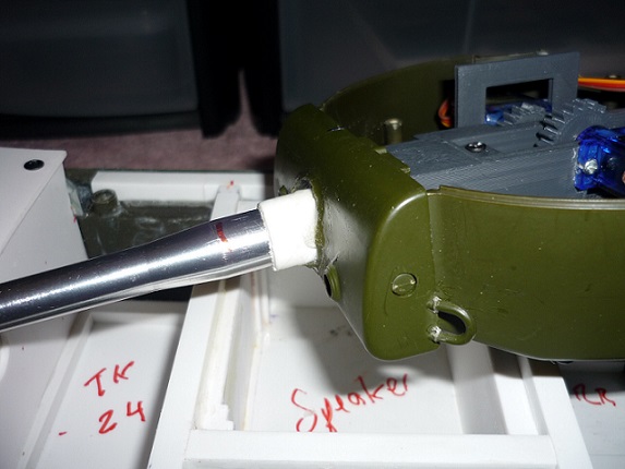

Servo/elevation unit supplied by rc tank electronics works beautifully, red line shows distance of travel

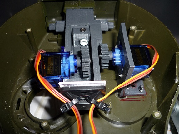

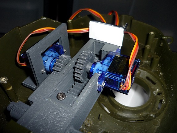

The servo recoil/elevation unit works very well and was easy to fit, the only problem I had with it was the fitter,
i spent 20 minutes trying to reverse the recoil direction following the instuctions on the clark website, to reverse
it 2 blinks on the led, tried over and over, then realised the servo was already reversed :{ 1 blink and all was well.
