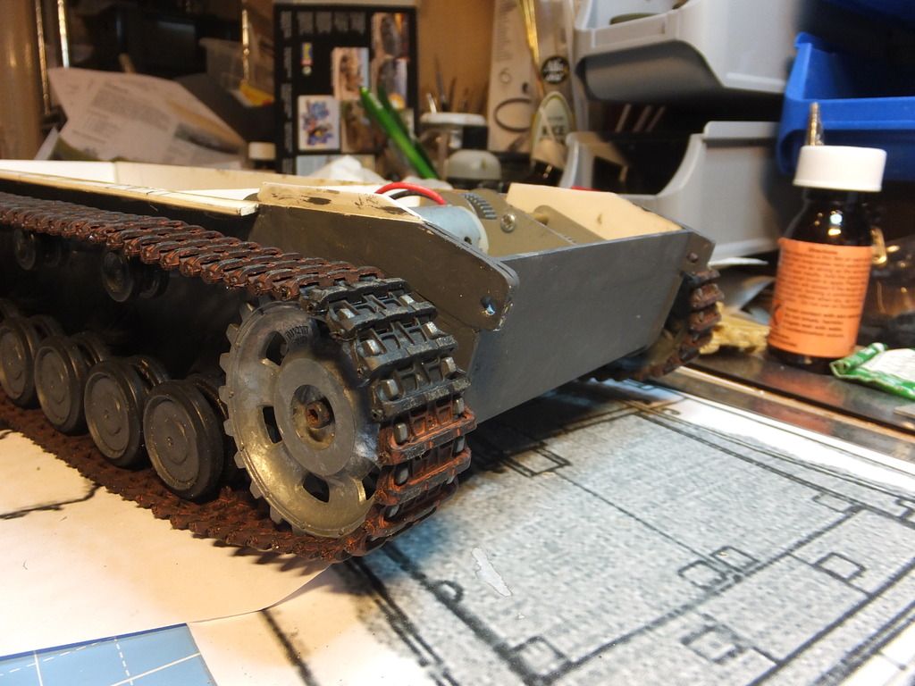

Modified the front of the hull to raise lower glacis and modify the tow points from Panzer IV to Nashorn
Before:
And after
There is now plenty of space to raise the gearboxes if needed but after reviewing the pics I think the positioning is about right, might be a few mm low but not enough to warrant stripping everything and building new mounts.

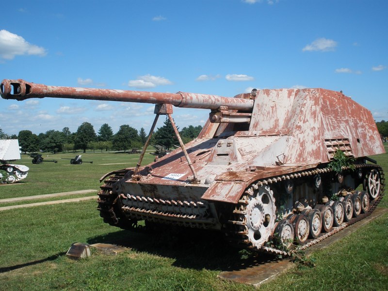

I saw this in the APG Maryland in '2010...............looks better now than it did when I saw it.
