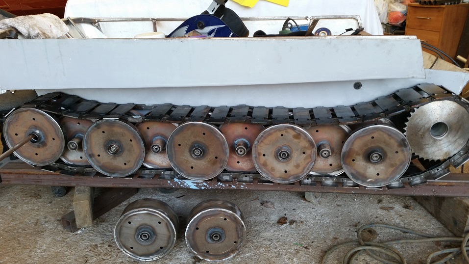

Re: 1/4 scale Tiger 1 (as a driving model)
This is a pictures from a while ago of the hull but its further along now. still needing a lot more detailing though.
