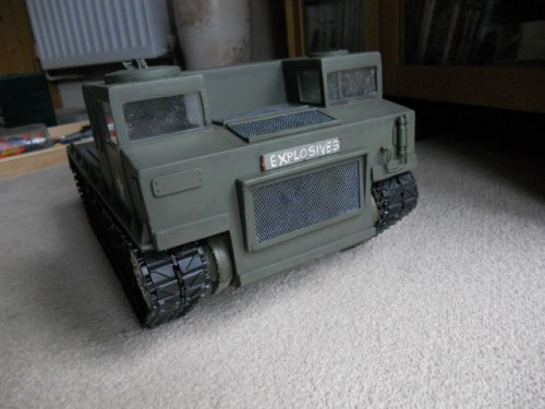

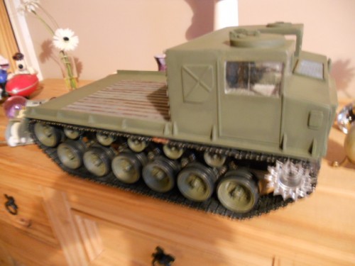

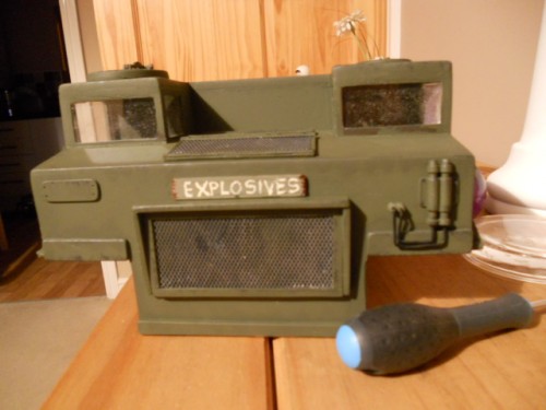

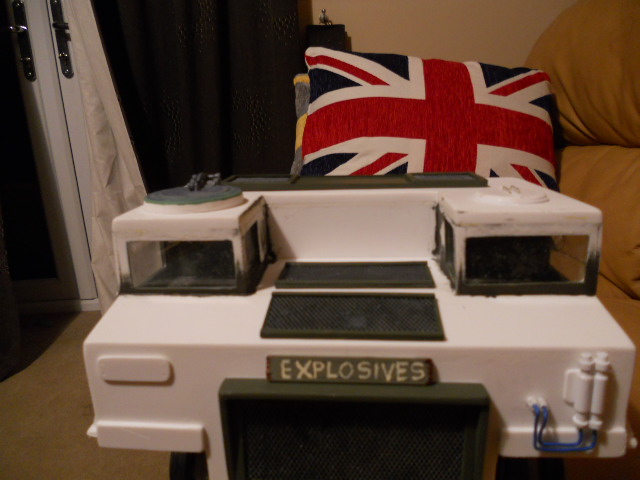

And just to show that I don't take Sundays off, lol.
Roof vent done, will have to await the arrival of the styrene tube before I can do the exhaust stacks.
Also did a plank, with 'Explosives' painted on it, just because I can... :D

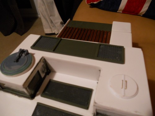

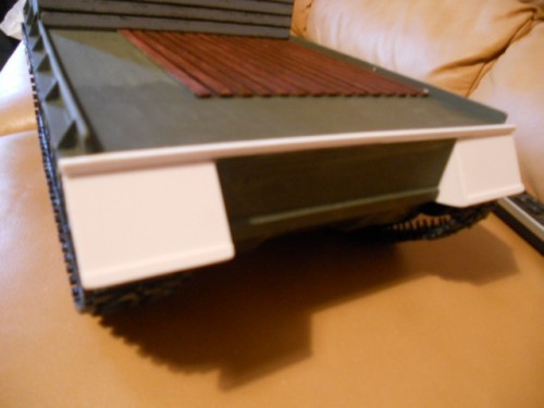

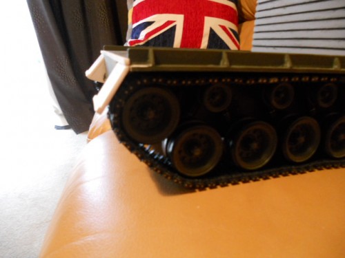

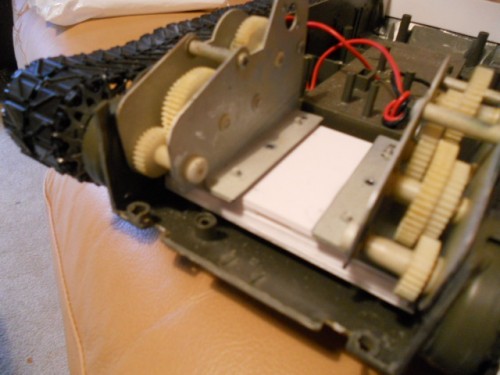

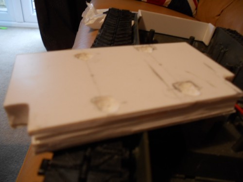

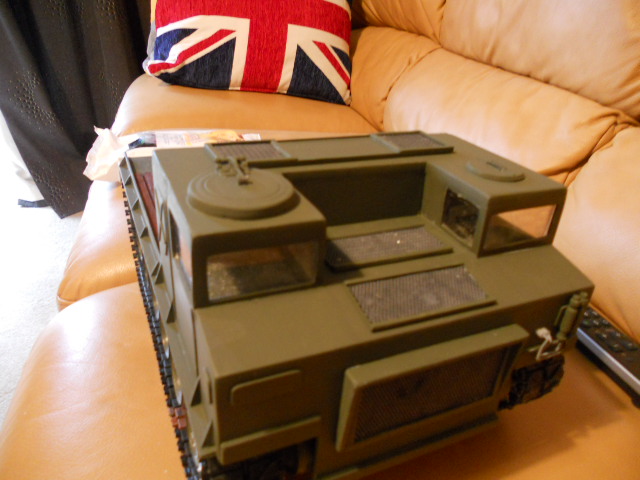

A bit more done, brush painted the upper hull to get a good basecoat on, though I have been airbrushing it today.
The motor mounting plate has been hot glued in, it isn't the tidiest way of doing it but it is the easiest way to get a rock solid mount.

This is the bit I enjoy the most, getting to work with the airbrush. Will post more pics as it progresses. I use an airbrush rather than weathering powders as it seems to work for me.

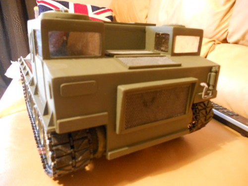

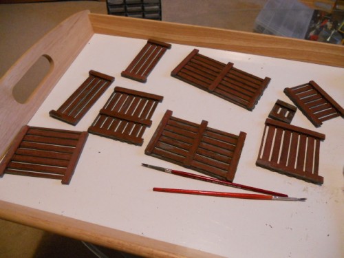

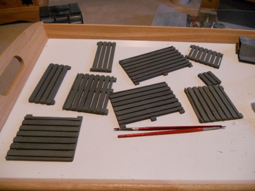

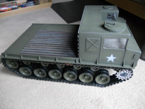

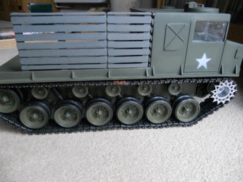

Its a long story but I decided that the mahogany effect on the rear slats was out of keeping with what I wanted it to look like. After numerous mixes of paints and different shades I eventually settled on a pale green, with a hint of grey.
I have also been doing some shading and whatnot on the upper hull, and adding a few scuffs.
There are two ways to shade, one is to apply a dark colour in recesses and edges and then apply the lighter coat over it. The other, the way I did it, was to spray the hull green, and then add a few drops of black, then spray over the top of it, that way I end up with two tone green.
I do scratches by putting two very small pools of black and silver on a piece of kitchen foil. then mixing them a bit at a time. Touch the edge of the brush against edges on the hull, and immediately dry brush spots. It will turn to a slightly burnished bare metal colour.
I made the stencil for the star by simply cutting the one out of the HL decal sheet. I use off white rather than pure white as it gives that ready dusty look.
I will add the final dusting coats after I have done the lower hull.

Got to hand it to you mate - the wood work(thats not actual wood) is bloody amazing !!
I guess now you will be busting to build a 'Long Tom' to tow behind it !

The woodwork was a chore to do, but more time consuming that anything else, but its quite strong doing it this way. If I was doing it again, I would go straight to using normal acrylic paint rather than use the woodgrain as it would be easier to get the required colour. The actual grain is etched into the styrene, so it will look like wood no matter what I paint it with.
