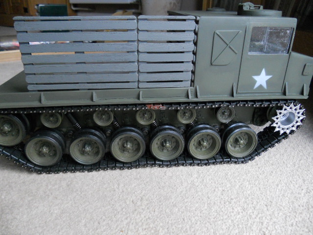

Its a long story but I decided that the mahogany effect on the rear slats was out of keeping with what I wanted it to look like. After numerous mixes of paints and different shades I eventually settled on a pale green, with a hint of grey.
I have also been doing some shading and whatnot on the upper hull, and adding a few scuffs.
There are two ways to shade, one is to apply a dark colour in recesses and edges and then apply the lighter coat over it. The other, the way I did it, was to spray the hull green, and then add a few drops of black, then spray over the top of it, that way I end up with two tone green.
I do scratches by putting two very small pools of black and silver on a piece of kitchen foil. then mixing them a bit at a time. Touch the edge of the brush against edges on the hull, and immediately dry brush spots. It will turn to a slightly burnished bare metal colour.
I made the stencil for the star by simply cutting the one out of the HL decal sheet. I use off white rather than pure white as it gives that ready dusty look.
I will add the final dusting coats after I have done the lower hull.
RobG
Posts: 11382
Re: M8E2 Cargo Tractor
Got to hand it to you mate - the wood work(thats not actual wood) is bloody amazing !!
I guess now you will be busting to build a 'Long Tom' to tow behind it !
wibblywobbly
Posts: 6396
Location: South Wales Valley
Post by wibblywobbly »
The woodwork was a chore to do, but more time consuming that anything else, but its quite strong doing it this way. If I was doing it again, I would go straight to using normal acrylic paint rather than use the woodgrain as it would be easier to get the required colour. The actual grain is etched into the styrene, so it will look like wood no matter what I paint it with.
I forgot to mention above that I always use Vallejo Model Colour paint. I hand brush it undiluted, and airbrush it with at least 50-60% water. A bottle goes a long way. Airbrushing is done at 20psi on the compressor, but I have an airbrush that allows me to adjust that down even further with an adjuster, plus its a dual action airbrush so I can adjust it again with fingertip pressure. They can be bought at Everything Airbrush, its in the AB range, they are made in China and I have used mine for years without problems. Needs a regular clean though as Model Colour paint is designed to be fast drying, so if the reservoir on the airbrush goes empty while I am pumping air through it, the paint dries in the airbrush, and starts clogging things up.
