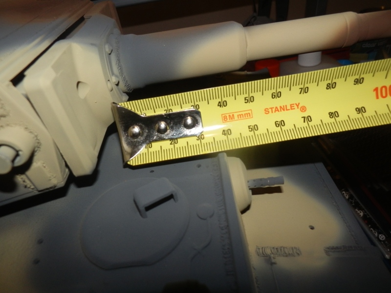

Lets call this "turret-gate" but i cannot see how on gods green earth I can move my turret back half an inch. :wtf: :wtf:
Could we have a simple case of mistaken assumption ?
By my calcs, and the measurements I have on mine, we are looking at a distance of 608mm in full scale. From the front of the drivers glasis to the mantlet face at the nearest point.
Thats 38mm in metric (scale actual) or 1 1/2" imperial(scale actual as pictured)
Thoughts ?

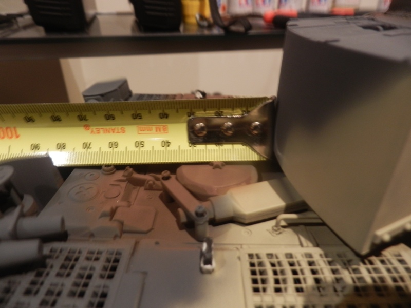

I have 21mm from the turret stowage bin face to the centre of the engine air filter cover.
Reducing that by 13.5mm or half an inch would put the stowage bin abvout covering the engine deck handles.
Lieutenant-General
Posts: 12019
Re: Early Tiger 1 my first build
woops, forgot pic
