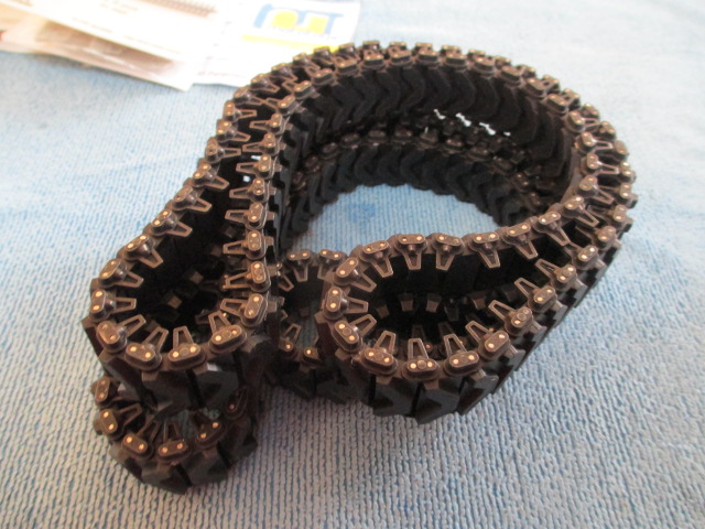

A parcel arrived from the UK and had some goodies in it for all of my American armor. The tracks are for the current build and the resin .50 cal ammo belts and cans will benefit 'Maxene', my HL Pershing and Taigen Walker. 'Maxene' is coming up on a mini redo here soon with some black steel gears and an idler mod I got the skinny on from Sassgrunt on the slate. I'll use this resin ammo and can to dress up her sweet Tamiya .50 cal at the same time. The Pershing will be getting a nice redo down the road which will include the black steel gears and this resin and one of the Tamiya .50 cals. ( I am really sold on those things ;o) and new paint. The Walker will get the same new gears and the new MG and details. The paint on it is from Taigen and excellent already. Tonight, I added a single link to the new tracks to bring them to 77 links apiece. I did this because the old tracks at 76 links were too tight and would have worn out the gearboxes with any serious use. I have new Mato running gear as well that was bought for 'Maxene' and not used. That along with these tracks will be a nice bit of kit to add to 'In The Mood'... Pictures:
New tracks for the M4A1

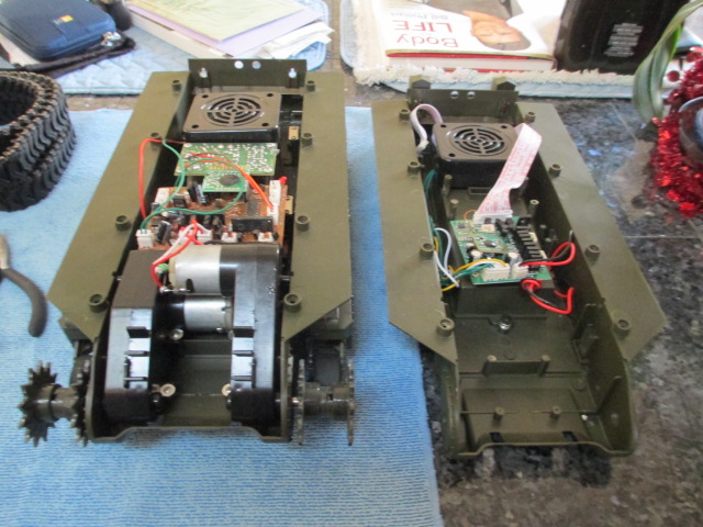

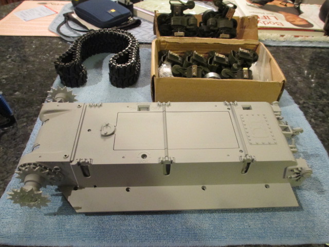

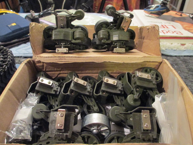

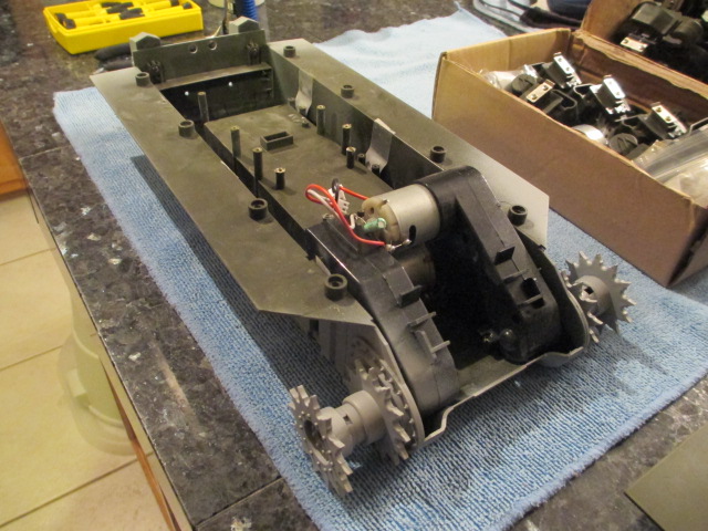

Nothing in the Post today but plenty yet to do. Tonight I removed the bogies and stock electronics from the lower hull and prepped it for priming. I added back a couple of pieces of the rear bulkhead and switched out the worn idler mounts for the new ones on the other lower. I primed it then using the same excellent Tamiya Lt. Grey that I used on 'Maxene'. Pictures:
Original bogies and road wheels next to the new set
Cleaned out and primered lower hull

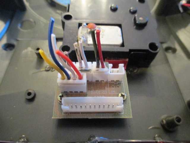

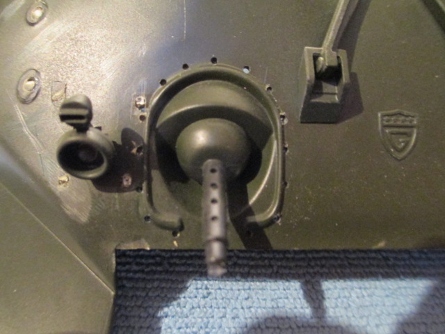

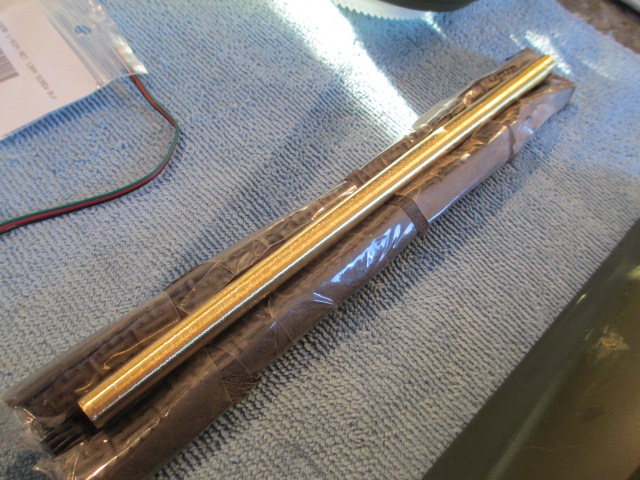

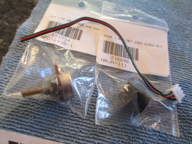

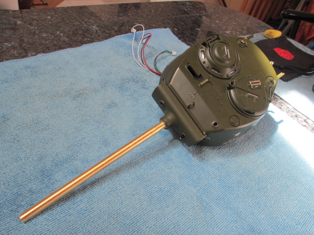

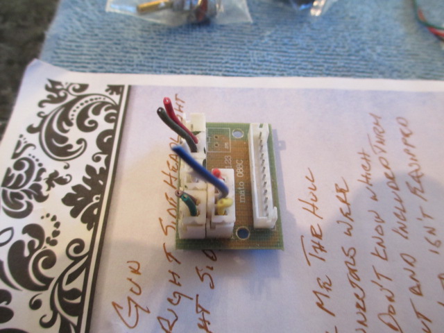

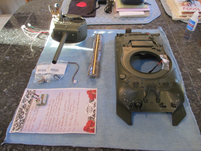

Some serious goodies in the Post tonight. From Alpha, I received a turned brass barrel for the M4A1 to replace the aluminum and plastic sleeve one on the tank now. I also received the bridge board for the cable plug in from the 2.4 GHz set in the lower hull. This piece is rare as Hen's teeth (at least it was for me) and it was very kind of Alpha to turn it over so 'In The Mood' would work. From Immortal Hobbies, I received the most serious looking Sound Pot I have ever seen. It will be mounted so opening a hull hatch will allow one to adjust the sound. Tonight, I am zipped from a social weekend so I managed to take pics of the new booty received and drill out the holes around the bow .30 cal mount for the pins a canvas cover would be mounted on. Pictures:
Holes drilled with a number 61 for the studs for the bow mg canvas cover.
Holes drilled with a number 61 for the studs for the bow mg canvas cover..JPG (99.84 KiB) Viewed 2953 times

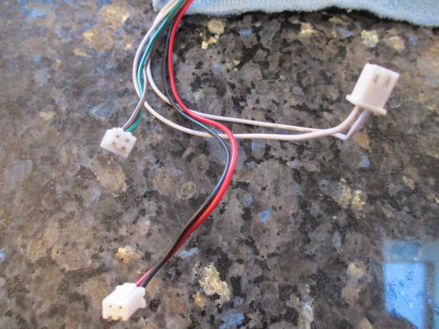

New main gun comes with the right pin plugs for the bridge board
Older 3 pin for the lights and mg instead of 4 pin plug like the port on the new board requires.  This will take some thought
Older 3 pin for the lights and mg instead of 4 pin plug like the port on the new board requires. This will take some thought.JPG (77.79 KiB) Viewed 2953 times
Bridge block mounted with 2 pin plugs in their places.  The empty is for the turret rotation
Bridge block mounted with 2 pin plugs in their places. The empty is for the turret rotation.JPG (95.96 KiB) Viewed 2953 times
A serious Potentiometer

A beautiful turned brass airgun barrel  to replace the out of scale two parter that the M4A1 comes with
Bridge block for the 2.4 GHz set.  A hard to find piece.

Posts: 10960
Re: Crazy Joe's Sherman Rehabilitation
Post by ALPHA »
Glad you got the parts Painless... I kind of forget if I listed the color codes on that four pin connector I think I did... the thing about the Mato that I found was that red doesn't mean it was "hot"...also the machine gun was hooked in series with the left headlight ...so one side had no wire at all...suffice to say it was pretty odd ..I had to rewire everything adapting the Heng Long system in mine
Hopefully on your end the solution will be as simple...
Good luck my friend :thumbup: :thumbup:

I thought I had better put up some pics on the work I managed last night. Alpha, It should be simple now that I have your notes and a pic of which wire goes where on the 2.4 GHz hull. ( Should be) Thank you, again, my friend. Pictures:

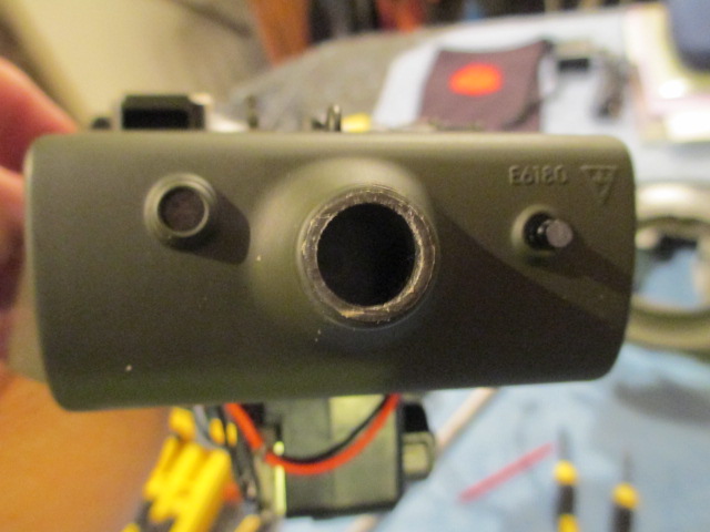

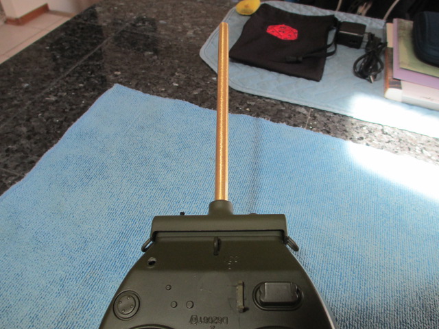

Turret reassembled with new barrel and airgun mechanism and .30 cal mg installed and drilled.  Also a clear rubber disk was installed behind the original LED mount.
The collar was cut from a section of the plastic outer barrel and sanded and glued into place after the brass barrel was mounted

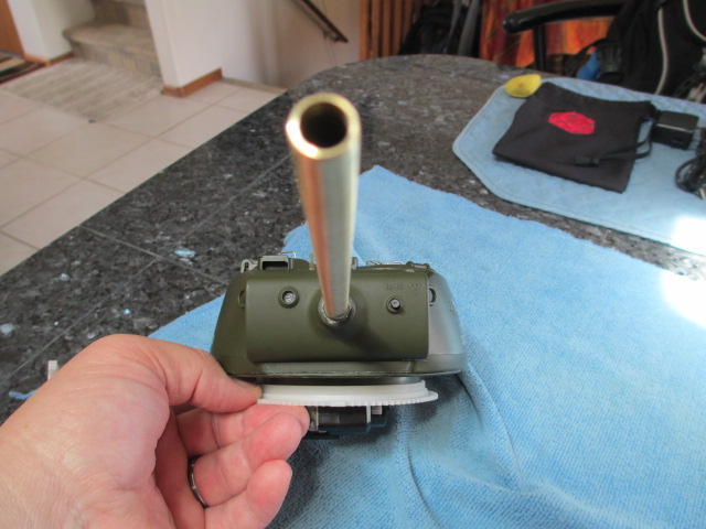

Also required was a plastic collar to glue inside the mantlet barrel mount to keep the brass barrel centered and wobble free
Also required was a plastic collar to glue inside the mantlet barrel mount to keep the brass barrel centered and wobble free.JPG (81.01 KiB) Viewed 2938 times
Mounting the brass barrel required a trimming of the rubber ring that slides over the airgun barrel breach
I had trouble with keeping the LED attached so I made a collar for it to be glued into from the end of the main gun's outer barrel
I had trouble with keep the LED attached so I made a collar for it to be glued into from the end of the main gun's outer barrel.JPG (82.33 KiB) Viewed 2938 times
Tested with the LED from the airgun warning light glued on the inside of the shield and a light source behind it
Tested with the LED from the airgun warning light glued on the inside of the shield and a light source behind it.JPG (95.21 KiB) Viewed 2938 times
