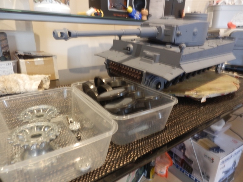

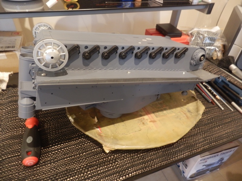

Lieutenant-General
Posts: 12024
Re: "WHITE TIGER"
So, it begins in earnest.
My first venture into the secret realm of the inside of one of these.
Have got steel roadwheels and other goodies on order, have got metal headlights & hatches to fit now, and I hope some other bits & pieces that can be dealt with at the same time.
Broke the tracks using a spare pin and a small hammer to drive the fitted pin out.
Pulled the caps off the drive sprockets & removed.
Removed all the roadwheels & set about the idler. This is glued togehter. So it can stay for now until the new ones arrive.
I can say this is looking less like a mighty beast of war than a new addition to the Panzer Wrecks literature series, 8O

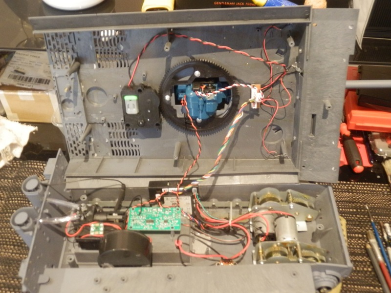

Lieutenant-General
Posts: 12024
Re: "WHITE TIGER"
Got into the heart of the beast. Seems its manufacturers got jiggy with the cyanoacrylate on everything. Anything the cyno missed was covered in motorcycle chain lube from the steel gear set. Good to know they wre thinking of my long term happiness, but the crap is all through the switches & reciever plugs. :(
I will make some form of splash guard for the gears as I still want to keep them lubed. Thinking of running a small hose from inside the drivers & radiomans working metal hatches through the splash guard to dripp feed the gears.
Made an initial effort to relocated the aerial to its correct spot, but again, the cyno-man has earned his keep. I might try using a soldering iron to conduct heat through the brass base to maybe get it free.
Will set the smoker tubes into a better position, but again, the fixed exhaust caps will not be ideal to flow the smoke solution into the unit. Pains me to say but the only real option is to branch the two tubes together & access the tract through the rearmost filler cap on the engine deck. This is of course assuming I can muster the patience to do so.
