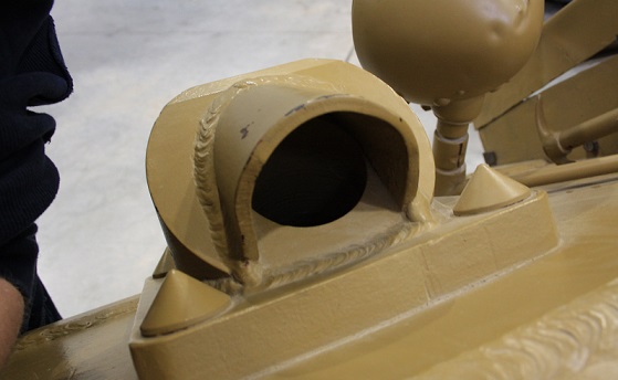

Next up the 'breather hoods'. As you can see in the picture below the 'hoods' are right at the bottom of the frontal armour plate. This is a problem when it comes to adding a weld bead across the front of the tank, so i decided to remove and reposition them.
Again i used a doctored razor saw to separate them.
This picture illustrates the before and after positions. For a more accurate model the 'hoods' need moving up and outwards.
Here i've removed the curved structure at the top of the 'hood' and added the 'breather' hole. The front edge of the plate needs sanding square as it isn't sloped on the real thing.
Plastic tube was attached to remake the top of the 'hood' with an open end, as shown.
