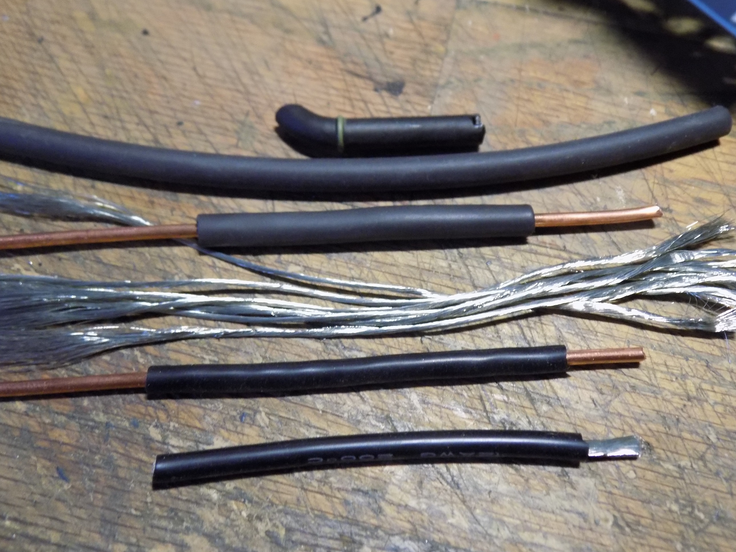

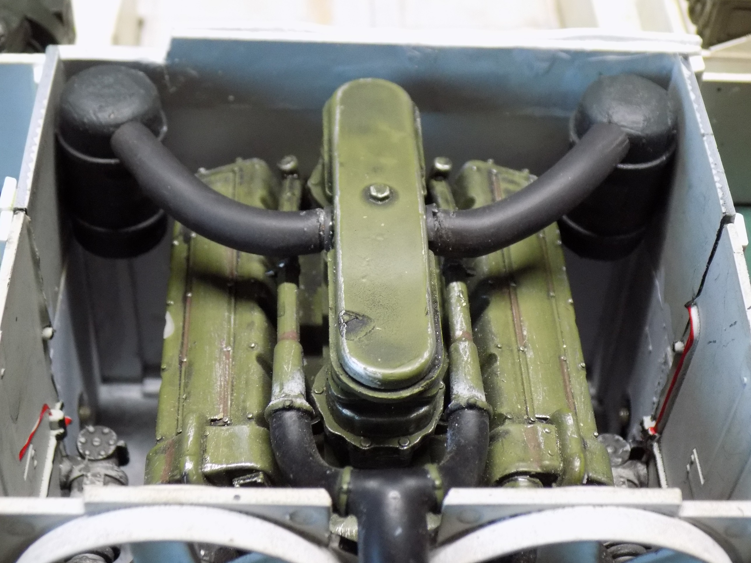

Added some air cleaners to the towed M4A3. Needed to come up with poseable tubing...
Pulled the silicone cover from some battery leads, slipped the cover over some copper wire then added some shrink tube to increase the diameter a bit (and it adds a natural rubber look over the shiny silicone).

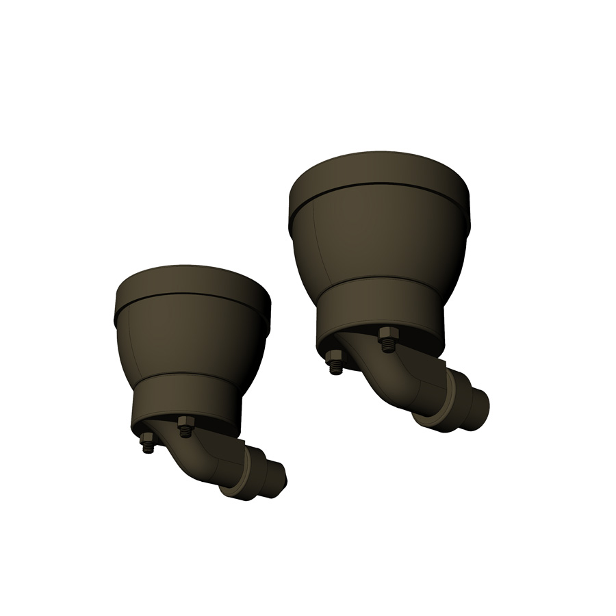

Great engine and details. I've been working on air cleaners too (but the square ones !)
My parts for 3D printing :

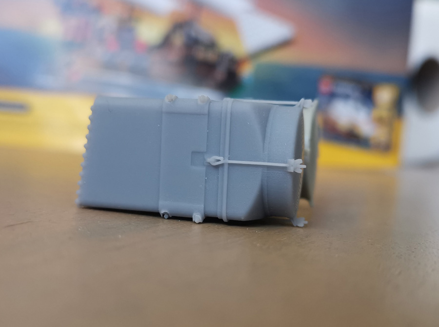

They are better than the Tamiya's ones for sure. They are oversized and lacks details...

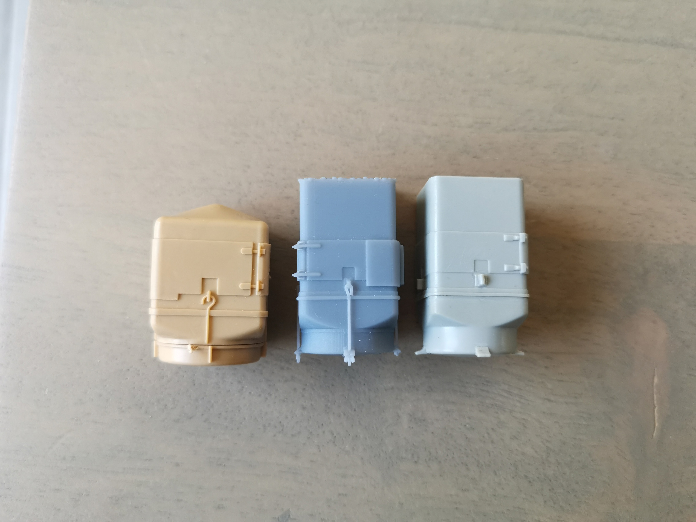

Here's a comparison, Tamiya/my 3D printed ones/not used parts from the I Love Kit M4A3E8 (which doesnt have those kind of air cleaner)
You can see some kind of steps in extreme close-ups, those are not resin layers but every step is the size of a pixel, this is actually the pixel matrix of the screen. I really need to buy another printer with a 6K or 8K screen to get ride of them even if they are not noticeable after a coat of primer a light sanding.

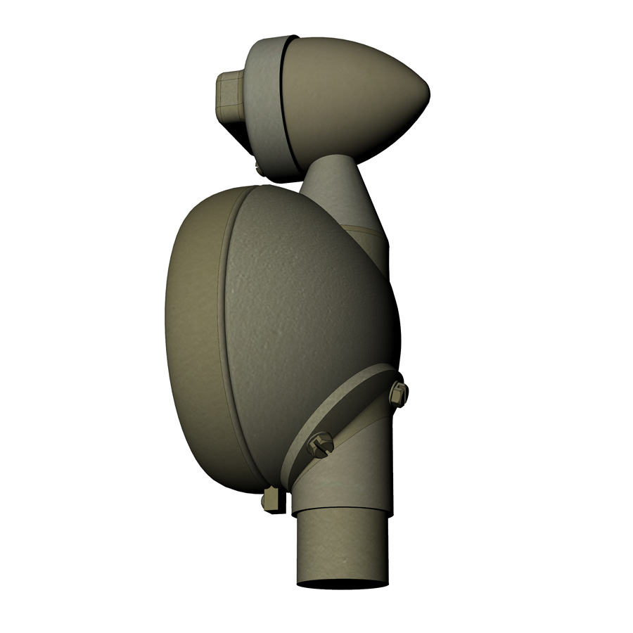

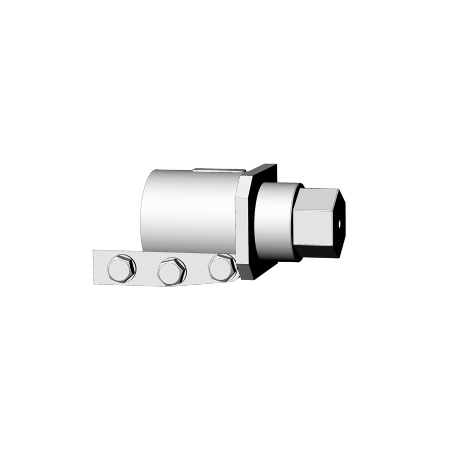

I don't have access to my lathe and mill right now, only my CNC and 3D printer so I'm 3D modelling a lot of sherman parts ! I think I will end up modelling every parts ever made for the Sherman haha.
Here are some of them :
I will try to print the lens with clear resin.
The track tensioner are meant to replace the HL part with slight modifications.
