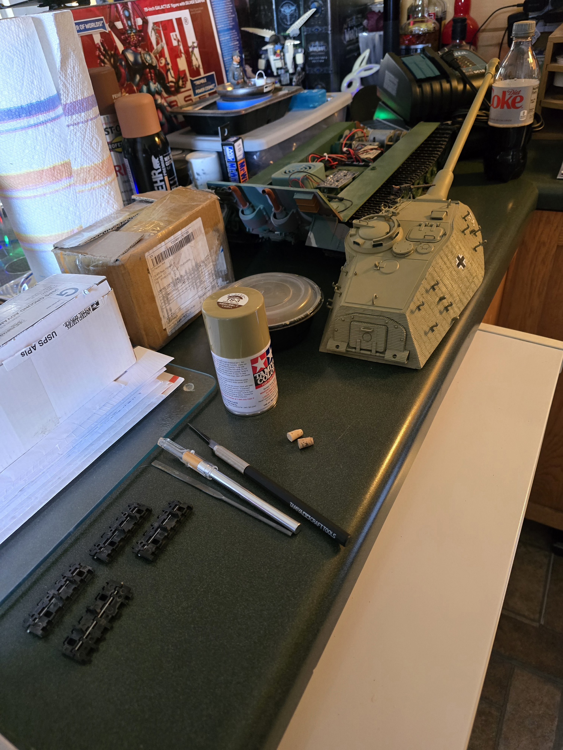

Good Afternoon,
Getting on with the KT Turret bits that I had overlooked. Screw holes in the bottom front of the turret were filled with 2 mini corks sliced to size and touch up painted. Onto the spare tracks. I am using four of the plastic ones (am sure that the few metal spares that I have will be needed sometime for track link replacements) and sanded and then filled the pin marks with 5 minute epoxy. Painted them then sanded lightly. Looks much better so hung them and used new pins to secure them in the track mounts. That started me on the last mounts for the Tow Cables for the Upper Hull, (as they did not come with those just pegs to stick into slots provided on the Upper). I looked at cutting four of them off of the spare plastic tow cables set and modding them to work. I decided to use the Brass ones in the Voyager set and mount them securely with Loc-Tite Ultra Gel. I managed to get one built to test fit before lumbering great Thunderstorms took away my daylight. I'll finish the other three tomorrow and paint them. Nothing left for the turret and upper hull except weathering after that when the build is complete.

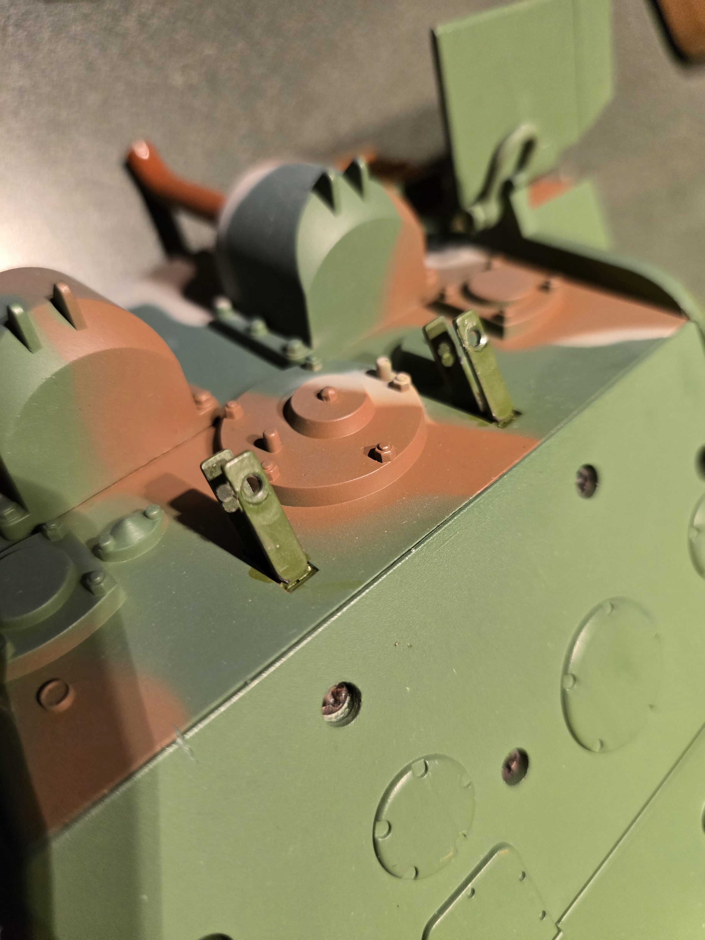

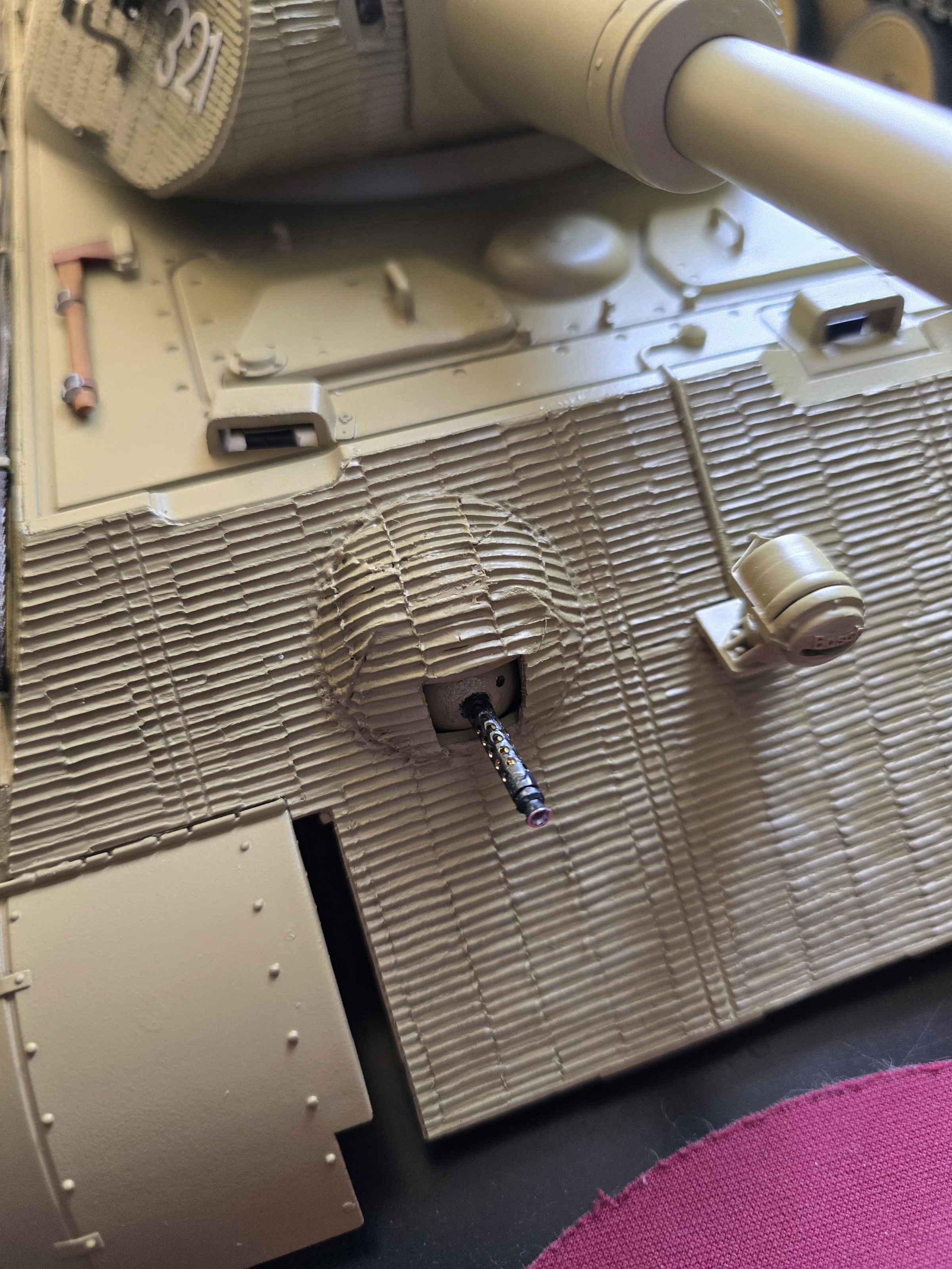

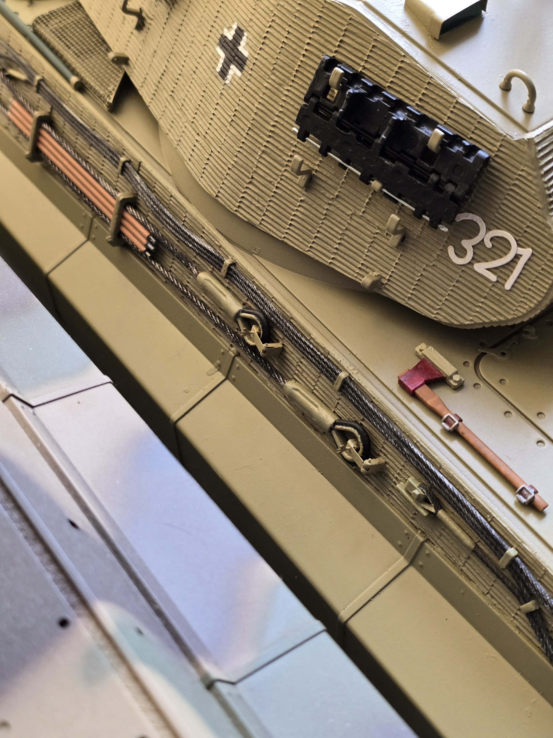

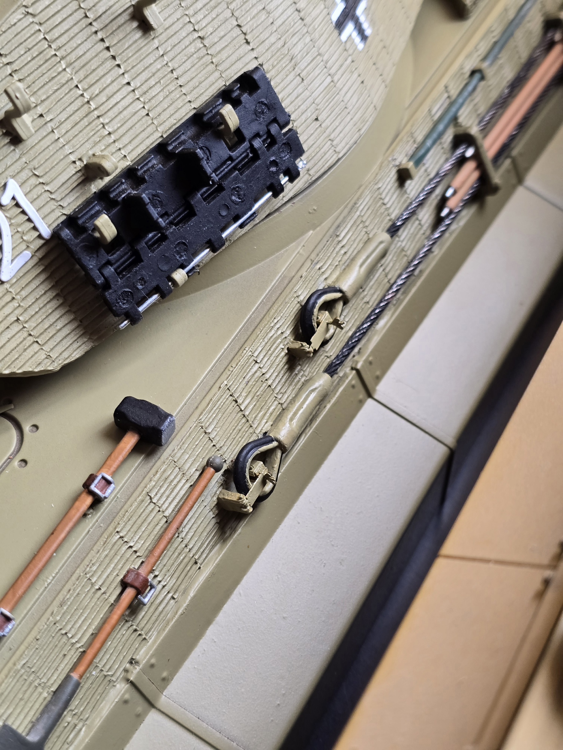

Good Afternoon,
A Pic from yesterday shows my build of the remaing Tow Hook Clamps. A couple of shots from this afternoon displays all the painted Clamps in place. A Pic of the Bow MG in paint rounds up today's work.

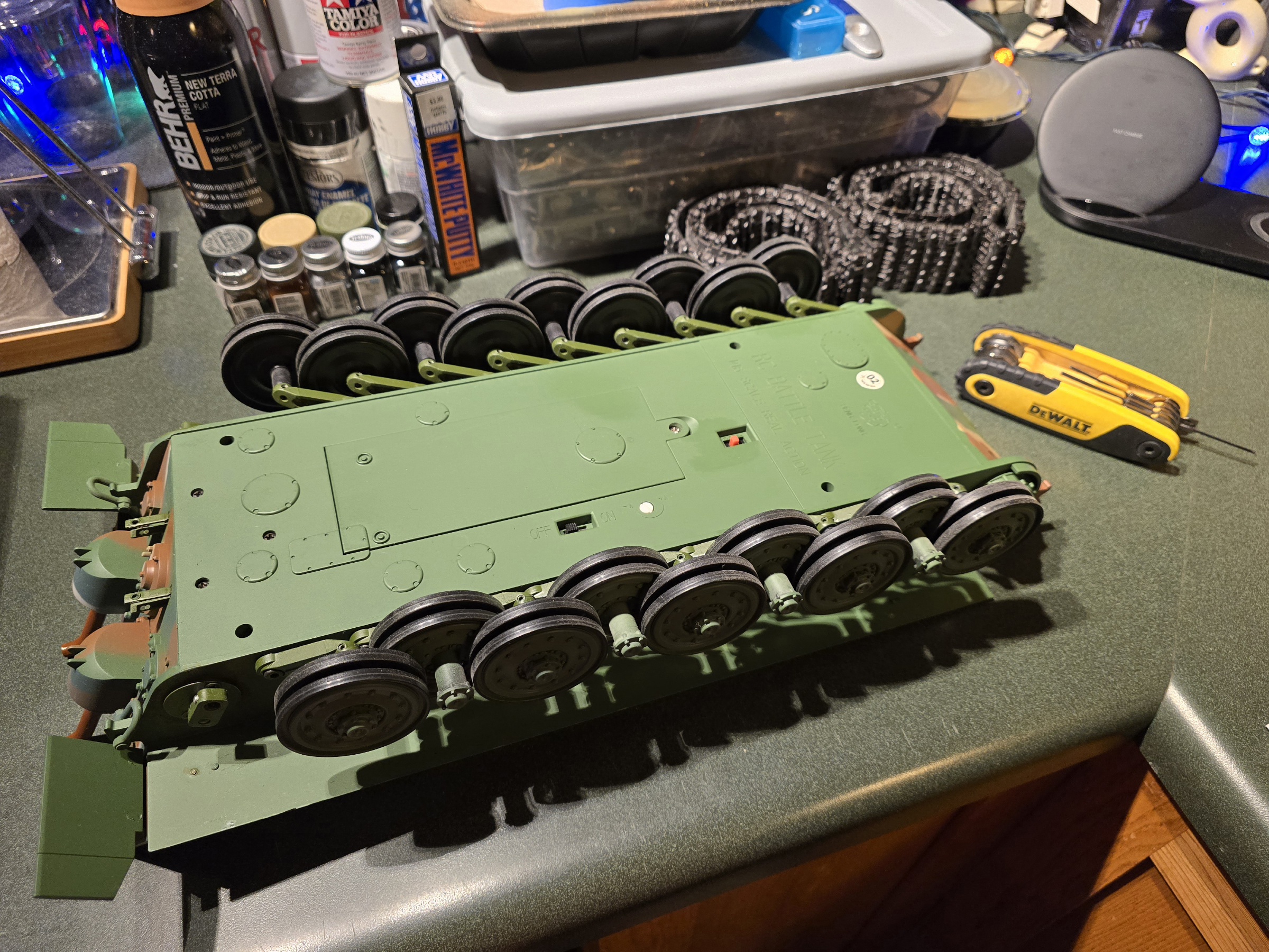

Good Evening all!
A quiet hour spent remembering how-to and then disassembling the Running Gear on the old Porsche King Tiger. It's a work night for das Spouse so I put off removing the road wheels and suspension arms until tomorrow. Which got me thinking, (always a bad thing)... about buying a modern plastic version of the HL
Kingtiger just for the modern electronics and smoker. I have already bought an upgraded HL KT and decided not to use it for parts since it was so nice a Tank. A cheaper version may allow me to overcome my idio(t)syncracies and take it apart to make the Porsche KT a better runner.

Thank you, Sir! It's like coming Home. The metal Asiatam Suspension arms on this Tank are made better than the existing HL ones (back in the day). They have Grub Screws for the attachment of each road wheel to the corresponding arm. I would like to reuse them but they are slightly, just a hair too long for each one which adds up on the HL Lower when you get to the arm and road wheel facing the Sprocket. This was an issue for me back in the day and I had to alter that Sprocket to get the Set to work. It did but at too sharp an angle of lift and the road wheel would still touch the Sprocket. So I will use metal Heng Long Suspension arms this time ( were not available right after this Tank came out until some months later). Now if I could get my phone to drop the size of these Pics. *laughes* You have to be Louis or summat to have your work look good at that magnification.
