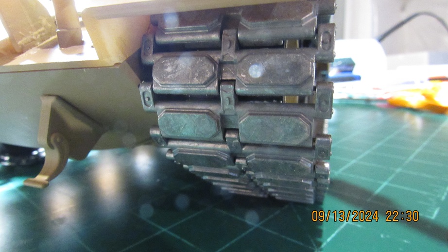

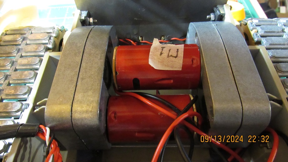

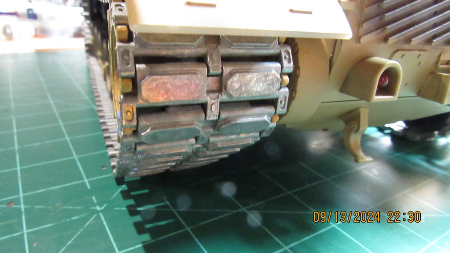

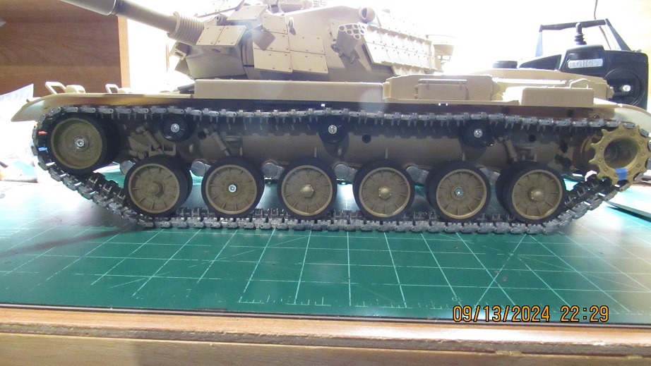

Optimize the Tongde M60A1 to run on grass lawn with 390 motor and metal tracks
My left hand neighbor and I both have 1/3 arca lots. The builder made our open space adjacent to each other creating a good space for tank running. The lawn has fairly uneven terrain. The lawn is well manicured and kept to 2" high. The lawn is too slippery for tank battle or sharp turning of the tank, but ideal for buggy type running. M60 with 380 motor with TD plastic track drives well on hard packed dirt road of RC tank battlefield. 390 motor with TD metal track drives well on slightly soft and slippery grass lawn.
The 390 motor and metal track upgrade works very well on grass lawn. The TD metal track feels much heavier than similar HL metal track because of its all solid construction (no hollowed out back side). The upgraded M60A1 weights 11# 2.4oz. It is the heaviest tank in my collection. Despite its weight, the torsion bar suspension works well as is too. It is most important that the M60 levels evenly and it does.
