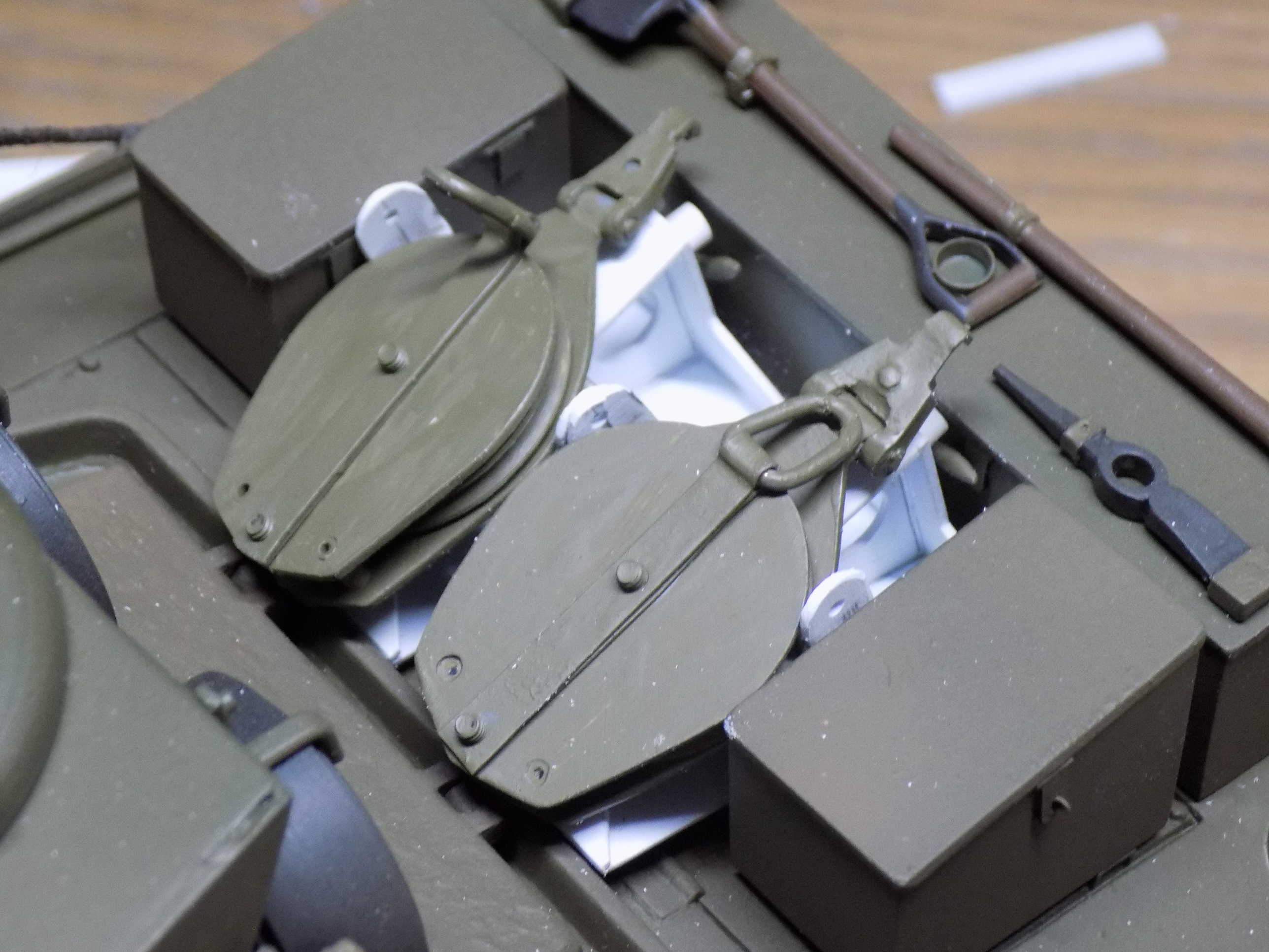

New chock block versions. Pulleys have been disassembled and painted.

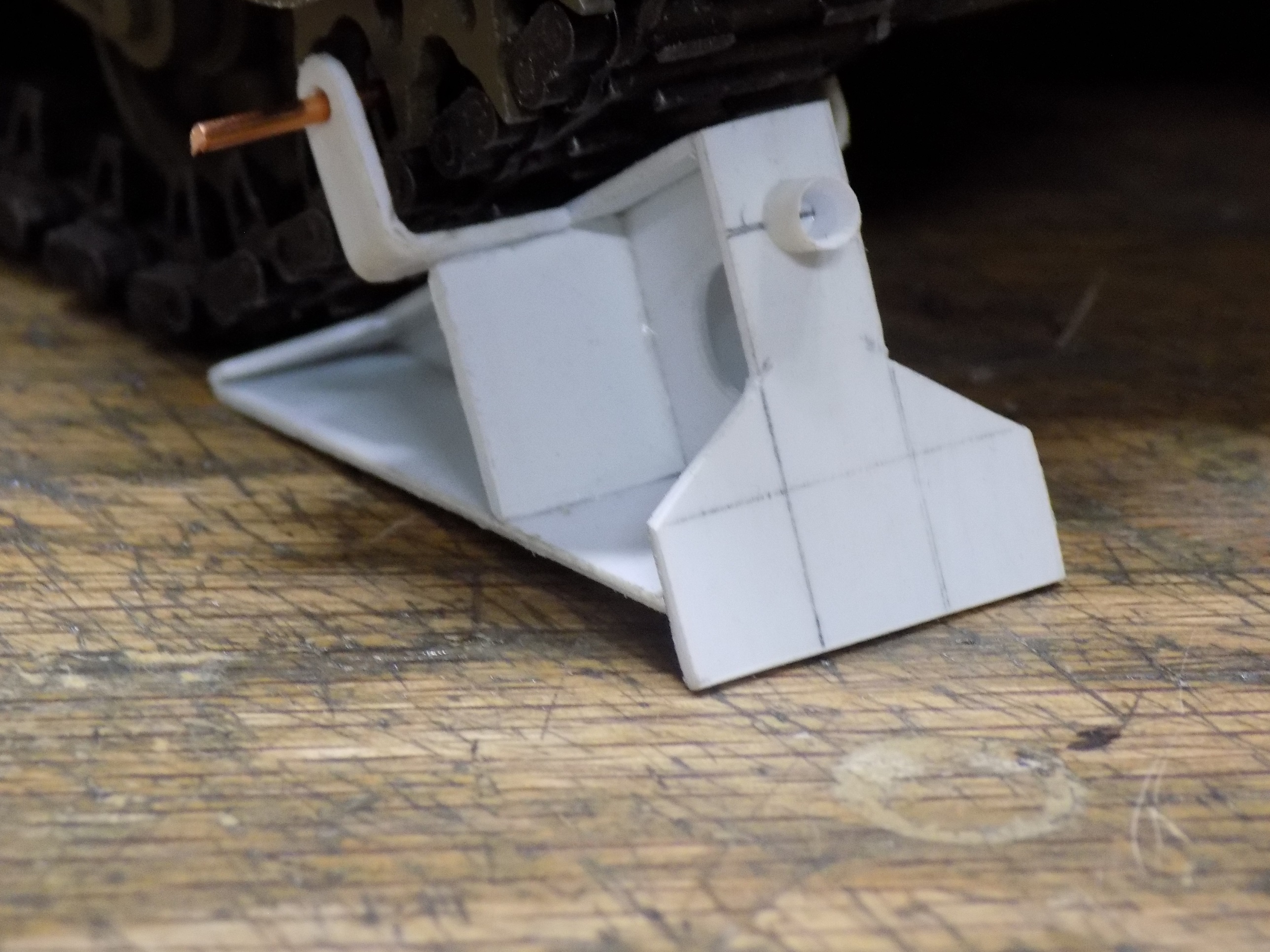

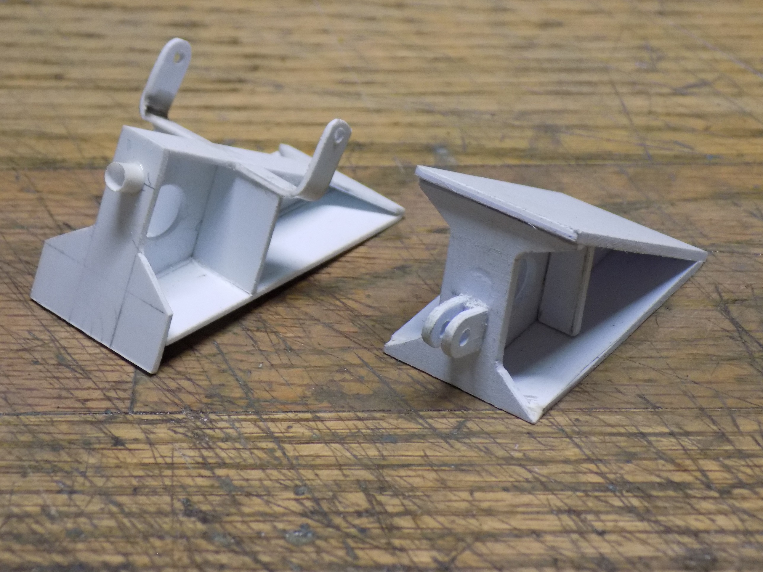

Old vs new.
M32 204.JPG (1.3 MiB) Viewed 79 times
I have lowered the ears for the track spike.

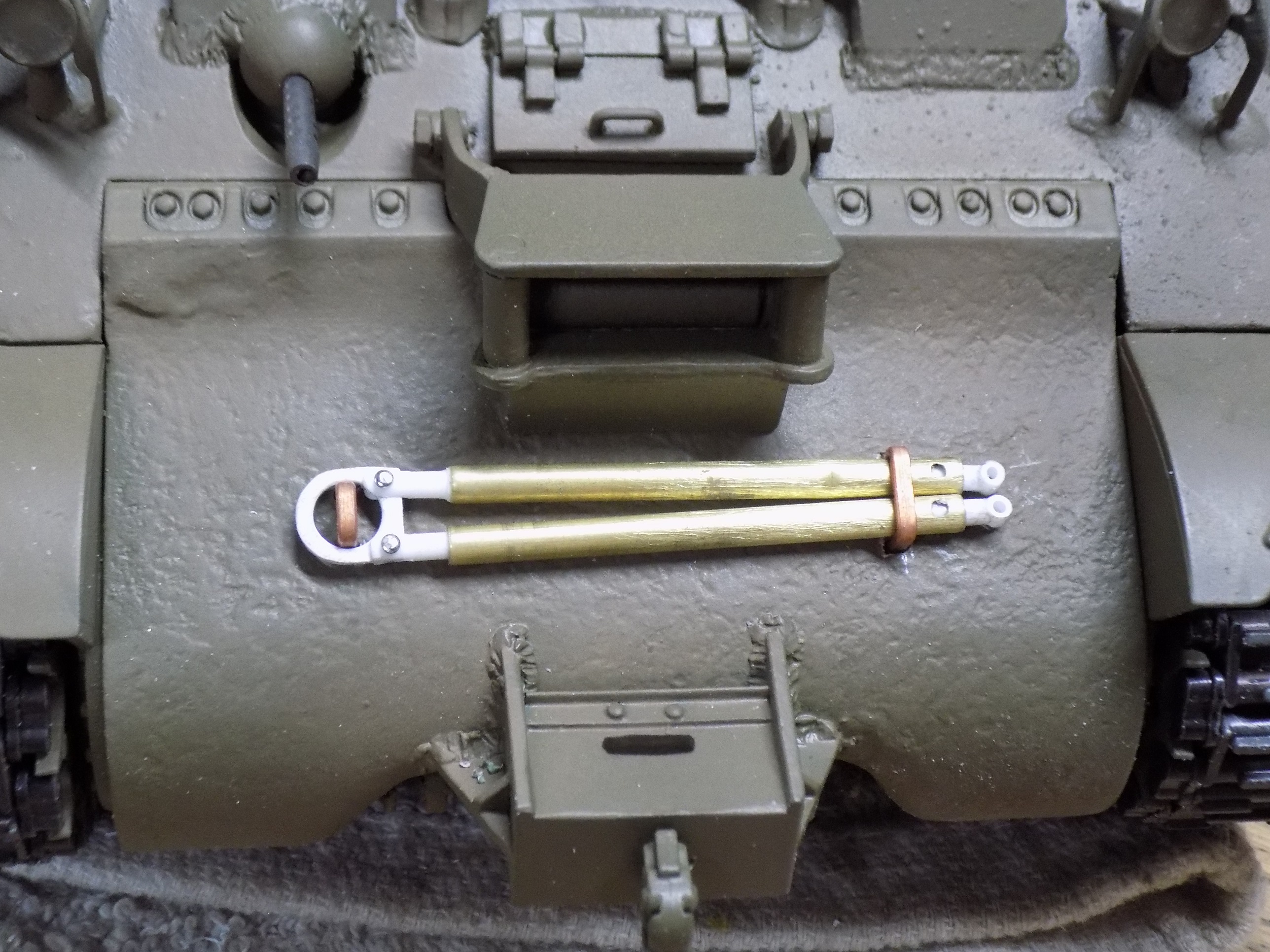

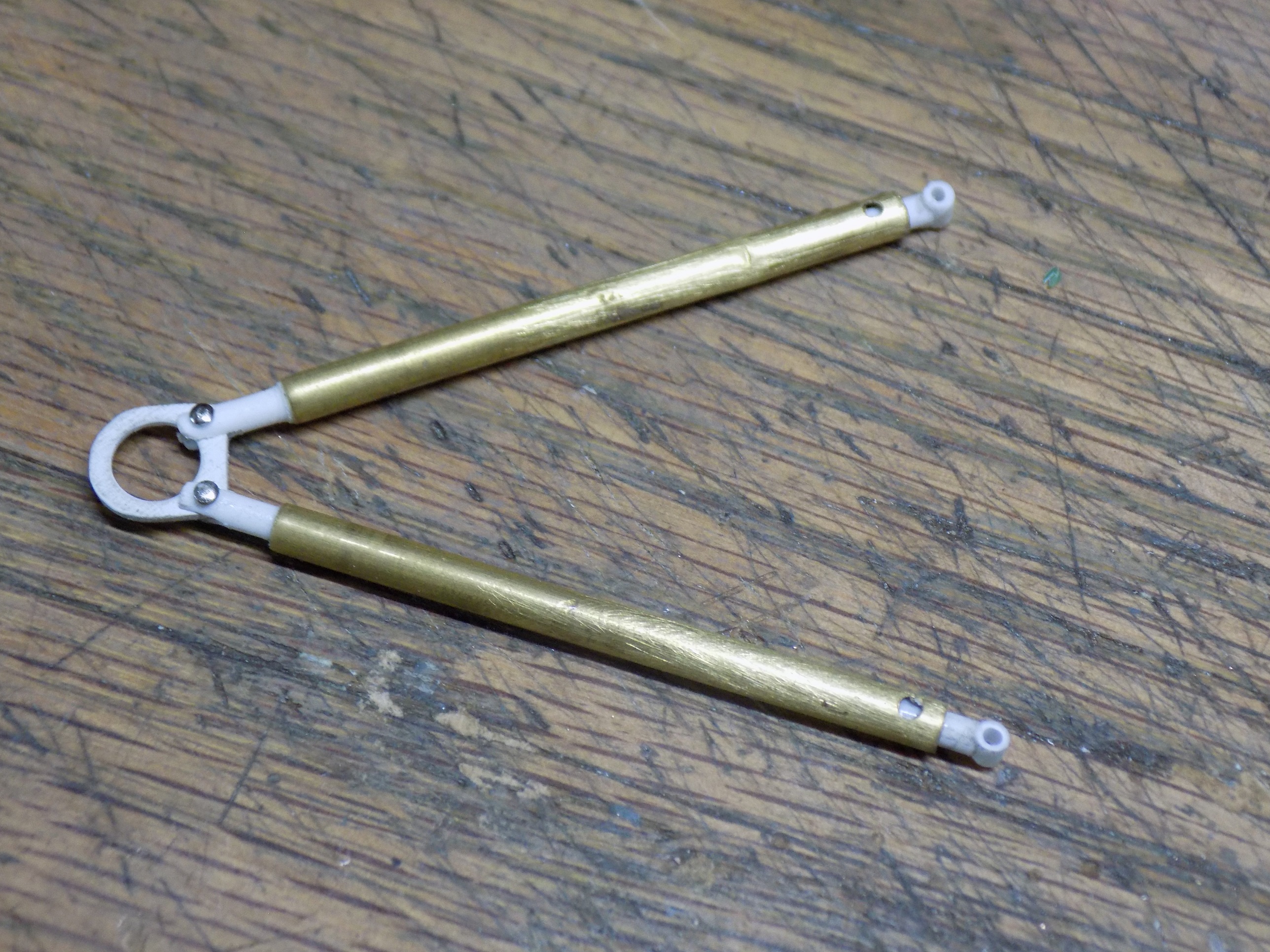

Hold out bar. Third picture explains it better than I can.
M32 206.JPG (1.48 MiB) Viewed 78 times
M32 207.JPG (1.43 MiB) Viewed 78 times
M32 208.jpg (179.46 KiB) Viewed 78 times
Eric

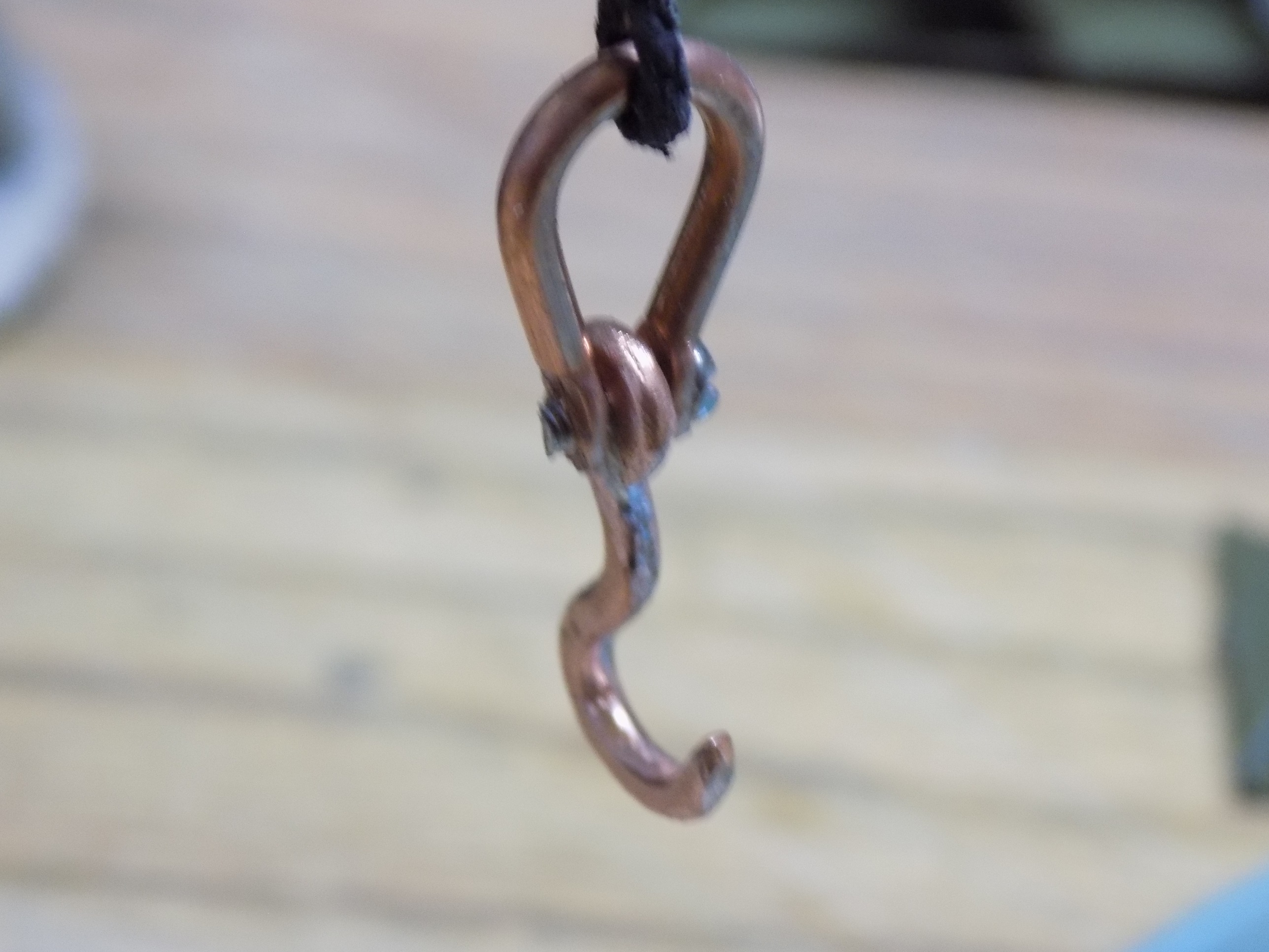

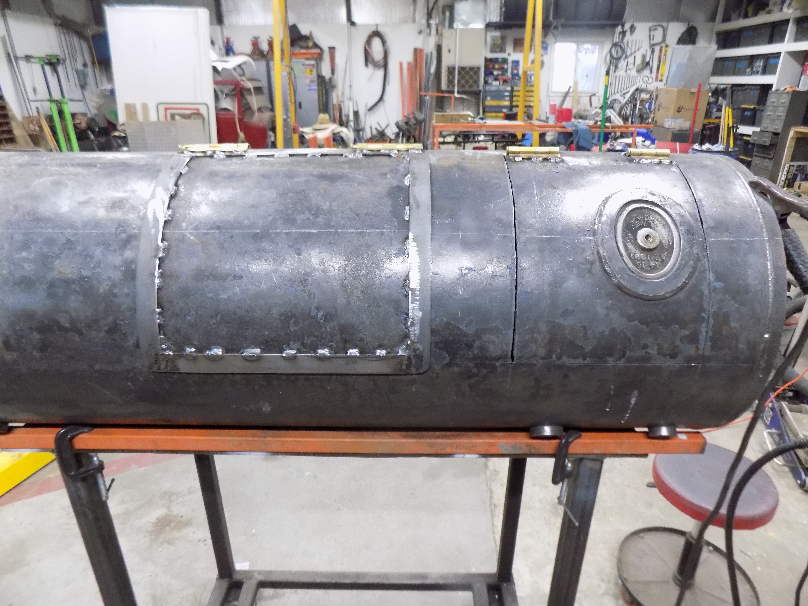

Minimal time in the hobby room today, brewed a pot and started the heater out in the shop. Made a clevis and hook for the ARV's main cable.
M32 210.JPG (1007.77 KiB) Viewed 77 times

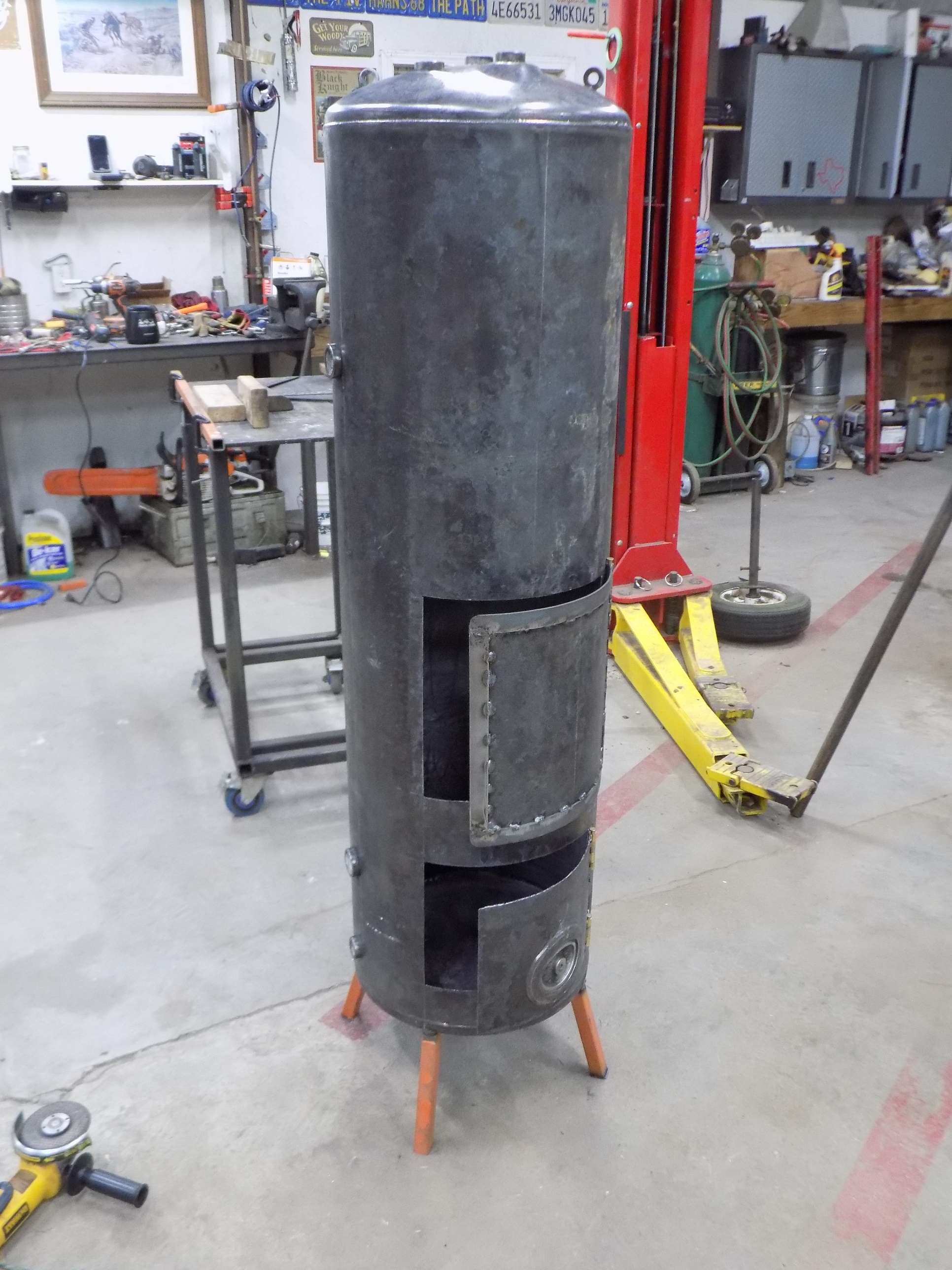

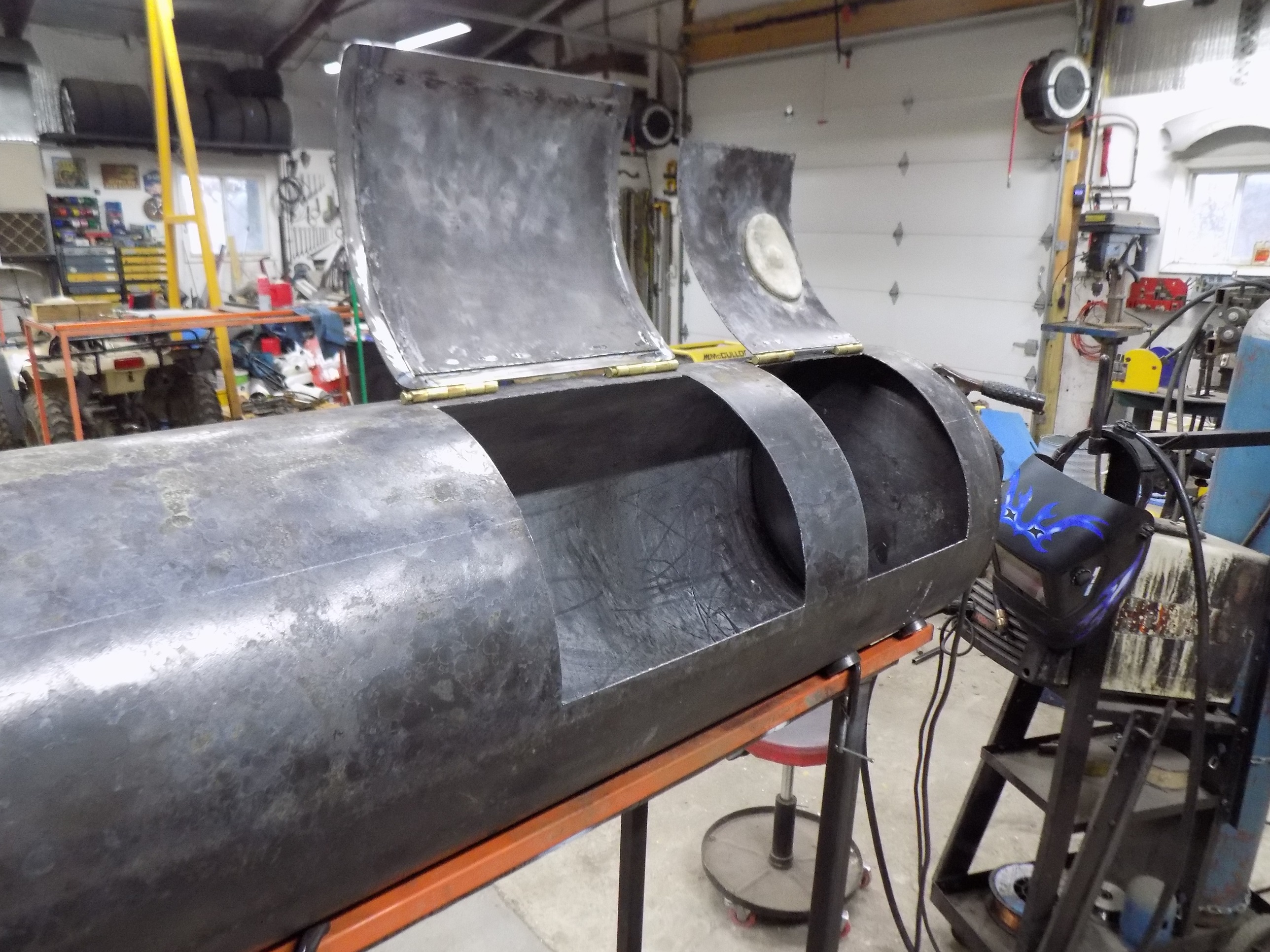

I know it will sound weird to most, but my Christmas gift to myself was spending the day in the shop. I have a couple (around 40) gallons of oil from the various vehicles that have visited my shop. It is rare that someone offers to take the old oil with them. So it has been a bucket list item to make a waste oil heater for the shop. I have propane powered heater (and A/C in the hot months), but free heat in the form of left behind oil has been a wish list item. Earlier in this thread (and month) I mentioned I was roped into installing a hot water heater for a neighbor. I even offered to dispose of the old one. This is about eight hours from a mineral loaded water heater toward an oil burning heater. Most of the time spent was stripping the outer sheet metal and inner insulation from the tank. Used the plasma cutter to make two hatches. There will be a baffle between the doors. This design should allow oil burn non forced air/forced air all the way down to wood burning.
