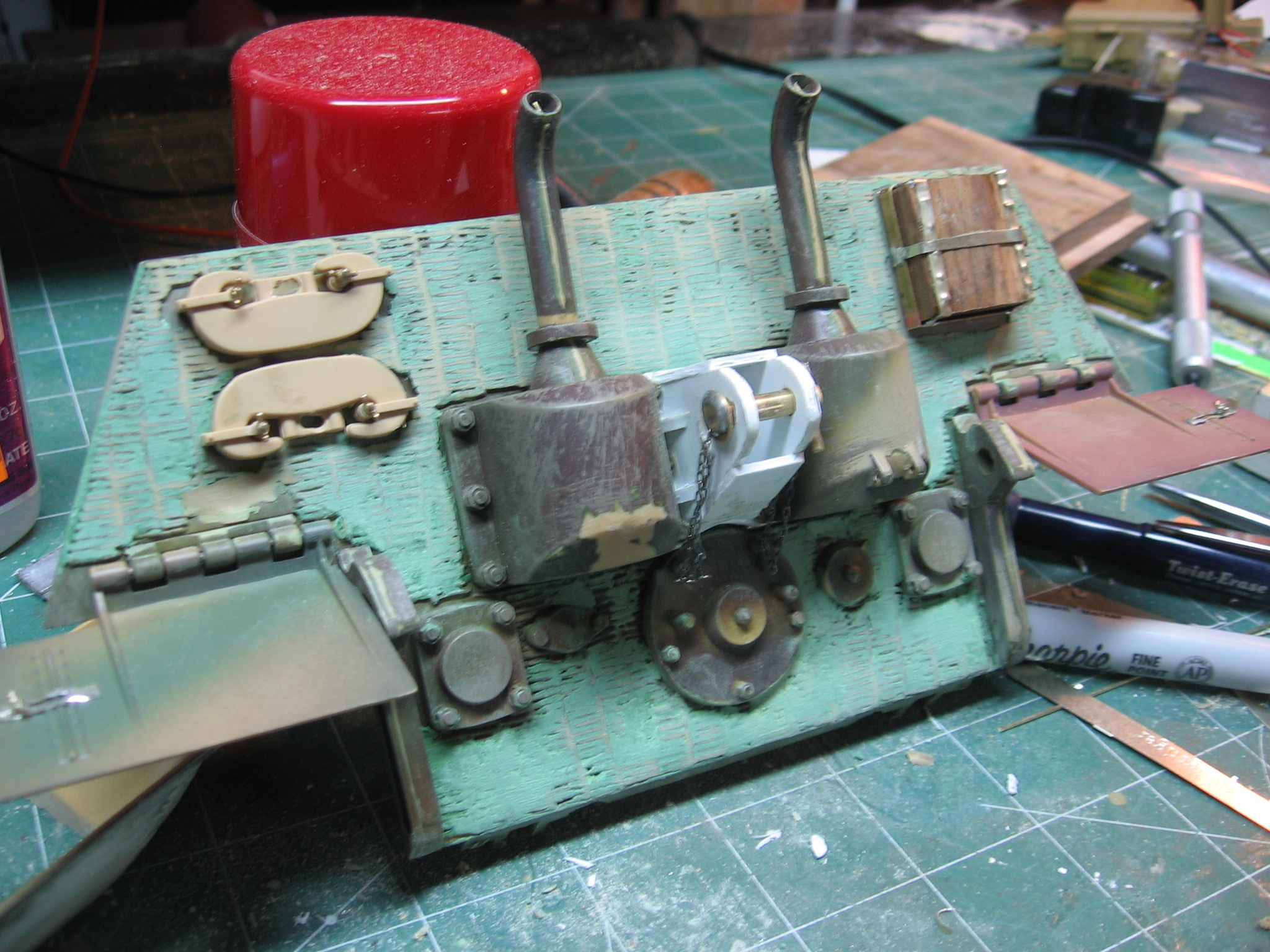

My JT's travel lock from wecohe got the same bad casting, but okay PE parts. I think the bolt's are in the bolt/nut kit which are availiable separately from Wecohe. Regarding the 18T sprockets/single link track's I think they were fitted to the JT's with Porsche design roadwheel/suspension. And I think all the early models didn't have travel lock either.... I don't bother to build a 100% accurate model of the JT, I build it out of personal preferences. Keep on the good work there, I like it.

I think you did a great job on the tow hitch! It's one of the neatest features of the late Jagdtiger that was captured by the Soviets and is in Kubinka - only the whole rear half is broken off. I always wondered what it would look like if it was intact - and now I know! Thank you.
