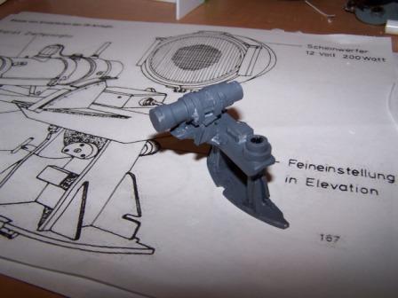

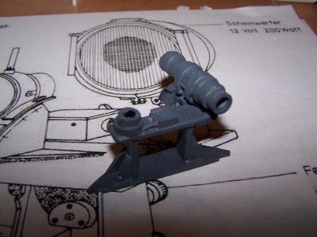

Here is the Vampyre system without the infra red light, I am waiting for leds from the LHS, they were out.
This is 2.2cm width, base is 2.5cm, total height is 2.7cm. If I did it right it will come just below eye level of my tank commander.
The lower hull is all epoxied up. When I get the suspension in I'll post the pics I am taking.

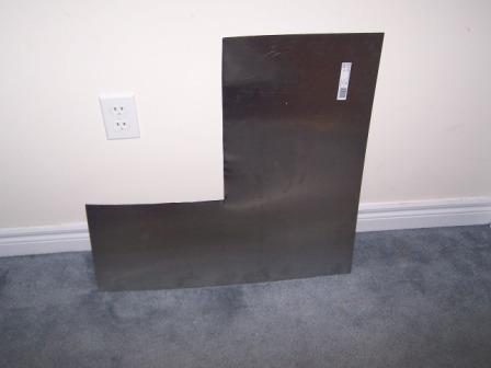

Something out of this. Actually I can't say because I don't know. at least I don't have a finished drawing.mustclime wrote:what are you building?
I know what I want it too look like and when finished it should be a cross between a Tiger II, Panther, T34.
The whole idea is too build my own Paper Panzer.
The cut aluminum sheet and the wall plug should give you an idea how big the Tank will be.
