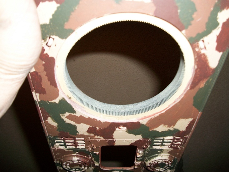

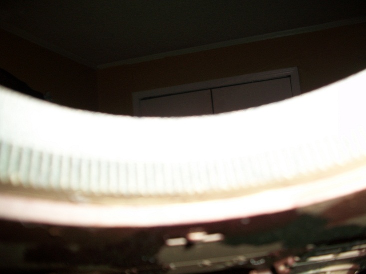

              Perhaps this modification might be of interest,I am sorry for not suggesting this sooner. It is a Tamiya Tiger VI Ring Gear installed in the turret opening in a Henschel King Tiger lower hull. This allows turret 360 rotation and removal in any position. The rotation gearbox is in the turret. Saxondog

              :thumbup: That looks just the job , cheers Blake ! I'll bear that in mind for the future , very handy .
