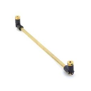

Got the boiler up and running after relief valve adjustment. maintains ~30psi no problem.
Preliminary mounting of the engine, boiler, alcohol reservoir. No room for hand pump..
see the vids:
http://www.youtube.com/watch?v=SpSTC_gQ ... er&list=UL" onclick="window.open(this.href);return false;
http://www.youtube.com/watch?v=hOnn-n9b ... o&index=22" onclick="window.open(this.href);return false;
Some issues: the propshaft came 'bent' so it took a while to straighten out. stuffing box had to be shortened while saving the bronze bushings. Prop shaft is shortened, and end near universal is drilled and milled so that the whole shaft slides in and out of the universal by about 3-4mm. this is so that the prop axial pressure is taken up by nylon bushing just in front of prop and not by the universal or the crankshaft.
Universal is 3/16th from Amazon, as no hobby site had this size. Just pry off needed ends and put together. I reamed the nylon coupler holes a little so they are just loose and easy to turn.
