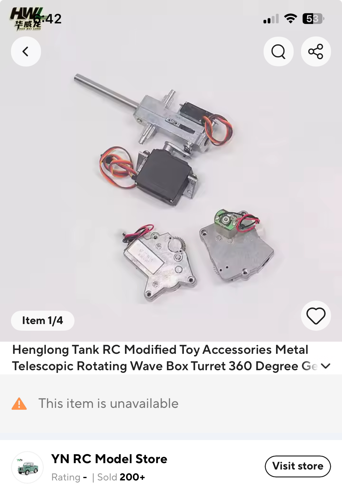

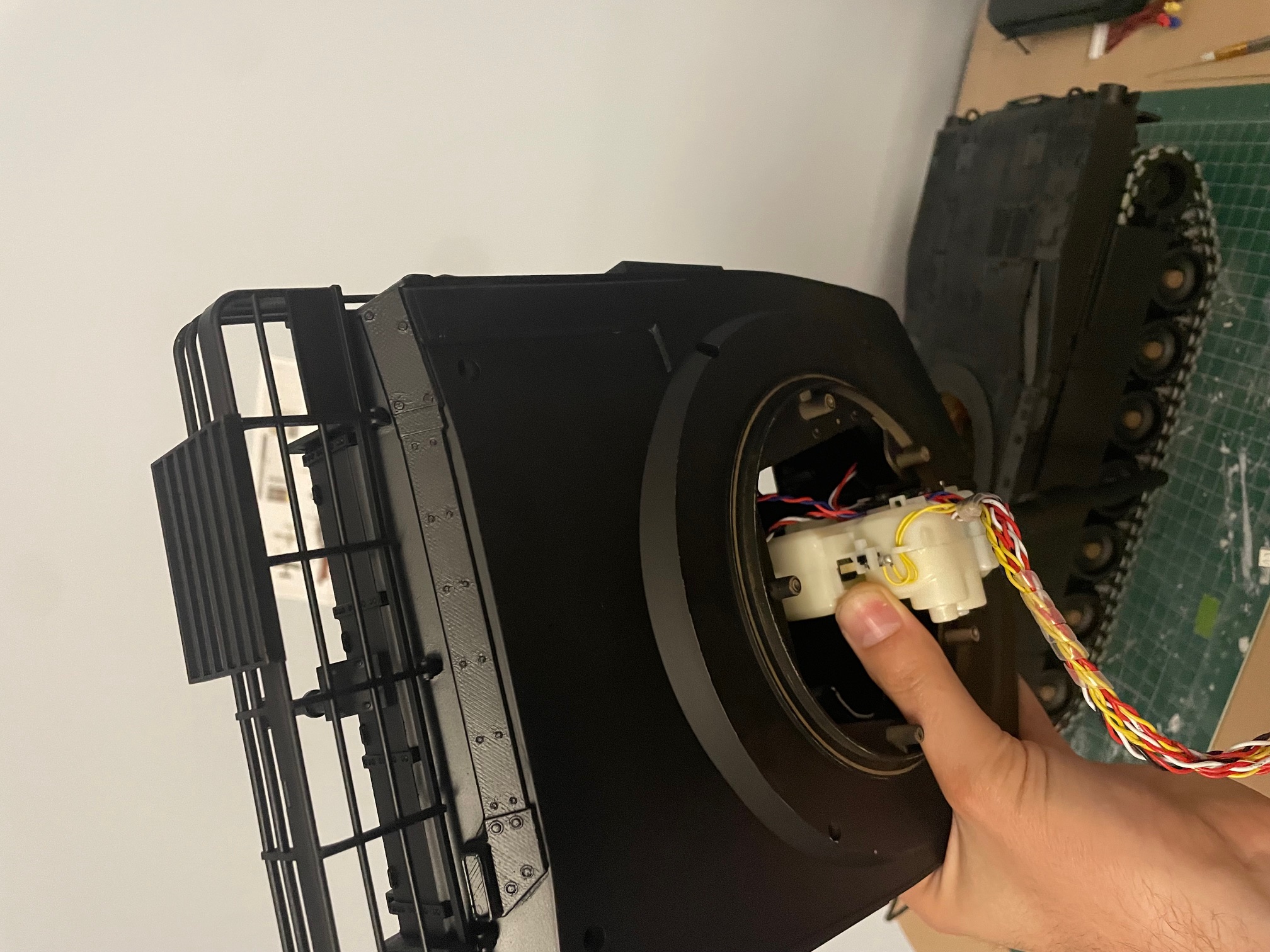

tankme wrote: Thu Jul 17, 2025 10:24 pm I have the metal ring with the metal turret rotation where the motor hangs down. It is definately faster than stock. Only issue I have with the metal rotations units is that they don't have clutches in them. They have no give if you run into something. They can't be turned by hand either, only under power of the MFU.
The one I have allows you to spin the turret freely by hand, which is super nice. I wonder if there are different versions?
Below is a picture of the one I bought. Apparently the store I bought mine from doesn’t have any more at the moment.
tankme
Posts: 3272
Location: Elgin, TX
Re: Build Time! M1a2 Sep V3 AUS
Post by tankme »
There's two rotation gearboxes there at the bottom of the pic. The one I have on my Abrams is the one on the right.
Jib
Posts: 405
Joined: Wed May 29, 2024 1:37 pm
Location: Kentucky, USA
Post by Jib »
Yeah I have the one on the right as well, on a Taigen Leopard 2A6 with the metal turret rotation ring/gear. Pretty sure I remember being able to move it by hand, maybe only when it’s powered off? Not sure, I haven’t fiddled with it in a while.

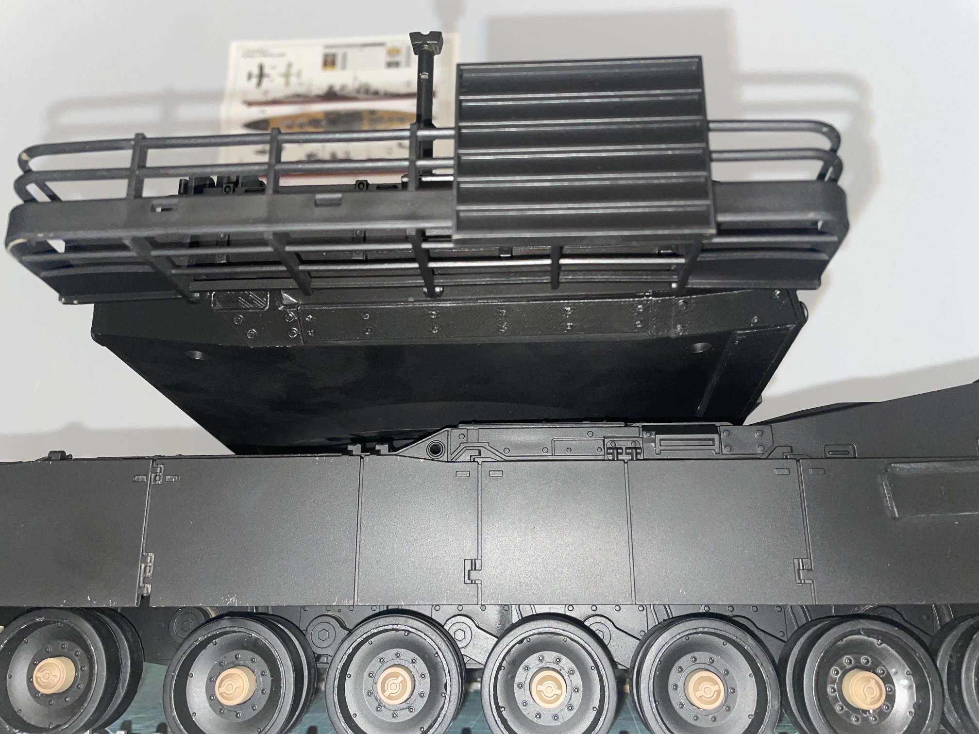

Alright,
More progress, very basic stuff completed. VCSU ducting is done
VCSU Ducting.jpg (844.33 KiB) Viewed 3826 times
Turret Underside VCSU Ducting.jpg (664.12 KiB) Viewed 3826 times

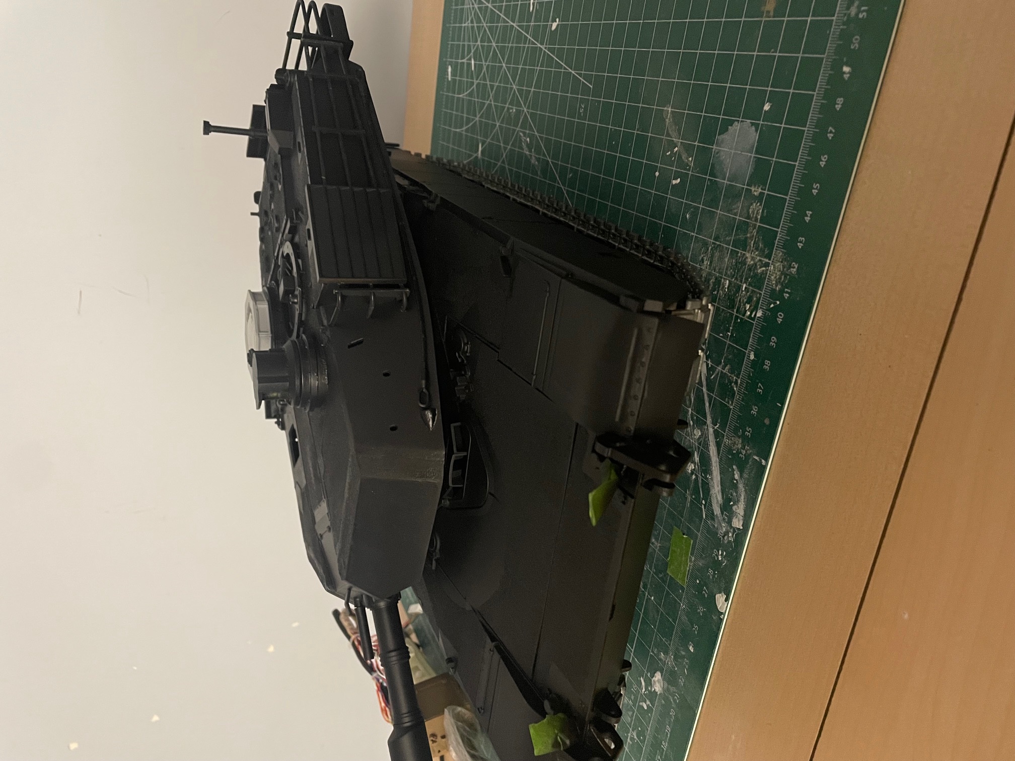

, It can use a bit more fine tuning for fitment, however at this time it can work. Fwd tow hooks have been completed
Fwd Profile.jpg (780.05 KiB) Viewed 3826 times

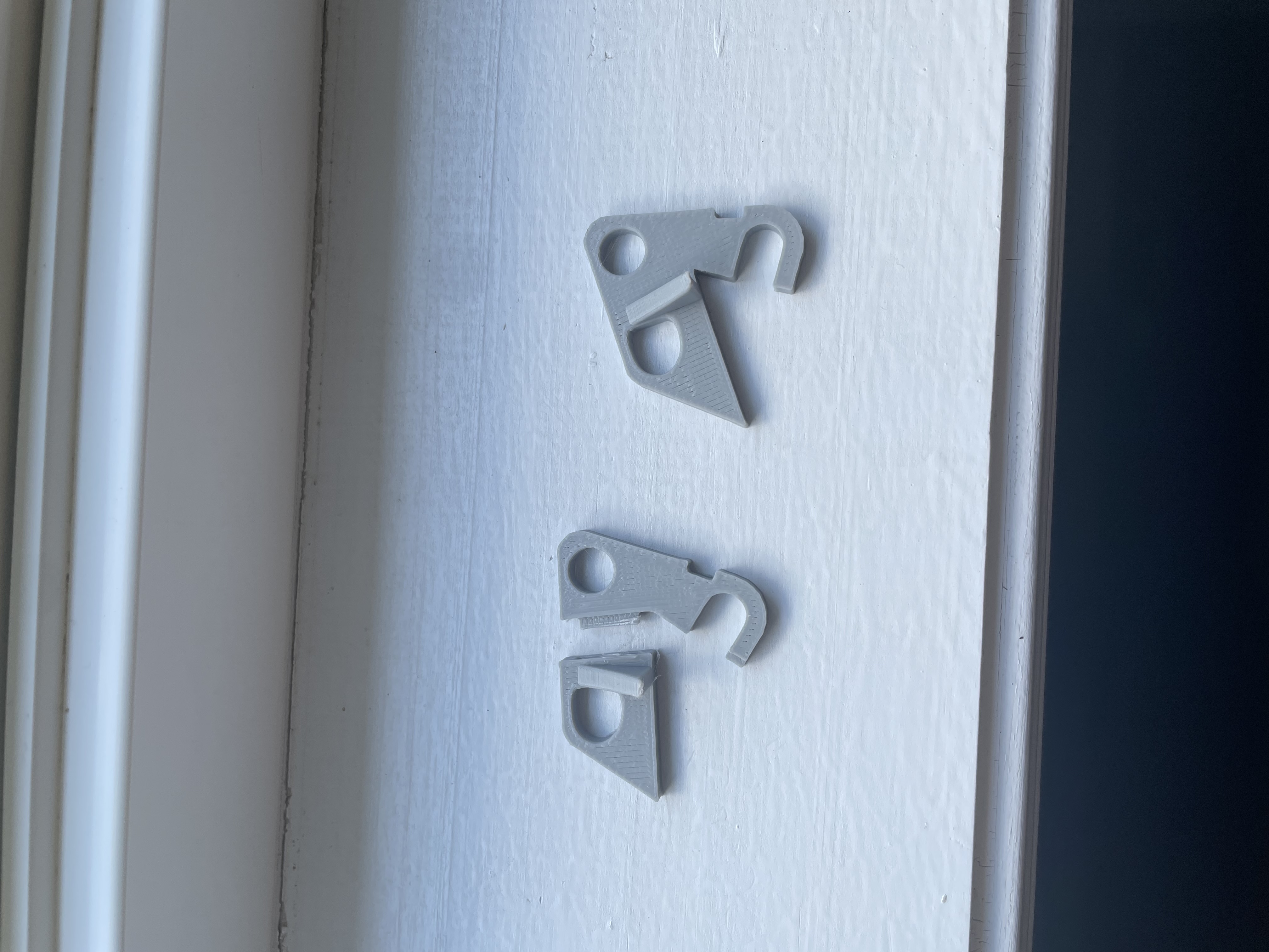

. They are built with the idea in mind that the upper and lower portions separate when removing the upper hull for maintenance
Tow Hooks Lg.jpg (1.81 MiB) Viewed 3826 times

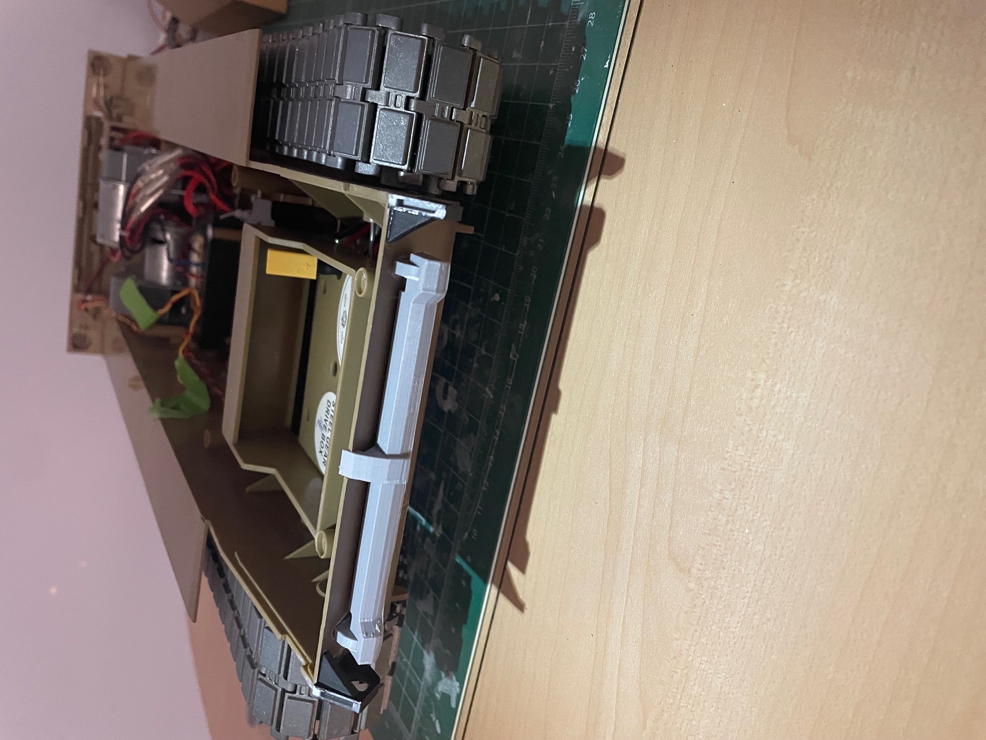

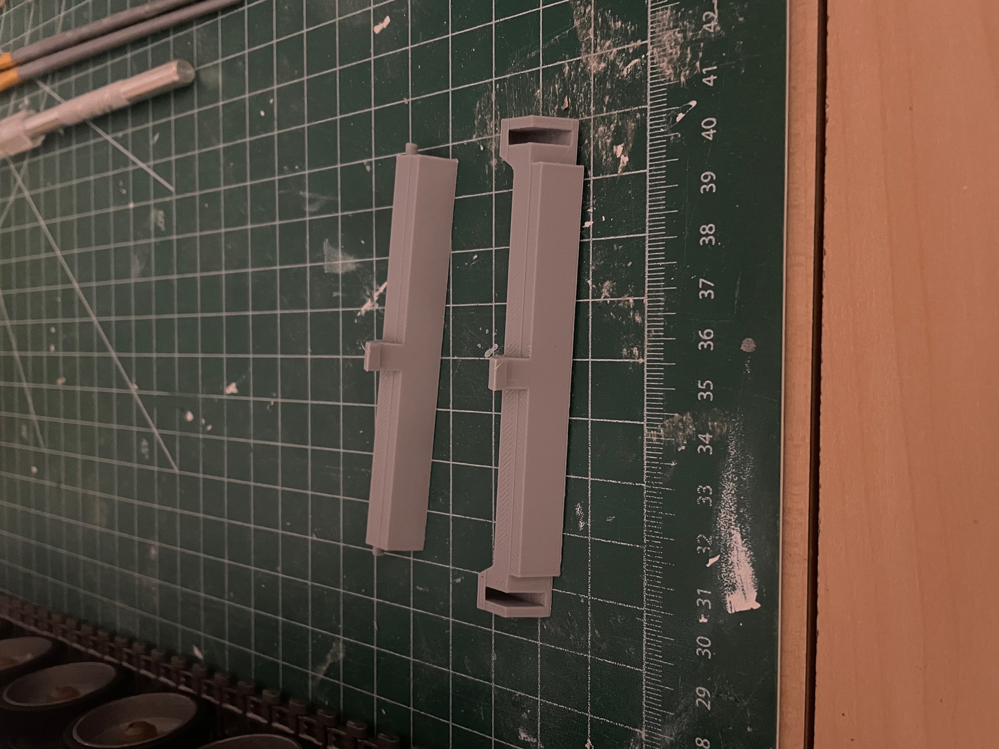

. To keep the spacing even and remove some of the guess work on adding the smaller tow hooks, I ended up building a jig that locks into the latch hole on the lower hull
Jig in use.jpg (927.47 KiB) Viewed 3826 times
, the spacing unfortunately wasn't even so this took a few tries getting it right. This imagine shows both the V1 and V2 variants

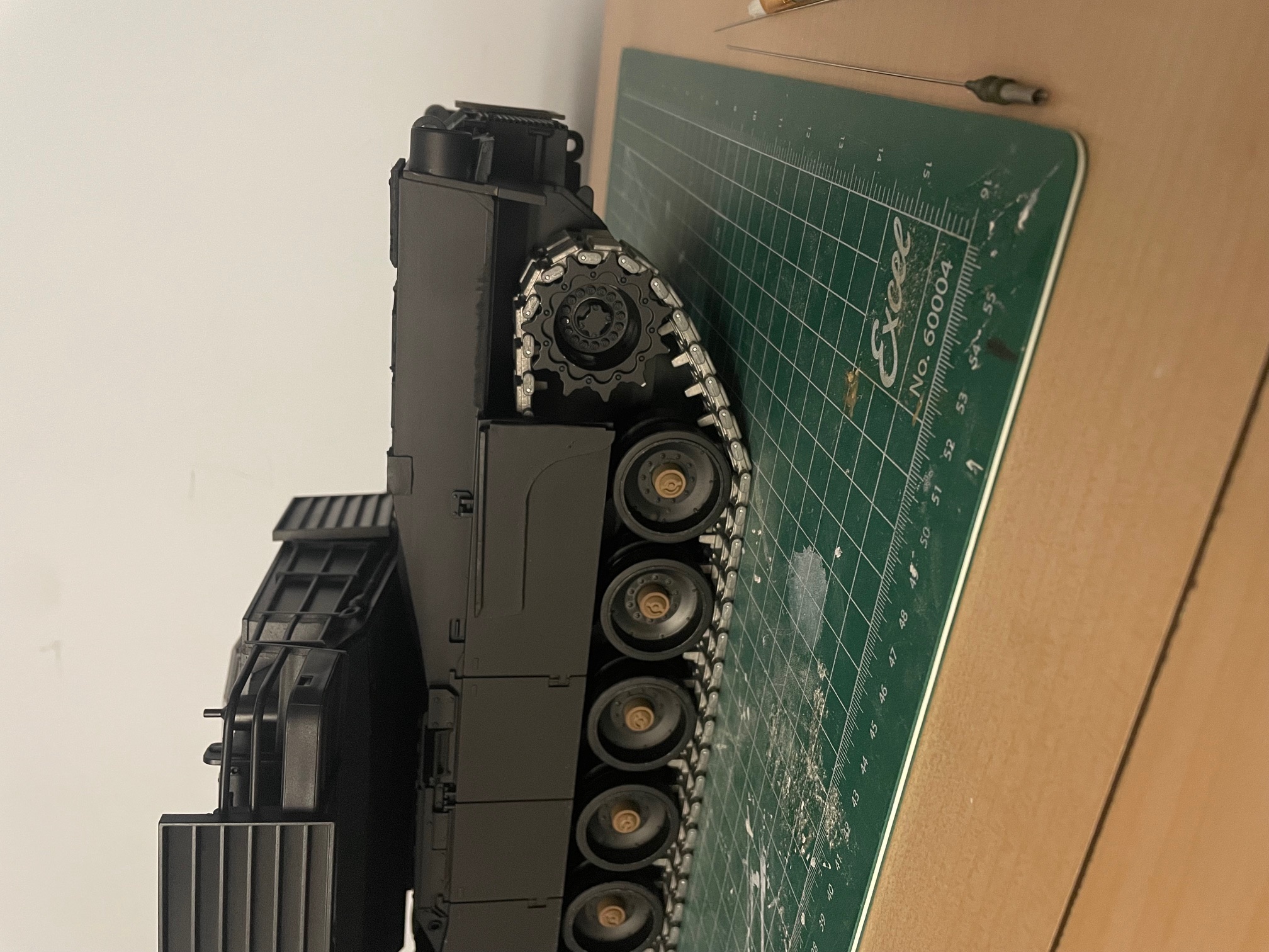

Cut the rear side skirts out and glued them into the open position, And love the look from it, something about showing off the drive sprockets on the M1 just feels right
