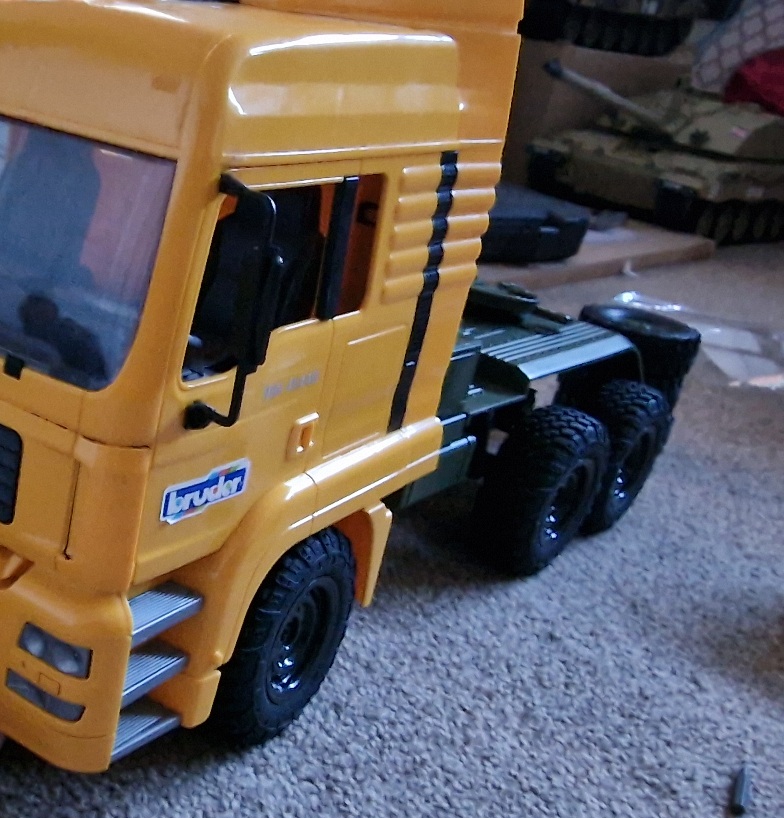

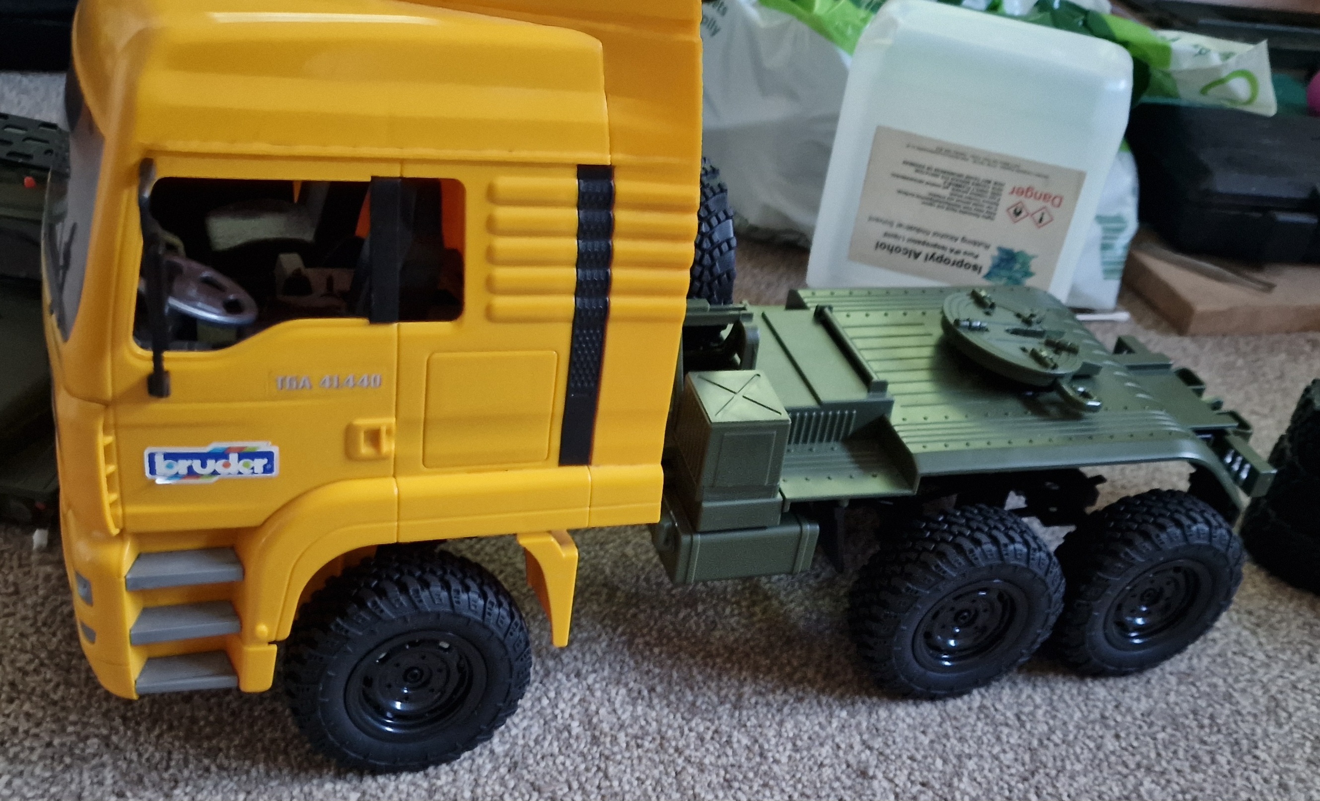

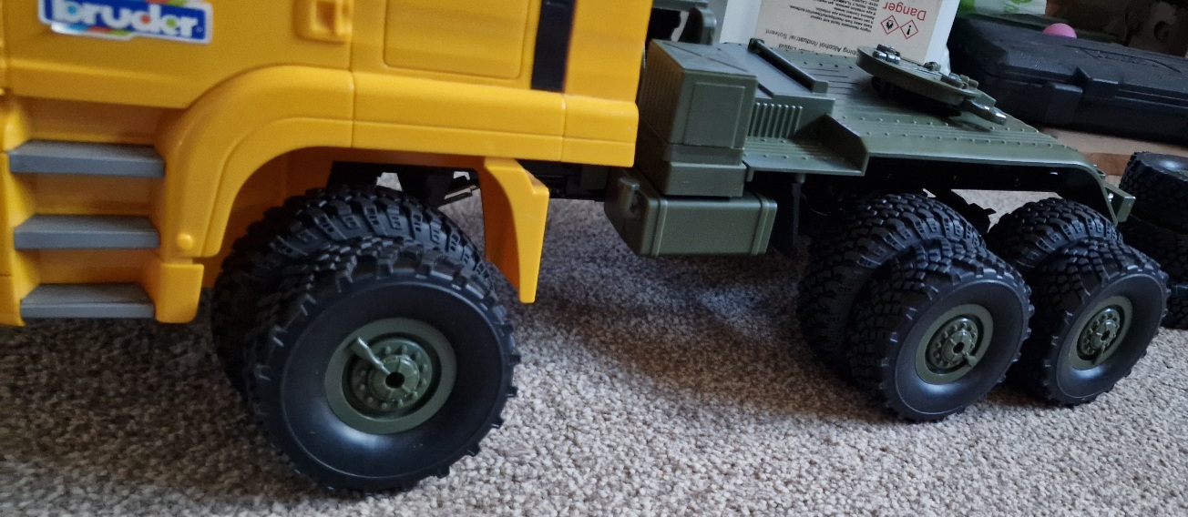

Track widened, and bigger wheels/tyres fitted...
Which colour for cab? Some sort of Nato green? British green? An olive drab?
Edit: I forgot the desert paint job option.

I would go with a full nato green respray. I’m not sure a green chassis with a dhl yellow can blends in to well

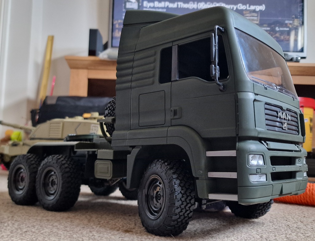

I have no idea why, but I went for Umbrol Black Green. I have ordered two spray cans of Ral 6012... as my first ever attempt at airbrushing was hitting 'why has this damn thing stopped working...' snags.
Managed to figure it out. So as it's all a learning curve project, and that the good ol' spray cans aint arrived yet... I kept going with the airbrush.
Just reassembled it there, to see how it looks...

Not 100% happy with my coverage... can I pass slight streaks off as detail?!? 🤔
I'll have a go at adding some more (proper) detailing and weathering when I get a chance.

Coverage problems are not showing up in the photos (as least to my, ahem, eyesight). I would bet that when you weather the truck, a touch of uneven coverage will be to good effect. Nonetheless, I confess to sometimes using a spray bomb (generally for a metal etching primer) even though I first used an airbrush in 1971.
six things that helped me with airbrushing: 1) always using an appropriate primer; 2) acrylics; 3) thinning more than I would expect; 4) a shop compressor; 5) disassembling and cleaning the airbrush with every paint change, even if immediate; 6) flat paints (in the rare instances I need gloss, I use a clear lacquer spray can after the base coat is finished)

Good tips/advice. 👍
I used a can of etch primer I already had. Water based Acrylic for top coat.
I thought I was over thinning it too, and using IPA. I'm not sure if it was evaporating too quickly at the nozzle and blocking it quicker. I had some paint and IPA in a mixing jar already... and added some water for that coat there. I may just thin with water totally next time.
I have a 100L compressor in the garage, but it's a bit chilly up here atm. At least I can spray quietly inside with the cordless one(which I felt in my virgin experience of airbrushing, worked well).
