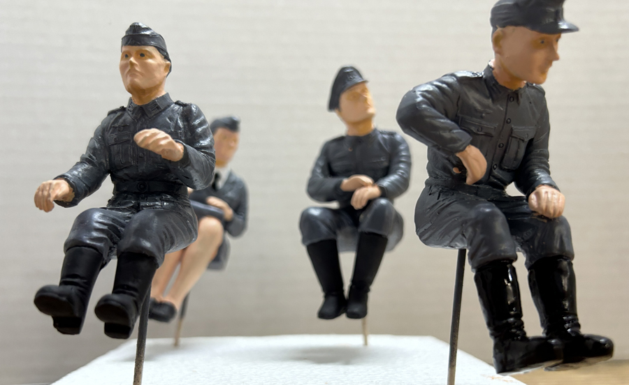

After something of a hiatus, I got back to the figures today. I have chosen to attend to the FAMO figures first, as they are crude and so, better for further practice (there's never enough practice). After the priming, I have put on a sloppy first coat of Vallejo Basic Skin Tone 70.815. The figures now look hideous. There's no need to be concerned at this point, as I will have to build up at least one more coat of Basic Skin Tone before turning to other skin colors.

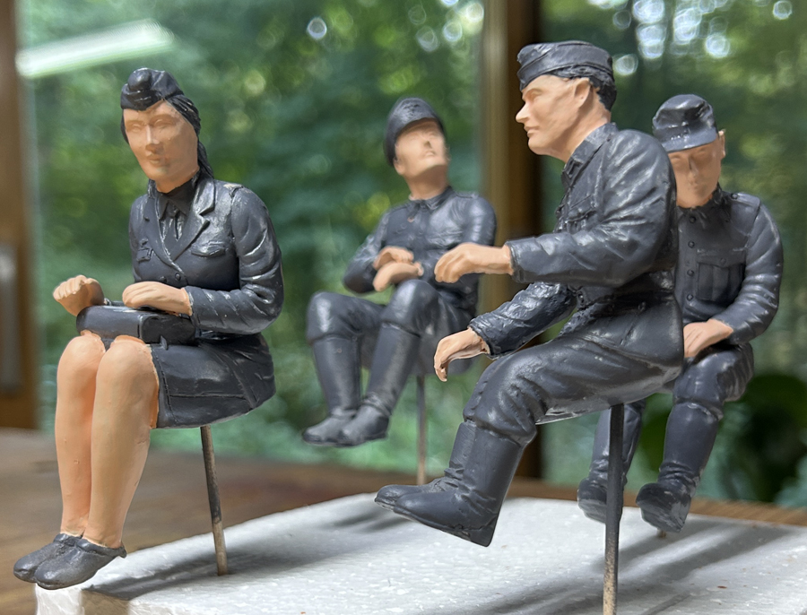

I added a second and third thinned coats of the Vallejo Basic Skin Tone to these figures. Two lessons:
1) I used too dark a primer this time. (I know some people use black.)
2) These figures are looking more and more crude as I work with them. I keep glancing over at the two Airborne figures and wishing for such nice detail: it makes painting work so much better.
So here's a step from hideous to just pretty bad:

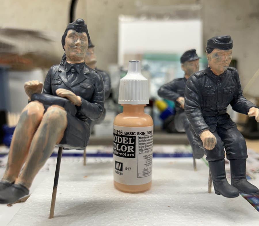

Given some time today, I took another step: the eyeballs. I do not paint eyes white or even cream: I left them in the light Basic Flesh Tone. I dipped sandpaper-sharpened tips of round toothpicks in the eyeball color, touched it to a piece of paper towel, then nervously touched the tip of the toothpick in the eye (not mine, the figure's) to place the eyeball. With cotton swabs and water close at hand, I was able to quickly clean off my mistakes and start over.
After I settled for the best I can do with eyeballs, I mixed Basic Flesh Tone and Dark Flesh to create a bit darker color. With a 4/0 brush I carefully swiped above and below the eyeballs, to trim the eyeballs above and below (a more natural shape, especially when eyes are in bright sunlight) and, at the same time, to darken the area around the eyes. I used the same mix to slightly darken immediately below the noses, chins, and cheekbones, where there would be a minimal shadow in daytime sunlight. I kept these effects subtle, so they hardly show in the photo below. I could go back and be more dramatic, but I hesitate because I have one more step that usually has a dramatic effect when seen in person. More later on that...
The exception is on the female, the Wehrmachsthelferin. In this case, I used diluted Basic Flesh Tone and 70.803 Brown Rose to create a blush to her face (which is hopelessly unshaped on the figure) suggesting delicate skin that has been out in the sunlight.
I will next have to face (all puns intended) the eyebrows and even eye lashes. I will be all paint, as in these figures, the former are not well-defined and the latter non-existent. :-<

Must be a little uncomfortable having a pole in that location... :haha:

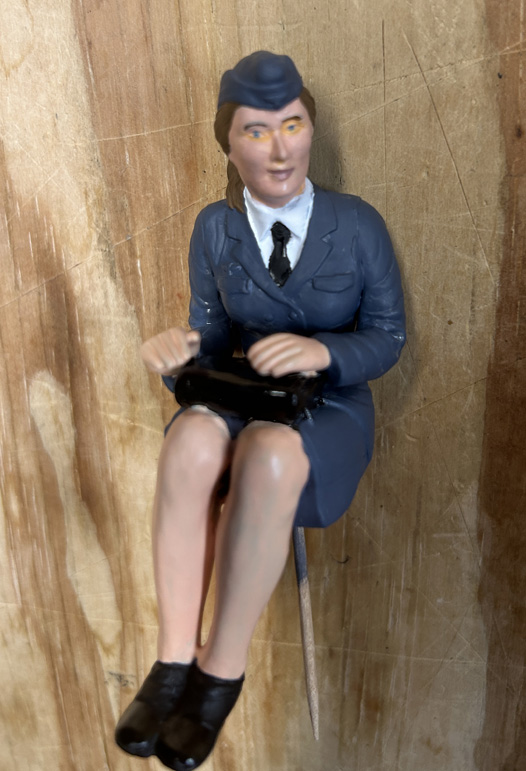

I have turned to the women first to complete, but there is still some ways to go. I take her to be a Luftwaffe Nachrichthelferin. I am using:
Williamson, Gordon. World War II German Women's Auxiliary Services. Osprey/Bloomsbury. 2012. ISBN9781780965840.
In addition, a quick internet search yields dozens upon dozens of photos of these women and their uniforms.
I am working to give some kind of detail to the nearly blank oval shape of her sculptured(?) face.
Eyes:
  • Vallejo 70.841 pupils of Andrea Blue dots touched on with a sharpened round toothpick.
  • Vallejo 70.983 Flat Earth for eyebrows, again with a sharpened round toothpick, an arc dotted on and then connected (with plenty of tries and quick "erasures" using clear water).
  • Then the same color for her hair (much easier).
  • Vallejo 70.927 Basic Skin Tone 50/50 with Vallejo 70.927 Dark Flesh using a 4/0 brush to trim off the tops and bottoms of the eye sockets, cleaning up the eyebrows and reducing the roundness of the pupils.
  • Vallejo 70.803 Rose Brown with 4/0 brush for her lips (cosmetics were allowed only minimally, so I am guessing no floozy red lipstick. :haha: )
  • Vallejo 70.950 Vallejo for her satchel and shoes
  • Vallejo 70.816 Luftwaffe Uniform WWII for her jacket and skirt
The last three steps, especially, require going back and forth among the Skin Tone, Black, and Luftwaffe Uniform to touch up "lines" among them, especially since these lines of separation are almost absent on this figure, making one sometimes "freehand," between the skirt and legs or jacket and hands or satchel, etc., etc., etc.
The next step will be a clear coat to protect what is painted so far. Then comes the yellow piping on the cap and collar and silvery wings above her right pocket ( 8O ). I don't know if I can come up with any of the other markings on her uniform, but I have not yet given up.
After those steps, there are yet more to come.
