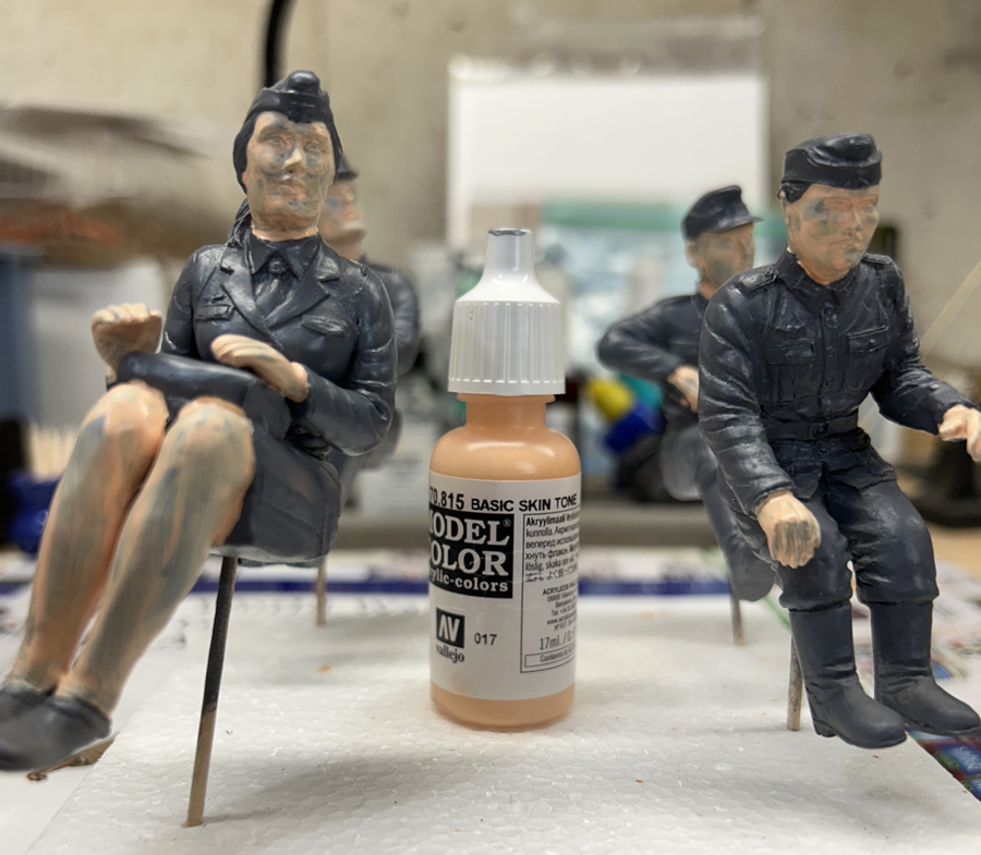

I added a second and third thinned coats of the Vallejo Basic Skin Tone to these figures. Two lessons:
1) I used too dark a primer this time. (I know some people use black.)
2) These figures are looking more and more crude as I work with them. I keep glancing over at the two Airborne figures and wishing for such nice detail: it makes painting work so much better.
So here's a step from hideous to just pretty bad:

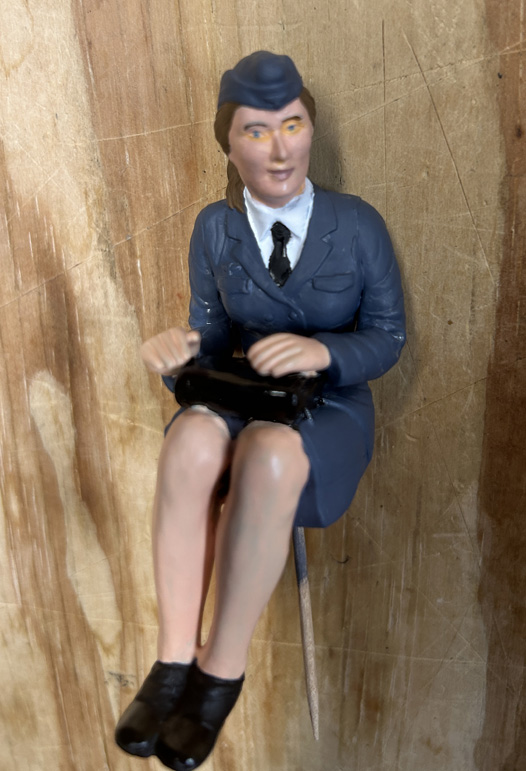

I have turned to the women first to complete, but there is still some ways to go. I take her to be a Luftwaffe Nachrichthelferin. I am using:
Williamson, Gordon. World War II German Women's Auxiliary Services. Osprey/Bloomsbury. 2012. ISBN9781780965840.
In addition, a quick internet search yields dozens upon dozens of photos of these women and their uniforms.
I am working to give some kind of detail to the nearly blank oval shape of her sculptured(?) face.
Eyes:
The next step will be a clear coat to protect what is painted so far. Then comes the yellow piping on the cap and collar and silvery wings above her right pocket (
). I don't know if I can come up with any of the other markings on her uniform, but I have not yet given up.
After those steps, there are yet more to come.
Eyes:
- Vallejo 70.841 pupils of Andrea Blue dots touched on with a sharpened round toothpick.
- Vallejo 70.983 Flat Earth for eyebrows, again with a sharpened round toothpick, an arc dotted on and then connected (with plenty of tries and quick "erasures" using clear water).
- Then the same color for her hair (much easier).
- Vallejo 70.927 Basic Skin Tone 50/50 with Vallejo 70.927 Dark Flesh using a 4/0 brush to trim off the tops and bottoms of the eye sockets, cleaning up the eyebrows and reducing the roundness of the pupils.
- Vallejo 70.803 Rose Brown with 4/0 brush for her lips (cosmetics were allowed only minimally, so I am guessing no floozy red lipstick.
- Vallejo 70.950 Vallejo for her satchel and shoes
- Vallejo 70.816 Luftwaffe Uniform WWII for her jacket and skirt
