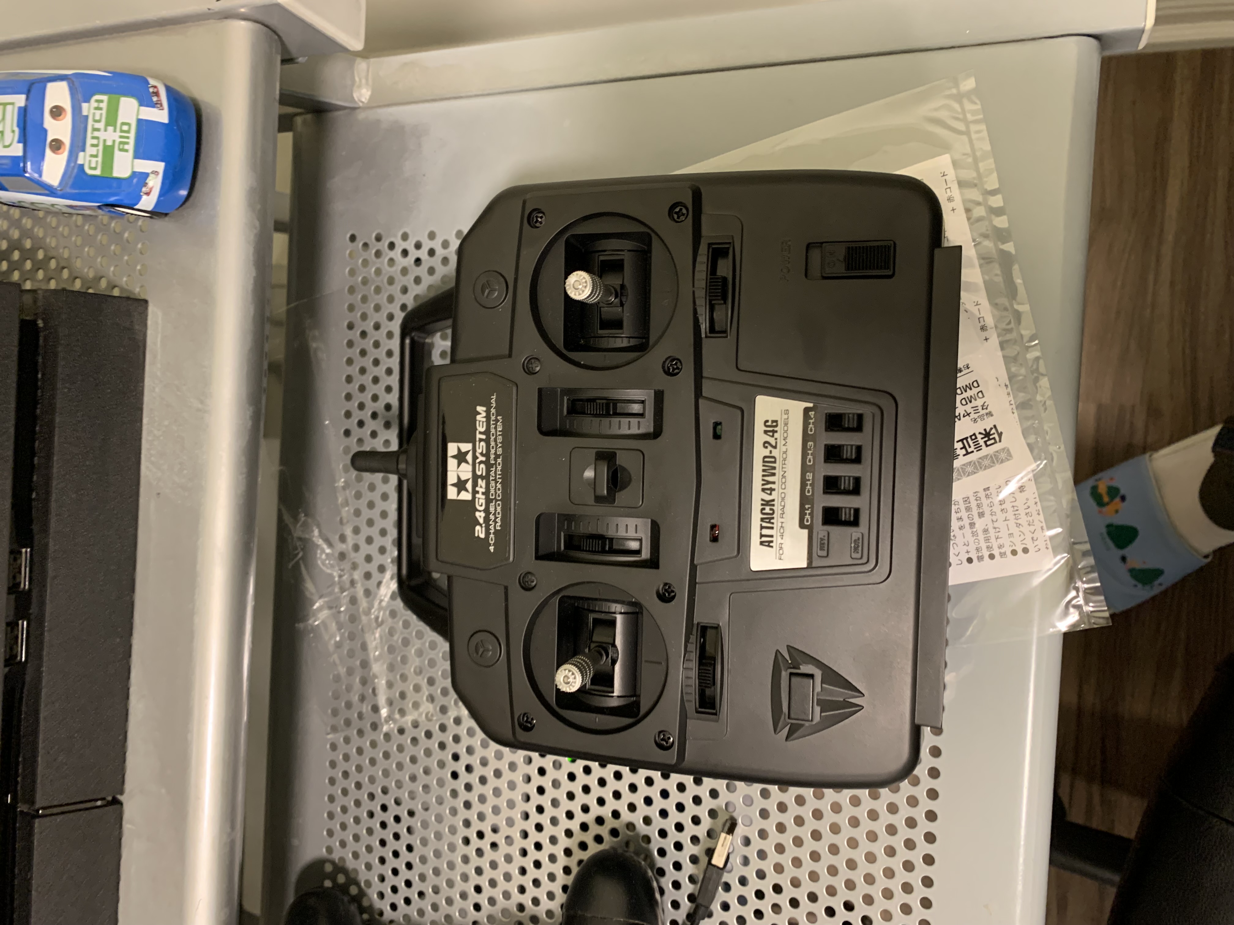

Yes I do know it ran straight yesterday albeit the road wheel did not spin but now there is a slight veering which I compensate with my control, anyway to adjust it, I believe it is the tracks and idler again but I have tightened both, anyway to adjust it like a trim?

Which radio are you using? If it's an analog 4ch Futaba/Tamiya Attack then you just use the slider trim to adjust it to get it straight.

Panzermechaniker wrote: Thu Jun 27, 2024 10:29 pm Which radio are you using? If it's an analog 4ch Futaba/Tamiya Attack then you just use the slider trim to adjust it to get it straight.
This is the controller I have, so to adjust it will be the disc thing at the bottom of the left stick, it veers left should I adjust it to the right?
