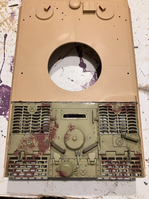

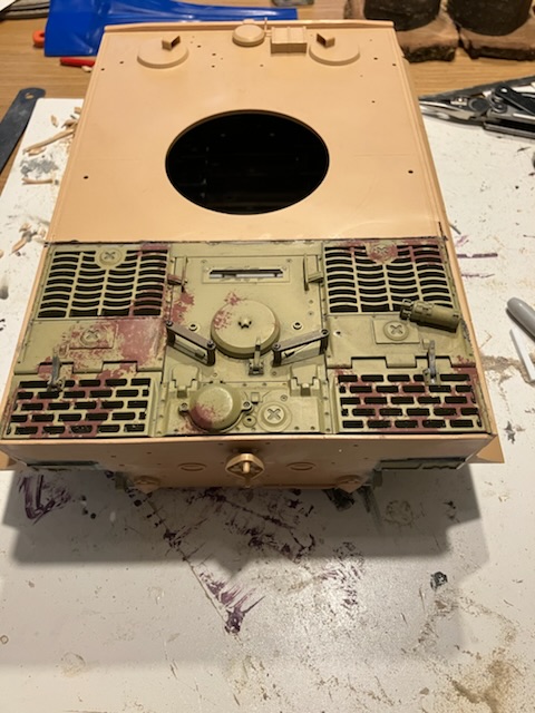

Free long weekend. The wife is away, on a girls holiday to somewhere or other. Went with the option of changing over the rear decks. Picked up a pad saw and a couple of blades.
Rear deck marked up.
No going back now.
A looks good and fits. Waiting on the glue to dry overnight then some filler.

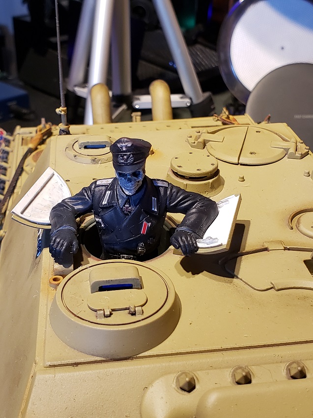

Thought I would throw this pic on here just for fun.
Posts: 7970
Re: Cheap Tiger 1. Not so Cheap
Good Afternoon!
Lets keep him Company!
Best shot of Von Norden.jpg (194.58 KiB) Viewed 14003 times
Jimster
Posts: 3440
Location: Illinois
Post by Jimster »
Ha ha! Yup, he needs to get into the spirit of things!

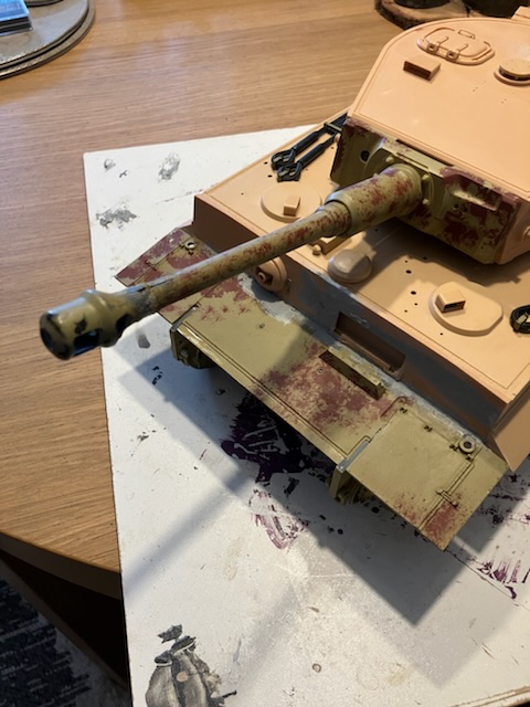

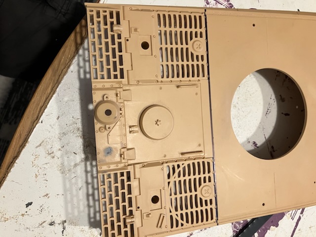

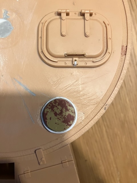

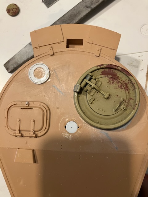

Managed to get some more work done on this today.
Grafted the front mudguards on, and removed the driver’s vision port.I am waiting on this, along with other parts, to come from Dave at Forgebear.
Hobby Boss track links fit with Tamiya tracks. This is to replace the broken one that came with the model. The tank came withe plastic tracks and I thought about using the the ones I had made for the static model. As there were a few spare HB links, why not try?
The repair parts for the rear idler are with Royal Mail. By next week I may have a working chassis.

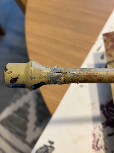

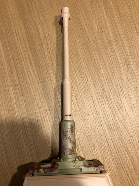

Gun barrel has been made to fit.
This looks better, although I had to repair it, as the end had been broken off at some point and been repaired with some tube externally. It now has some aluminium tube inside. It need some filler and cleaning up.

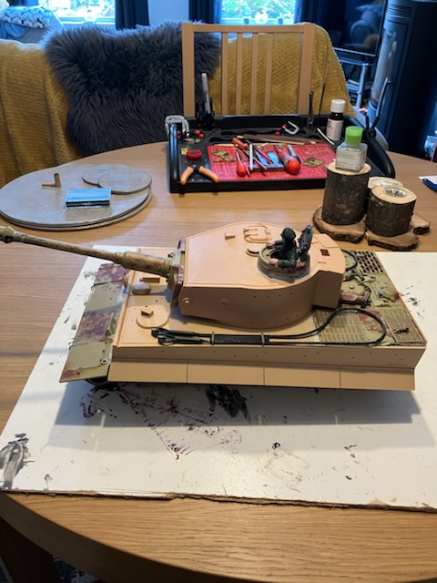

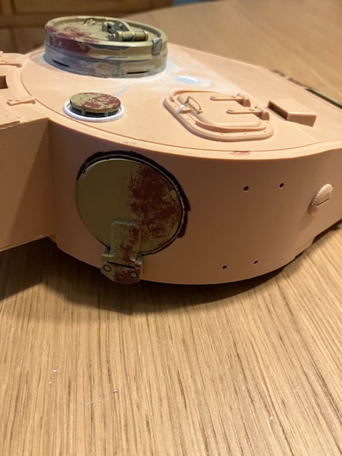

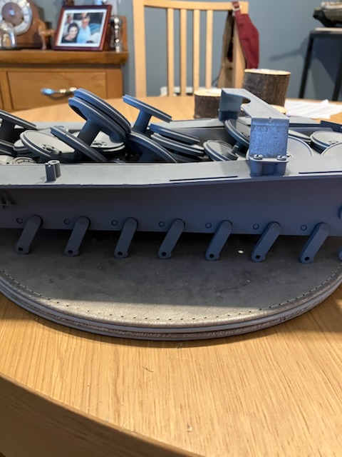

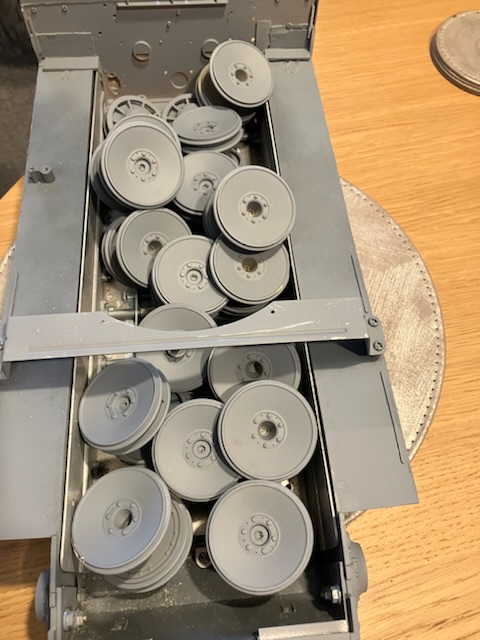

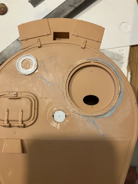

Being doing a little bit more on the Tiger.
Still not sure if the coupler is in the right position. Definitely was not in the correct place to start with. My bad. But you guys could have told me. 😭😭😭.
Also shown is a small amount of scratch building under the cover, for the turret vent.
The escape hatch was also moved over. This will be where the on/off switch will be located. Maybe.

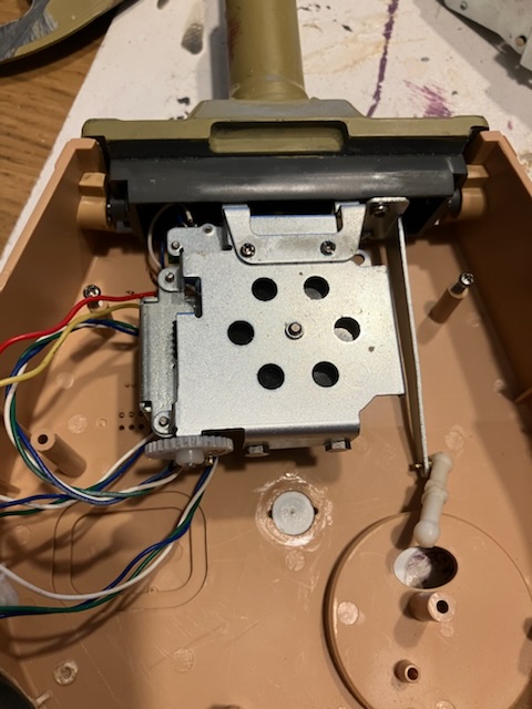

I decided that the Tamiya gun barrel was too badly damaged and replaced it with the HB barrel, and connected it to the Tamiya recoil unit. Much thanks to John1979 and Jofaur86, for getting this working. Just need to work out how to get the elevation to work. :headbang:
And finally, the lower hull and wheels are in etch primer.
Also rebuilt was the idler adjustment system, with new parts. This required a bit of fettling to fit. I may have a running chassis by the end of Sunday. Also I think the circuit for the gun elevation has failed. Oh well, I will rob the MFU from my T72 as this is going to be upgraded.
