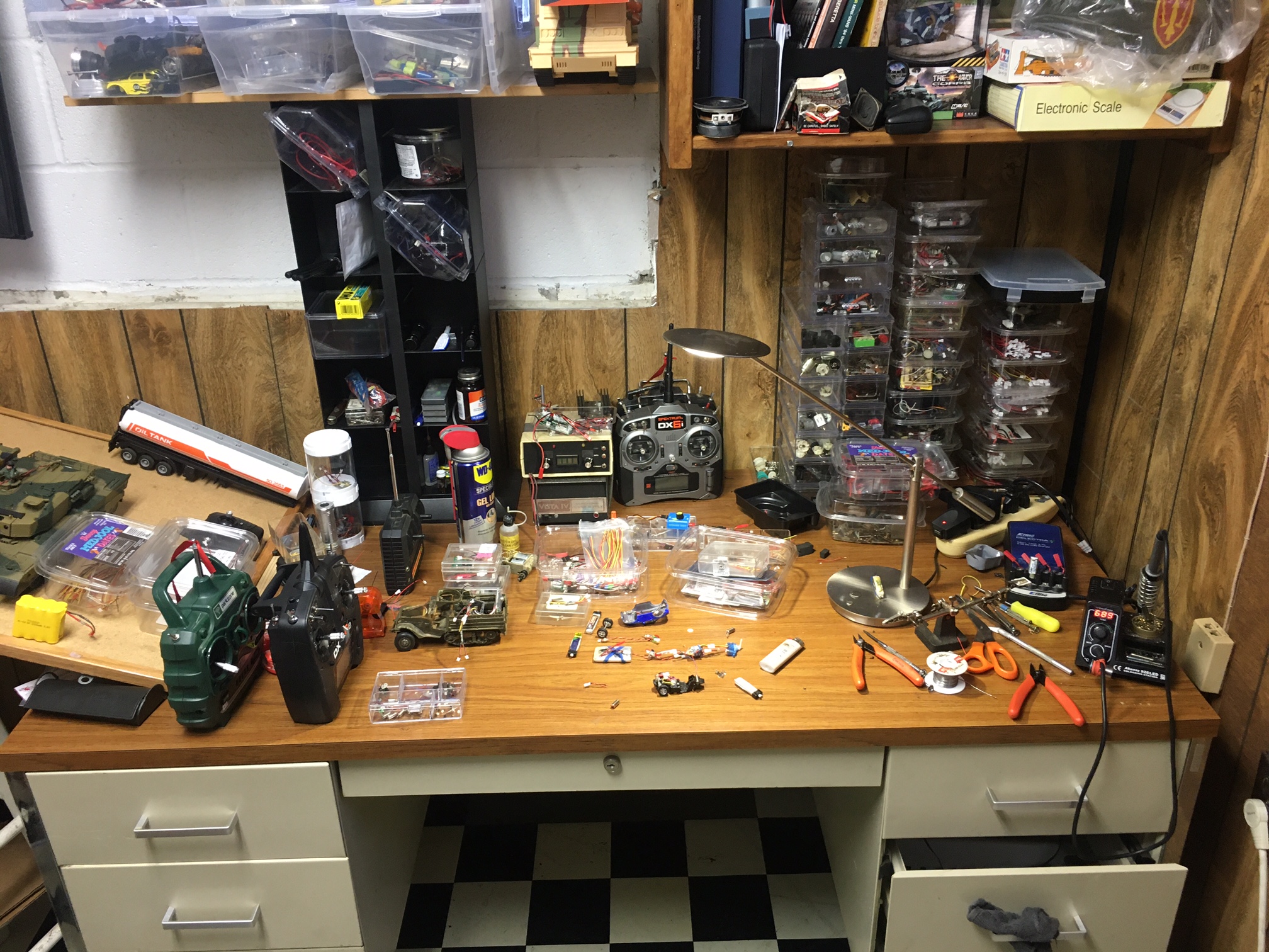

Well I lost my "in home" work shop but finally able to do some model work at my new car\model shop which I work on classic cars and models of all types with an electronics lab on the side :)

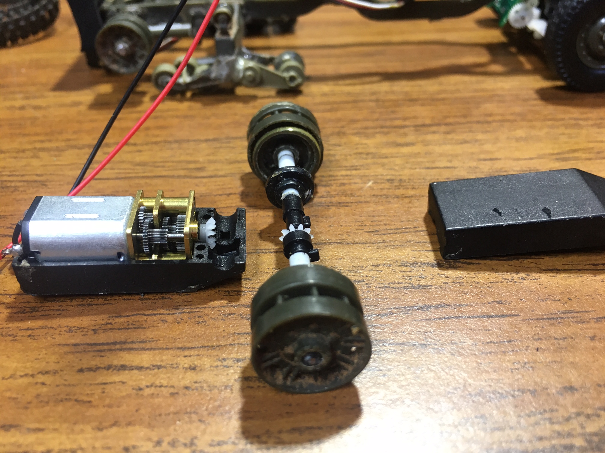

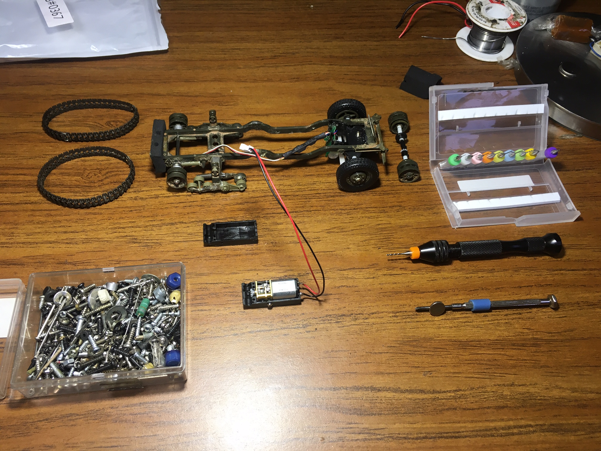

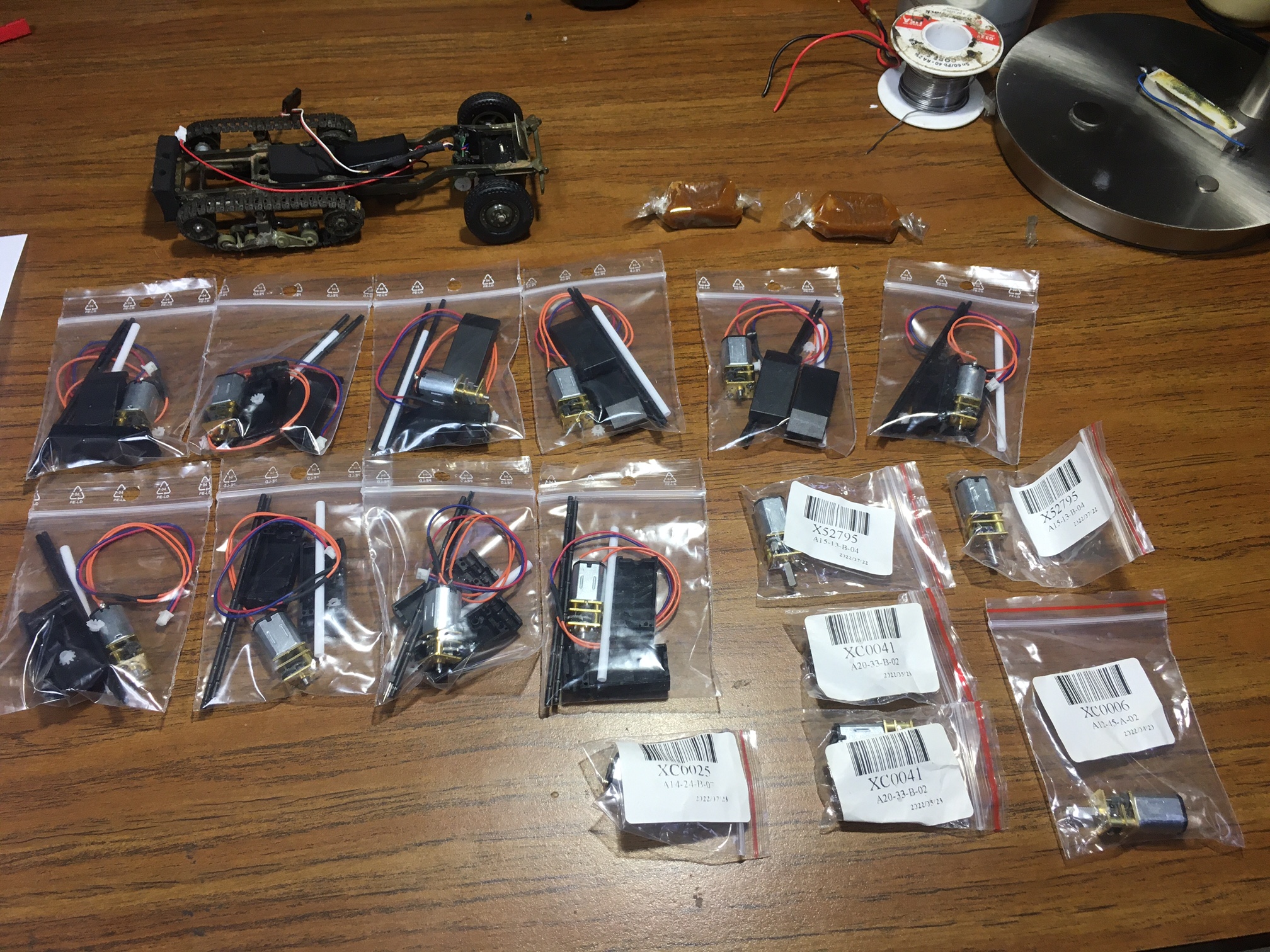

Decided to improve the gearbox mount on the Half track with a one screw mount that allows easy removal of the gearbox for service, motor upgrades, gear ratio swaps etc. I ordered 6 additional motor\gearboxes of different gear ratios so I can tune this model for optimum torque vs speed. MTM gearbox\differential needs to be removable to achieve this. I figured this mounting strategy out on a M10 Tank destroyer back in August of 022 and will now implement it on this M4 Half track.
These fancy micro gearboxes are a game changer for "animating scale models". I tried several times over the decades of years (45) to animate this M4 with limited success and was not able to use the stock M4 frame in those attempts but kept the frame in the hopes that some day I would be able to use it so as to have a accurate model of the M4 in 1.35 scale. I have about 35 1.35 scale models that are RRC and a few have been with me for decades so they are not too pretty to the casual observer. They are like time capsules to me and I get much pleasure seeing them MOVE under their own power ;)
10 MTM gearboxes directly from France. Also extra motors and metal gearboxes from ebay shown in lower right.
part of the work shop area

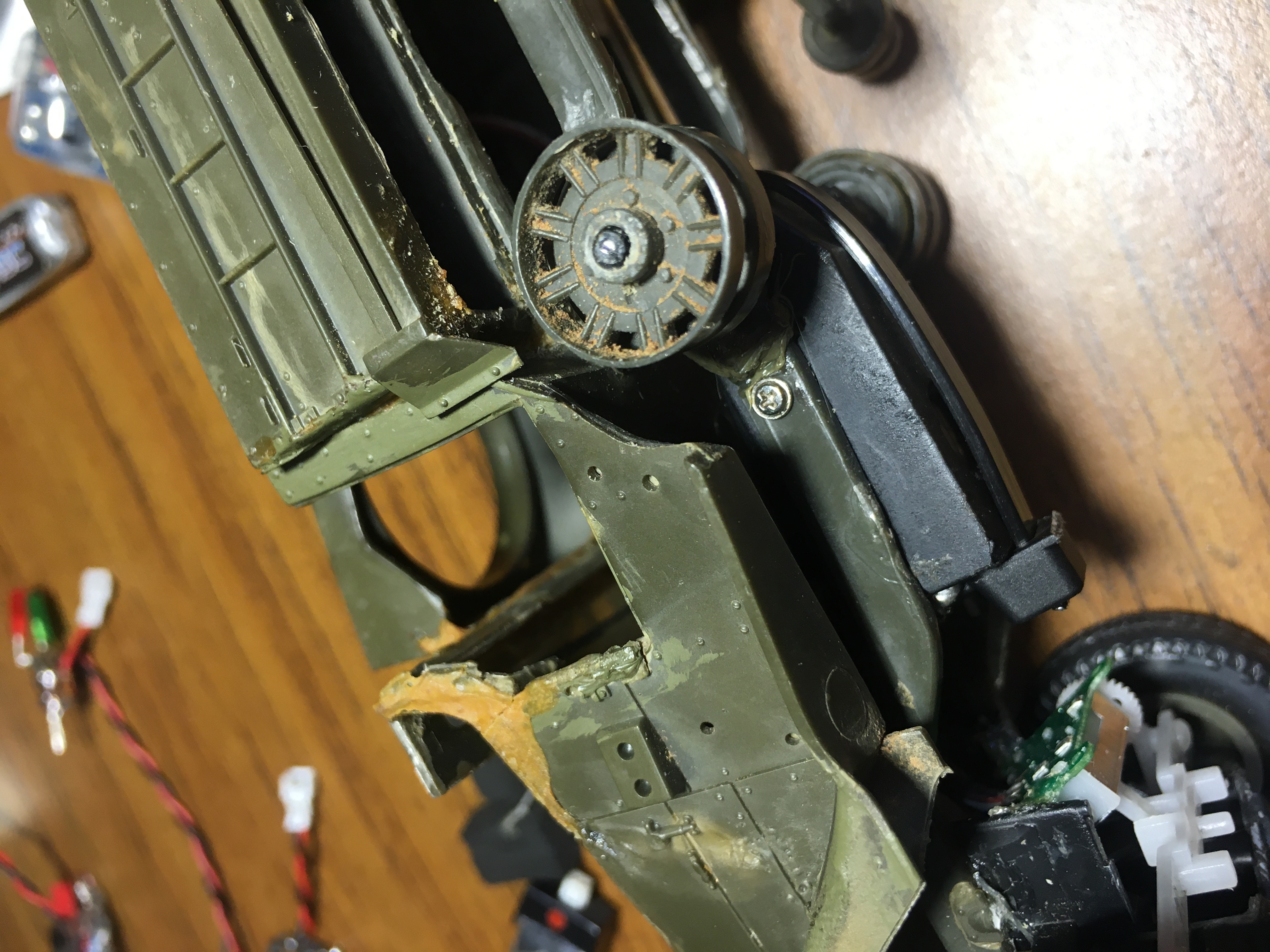

close up of screw mount. This model is 45 years old! You can see sand on the frame from Tucson Arizona (1982) when it sat in my model junkyard for 2 years.

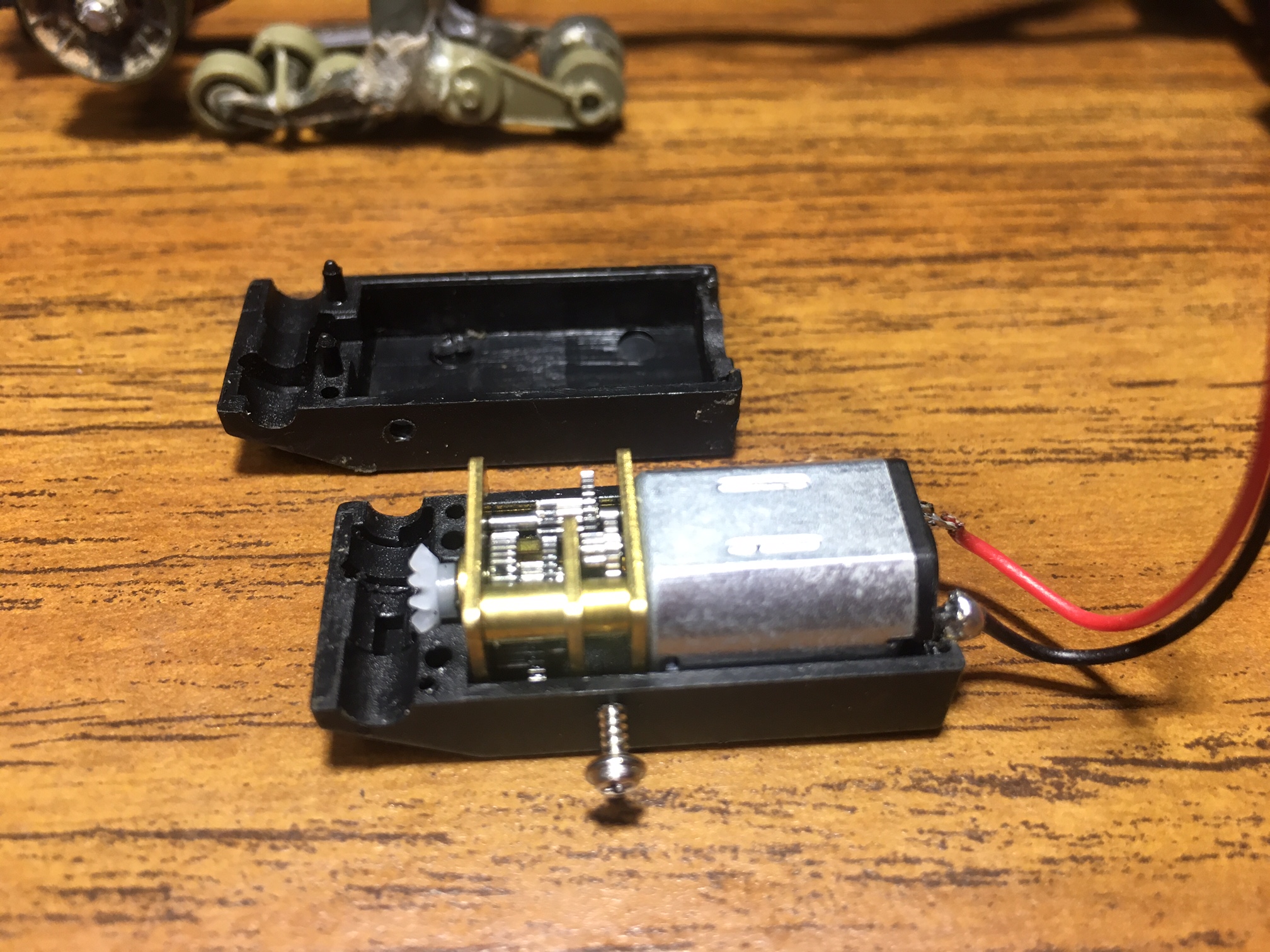

work in progress
work in progress
with the screw all the way in it is clear of any metal parts
correct orientation of case half and metal motor drive

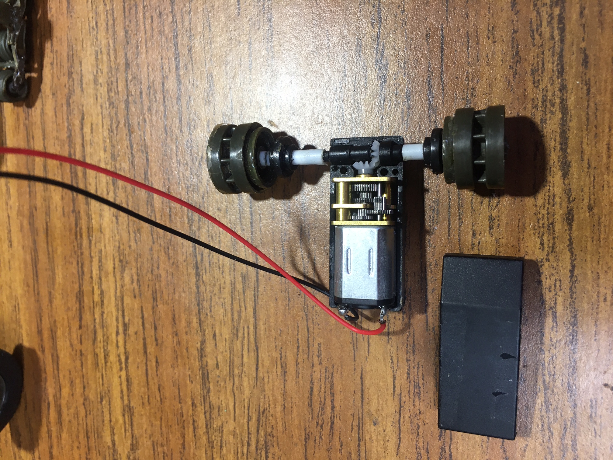

placing the axle is a little tricky with 2 bearing lined up
ready for final assembly
Screw mount a success

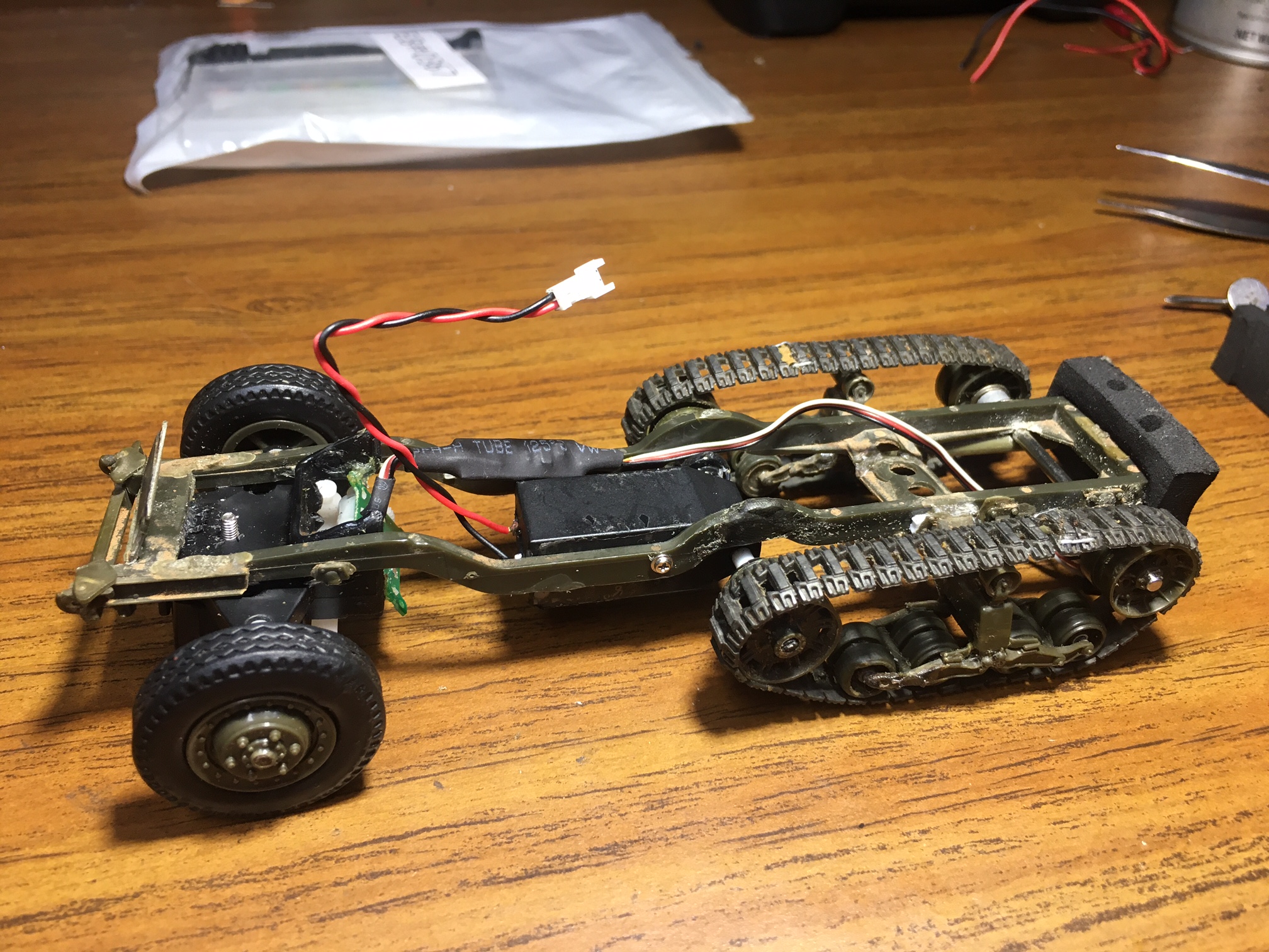

With the GB secured and with the proper track tension, the M4 Half track is now back on line with no track slippage.
Here are the things I have done to make the MTM GB installation more robust and serviceable.
1. Modified the axle assembly so that it is a 1 piece steel axle inside the 2 piece plastic outer axle. Then the outer plastic axles are joined in the middle with CA glue after fittings the ring gear in flat keyed center of the 2 piece black plastic axles.
2. GB mounting hole drilled into correct half of GB shell. This allows service and or repair or motor change.
3.Plastic tie strap secures the black plastic outer GB shell. This along with screw mount allows GB shell to come apart as opposed to being glued in place.
Yes I know this model is beat up due to many attempts at "animation" but thats OK because it is the prototype and future models will be much better esthetically I'm sure.
So the major elements of animation for this model are.....
1. UM servo added to modified toy steering escapement for steering. I would have used the stock steering had it been present.
2. Improved Ultra Micro MTM GB for track drive using the stock polymer tracks with strengthened stock track bogie system.
3. 1s DSM2 6 channel radio system featuring low power 1s 30~100 mAh lipo operation.

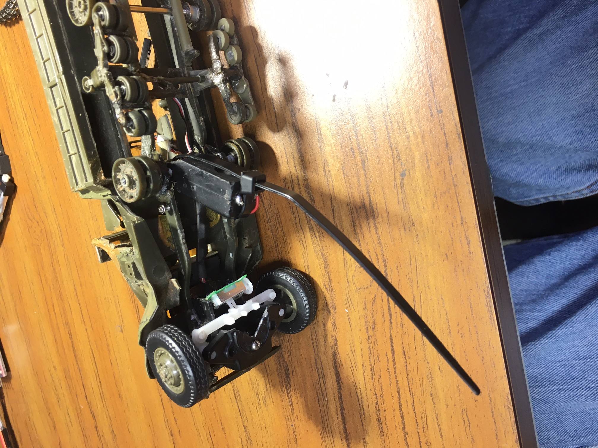

Black Tie strap secures the 2 piece GB shell. To access inside the GB shall, the Tie strap is cut.
MTM GB reattached with 1 screw mount.
IMG_9374 (1).JPG (2.12 MiB) Viewed 58100 times

Tie strap holding the GB shell together. This shot is before trimming excess. If GB access required, the Tie strap is snipped away and after repair or upgrade, new Tie strap secures the GB. So this is a Hobby Grade Gear box as it can come apart for service, motor swap etc.

The photo shows a tie strap mod for holding the GB together instead of gluing it together. This mod makes the Gearbox "Hobby Grade"

Testing the M4 HT proves this mod and the GB screw mount works great.
