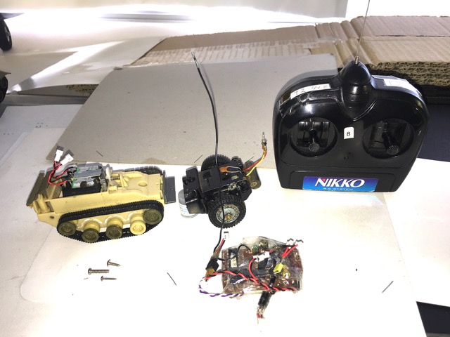

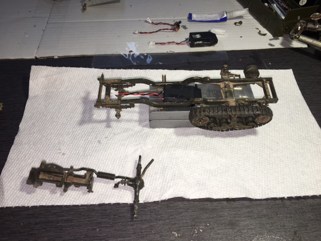

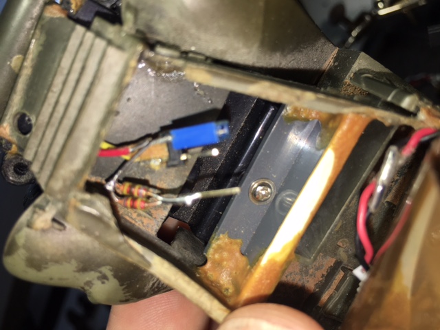

The chassis came from the Halftrack shown in this picture. It is a running model but is crude compared to what I can build now. The two parts may wind up back as 1 unit again.

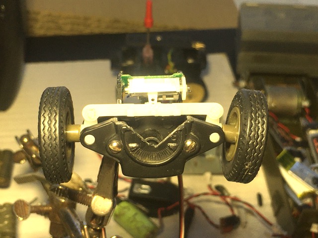

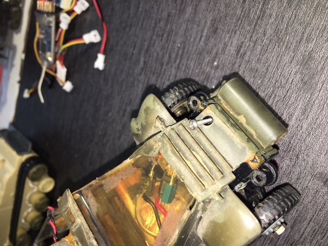

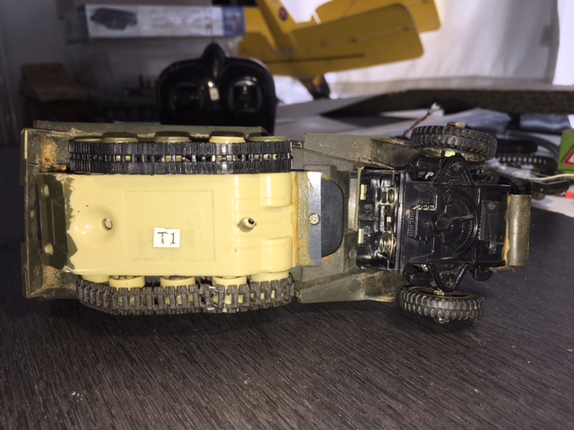

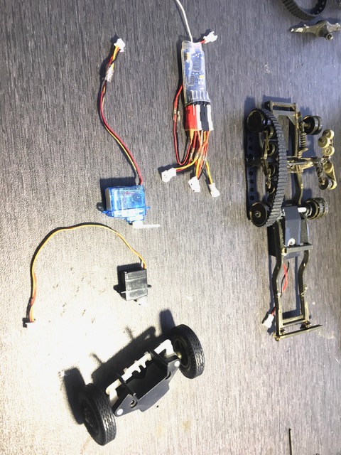

This is an Escapement stye steering box that has been converted to proportional steering box with Ultra micro servo.

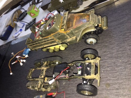

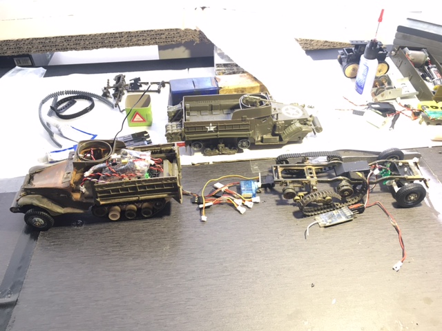

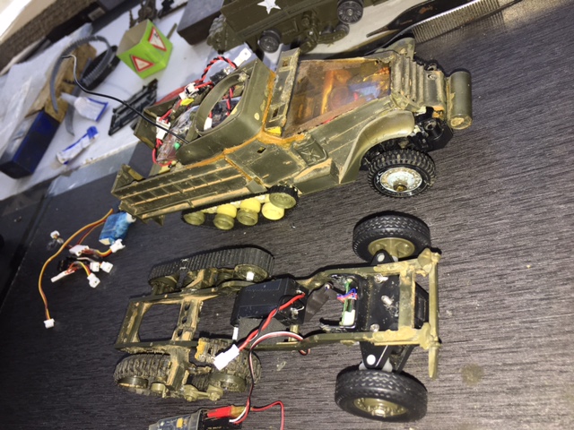

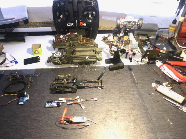

busy workshop with lots of parts coming together
figuring out which servo to use
steering box test fit

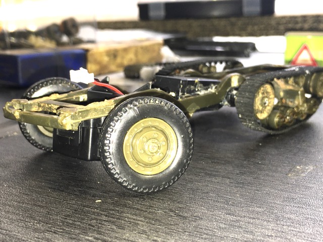

The right side has been parched up and works good now

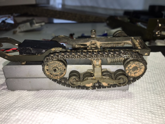

Some Arizona (1984) sand in these wheels from sitting in my model junkyard in Tucson AZ.
the right side needs wheel bogie repair, can't find a new one of these at this time so will repair this one for now.

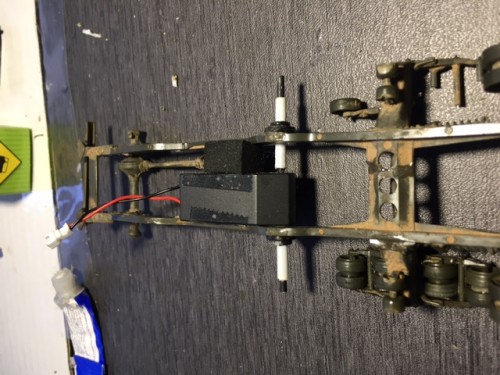

MTM gearbox axle assembly modified to be a bit stronger as it is going to drive 2 poly tracks.

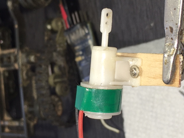

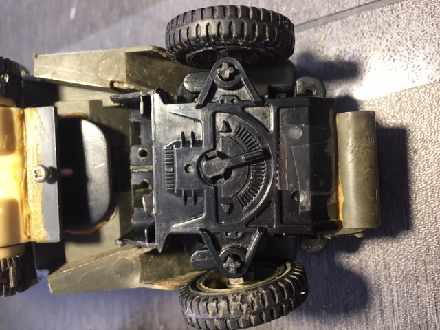

The earliest form of sequential (although not proportional) actuator for radio control was the escapement. Like the device used in clocks, this escapement controls the release of stored energy from a spring or rubber band.
An "Escarpment servo actuator" is a linear device (not proportional) that was used in early radio control planes to move the Rudder Left\Right in both extremes of movement and when not called to actuate the Rudder (or elevator, ailerons), will return to center or neutral position. These were used before digital proportional servos were available.
Back in 1977, when China mass produced radio control cars became available at the malls, They were elaborate, well made Toys that featured "Digital Proportional" speed and steering and were expensive. As time went by, They figured out how to make them less expensive with "Bang Bang" steering using a new form of steering "Escapement actuator". Suddenly most Toy grade cars had this style of steering actuator and to make them even cheaper, no more proportional speed control as now they went "full on\off and reverse.
Full on\off is also called "Bang Bang or escapement style speed control as well as BANG BANG steering which is full left or right when steering command is issued then returns to center position when steering command ends with a center position adjustment lever.
So basically, a R\C Escapement actuator is similar to a servo in its function. It has a few drawbacks compared to a digital servo but has one major advantage, it is cheap to manufacture compared to a digital servo. These are very common in
toy grade radio control vehicles.
For years, I would cut the Escarpment steering out of Toy Cars and use them in models like Half Tracks. I am now converting those steering actuators to "Digital proportional" servo steering boxes.
M4 Escapement steering box bottom view with "return to center" motion

This steering Escapement has been converted to a Digital promotional steering box. Not scale looking but very robust and will last for decades. Scale steering looks better of course but is very delicate and hard to repair but has its place on a nice scale model that runs on a smooth surface.

Halftrack build area is busy. A DP HT is in process.

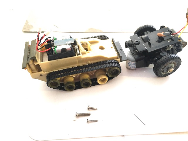

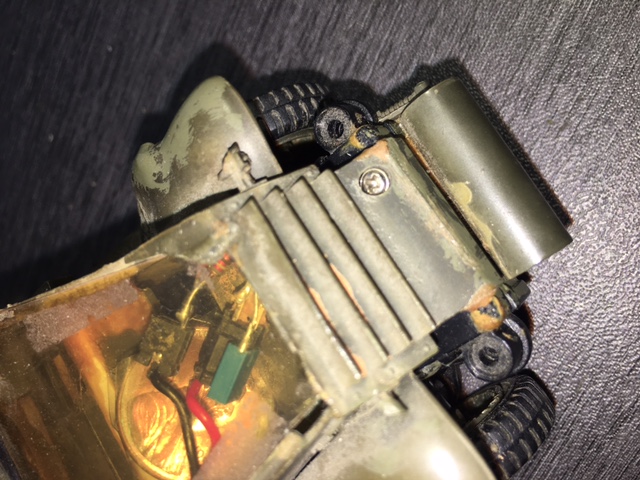

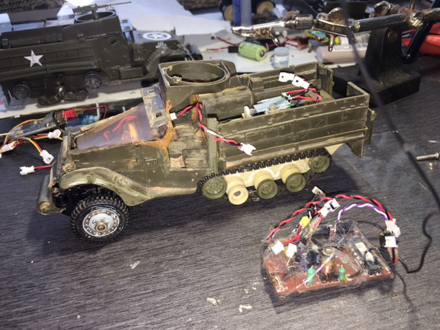

oh look, upper complete (unibody mount no frame) drive line removed with 3 screws. This is a feature I perfected along the way to 1/35 model work. They have to come apart like a real machine as apposed to being  glued in place like a "static" model
IMG_8462 (1).JPG (94.17 KiB) Viewed 63580 times
second screw in here
first screw removed
first screw removed

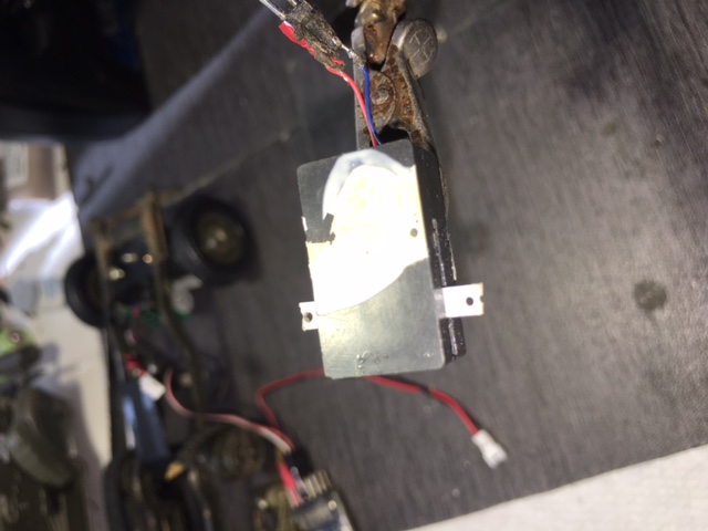

now to remove "Escapement" steering box, which is held in place by two screws

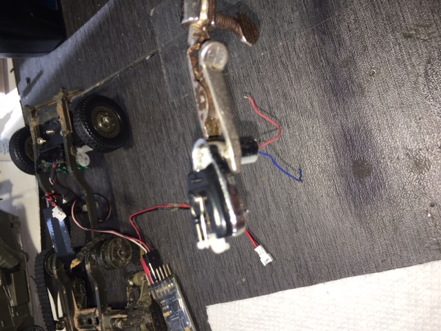

old track drive assembly removed. It was held in place by 1 screw.

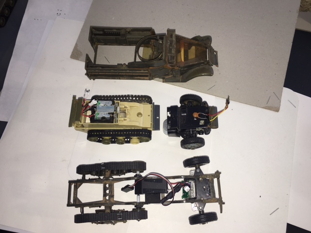

it is time to upgrade this M4, let the disassembly begin staring with the old radio system.

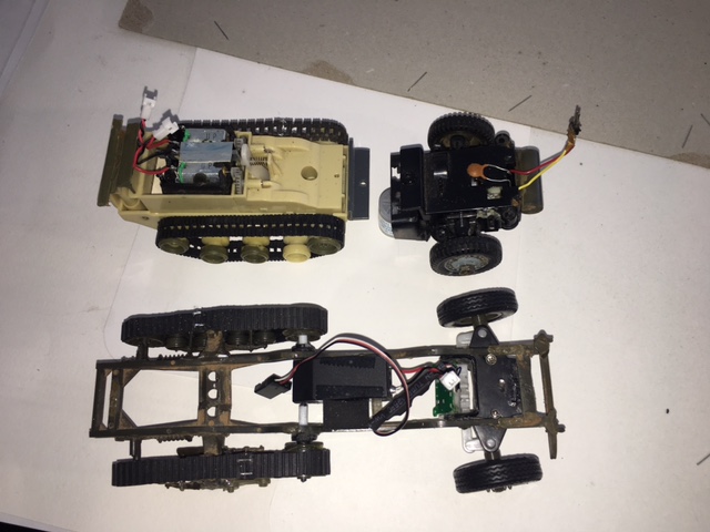

well, this looks better. The MTM gearbox has opened up new possibilities for a more scale like appearance and operation of the stock tracks.

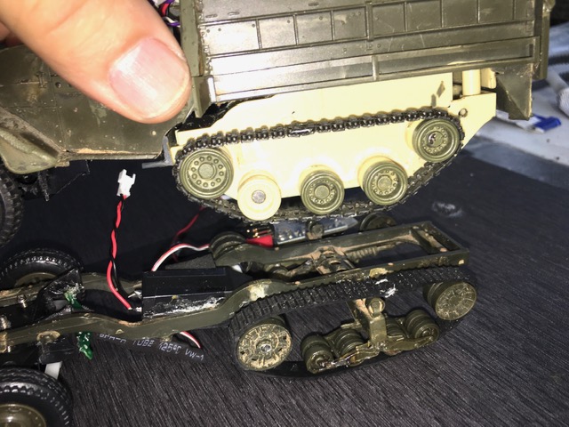

This upper track assembly uses the stock 1/35 tracks. Now those tracks will be used on the scale chassis\rollers\sprockets\idler wheels

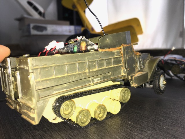

yes it has toy parts in it from that era as that is the best I could muster skill wise at that time. You have to start some where.
This early attempt (1999) at a half track has a crude suspension as this track assembly floats in the body assembly.

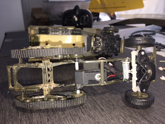

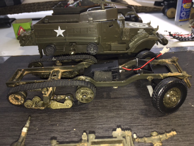

As you can see the old M4 Is going to get an update 8) I can no longer stand to looks at it in its present form 8O
This update will reunite the well used frame to the well used body and will re-join the ranks of my favorite models Arizona patina as an extra bonus ;)
Now to fit the body back on the frame. The front wheels are too wide apart and will be made to fit the fender wells.

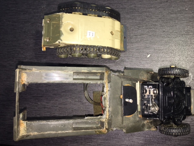

These elements will be replaced with updated versions
Here is the old drive line making its last appearance.
these two assemblies will be reunited at last after 23 years.
IMG_8464 (1).JPG (98.68 KiB) Viewed 63577 times
