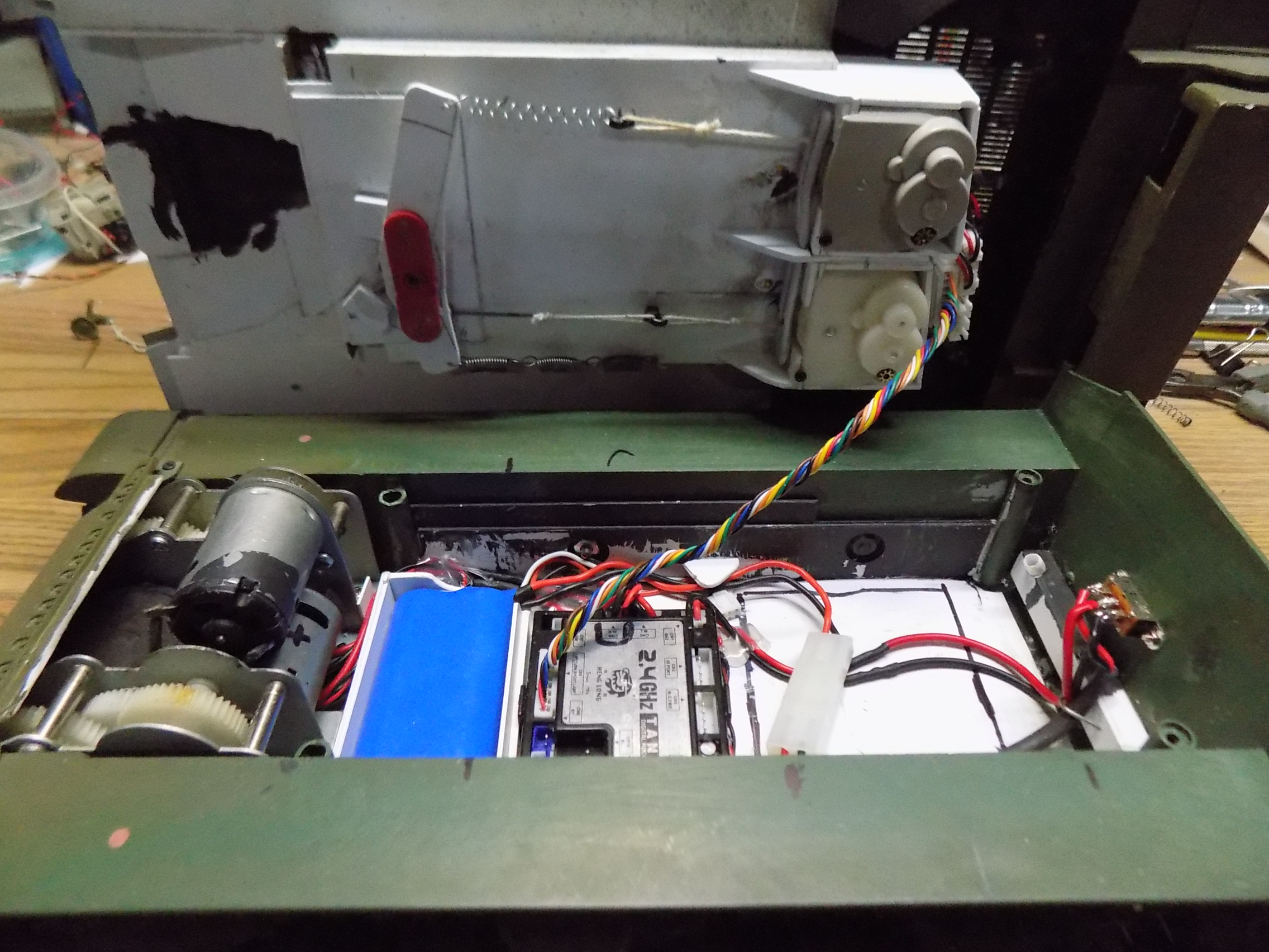

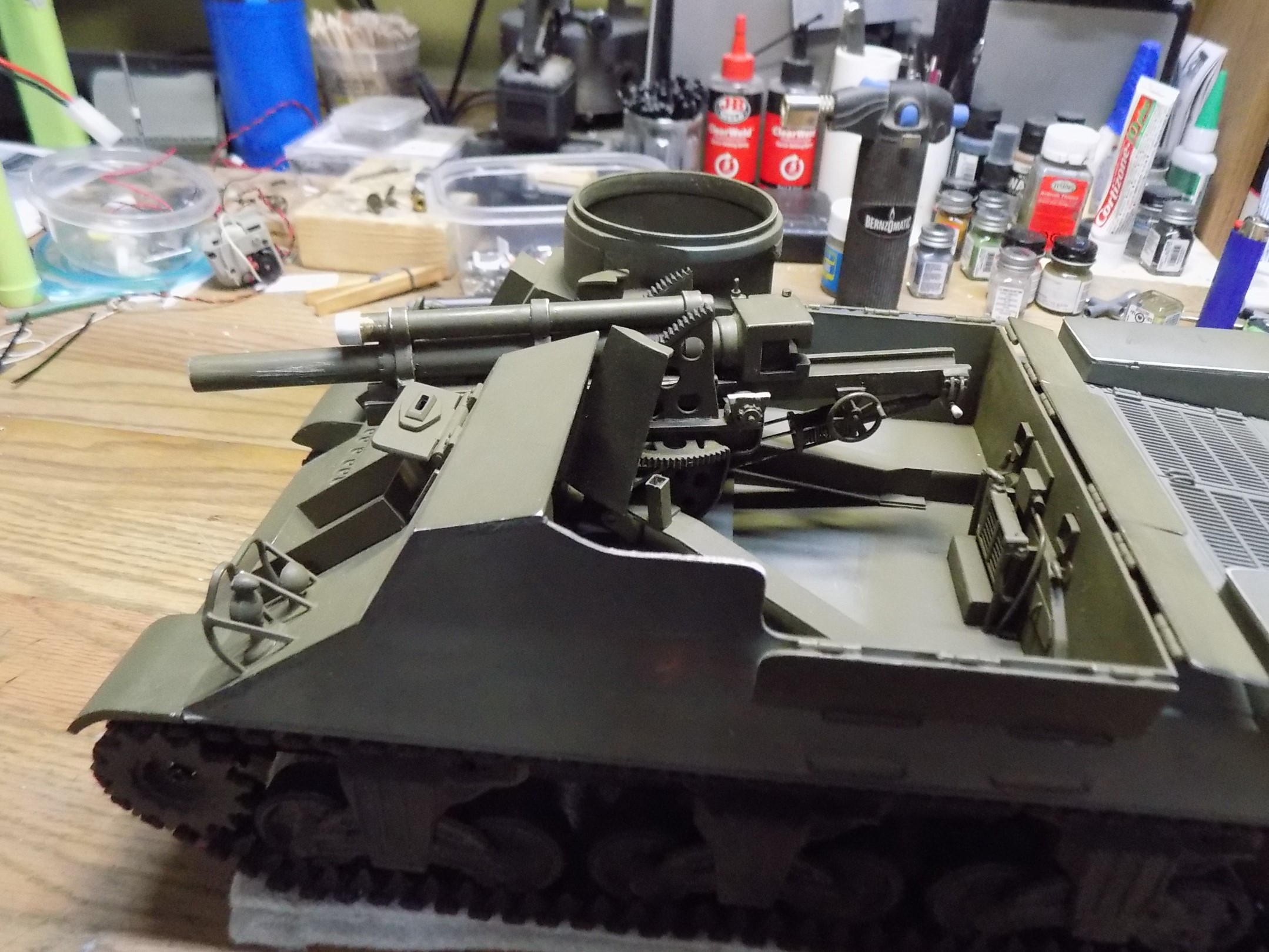

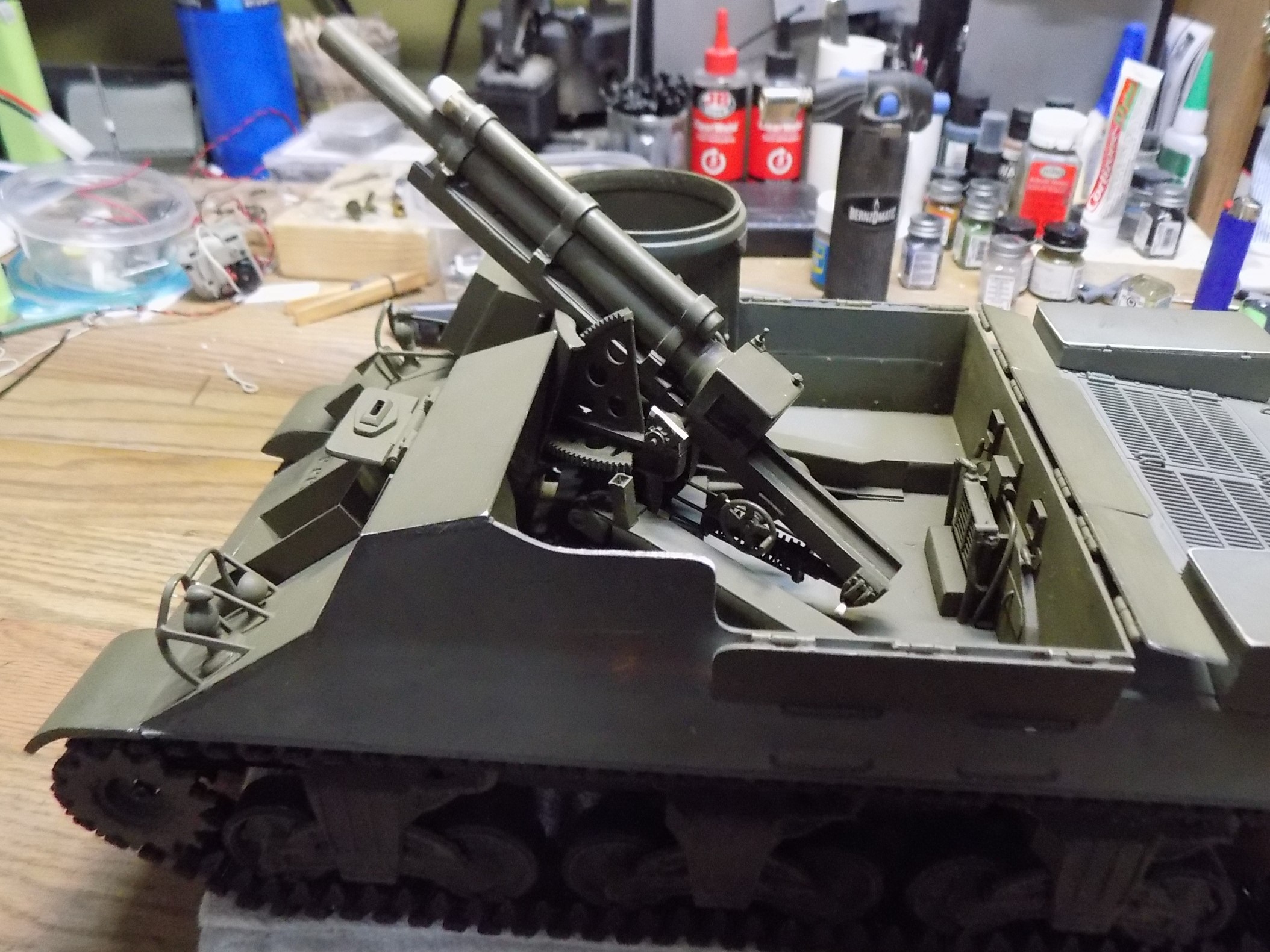

The first two pictures show full travel in traverse and elevation from the working "servos".

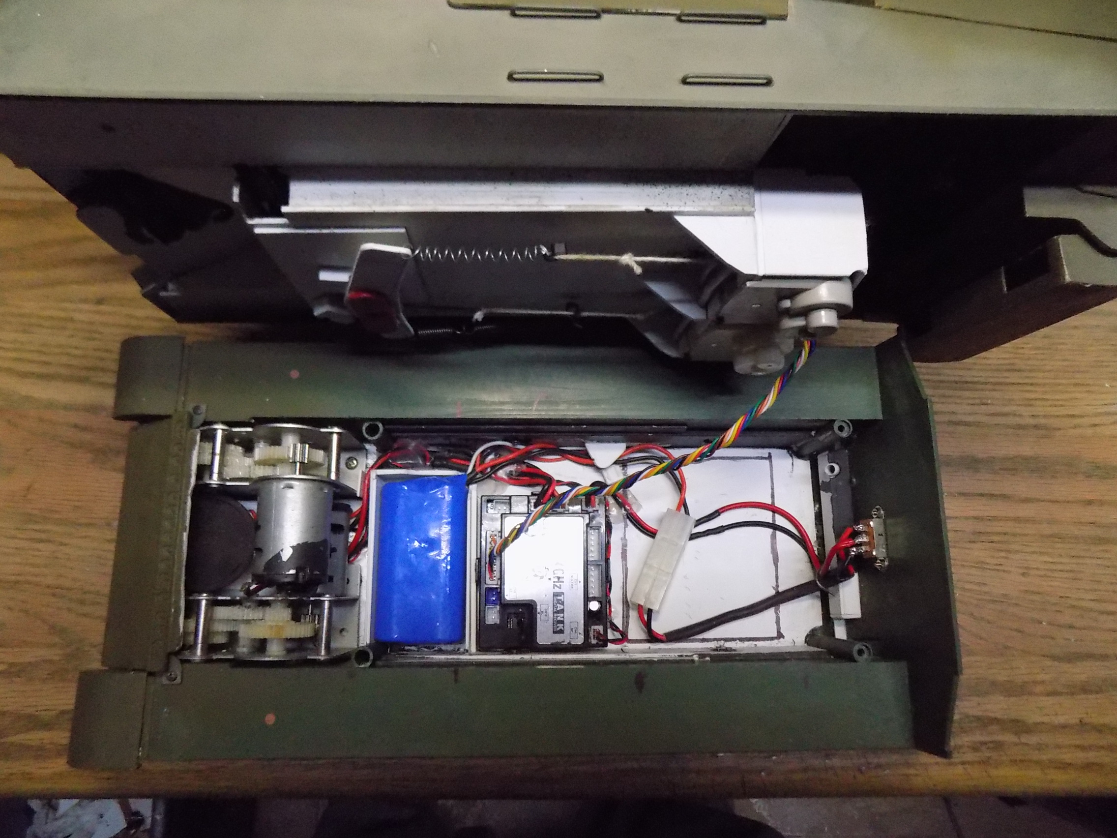

Inside the contraption. The black mark on the floor was space used by the servos. I did have a smoker and battery in the rear of the hull, but that space was needed. The housing less speaker is between the transmissions up front. The winches are really strong and have broken a couple strings already, and are quite noisy (like the air soft units are). The three linked springs are from the air soft units cut up for the build. The longer spring is from a ball point pen. I intend on changing these out, but this is testing phase.

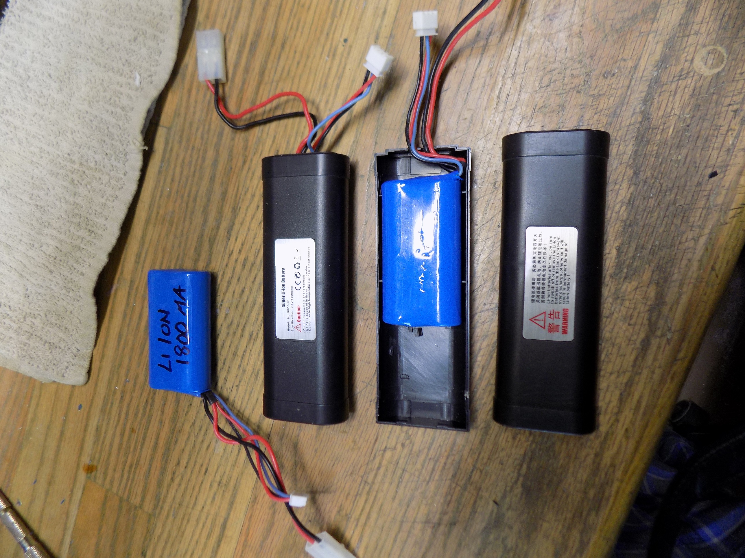

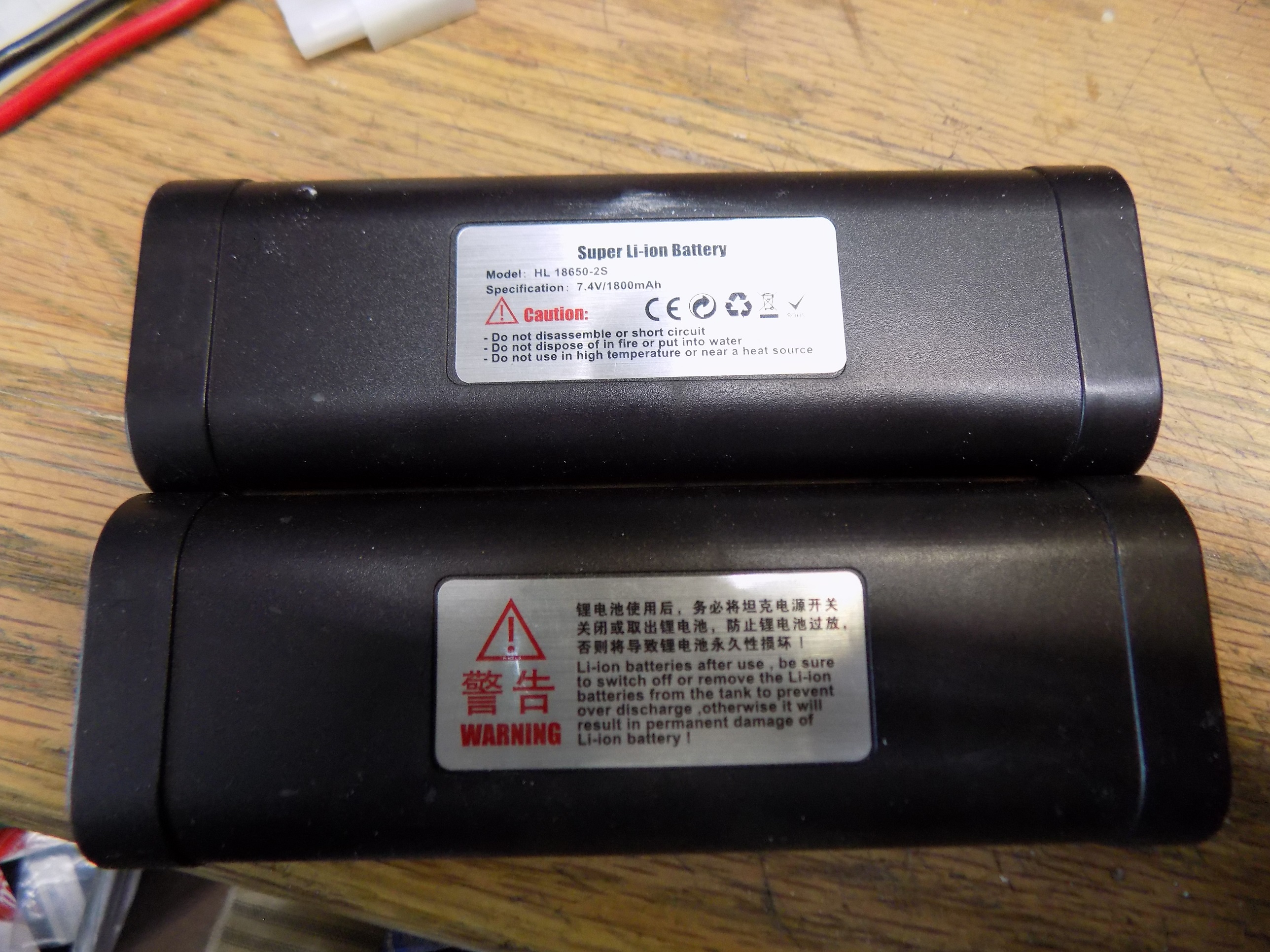

The battery is a HL that came with several of my tanks. It was inside a plastic "hull" that replicated a 7.2v stick pack. It is a Li-ion 1800 mAh 7.4v. Really handy for a compact battery solution.

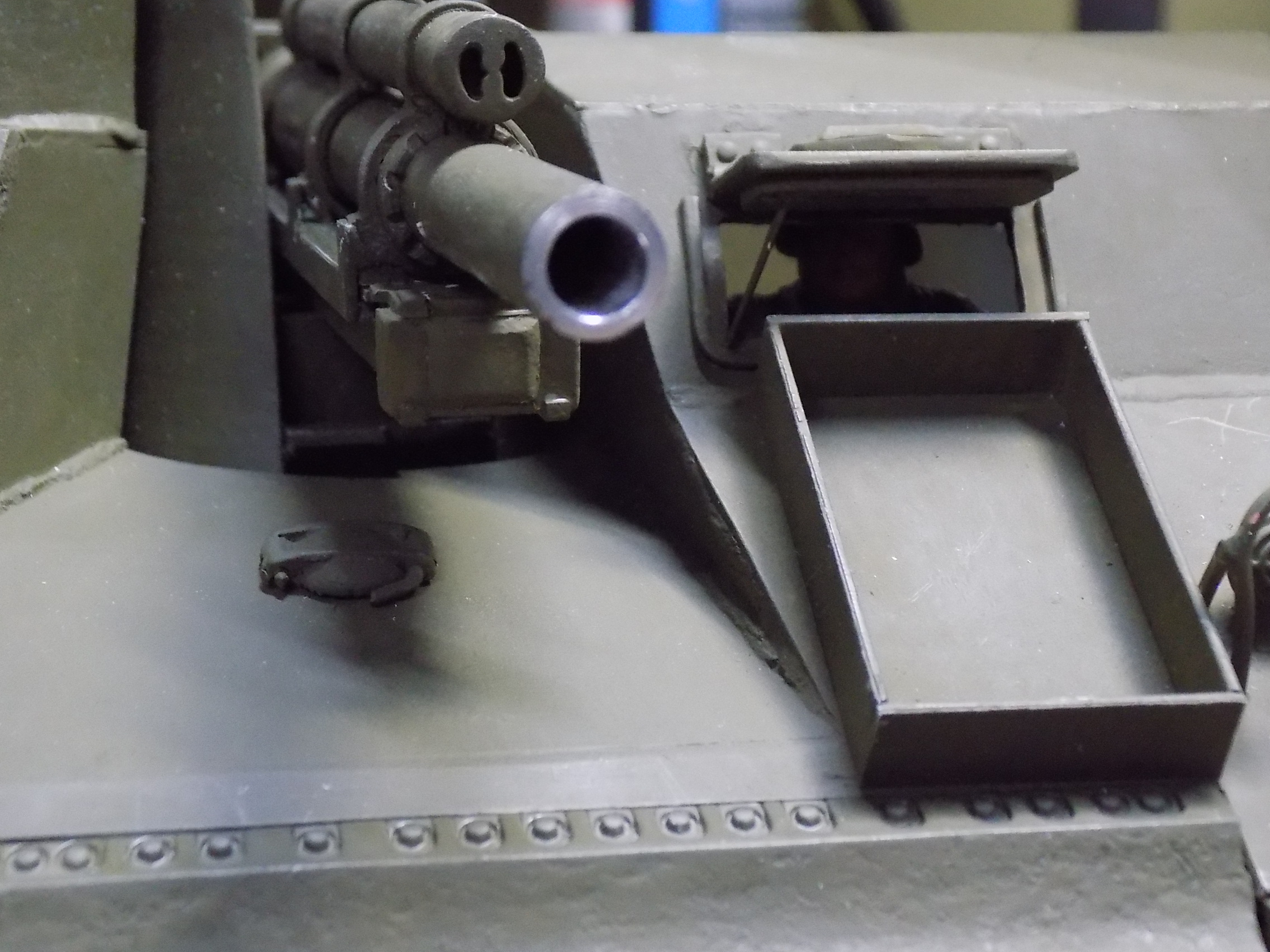

Finally a bit of gun detail.

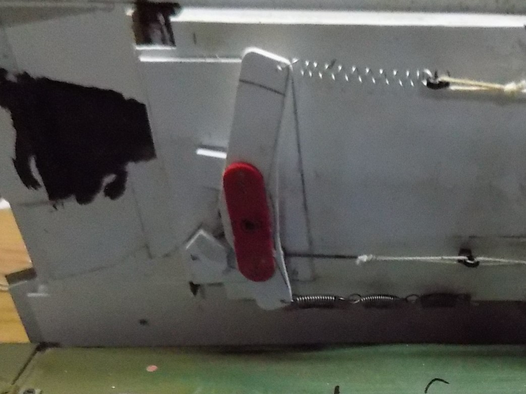

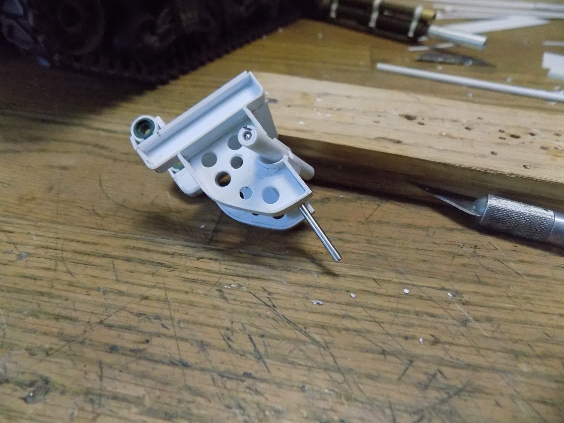

The picture shows the lower string going just below the "servo" arm. It has two "posts" (polished SS welding wire) it slides on. One is just above the tube as it heads up in the hull. The two blocks just in front of the servo arm support that post.
The pivot has set screws on top and bottom so the whole thing can be taken apart.

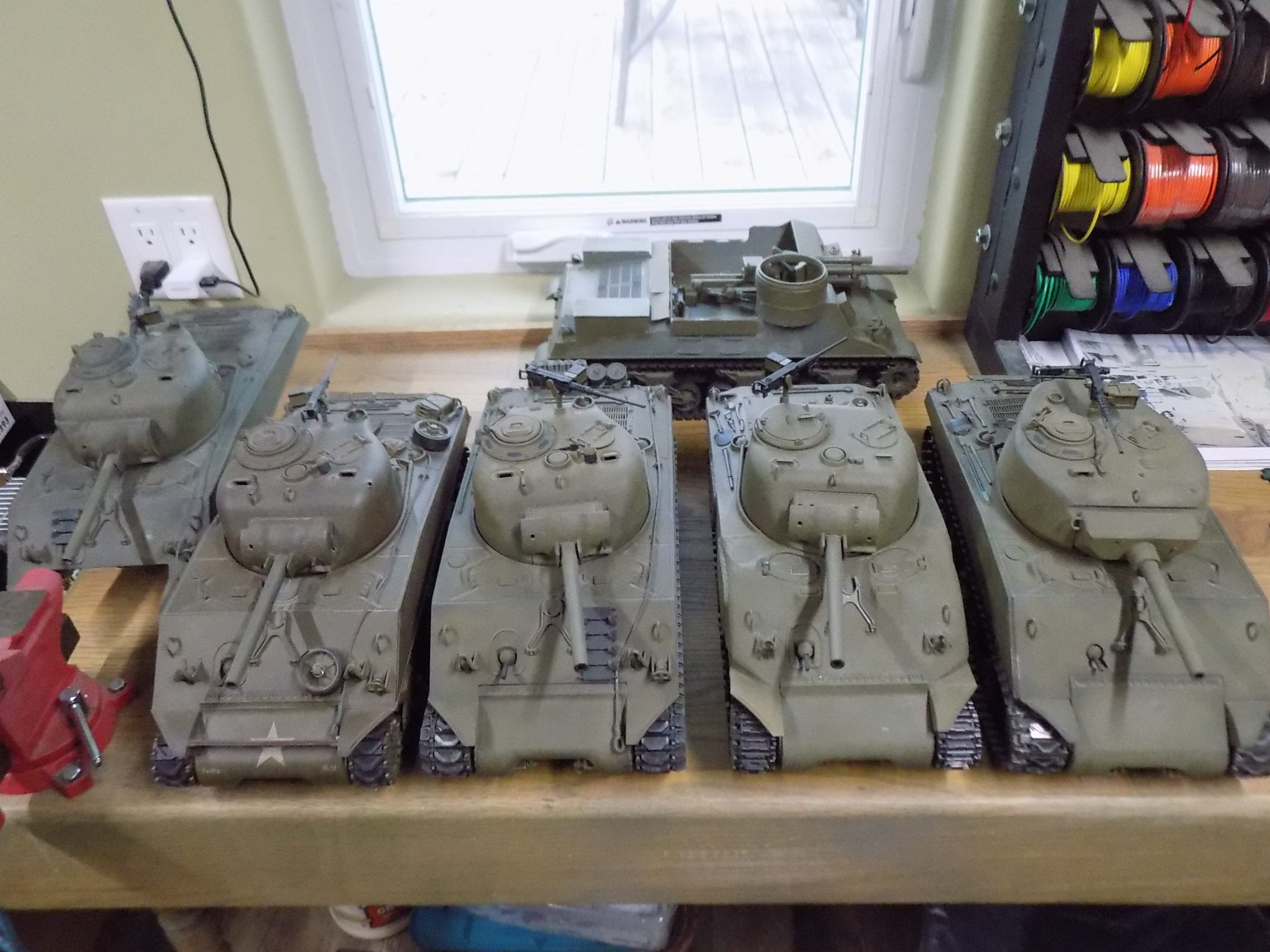

In keeping with my low cost theme, I thought I'd show where the lower hull and electronics were borrowed from. The tank on the left next to the vise/vice was my first tank. I never liked the look of the 105 M4 so I changed it to a 75. The empty upper was my 5th tank with two TD's and a Firefly in between. I decided it needed dry armor pieces added. Several tanks later I figured out that all the Fisher built M4A3's were wet ammo stored units. Also, I had a few 75's, and it was a near clone to my first tank, so it was gladly my donor.

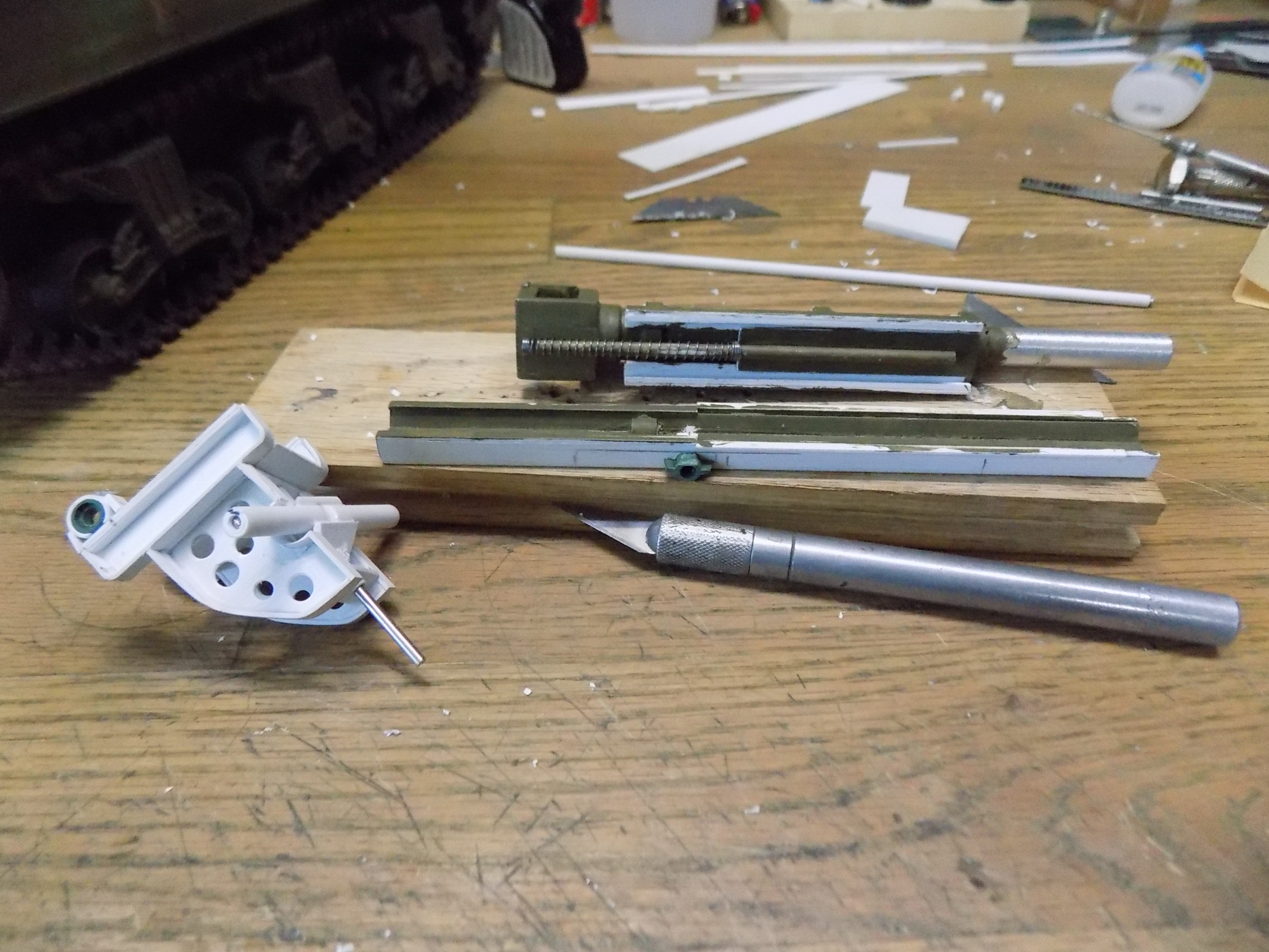

Found a couple pictures of the gun and gun mount from earlier in the build. Also a picture of what I want to add when the project is finished.

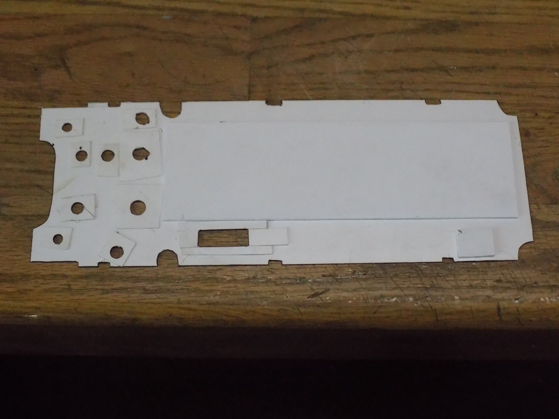

A .020 template that I use on the HL M4A3's. I reproduce this in .080 Aluminum and bond it with two part epoxy. That has made my plasic lowers nearly as strong as metal lowers

The newest HL M4A3 changed. I'll have to make a new template to match. I've reworked most of my tanks. I am not convinced that metal lowers are needed.
