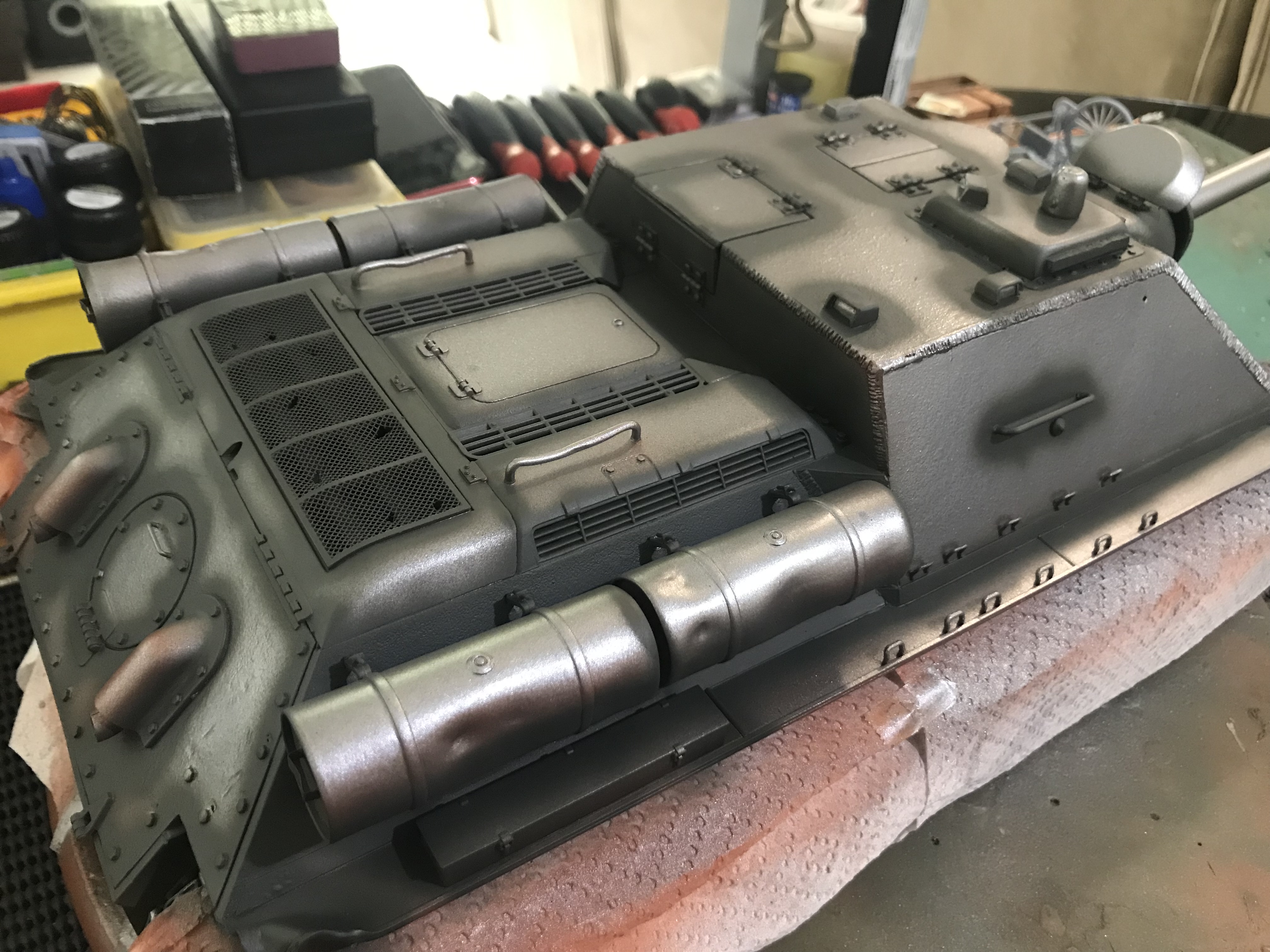

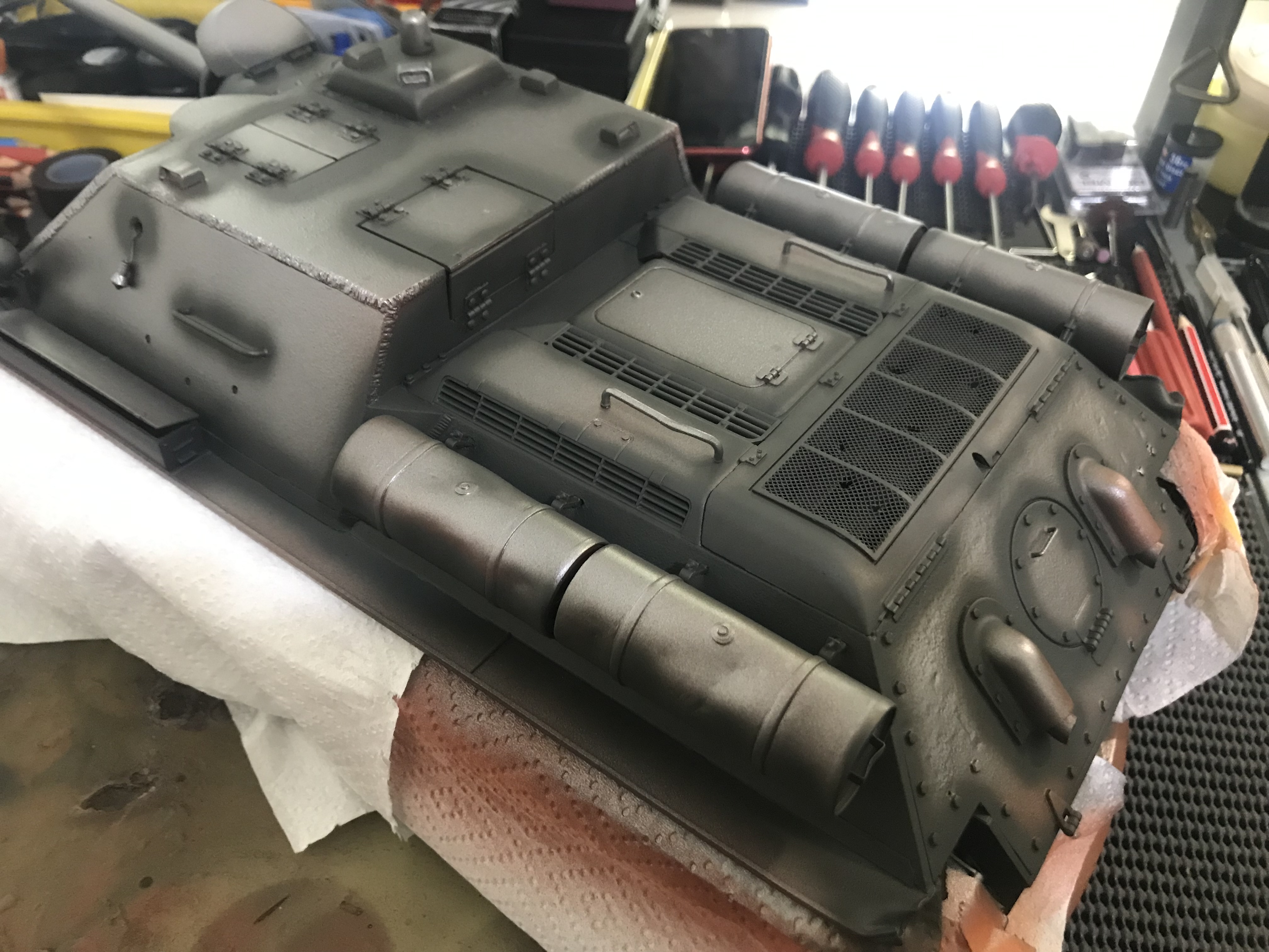

Held up waiting for a couple of servo’s to arrive, so going on with basic little bits to keep moving on .

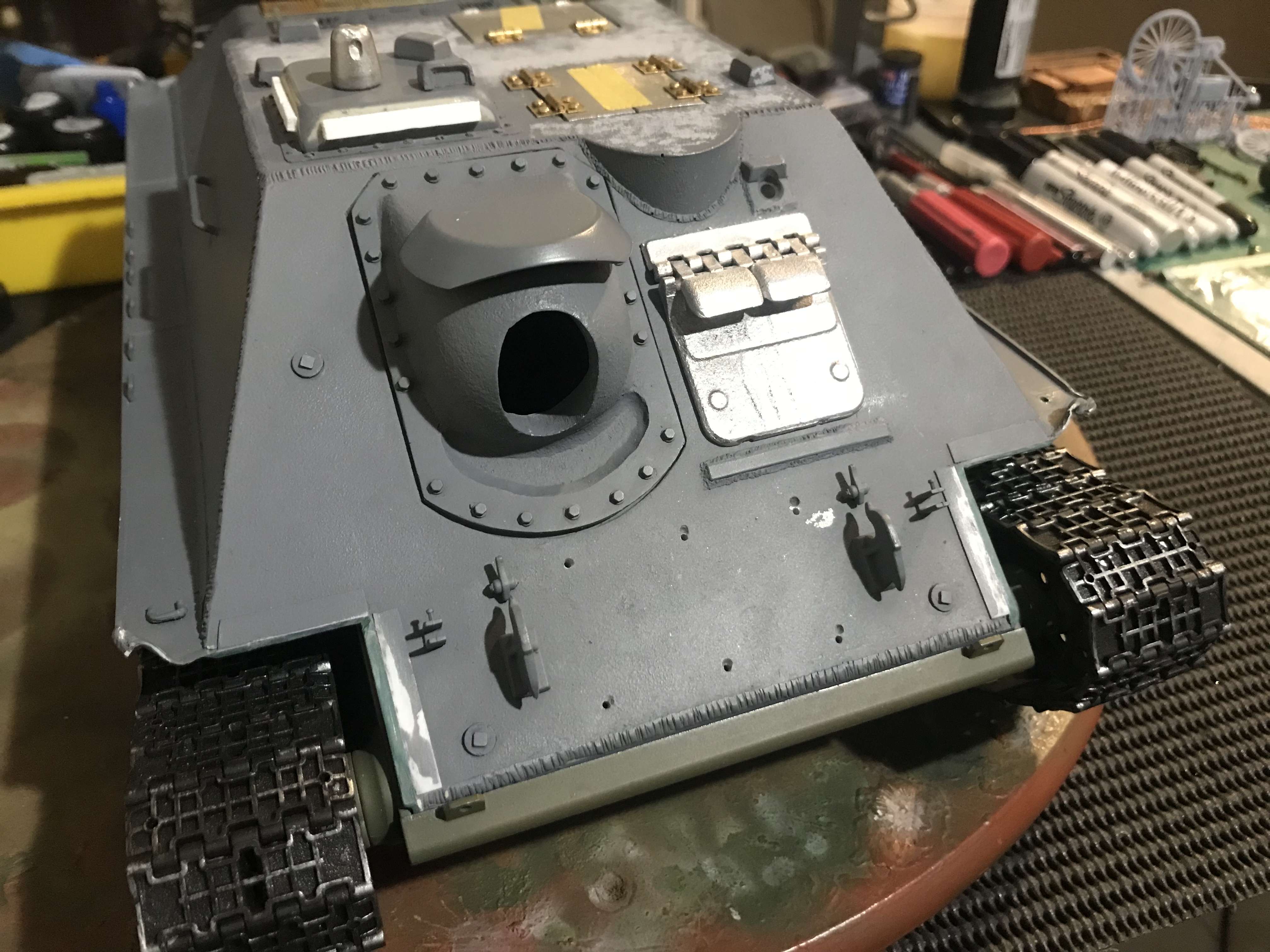

The immaculate guards had to come off! I just can’t cope with factory fresh unless it’s 100% unavoidable !
After they gave way,I used a carefully directed jet from a heat gun to soften the thinned out plastic, then bent it into reasonable shapes of crushed sheet metal.

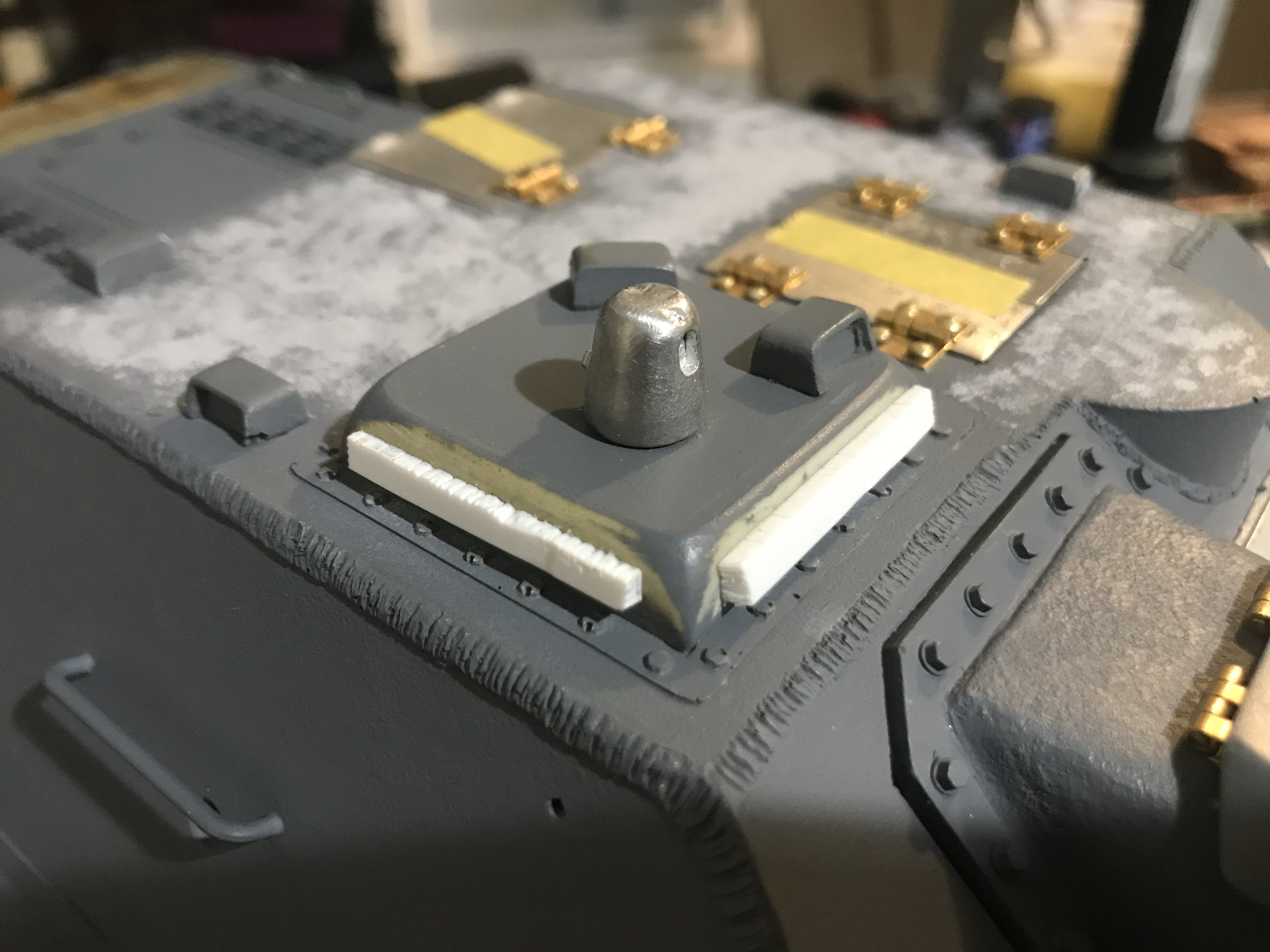

I also added small sections of styrene to the cupola after seeing a period picture of an SU85 with this field applied add on armour on it.Still need to do weld beads on them.

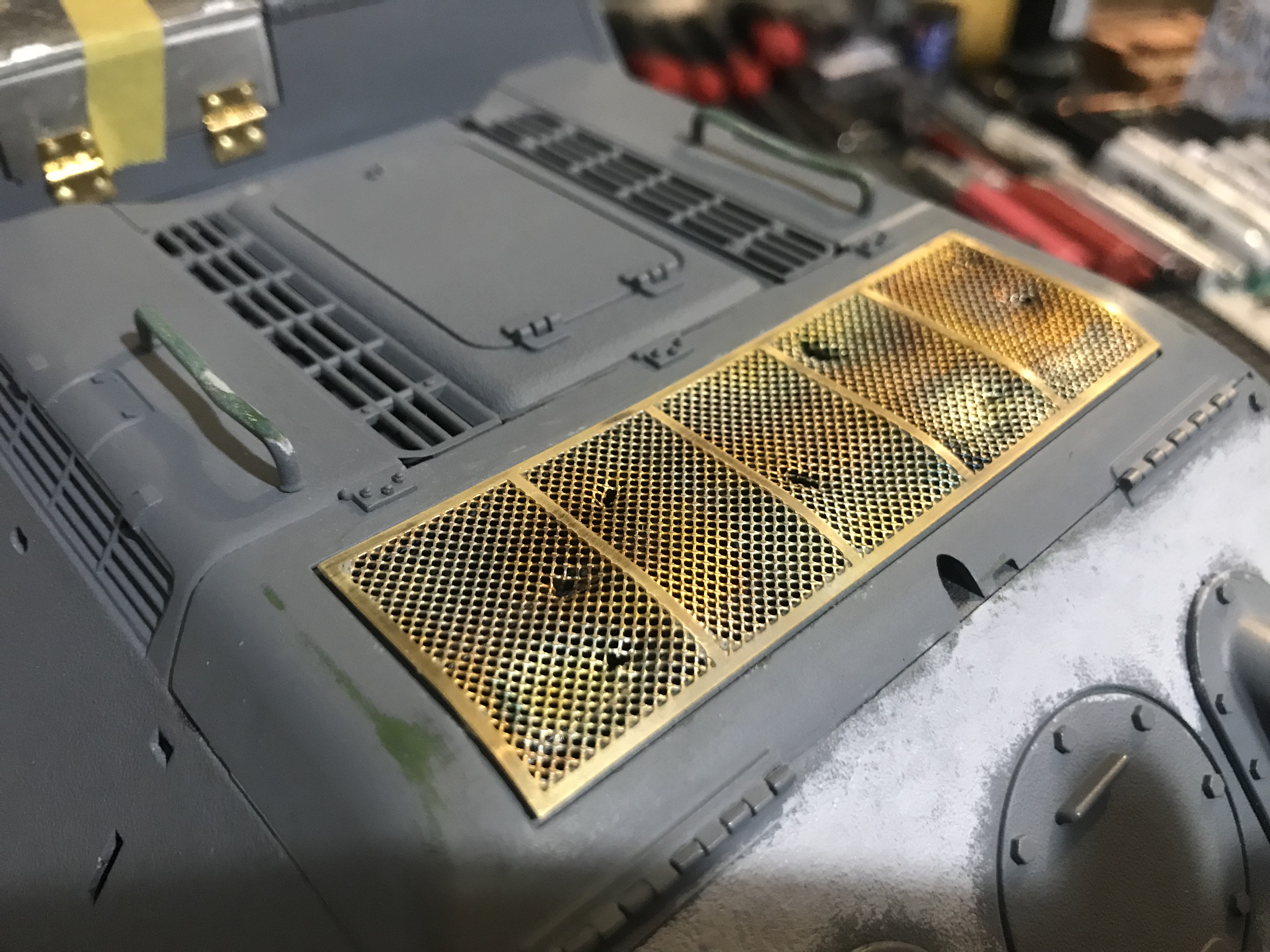

The engine deck transmission cover mesh was also treated to a bit of abuse, I annealed it with a burner to make it easier to shape, and to touch up with damage.
The drivers hatch was assembled with all its shiny bits & might be made to remain open, if I can get a suitable figure to perch inside it !
The fuel tanks are ready, dented and right to fit when I can !

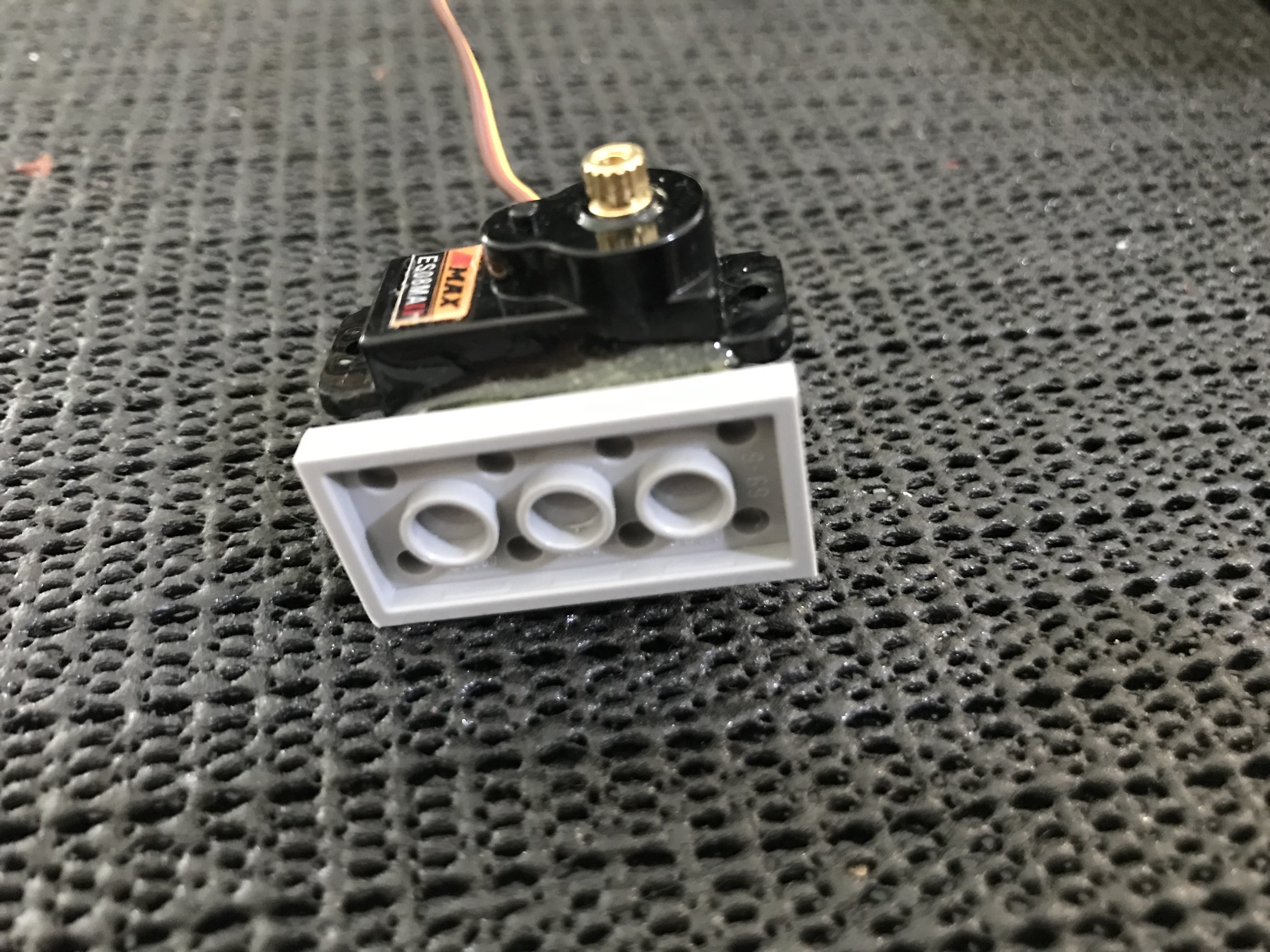

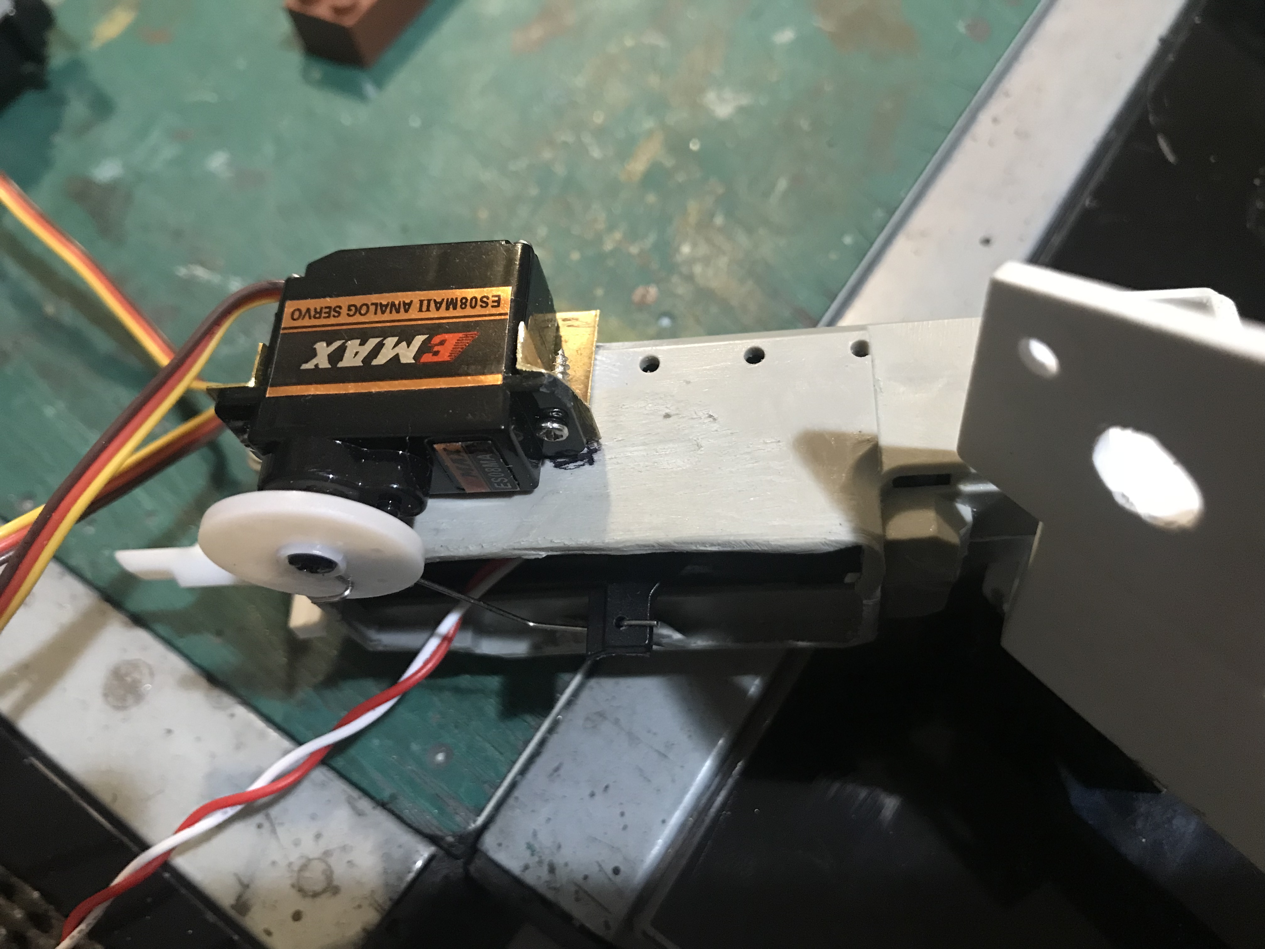

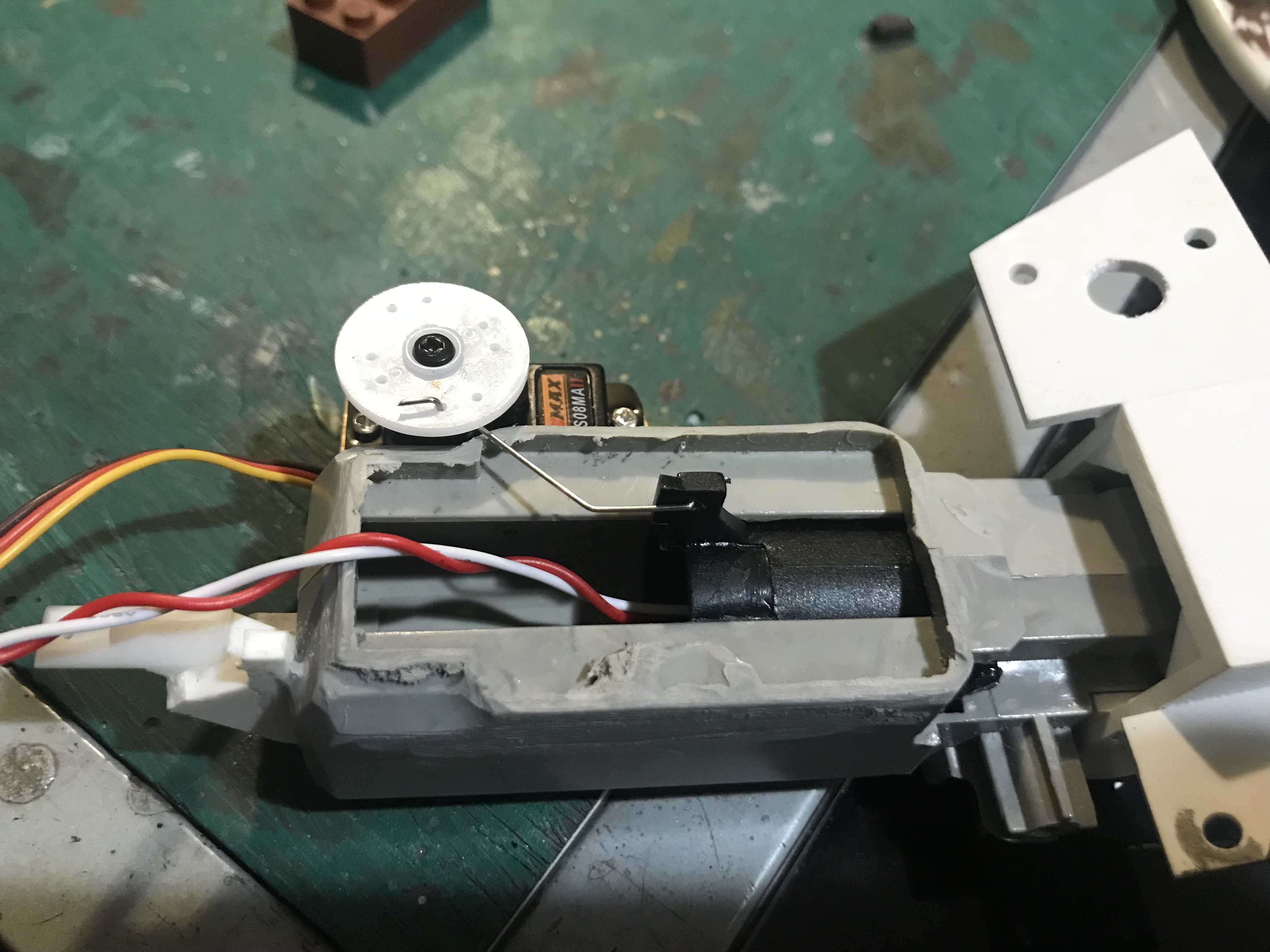

The recoil and elevation are done.
Small servo mounted to the case of the BB unit and linked to the piston by a bent up bit of HL aerial wire!
I made a brass mount & screwed the servo onto it using its factory mounting points.
The brass plate was then secured to the BB case with gel super glue.
For the elevation I used Lego glued to the servo with 2 part epoxy which then was secured onto a corresponding piece of Lego that was glued onto the underside of the resin Casemate.
One of the arms supplied in the servo box was slotted through one of its holes, then that was screwed to the side of the BB case.
Simple and works a treat.
No slop either.
I did have a need for some ballast weight in the front, and as I can’t drive anywhere, went on the hunt for anything that I could use.
Ta-daaaa kids Knuckle Bones game made out of some sort of very heavy metallic material!!
Some double sided tape to keep them in place & no one will ever know
No slop either.

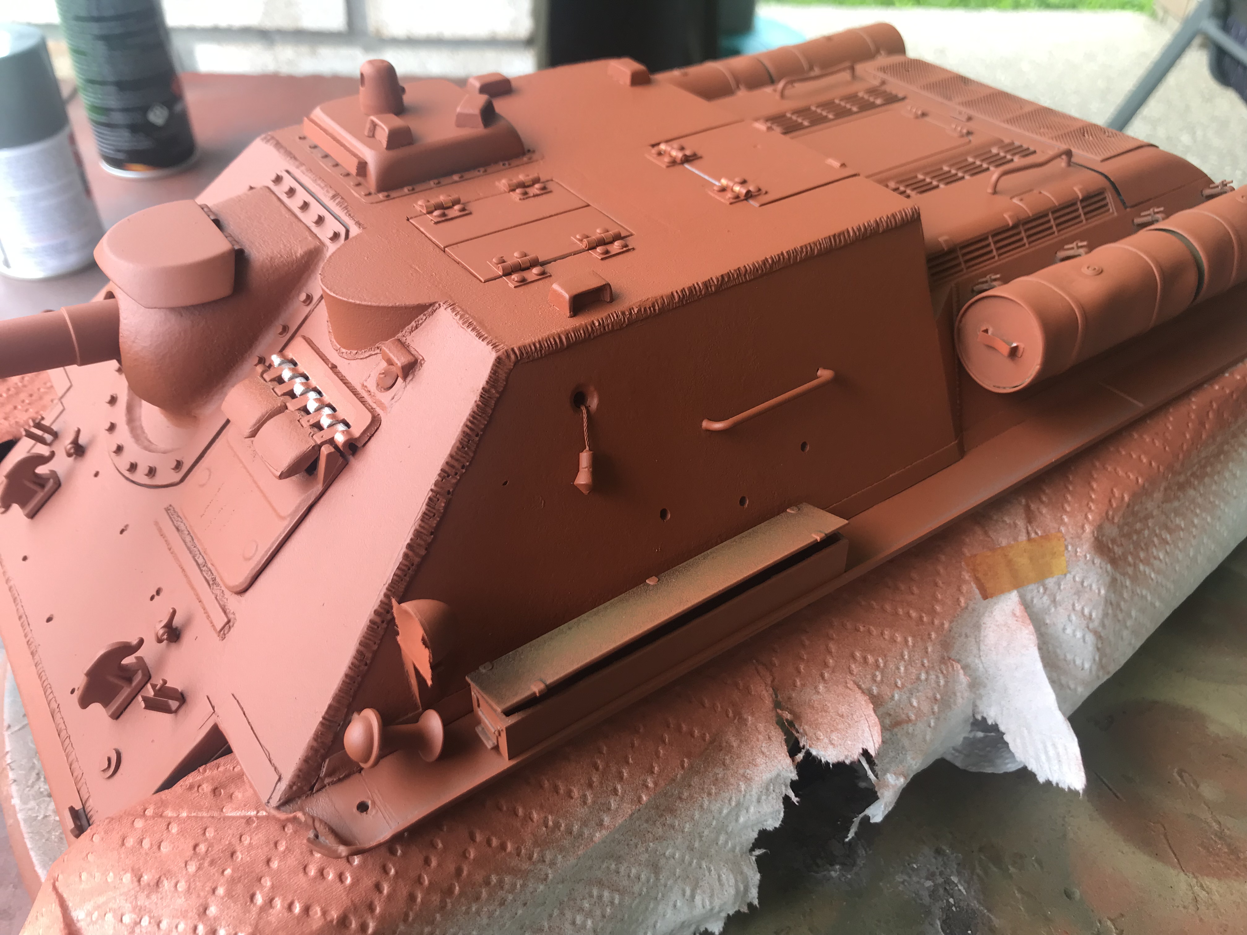

Re: SU '85 AN-BRI-RAMINATOR PROJECT

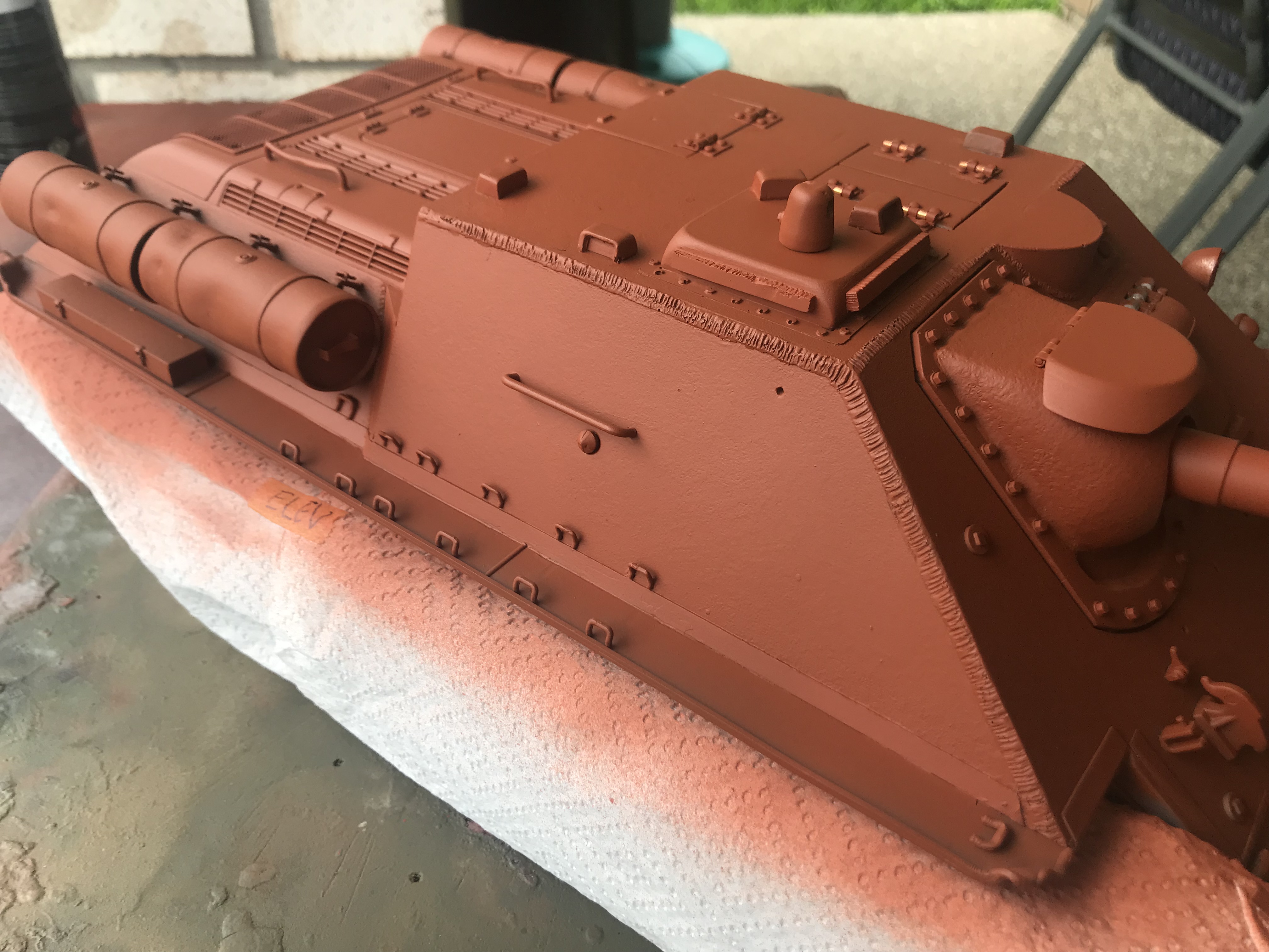

Mmmmmmm priiiiiimer !
The grey that Mr Ram used seemed to be quite absorbent to finger marks etc so I thought a light coat of good self etching primer over it, and the added bits would tie it all in and help the paint stay put without finger prints becoming a problem.

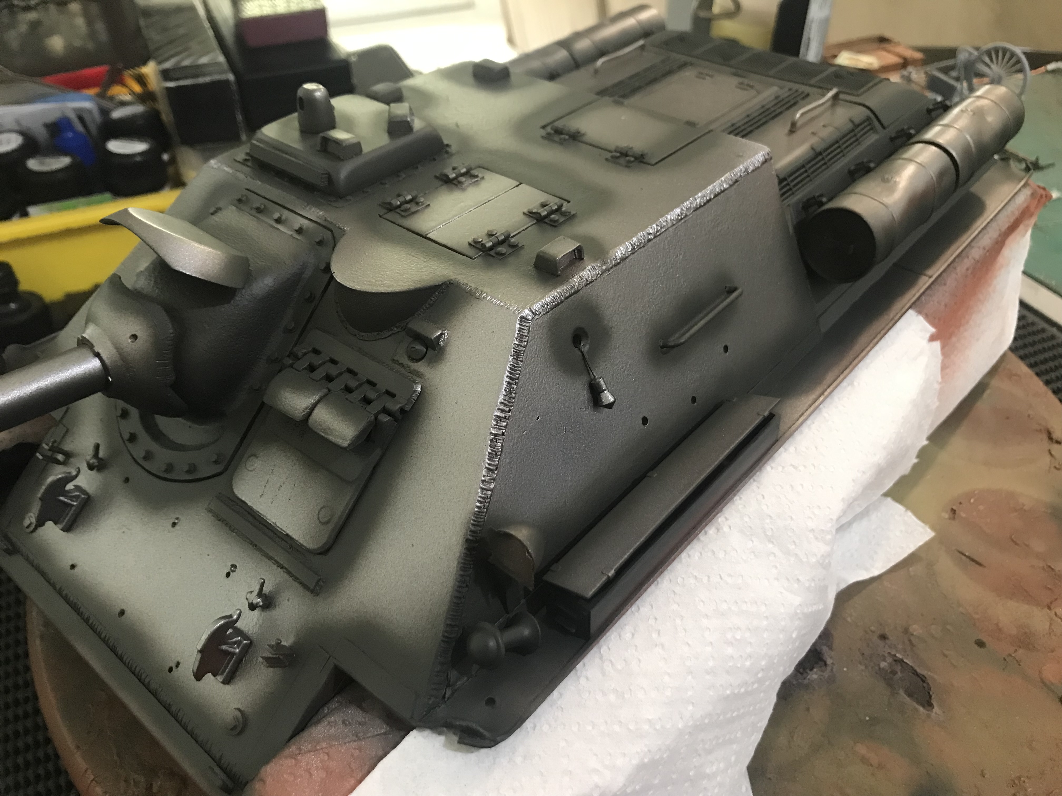

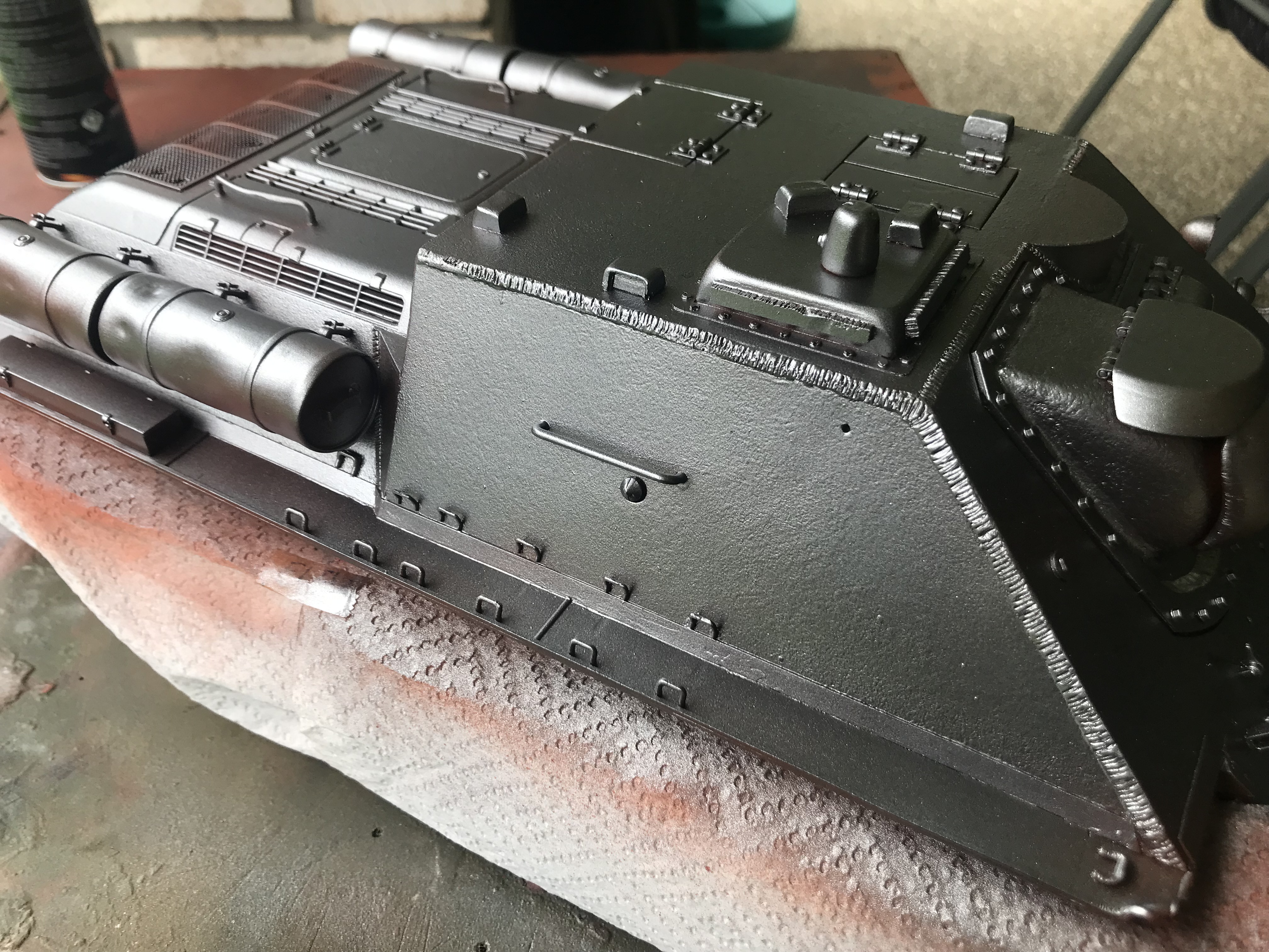

- Posts: 11959

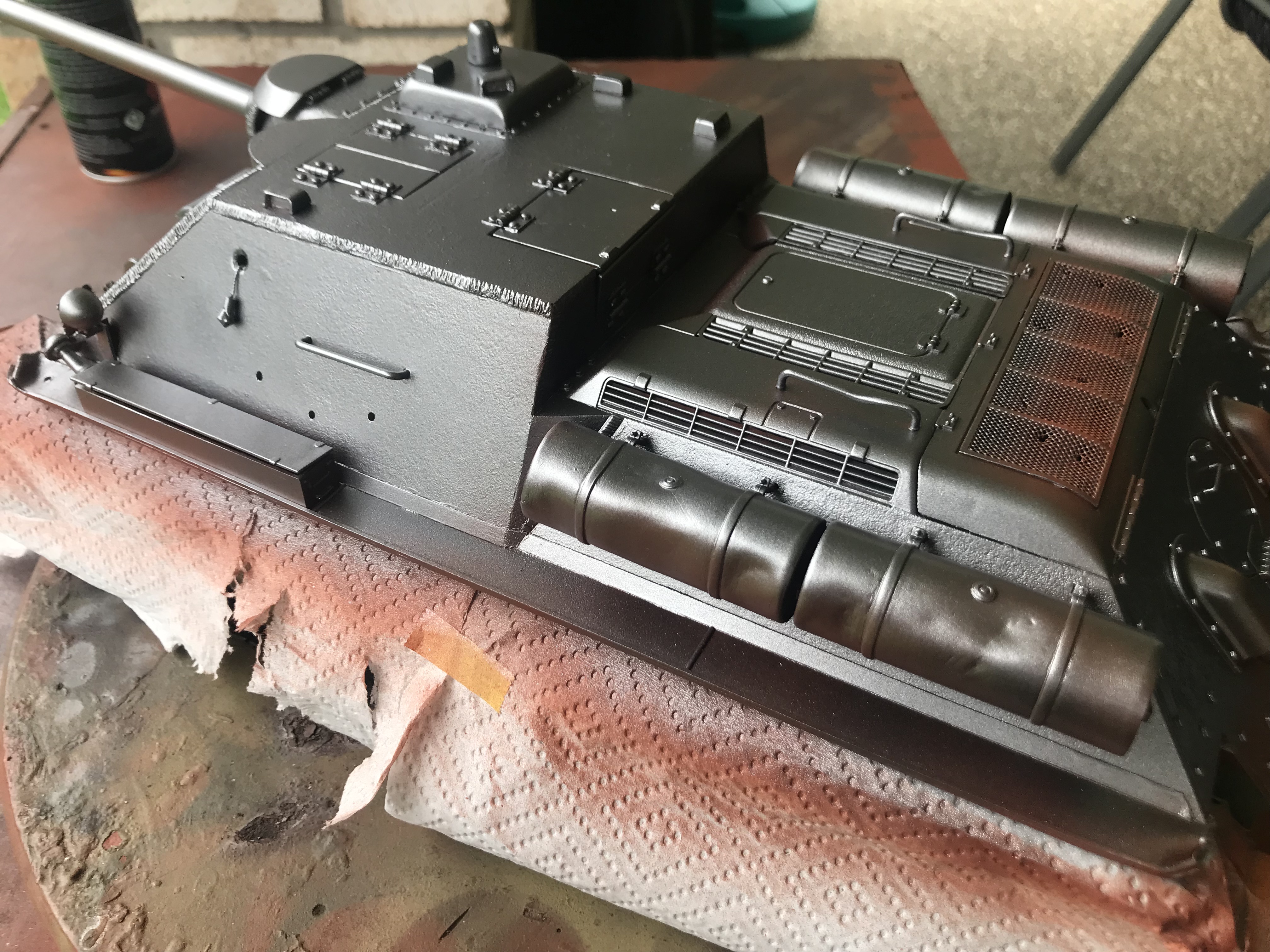

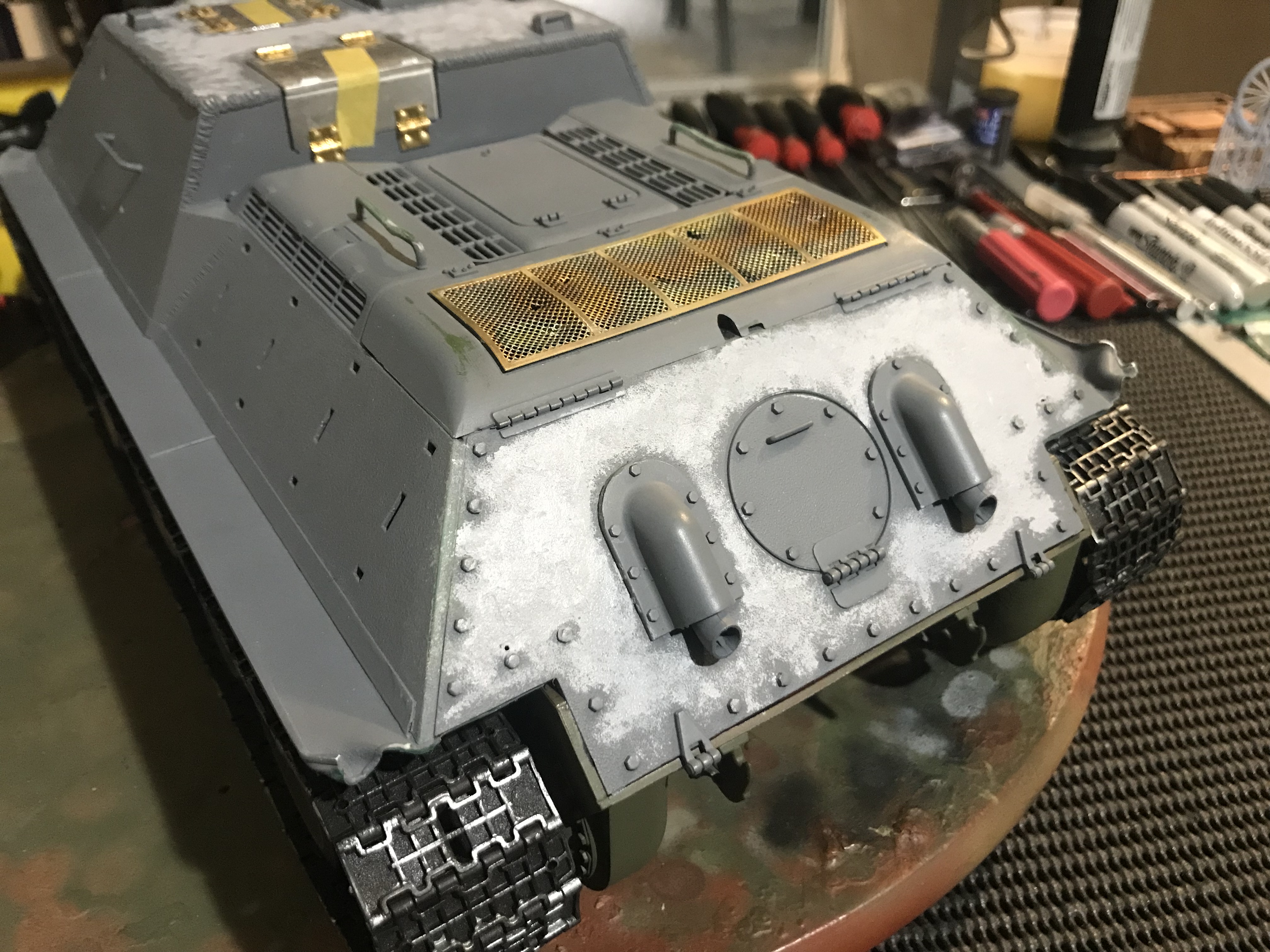

Following on from the success of its use on my SU-152 , I hit the ‘85 with a light coat of Tamiya TS-42 light gun metal.
Now it looks like it’s off to the bloody moon, but it does make for a light base for the 4BO and allows scratches to show if desired.
As soon as it was dry I ran the shadow coat out of the AK 4BO kit in the usual spots.
So far so good.
So far so good.
