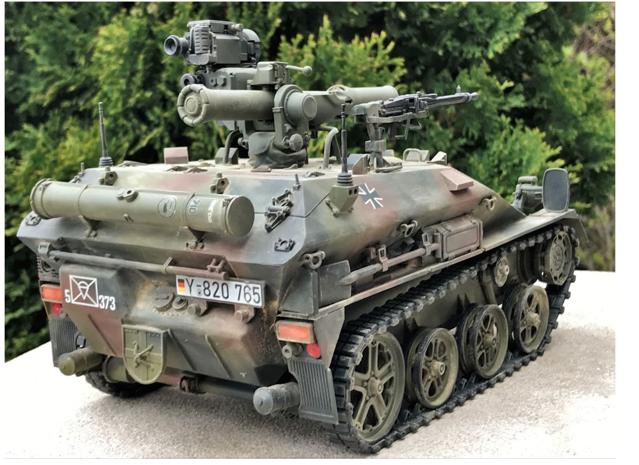

To finish the build, i had planned to put in the provided figure but my painting skill are recreating the Bundeswehr modern desert camo uniform really sucks, so i won't put it in.
Here is a final exterior photoshoot and two Youtube videos of the Wiesel in action.

And two short Youtube videos.
First showing performance in thick bush. It is running surprisingly well and the tracks are holding, but i had to be careful not to push it.
And demonstrating slow, top speed and maneuverability on cement.
Regards, Louis
