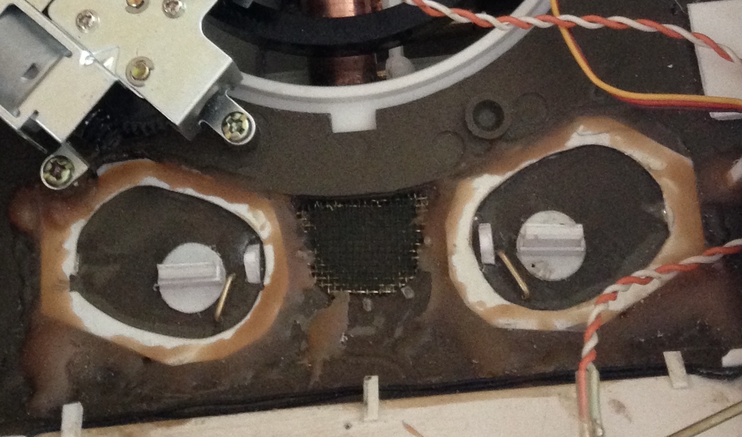

taking profit from the holydays, i started to work on the Sherman
nicknamed "Soul Reaper"
The first thing was to empty the interior of the lower hull, all the electronics went out, since I am going to install an elmod
In the end, the speaker should be a FR7 visaton, I can't fit an 85mm speaker with mylar cone, which is the one I use in the other tanks.
After emptying the lower hull, and as this tank will also pass through the Panzodrom river, I have had to plug the screw holes in the belly, and open an drainage for the water at the back, just below the tow hook.
after closing the screw holes and opening the drainage ones, as always i build a waterproof container for the electronics
next step is making the driver hatch functional, so i can put the main switch below, I used the strand technique, with the help of my wife, who held the upper hull so that I could perform the saw movement with the string. I have intentionally tried cutting to make the hinge functional but I am not sure that I can achieve it. the alternative would be to install the Mato hatch, but I see it very small compared to the Taigen
At this point I would need your advice, what would you do? and most importantly ... how? I don't even know how to mount the Mato hatch hinge
Personally, I would prefer to install the original one that I have cut, as long as I can save the hinge, but the position of the hinge makes it complicated, besides that there is not much material left to work with and make the hole for the pin. Has any of you done it?

Good evening, I personally did it on a Tam, but with the original hatches cut out, and sticking under the ABS, see photo attached, but I think we will have to remove the metal axis, existing and drill a hole, both in the upper frame, as the metal hinge to insert a thin axis
