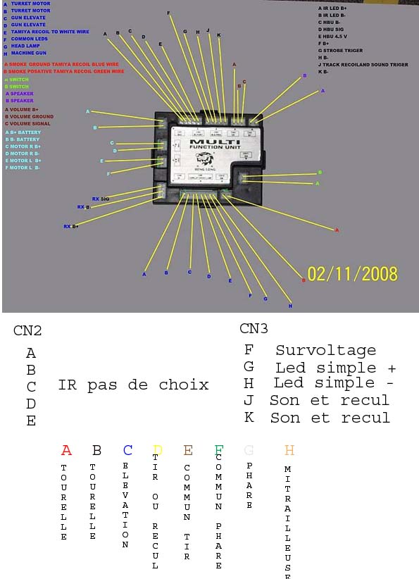

on the 8-pin plug you must have this:
green wire, common leds headlights and machine gun,
+ 3.3 volts
on the white wire (headlights) - 3.3 volts
on the orange wire (machine gun) - 3.3 also'hoping that will help?

Personally I have been riding for 10 years and whether it is Heng Long or Taigen, have never asked myself the question type 5.3 or other? for me the RX are identical, level of connections and voltages, since replaces HL in 27 Mhz by Taigen 2.4 ghz without problem, if you find 7.2 volts it is not normal? be careful to measure the places where the lesd are connected and not taking from a common + or -
elsewhere? which could possibly lead to errors
