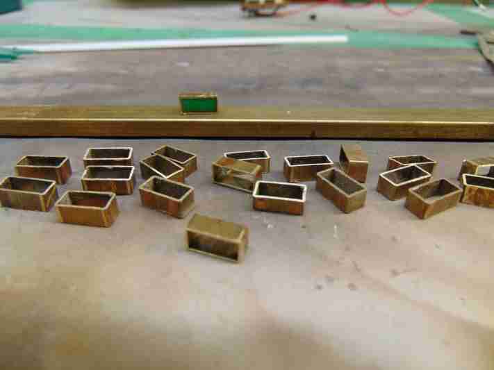

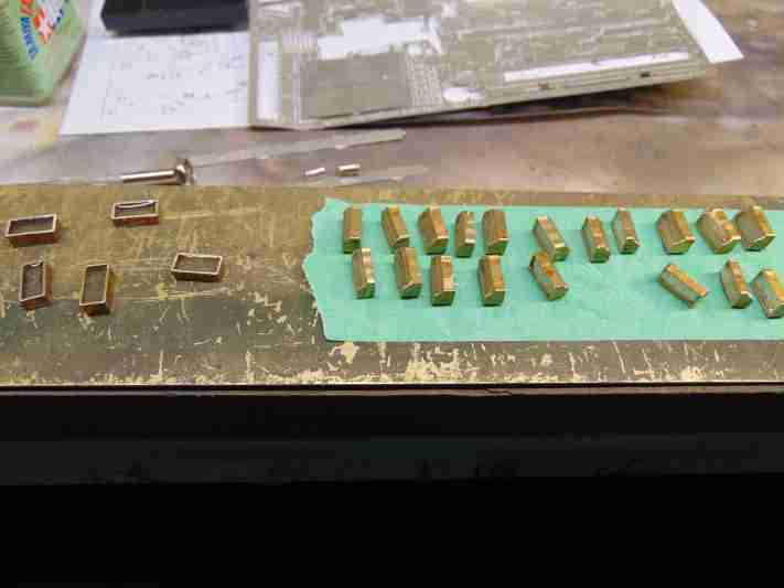

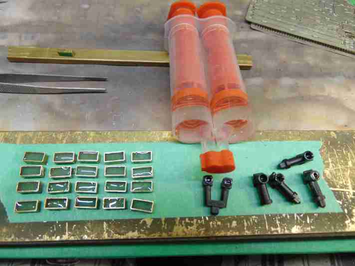

Thought I would show you what I am doing for a 3 Jagdpanther build. I use brass rectangular tubing, 2 part epoxy and Tamiya clear green. Make the periscopes in brass, fill with 2 part epoxy, coat the back side with Tamiya clear green. when it has hardened I sanded off an angle to make them look like the real thing. Then paint up frames and the back properly. Really gives a nice effect...
periscopes 2.jpg (25.95 KiB) Viewed 2195 times
periscopes 1.jpg (28.28 KiB) Viewed 2195 times

Hey, Thanks, Dean! I must say they look pretty impressive, and so it looks like a good epoxy could fill a larger receptacle better than Micro Krystal Clear. The Tamiya clear green also sounds like a good option. :thumbup:
What brand of epoxy did you use, just out of interest? :)
Generally, I use Plastic Fusion- but it's more like a superglue, and it didn't occur to me to use it.
I think JB Weld Plastic Weld might be a better choice for periscopes/lenses.
