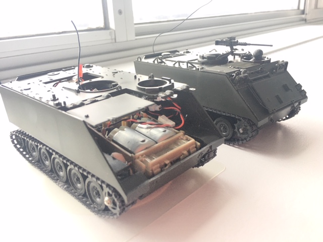

APC #1 has twin 140-RH Mabuchi motors which are have a round shape and are physically larger than the 130 motors in APC #2.

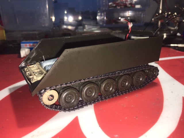

Testing of APC #2 in progress now tuning the setup. The track tension on #2 is much higher which results in more current draw. this is required for those drive sprockets to work properly with the stock Tamiya tracks.
I had to shorten both tracks by 2 links to get the proper tension. Normally the gearbox slides forward\backward to adjust tension but this gearbox does not have that feature. It is a lot easier to use a stock Tamiya gearbox in this APC but they are very expensive. To get one you have to buy a vintage Tamiya motorized remote control kit.
This particular Tamiya model was available as a "motorized" kit (very rare) but not as a dual motor remote control kit. I have a SM motorized gearbox that will fit this APC but I prefer dual motor control. After looking at these SM gearboxes, I feel it would be very difficult to convert one to DM.
Got two of these little buggers that are RRC.

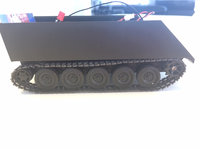

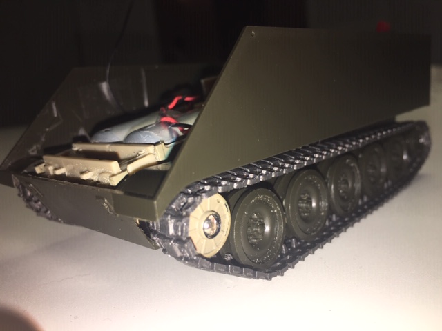

Update...Figured out how to use a scale drive sprocket like a facia. It is only on the outside of the drive sprocket like a facia but it actually engages the track and now no slippage at all.
the drive sprocket has center teeth that engage the tracks center teeth like a german halftrack sprocket.
non stock drive sprockets on this one.
Now it fits in there quite nicely

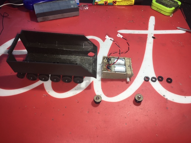

Gearbox trimmed down to fit the M113. I wire all my 1/35 gear boxes this way with male 1.25 micro JST connectors.

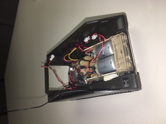

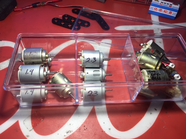

Hey thanks for that Link jimbo_wa. I did find some 140 China motors (3.2 ohms) that work OK. I need to update this thread as I have done a lot of work to both these APC models. I changed the slow 140 motors (20 ohms!) to the 2.3 ohm and I had to add a 5 ohms resistor (now 7.3 ohms) to each motor to impedance match the RX I am using and now it has much better speed and is where I want it.
On the second APC, I redid the sprockets to stock and they work much better now. Redid the plastic gearbox gearbox and it is about as good as it is going to get. It will runs off a 2 cell nicad now where before it needed 4 cells and was very jerky.

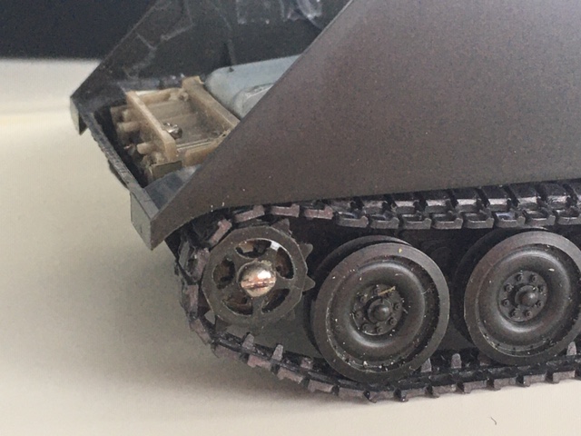

Modified static sprockets on left VS stock Tamiya motorized sprocket on right. Both of these APC's have excellent track mobility.
This screw allows the modified scale sprockets as they come with the static model to now work with the plastic gearbox and are easily removable.
Static APC sprockets on APC #2 have been redone and are now work as good as a set of motorized sprockets.
I used a set of these new 2.3 ohm motors with a 5 ohm resistor in series to (7.3 ohm) and now the APC has decent speed. see video above

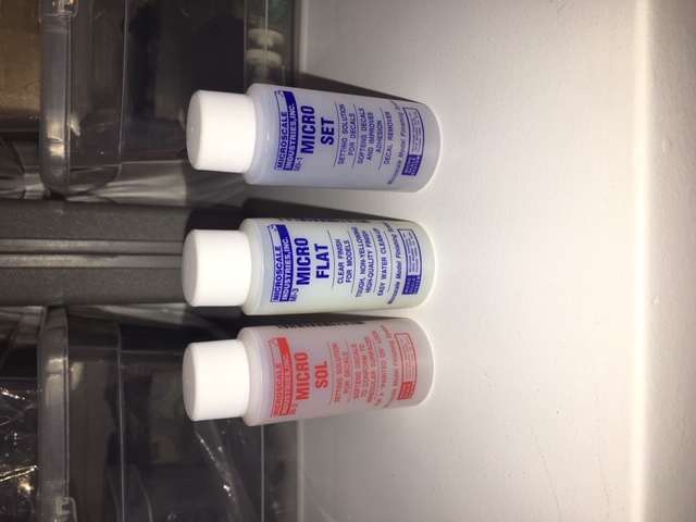

These products are a must for setting these 50+ year old decals.

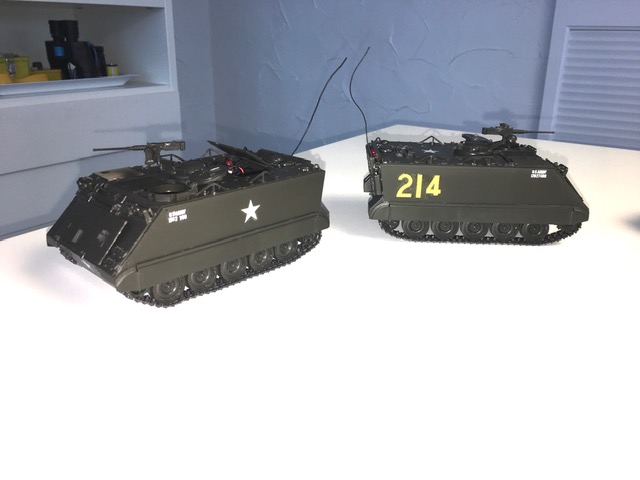

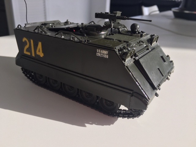

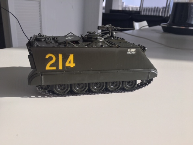

Here are both models. Finally complete with decals
IMG_5863 (1).JPG (58.46 KiB) Viewed 44950 times
Finally got those decals on there

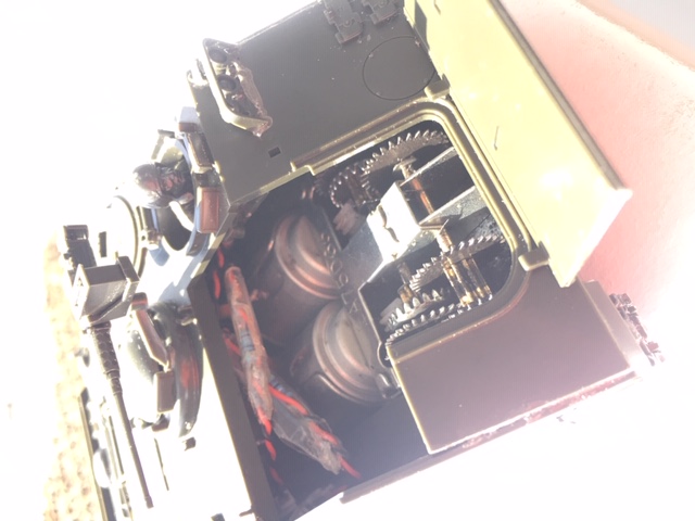

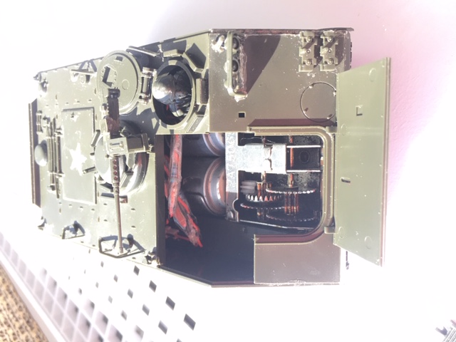

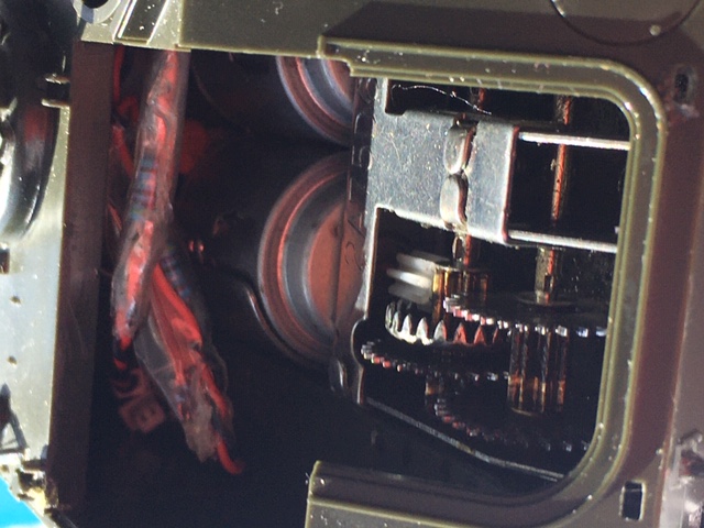

metal Tamiya twin motor gearbox.

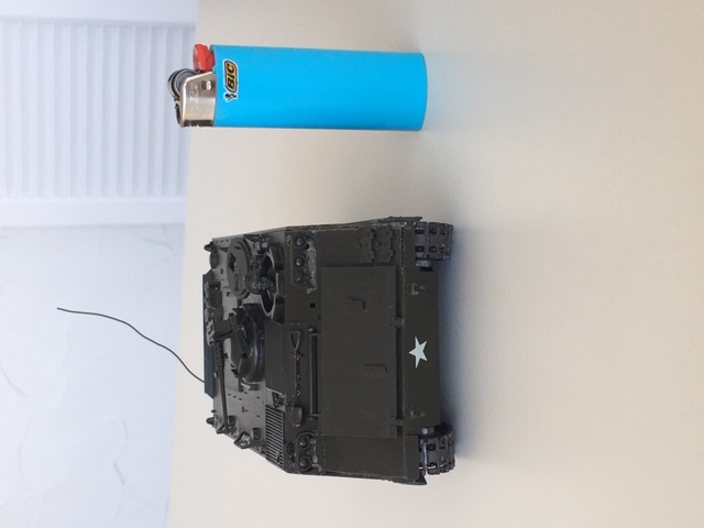

small even for 1/35 models.
