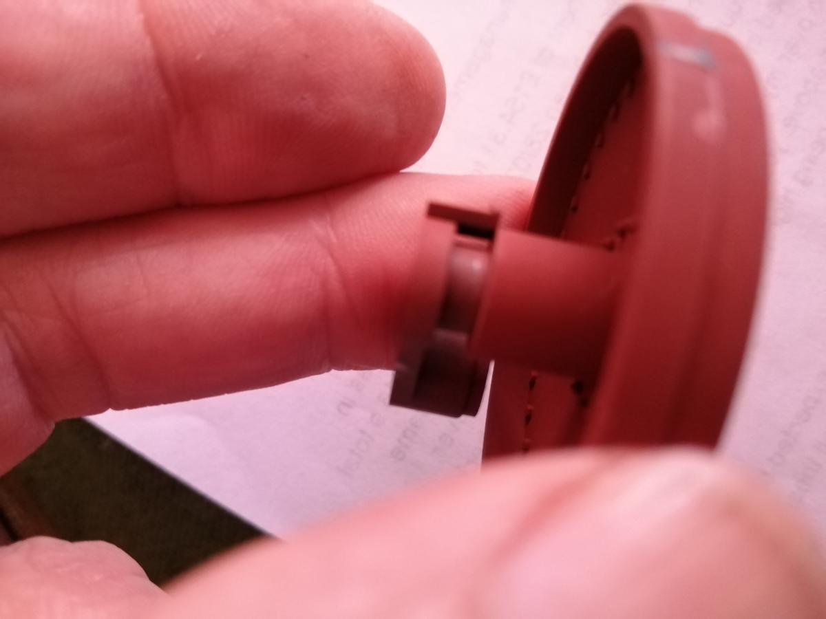

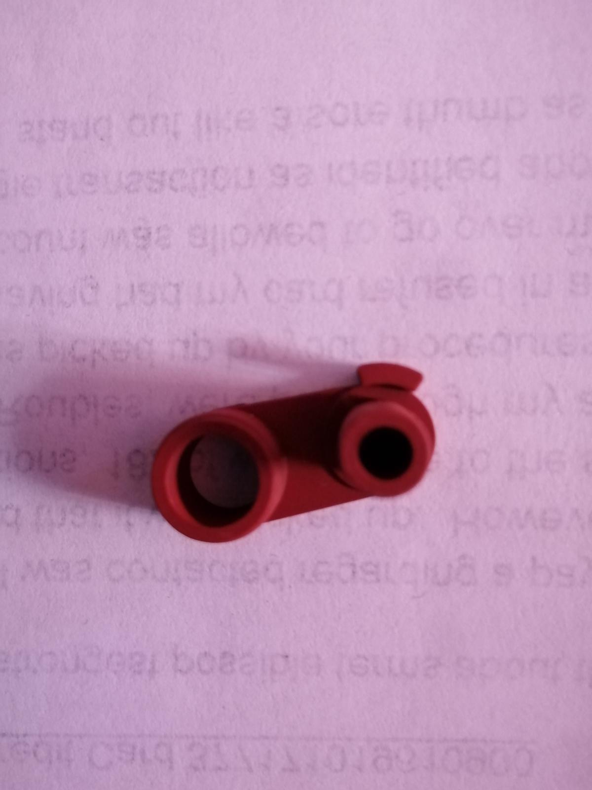

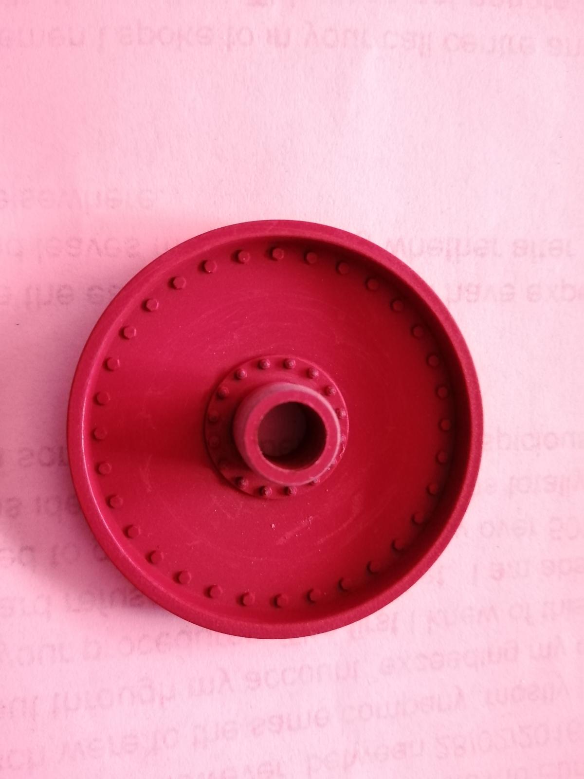

This morning I found my first problem, one of my own making I have to admit. When I started work on the kit, I decided to give everything a coat of primer beforehand. Today I started on the road wheels. They need modification anyway to become free running. The parts are a very good fit, which would be great in a static model. Having the primer on has exacerbated the problem, so I am now working my way through them slowly, rubbing them down. On the right hand side of the photo is what is effectively the axle. Just above this is the small plate which bears against the leaf spring suspension. The instructions say to widen the gap between this and the axle. so far I have not found a satisfactory way to do this, so have resorted to sanding down the socket on the wheel. The situation was not helped when I found that the wheel moulding is imperceptably off centre. It binds for 50% of its circumference. I have overcome this, and the wheel rotates. I would, however, like to widen the gap as suggested as I don't want to make the wheel hub any thinner. If anyone can suggest how to reduce the thickness of the plate I shall be grateful. I have tried wet and dry, but can not get any pressure against it.

Have you got any of those dremel sanding drums? The type you put on a rubber expanding arbor.
Just need to work out how to hold the drum to use by HAND.
These things.
Drum Sanding Kit Sanding Sleeves
https://www.toolstation.com/drum-sandin ... 4wEALw_wcB
Triton Aluminium Oxide Sanding Sleeve Set 13-76mm 80 Grit 6 Pcs | Bobbin Sanding Sleeves | Screwfix.com
https://www.screwfix.com/p/triton-alumi ... A3EALw_wcB
Unless you have some suitable tube you can wrap or glue some sanding sheet around, you may need something a bit course to speed things up, and wouldn't need so much pressure. Again, to be used by hand.

Richard have you looked at my build thread? If I remember I sanded down the exterior of the wheel hub and very carefully hand sanded the arm. The dremel may work but due to the fragile nature of the plastic I stayed away from it.

If I use anything from the Dremel, it will be the sanding drum in my fingers. I will have a look, but I don't think I have any suitable tube. The machine is far too viscious, as Carl has said. I will have another read of Carl's thread. I did read it, but I think my brain is full and it did not stick. Thank you both. I am sure I can progress in an orderly manner with the benefit of your advice.

Like I said and re emphasised, by hand, I was never suggesting using the dremel. It's just that most people have those drum sanders for their dremels. And one can make useful sanding HAND tools with them.

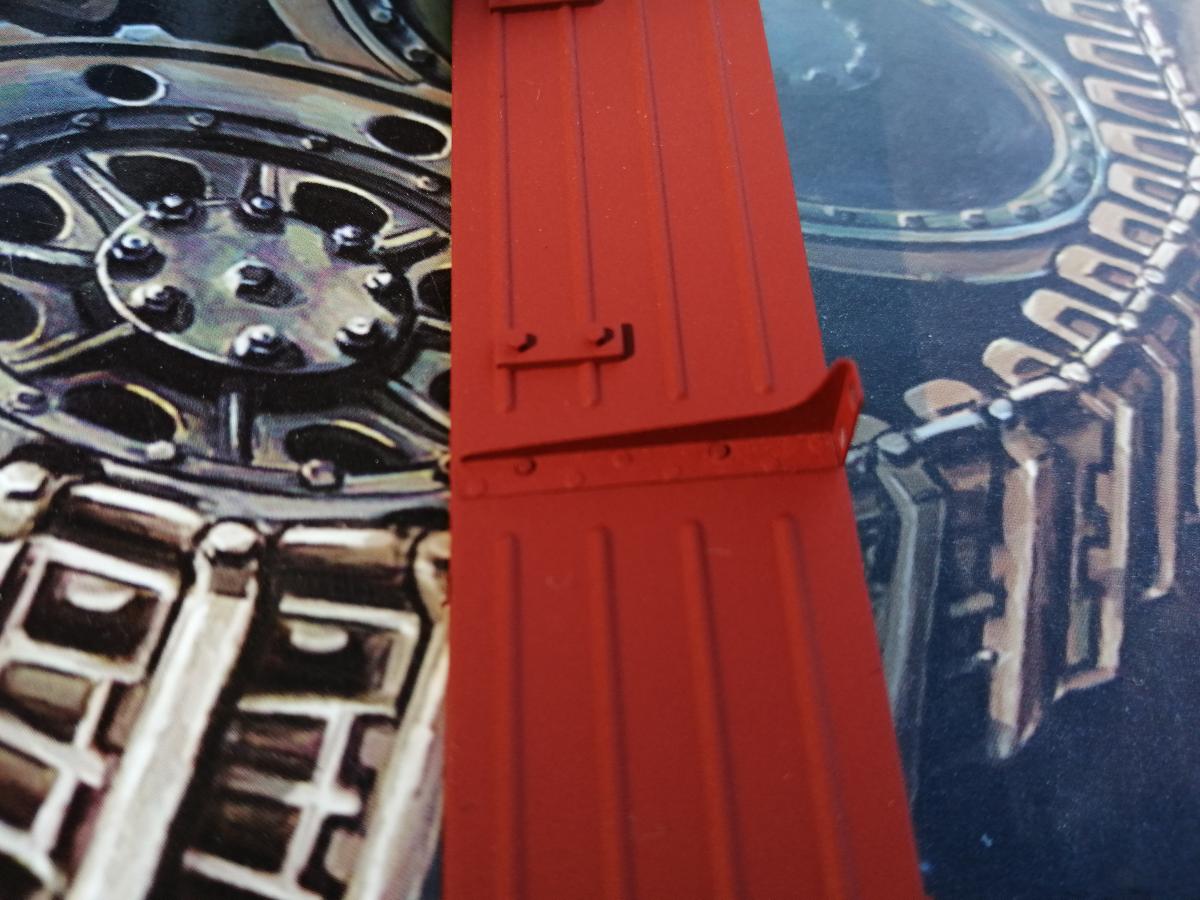

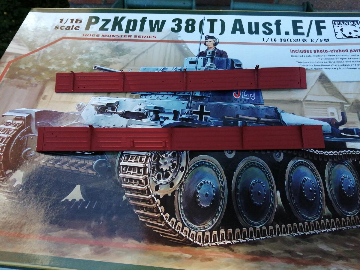

Slow progress, I'm afraid. I have made up and fitted the PE mudguard brackets. Vey impressed with the way they have used the locating tuds as rivets. The brackets all fitted perfectly with one odd exception. On the rear left bracket, the studs did not match the holes in the bracket. It was easy to rectify though. Slicing very carefully with my trusty Swann & Morton scalpel, I removed the offending stud, glued on the bracket and refitted the stud into the empty hole.
