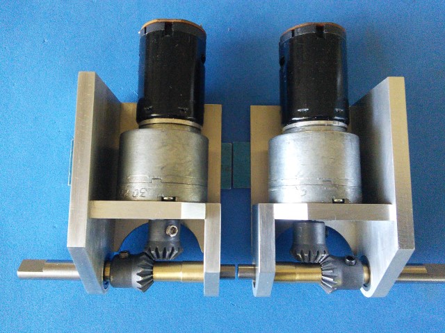

Re: Building a Bevel gear Gear Box
Hi all,
finally with all my various gear box projects almost coming to an end I started installing them in my Tiger2
To my dismay installing the gear boxes required me to completely take the lower hull apart.Which is a nice experience but very time consuming. There are around 500 screws that hold the lower tank together.
To be able to install and remove the gear boxes with ease, it became mandatory to redesign the gear box housing.
Reducing each one by 6mm would give me an extra 12mm inside space.
There where also other modification that needed to be done too.
The geared motors I used where sold as 30 : 1 rpm. It seemed a touch slow but I thought I could use a faster motor to compensate.
Installing and testing the finished gear boxes did not satisfy. Crawling was excellent but overall speed was to slow.
I bought another set of geared motors sold as 60:1 rpm.
Finishing and testing them was another disappointment. Crawling was a bit fast so was the over all speed.
In frustration I started experimenting with my first gear box ( 30:1 ) By rearranging the gears, then ended up taking one gear out all together. To my surprise it was the best outcome yet. Good crawling speed 30 degree with ease and it speeds up nicely too.
It will be a wile before I think gear boxes again though.
