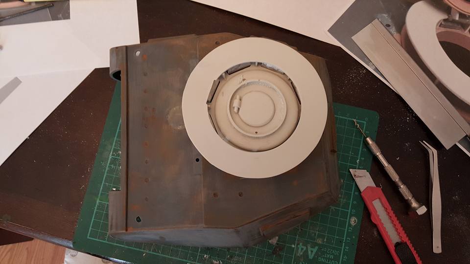

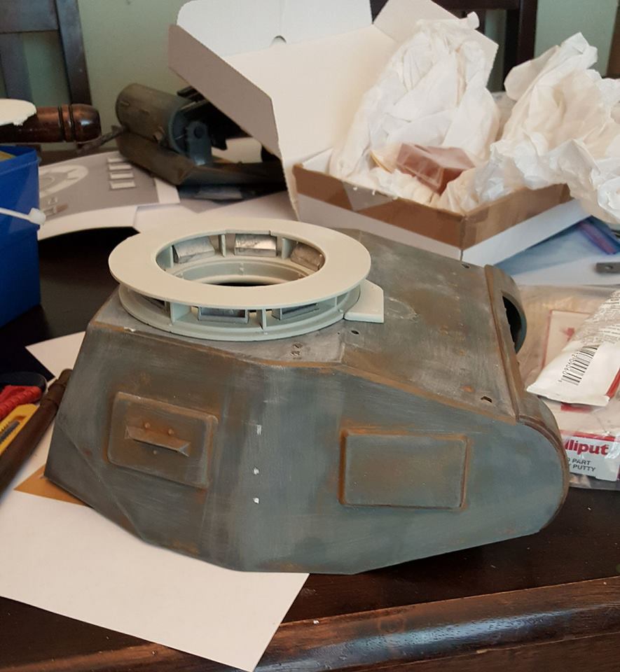

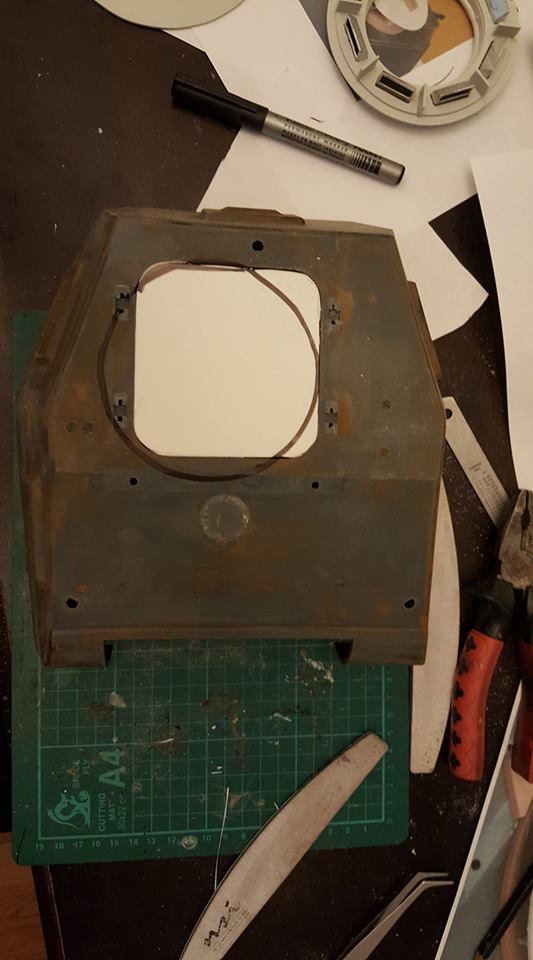

I got my Upgrade Cupola and started working on the Turret. First job was to fill the hatch holes & removes the Hatch hinges. Then I cut out a hole & fitted the Cupola. I still have to clean up the Cupola before beginning assembly.
Cupola trial fit
Cupola trial fit
Cupola trial fit
Cupola trial fit
Hatch hole filled & new hole marked out.
