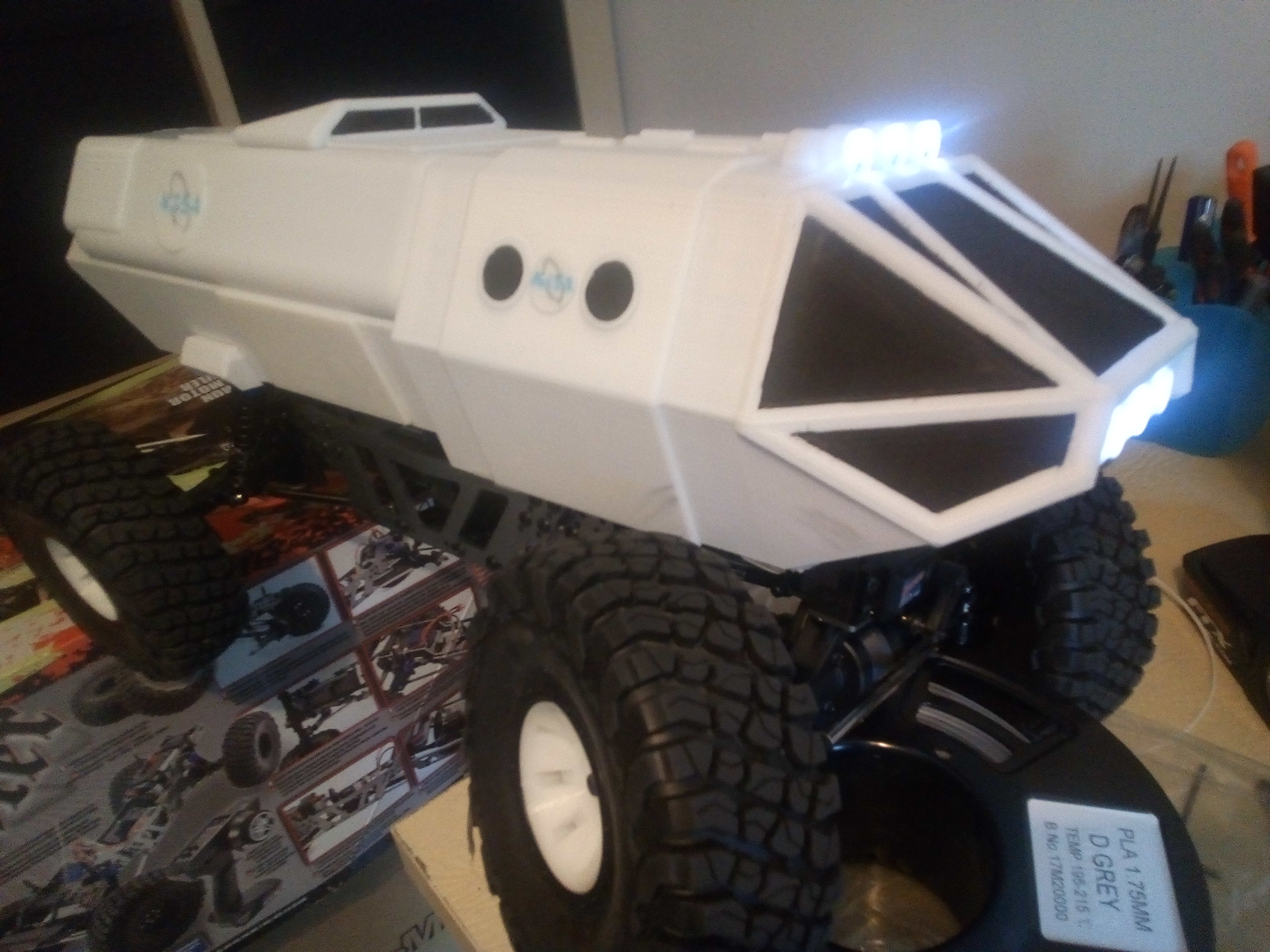

Must be something in the air, I’m building a rock crawler/truck/Unimog/ tank towing beast, trying to get my money’s worth with as many uses as possible.wibblywobbly wrote:Just a few mouldings to print and glue on, but 95% done, and even hooked up six led's that work. One thing I did notice was that although I have a big bag of led's they weren't all the same brightness, so I had to keep swapping them out till I got six the same. There is an led socket on the esc, but it puts out 5.7v, so I ran the power through a voltage regulator adjusted to 3v output and hooked the led loom up to that.
Sorry it's a short video, the blooming battery went dead after 60 seconds...grrr!

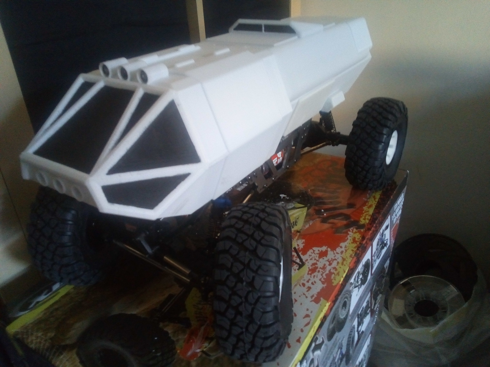

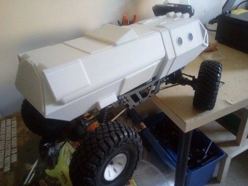

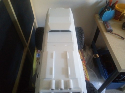

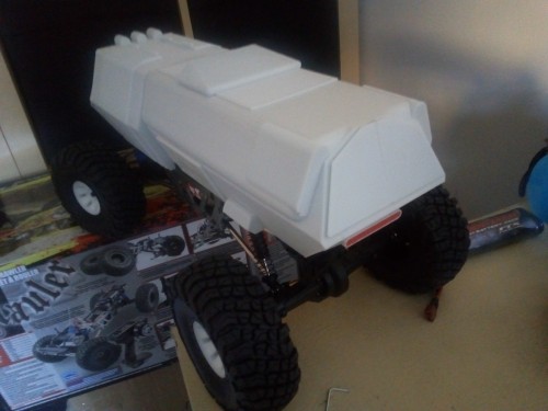

I am now considering this to finished. I will take it for a test run sometime and then decide whether the esc, steering servo and motor need replacing with something more suited to rock crawling.
I have used around 1.5kg of filament to do this one, but as always I have learnt a great deal about parts design, reducing filament required, and reducing print times.
The CR-10 in combination with Cura achieves remarkable results. Everything, including the curved parts all slot together perfectly.

Re: Rock Crawler
The typical colour for space stuff is white, so I used white filament. When it gets scratched and knocked it won't show as badly as a painted surface would.
I will have a go at stencils and put NASA symbols and things on it.

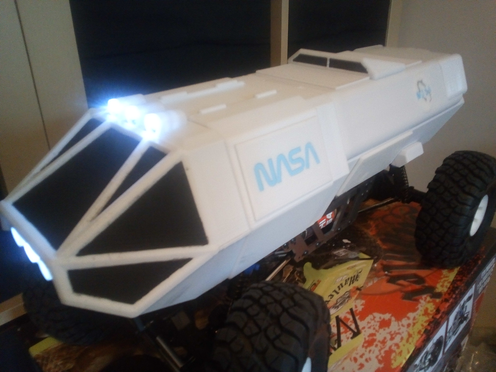

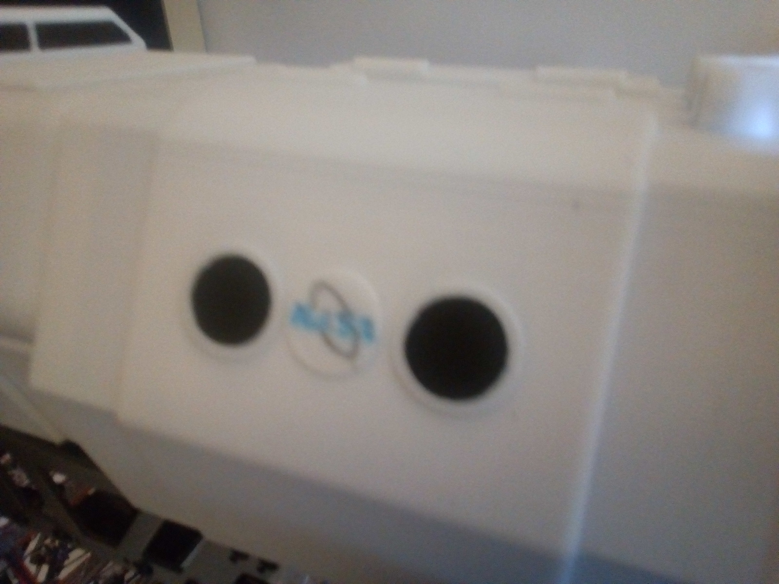

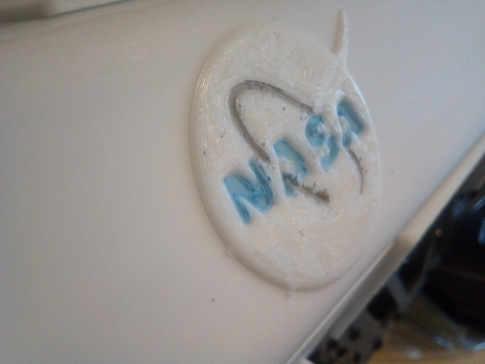

Re: Rock Crawler
How about these. 3D effect logo's, infilled with colour.
Need to put spots in the craters on the 3D lunar surface on the background, but they turned out ok.

Re: Rock Crawler
Love it Rob - did you use CURA print fom jpg?
