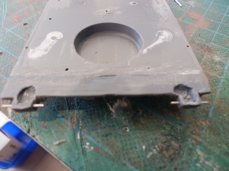

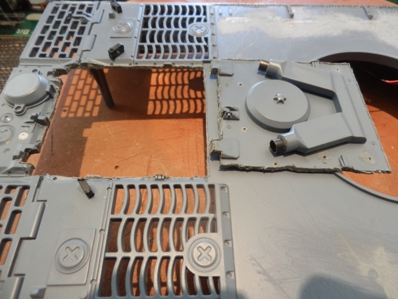

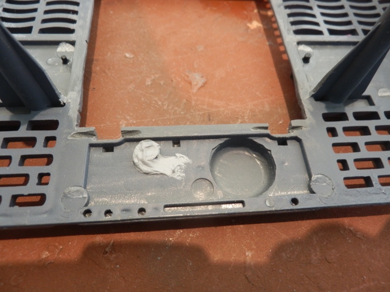

Been chipping away at this, held up a bit due to a lack of parts, but in the interest of keeping busy, I have attended to things I really would not normally do.
Decided to make the rear main engine hatch open.
"Brilliant Baldrick"
Heated up a craft knife & cut into the hatch profile.
Its worked ok, and cleaned up good enough.
To hinge it all I did was drill a hole through the hinge mouldings and placed a shallow groove with a dremmel blade into the hull underneath each hinge section.
Dress making pins cut short will fit into the grooves & be covered with an infill section.
I will also need to make some degree of infill around the hatch hole, but thats not an issue.
If I can place the switches under it, that would be gooderer !!

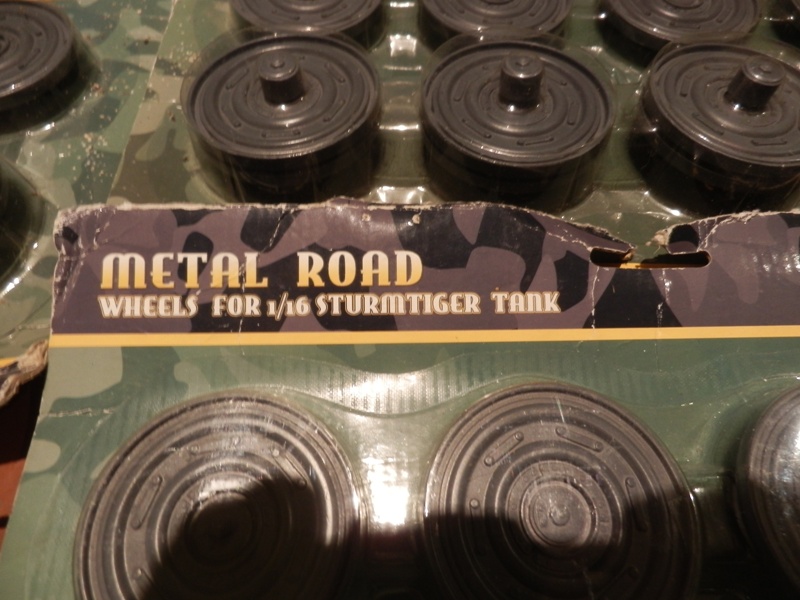

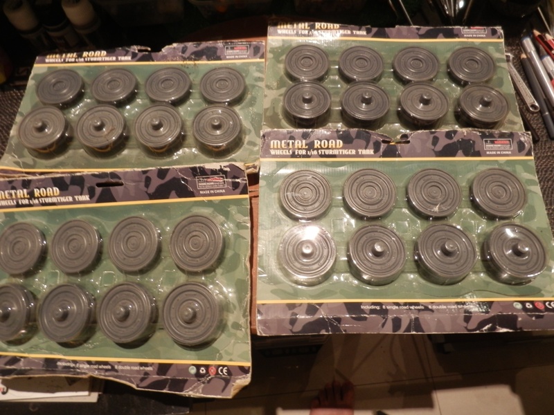

Odd thing though, in the literal containers of tank parts the guy had, was a set of metal roadwheels for a Matorro Sturmtiger !
They are really rare & Im almost reluctant to use them.
Trouble is if I do, they are not a simple add on without heavy modification, and as such, will ruin them as relic parts !
Seem too unique to cast into the abyss that is 'Tiger Building' :haha:
