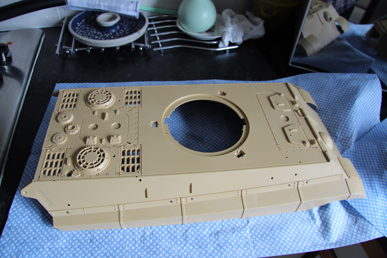

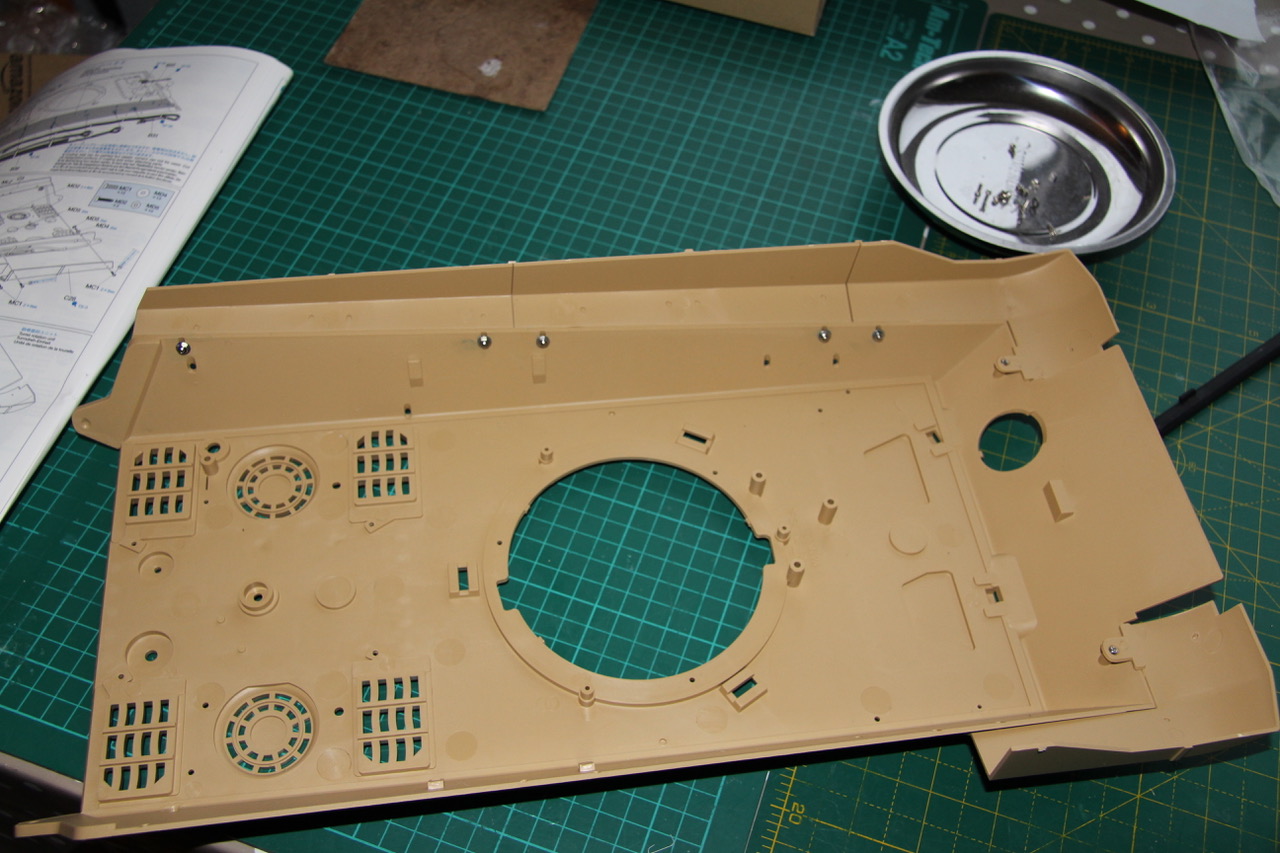

Time now for a little attention to the Upper Hull. The lines of the hull are crisp and distinct, as if they came out flawlessly from superior moulds. For the price, and with Tamiya's reputation, you would expect nothing less. However, I was immediately struck by how thin and flimsy the Hull feels. The walls of My Torro (metal ed) King Tiger seem to be twice as thick, and much more rigid, than Tamiya's offering. :eh:
Here's the Hull. I've just been adding the side skirts/mudguards. ('Fenders' in Tamiya-speak). Again, it's necessary to add a dab of threadlock to the retaining screw/nut combination. Before I began this project, I assembled all the build tools I'd need. I picked a threadlock of medium strength.(Even though there's one in the Tamiya kit..but it took me a while to find it :eh: ). Why medium? Well, it's a compromise between securing the part, and being able to remove it at a future time if the Tank would look better with one or two sections of Fender missing. You don't want to forced to drill the fastening out, if you wish to remove the part. The same applies to worn suspension components.
Fitting Fenders to flimsy upper hull
All side skirts or Fenders now in place..

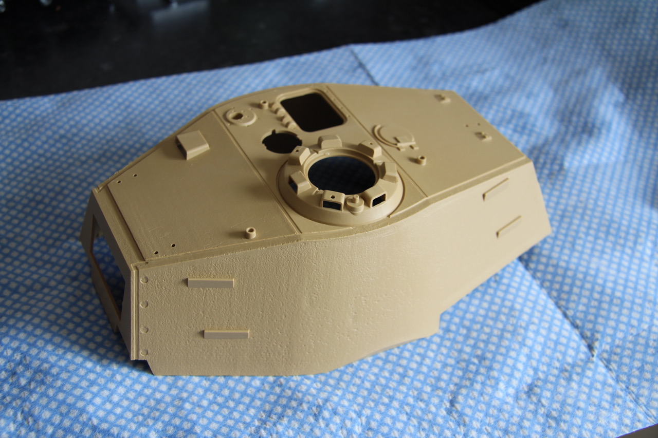

Here's the unadorned Turret. There's not much to say about it except that it's surprisingly bendy, and has some subtle and credible pitting marks in the walls as 'evidence' of the German foundry casting process. Under a coat of paint, the pitting should look pretty authentic. :thumbup: I've also decided that I'd prefer the pitted look to the Tamiya zimmerit that came with the kit. I already have the Torro Pro King Tiger. (A model that comes in its own sarcophagus..like King Tut :haha: ). The Torro comes with embedded zimmerit and not much can top it, in my humble estimation :thumbup:
Tamiya KT Turret- minus embellishments
It doesn't take long to cut the turret parts out of the sprues and glue them in, so I'll skip all of that. Anybody wishing to see it dome with artistry, and with choice 3rd party upgrades should look at Painless' Tamiya Tiger 1 build. Yes, it's a different model, but the same principles are involved.

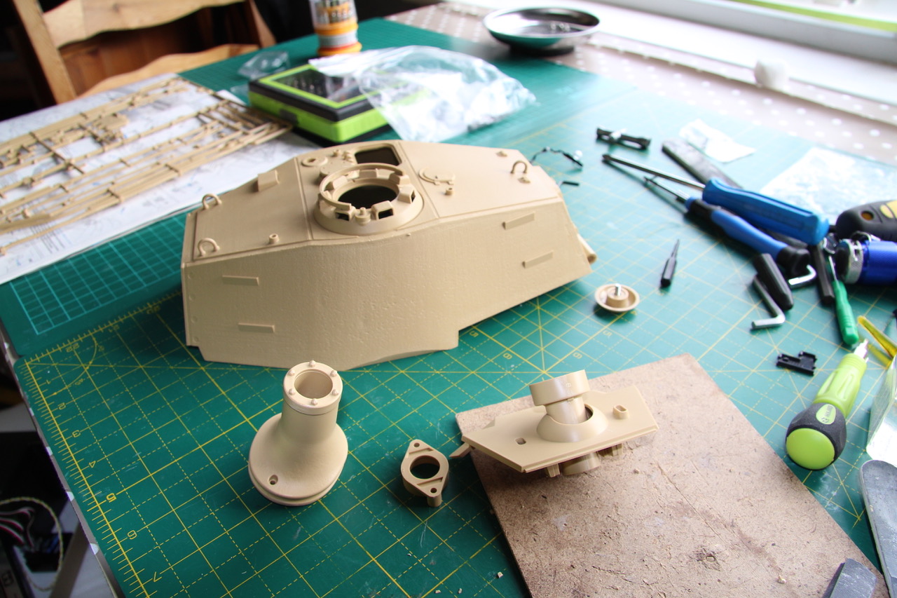

Re: Tamiya Königstiger- a blitz build
After adding the turret lifting rings, and the MG support rail, I got round to assembling the gun mounting: (The b***ard predictive text feature just put 'gum' instead of 'gun'..good thing I checked @) )
Assembling the gun mountings..

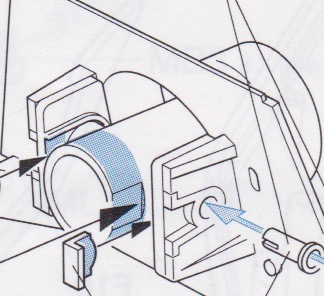

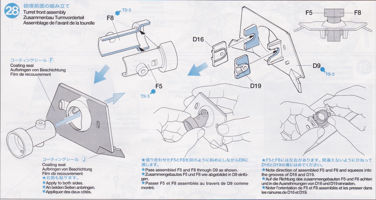

But in diagrammatic form, this is what you have to do:
Tamiya KT gun mounting assembly
Gun mounting aperture
Tamiya KT gun mountings 2.jpeg (37.09 KiB) Viewed 4670 times
I used the Contacta Pro cement here, as it's necessary to get the glue in exactly the right places, and nowhere else. Hmm.. I like the smell of cement if the morning :crazy: :D

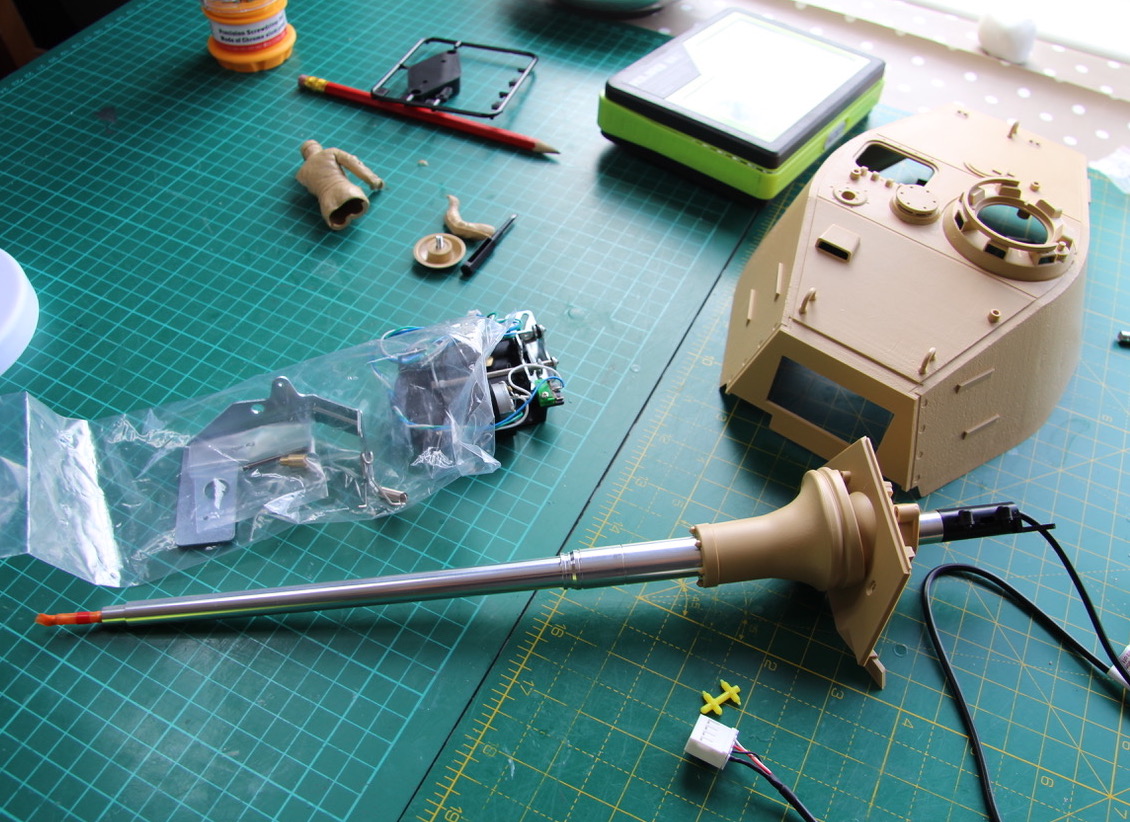

After fixing the barrel assembly in the Turret front armour plate, it was time to start adding the really interesting bits: the recoil unit, and the elevation unit. By the way, the Full-option kit came with a very modest looking plastic barrel unit in the sprues, as well as separate metal alloy barrel kit in its very own box. Guess which one I chose? :think:
Slipping flash lead into barrel
the flash cable slips in easy (Should be 'easily', but hey.. ;) )

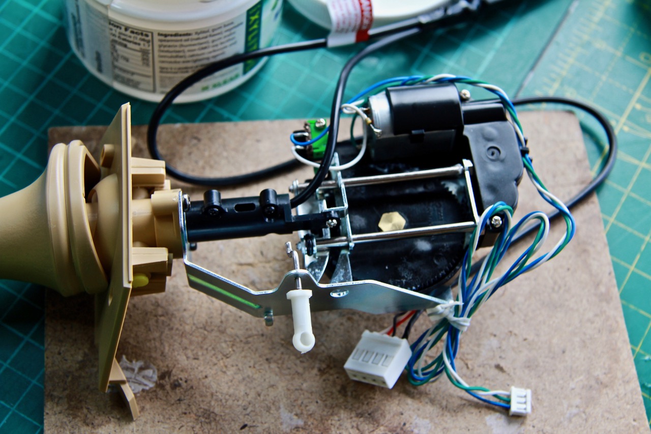

Then, its time to attach the recoil unit. I must say, all the screws go in nicely. All in all, everything fits exactly where it should without the need for reaming, sanding, or other desperate measures. Images of that crappy Asiatam Pz IV hull come to mind, with the nightmare experience of nothing fitting properly. It was like a dream of a jigsaw where every piece needed to be 'trimmed' to fit where it should go...
The Asiatam called for the 'Emergency essential tool' (single malt 15-years old) over and over! :lolno:
Tamiya KT recoil unit fitting..

I think you put the flash unit wrong. Once insfalled propperly, it wont move anywere. If I remember correctly the wire goes trough a side, and not through the back.
