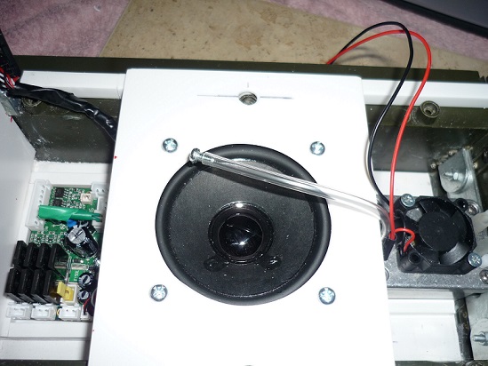

With all the impressive improvised struts and shelves, :thumbup: will there still be sufficient clearance for the gun to depress and elevate? :think: I imagine an airsoft version would pose a problem, but maybe yours is IR...
Neat work, though.

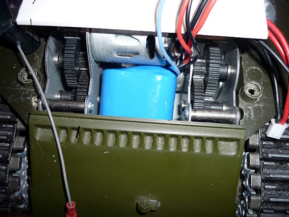

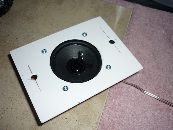

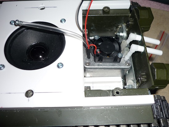

Good morning all, thanks for your comments chaps, painless, your Sherman looks super, :thumbup: well weathered I
like the shape of the cast hull, 43rd,there is a surprising amount of room inside, the framework was added so I could
fit the large speaker and I was going to mount the battery over the tk24 in the available space, however after seeing
on the forum you can remove the case on the hl li ion battery I have slotted it between the motors as it fits nicely
in there.
I cut the airsoft unit up and fitted a servo recoil so that doesn't hang down into the lower hull, in fact the plate on
the bulkhead where the switches will go has a good inch clearance to the hatch doors
regards john.

:thumbup: Nicely thought through and planned.

Thanks 43rd, its taking shape now, it will never achieve the quality of some of some of the builds on here though
but I am happy with the way its coming along, I have a few items I have ordered from china for it so waiting for
the orient express to bring them.
not entirely happy with the elevation/recoil I lashed together so going to have a rethink on that.
regards john. :thumbup:

Very neat! Where does the battery go?
